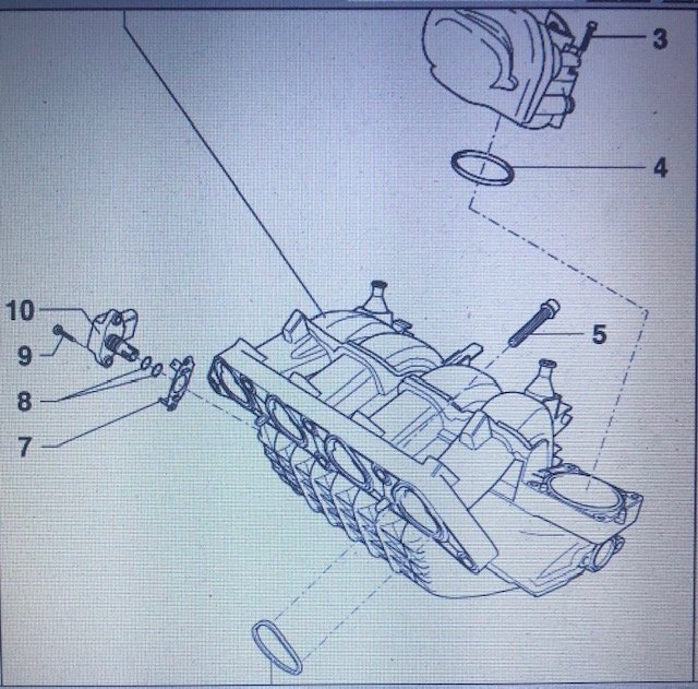

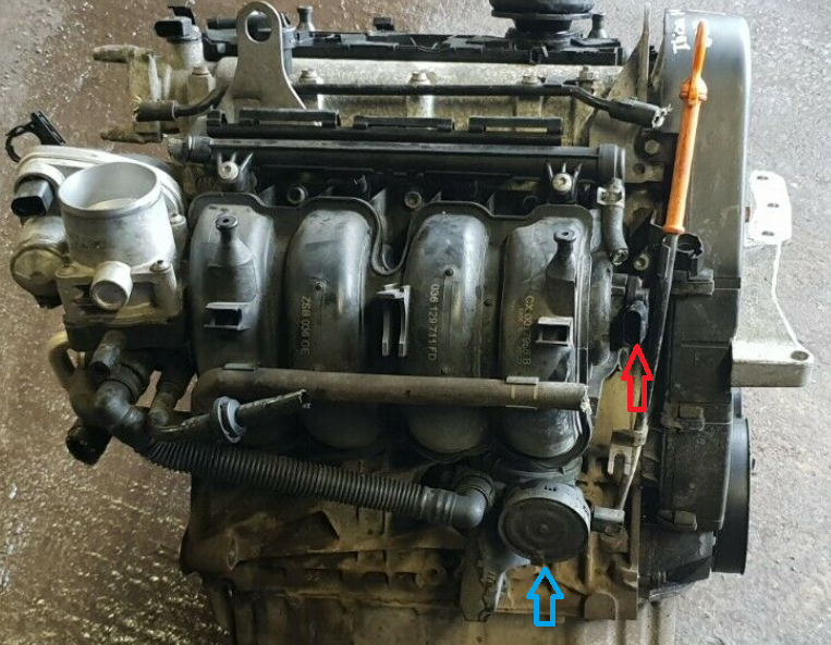

    BBZ engine MAP sensor and PCV valve positions shown with red and blue arrows respectively:

#10 is the MAP/IAT sensor  ( Manifold Absolute Pressure & Inlet Air Temperature sensor) the sensors often get gummed up with oil deposits you can clean them but only use carb or brake spray cleaner, do not use a brush or anything else as they are quite delicate.
Much appreciated Nige, thought so about sensor position in my car (2007 16 BBZ ) it is at very  awkward position near the dipstick and possible need some pipes to be removed before reaching there , on Motor also grateful to share the info please. Will consider checks  before changining sensor since car have high mileage so possible may need change those. Cheers
PCV valve looks like it might be a PITA to get at with the engine fitted, I hope it doesn't involve removing too much brittle plastic to get at it if required.
I can almost guarantee there won't be anything wrong with the MAP sensor.

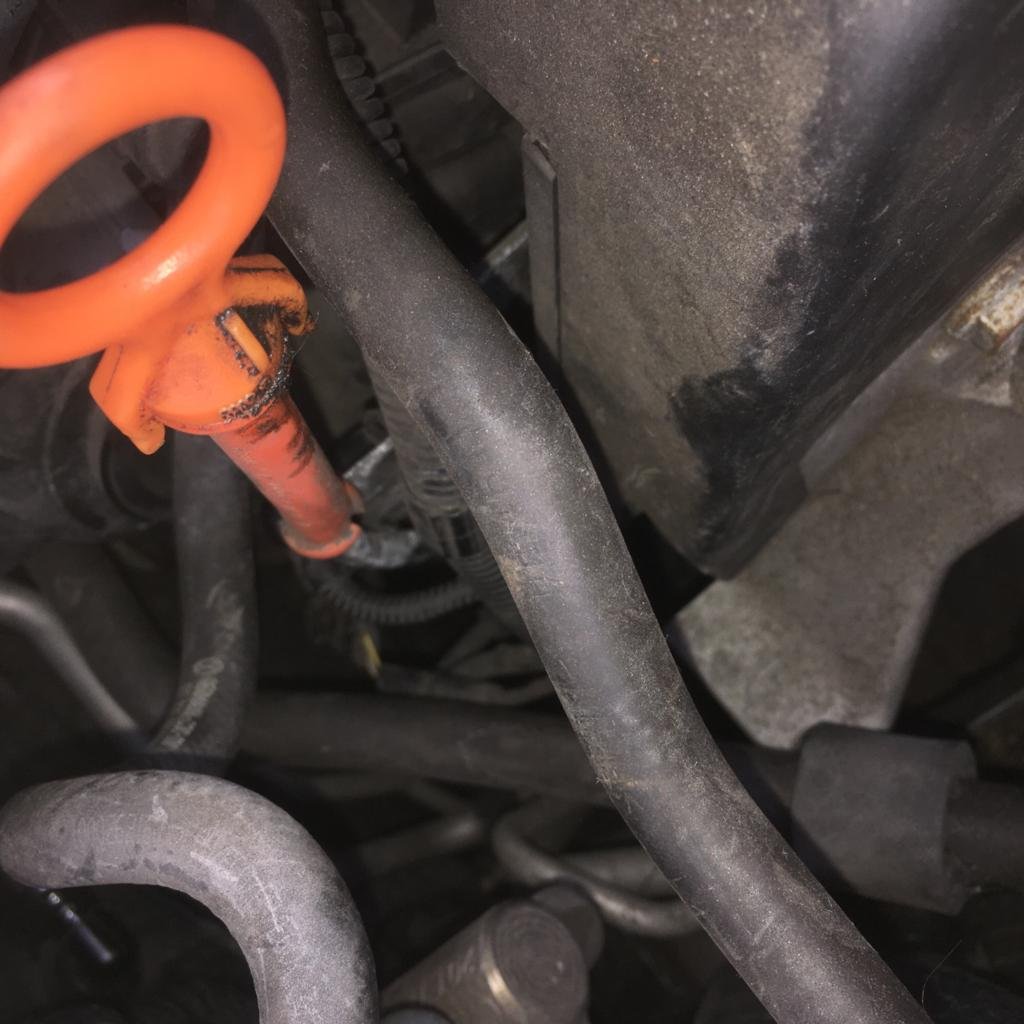

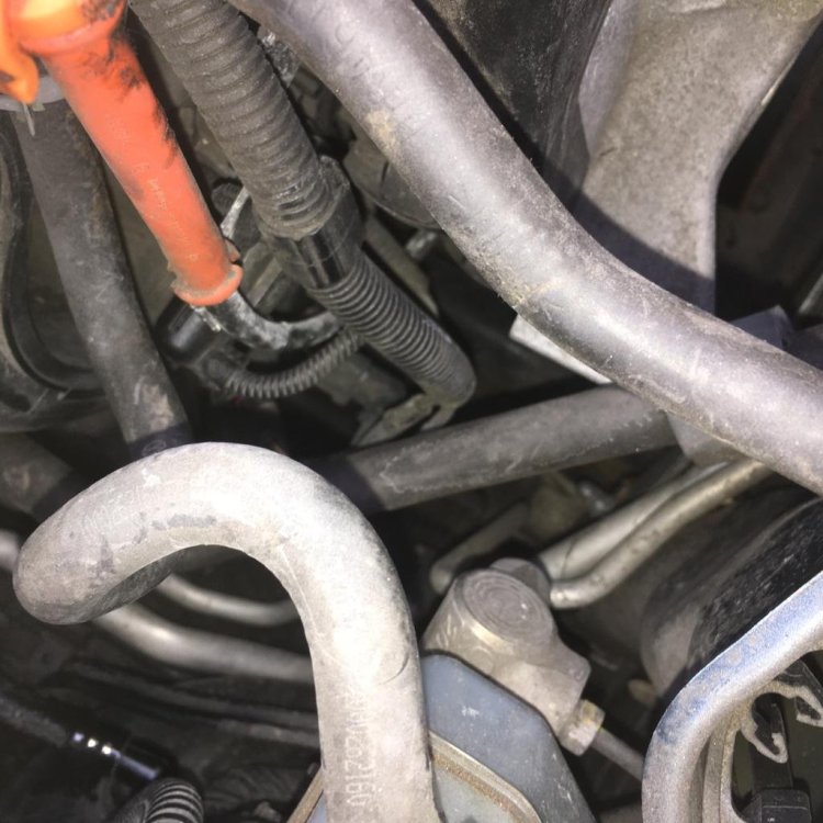

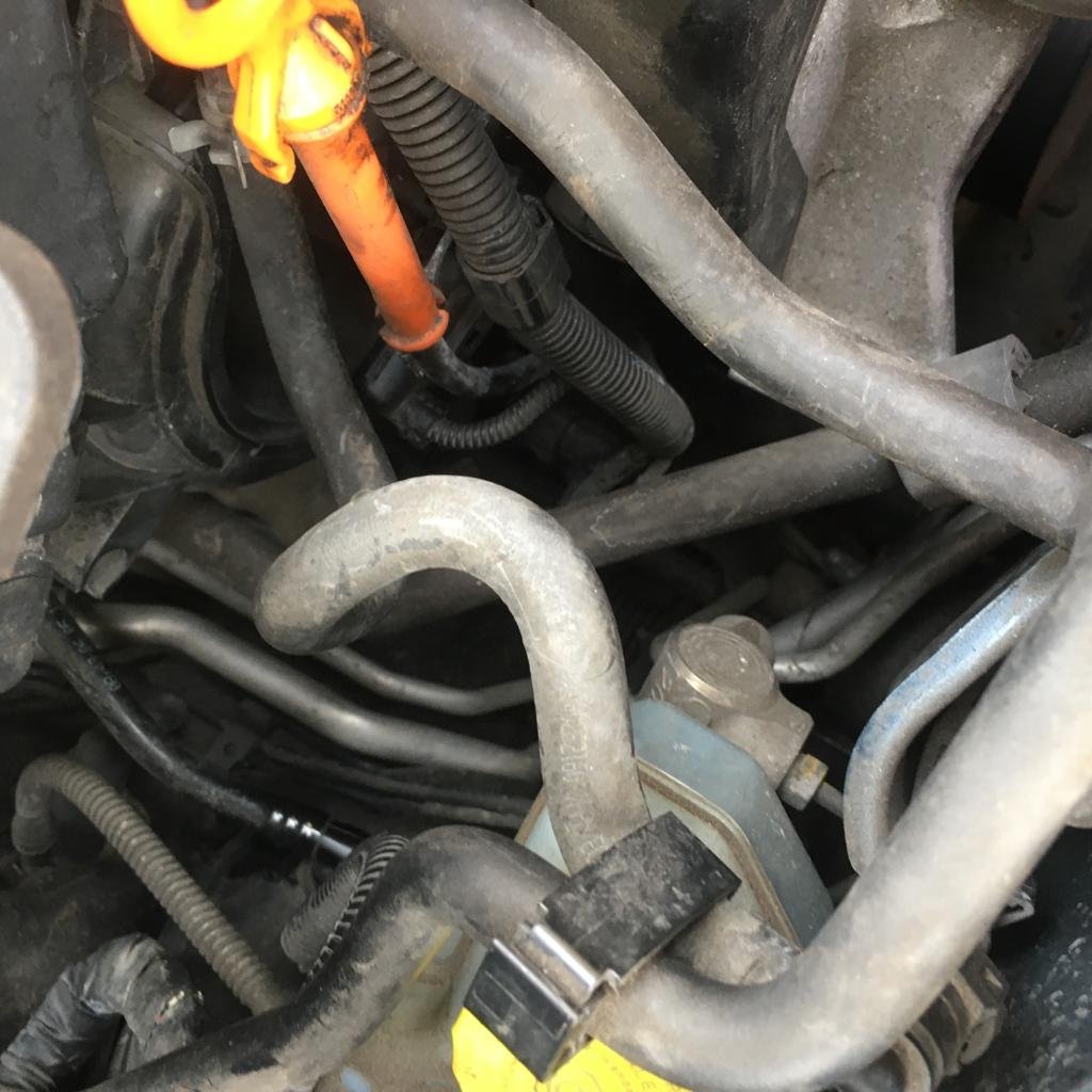

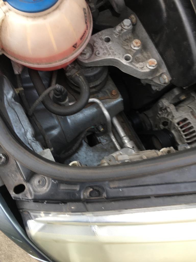

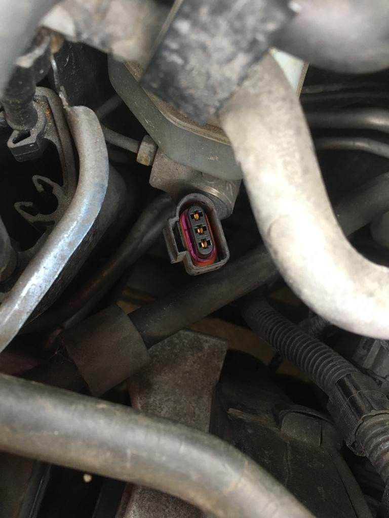

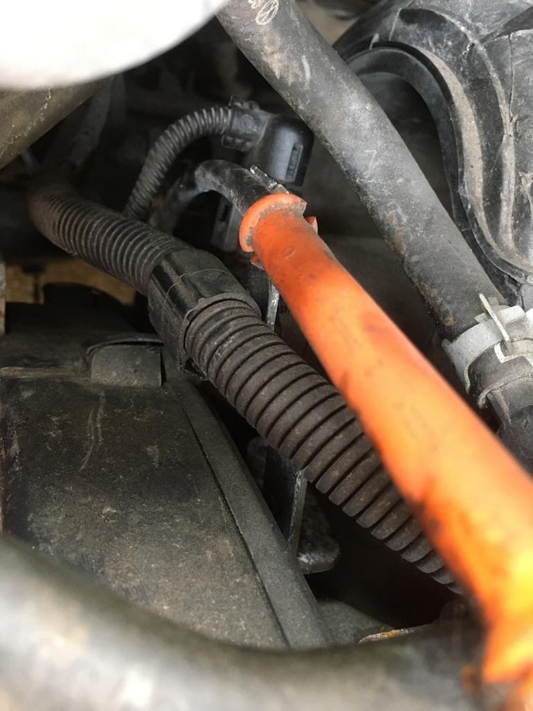

Dear Pete , Much apprecaited for image , mechanic came in just tried to take out MAF sensor without any luck the strip of dipstick is stopping the access for unblock the lock , he tested the car with full accelerator apart from back wet smoke everything seemed fine at low speed it idling is not stable but with full speed black wet smoke is thrown also noticed today that my  coolant had increased the box was near the min level but now it has gone above max level which was weird for me.
I have also tried to pull the sensor but seems lock is not getting released pressure with screw driver is not working as opened few other sensors without any issue as understood  the mechanism. I have scared to drive the car as it would spoil the coil/plugs .

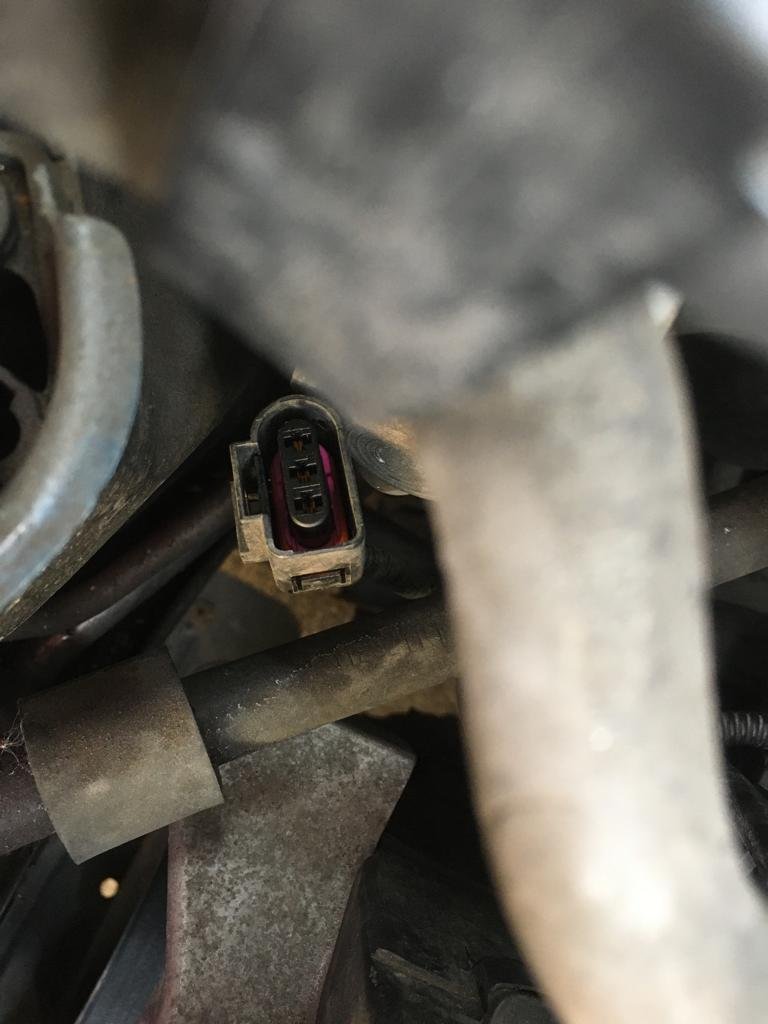

I have found another  sensor ( don't no ) near MAF sensor as show in image was able to open and test the voltage it had 5 & .2 volts has 3 wires tested all with each other with ignition on, but when I removed I saw the car had stability light on ... and it went back when I put back.

Dear All , Pete @sepulchrave@Stewartasb@nta16@J.R.Reall apprecaite your time to share experience and help me , I think these two(MAF&PCV )are  possibly at are positioned at very difficult location would defiantly need technical expertise and necessary tool  to take them out or clean them. (99% mechanics may have technical knowledge but does not have electronics knowledge and no body have patience to test these sensors or electronics , so thinking to change maf and catalytic converter( it was changed when it 60k now 120k) while on ramp would request mechanic to look pcv sensor as well I shall keep my voltmeter in case if he allows me test it and  check values.
Really grateful to you all learned people for sharing knowledge, very delighted that at least I had gained good knowledge about the issue and possibly can share with friends if they ask suggestion that way we can reduce co2 on planet not unnecessary chaning the parts which still may have life in them. Cheers

I'm not sure what that 3-way connector in your pictures is from, maybe knock sensor? That's somewhere under the inlet manifold.

Looks it has two sensor near dipstick - 3 pin and 4 pin( MAP).  map sensor is fully blocked with dispstick steel holder. keep you posted the progress hope it helps others.

Looking at the wiring diagrams I can't see any 3 pin connectors that are in the vicinity of the MAP/IAT sensor, the Knock sensor @Pete_Ex-Wino mentioned is a 2 pin connector, the only other connector I can think of in that area is the 2 pin for the crankcase vent hose heater element ?
