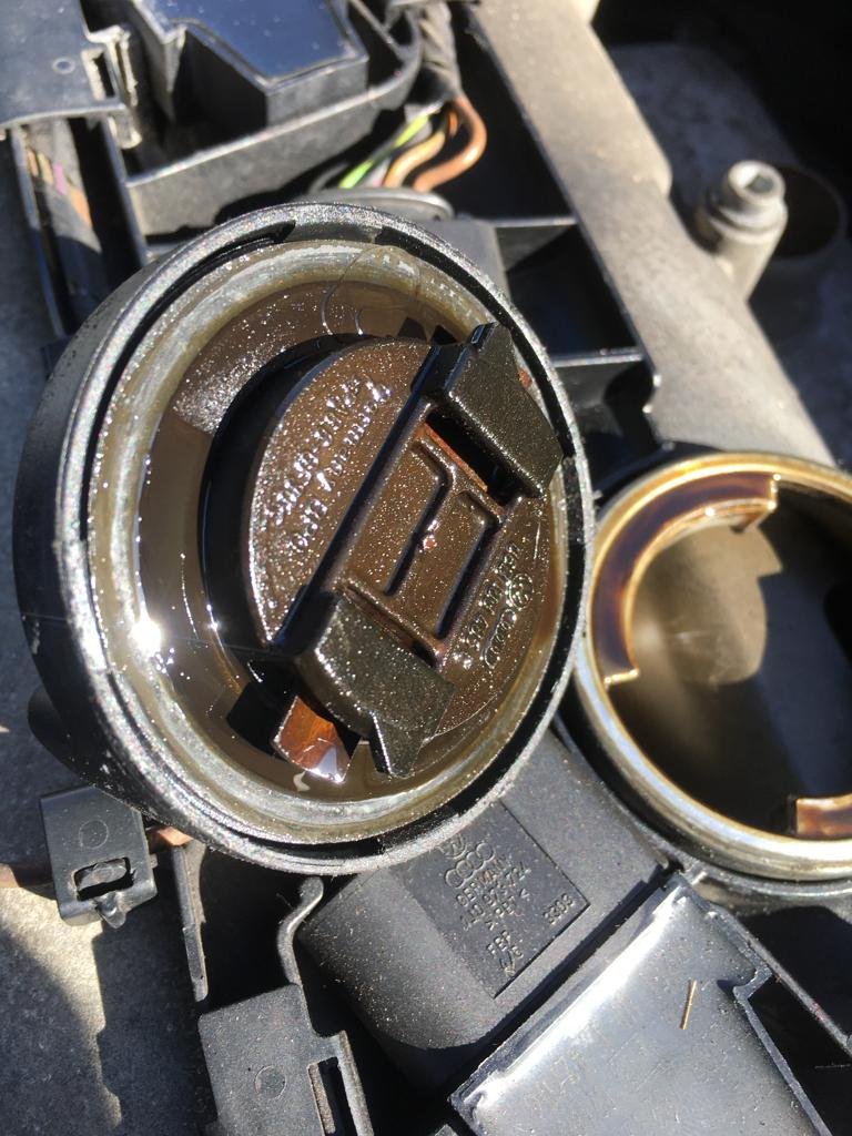

Have you been checking the obvious taking the oil filler cap off to see if any mayo on it and are you noticing a film on top of the coolant as Pete says pop out the plugs and check for coolant it's a quick easy job to tick of the investigation list.
Thanks Stewart , Will Do  tomorrow , coolant colour was pink, I think first day I saw oil cap as well looked to me was fine but will click some photos of it will share it tomorrow.

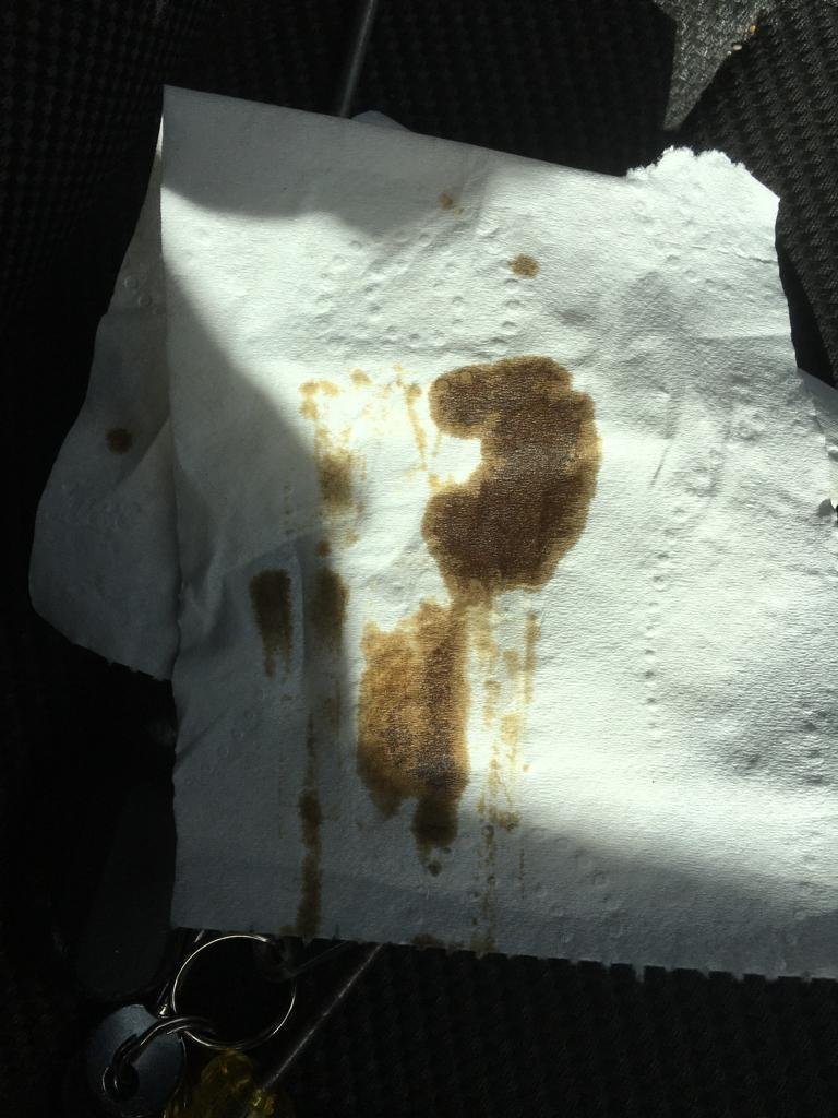

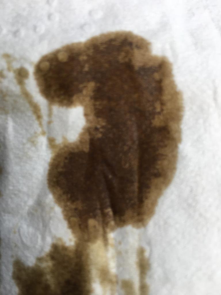

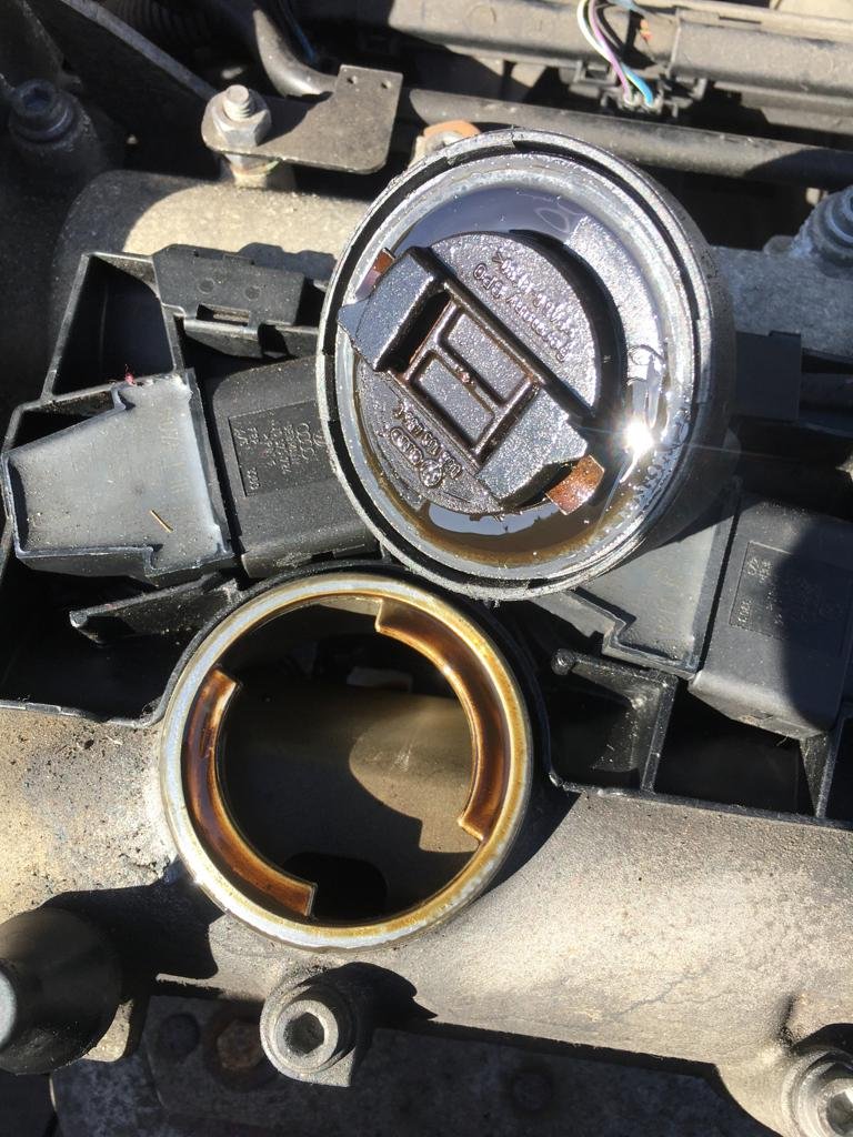

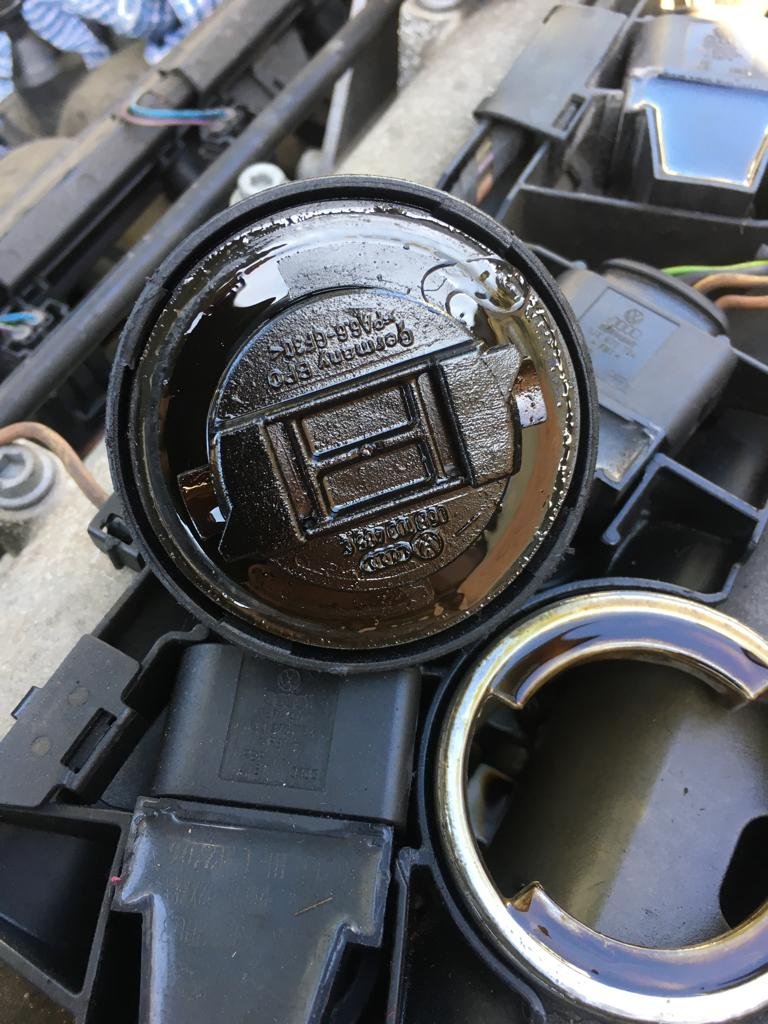

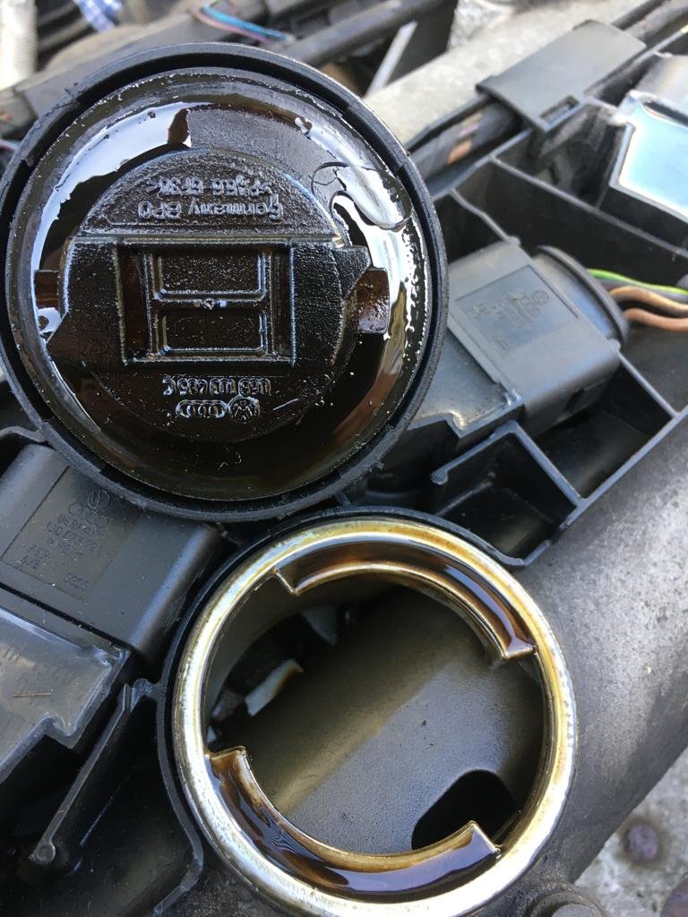

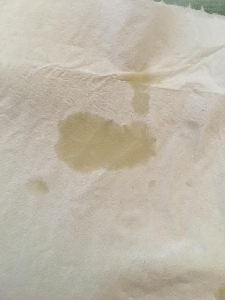

4. clicked photo of engine oil after opening of cap please advice if u something looks bad ( changed oil/air /oil filter march 2021 5-7k miles driven so far)
Next plan probably tomorrow Will  open coils and plugs and see if there is anything  in it.
If anybody can advice of the engine oil health based on photo on tissue paper .
 have also taken photo with unused fresh  engine oil on tissue paper as attached for ur info.
thanks advance for all help and support.
Based on the photos, to me, as not even at the level of an arse-scratching mechanic, and certainly not an expert in anything, they look fine.

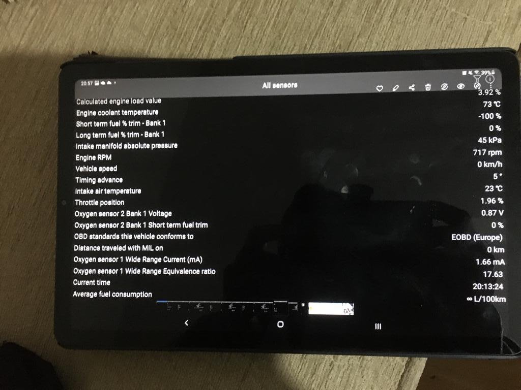

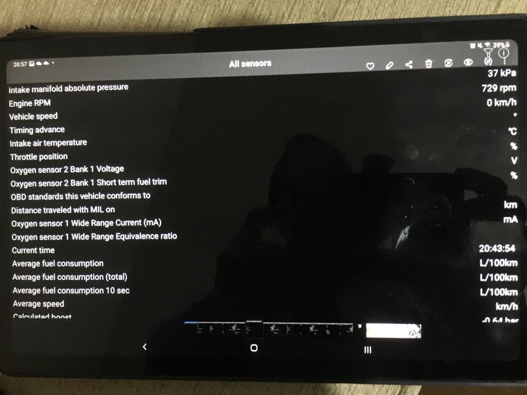

Thought to share Elm app Torque Lite (OBD2 & Car) was able to clear all errors there was no error but started car for 1 minute car had shaky idling so switched off immediately , let see what happens after battery disconnect for few hours I shall keep it full night and discontinue my research and look for specialist.
Once again much appreciated each one of you for their time and support  to share their knowledge .

Sorry I've no idea what ELM app Torque Lite (OBD2 & Car) can and cannot see, whatever scan tool clearing a code is not the same necessarily as sorting the issue and just because no codes are showing does not mean the car is fine and running well, do not put all your reliance on these magic numbers and the machines that show them.  All these things are mainly computer programs, now think about it how often do computer programs need repairing themselves, then there is how good the program is anyway and how reliable the information it receives, particularly from cheap unreliable sensors, or car systems with electrical or communication wiring/connector faults.  Put all your eggs in one basket and you have scratchy omelettes.
It would be interesting to connect up three or four of these machines and Apps, update all and compare the figures they give from a car that's not running well, allowing for variations in when they are plugged in and the car's and other variations of back to back comparisons they should all show about the same but would they.
