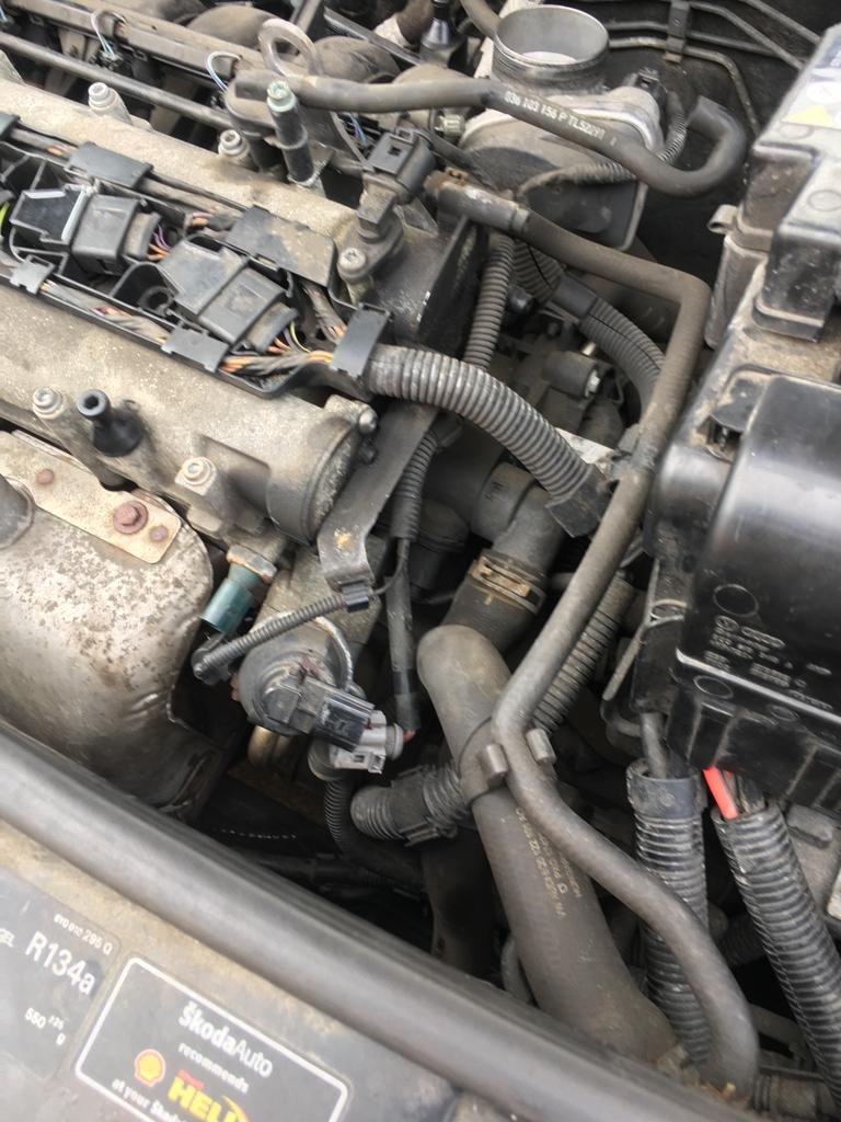

    BBZ engine MAP sensor and PCV valve positions shown with red and blue arrows respectively:

    Unless they're disconnected 😄

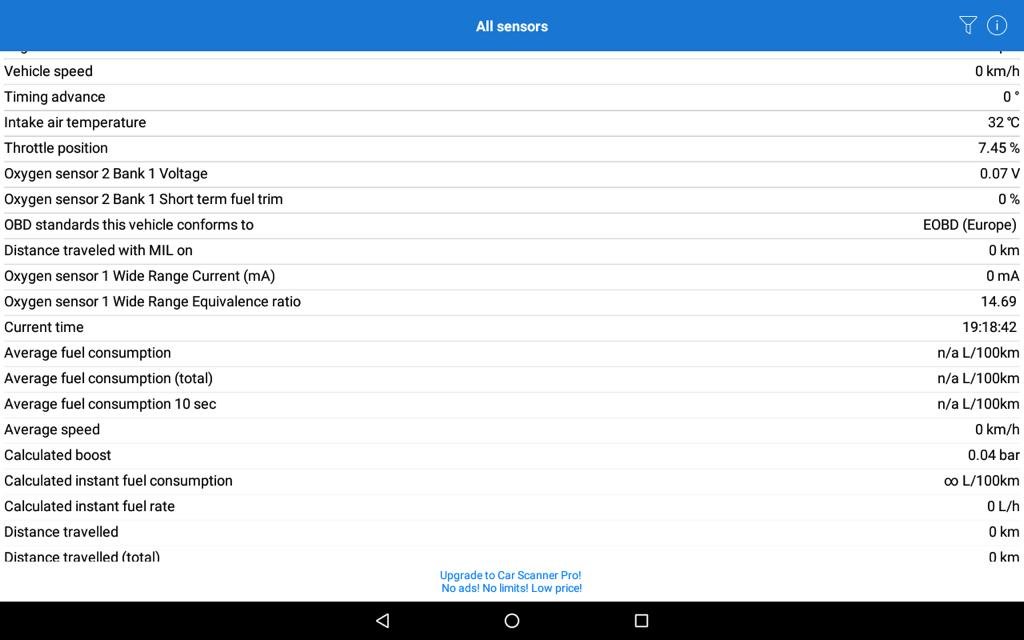

Hi Experts , I am keen to do below tests and  not in rush but don't want  garages to beat around the bush and keep changing unnecessary parts. Can any body please had done similar tests and share digram/utube links  or experiences if it can be possible even , I can use multimeter and have basic tools as well,  apologies if it is big list please
Tests:  (Car Skoda Fabia mk1 2007 )   - intermittent P0171, bad idling , black smoke again , power loss ,( Mechanic informed no piston/gasket/rings issue after high rev for good few minutes and using sophisticated scanner )
  • Checking fuel pressure. (How much psi,  which pipe needs to be connected with gauge digram/utube link if any please
  • leaking fuel injector check ( how to open them tools needed, saw video if we they are leaking we can see them after opening them and switching on the ignition?)
  • purge valve (how to open purge value , I think I know how to check it check it .. saw some videos)
  • fuel pressure regulator – (Shall I change pressure regulator?? )
  • fuel filter – ( will take professional help for this definitely cannot do myself )
  • oxygen sensor –do I change again  ( just changed few months lemark sensor, 2nd sensor  in 2 years - bank1- ebay bought, bank2 was also chnaged 3-4 years bought from euro parts )
  • coolant temperature sensor - Dashboard value seems fine( reckon no issue)
  • air intake temperature sensors – changed already  ( MAF sensor )
  • vacuum leak - smoke test ( which pipe to connect for pushing smoke in the system)
  • check pcv valve ( do u think changing ?)
  • Check Exhaust System for Leaks. ( how to check )
  • Check Secondary Air System for Leaks. ( how to check)
  • changing spark plugs ( ur views ,chnaged few months 4-5k driven)
  • Cleaned throttle body wasn't dirty but after pressing flap it was little black ( used recommended spray)
  • Any test to remove o2 sensor to rule out  any o2 sensor  issue,  I can disconnect the bank 1 lambada sensor and understand the behaviour of car any approach please???
  • Changing park coils ( changed number 2 spark coils 4-5 months when car was misfiring but no misfiring at the moment)
Thanks for reading please.
Kind Regards
raky
Ok, dash reading for correct engine temperature is meaningless, change the ECT, it's cheap and easy to do.
YOUR CAR DOES NOT HAVE A MAF!!!!111ONE
MAP sensor will be fine.
All the other guff is a all waste of time, the car is overfuelling, it can only be the ECT or the pre-cat Lambda probe causing it realistically.
Disconnect the ECT completely and see if it runs any better.
Much appreciated  @sepulchrave for your time to offer help ,  thanks for coming quickly please, Your approach makes senses thats why engine fan is not working possible ECT is not sensing heat in it so not triggering fan to kick off.    Sorry I meant MAP only  don't know correct name , apologies for that , attempted to disconnect ECT after disconnecting few other sensors to make some room , but no room to reach to ECT as the removal clips are   downwards & unreachable   assessed the situation and it seems  unless I remove radiator  coolant pipe which seems filled with coolant , ECT cannot be disconnected , Any thought please ??? I can take challenge of emptying the coolant and even remove the pipe if needed please,  appreciated for your time and help.    Thanks Kind regards

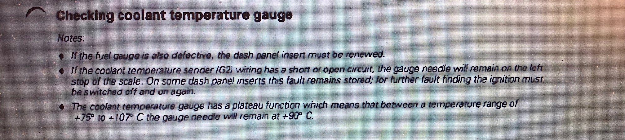

The gauge reads 90c for an actual coolant temp between 75~105c
I'm not disputing this just interested to know where you found this info.
I was 2c out in my original comment but that was just going off a failing memory, the pic below is from ElsaWin a copy of the stealers workshop manuals

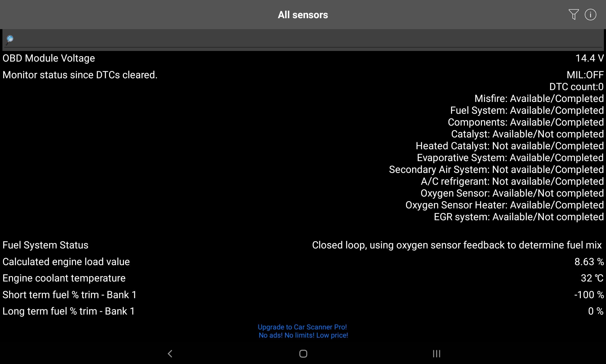

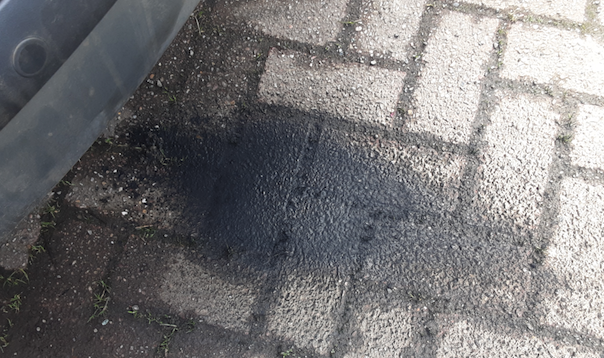

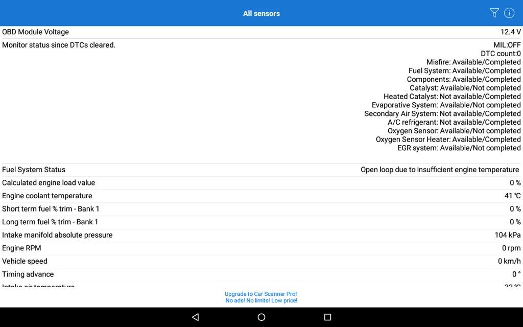

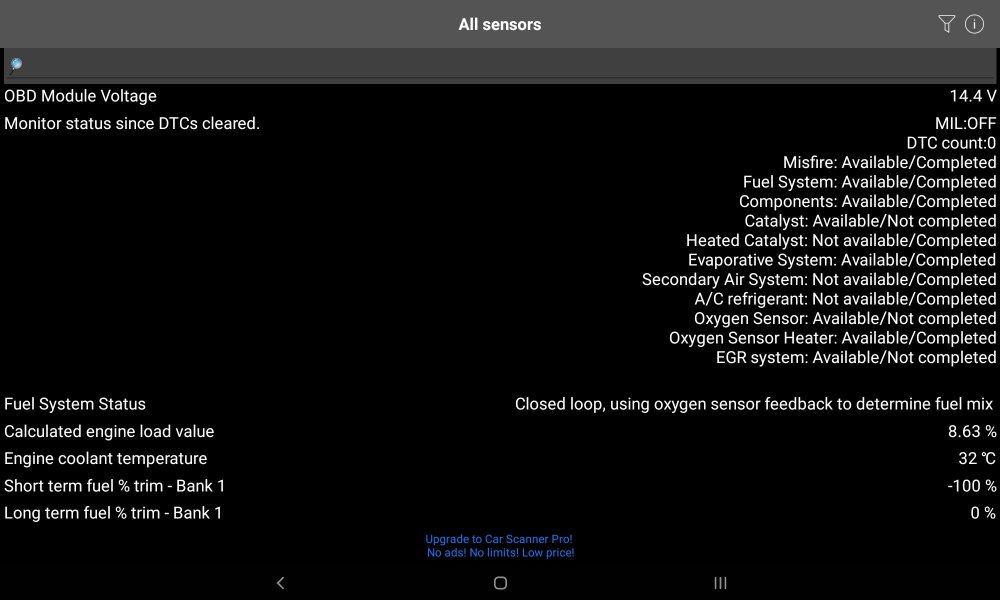

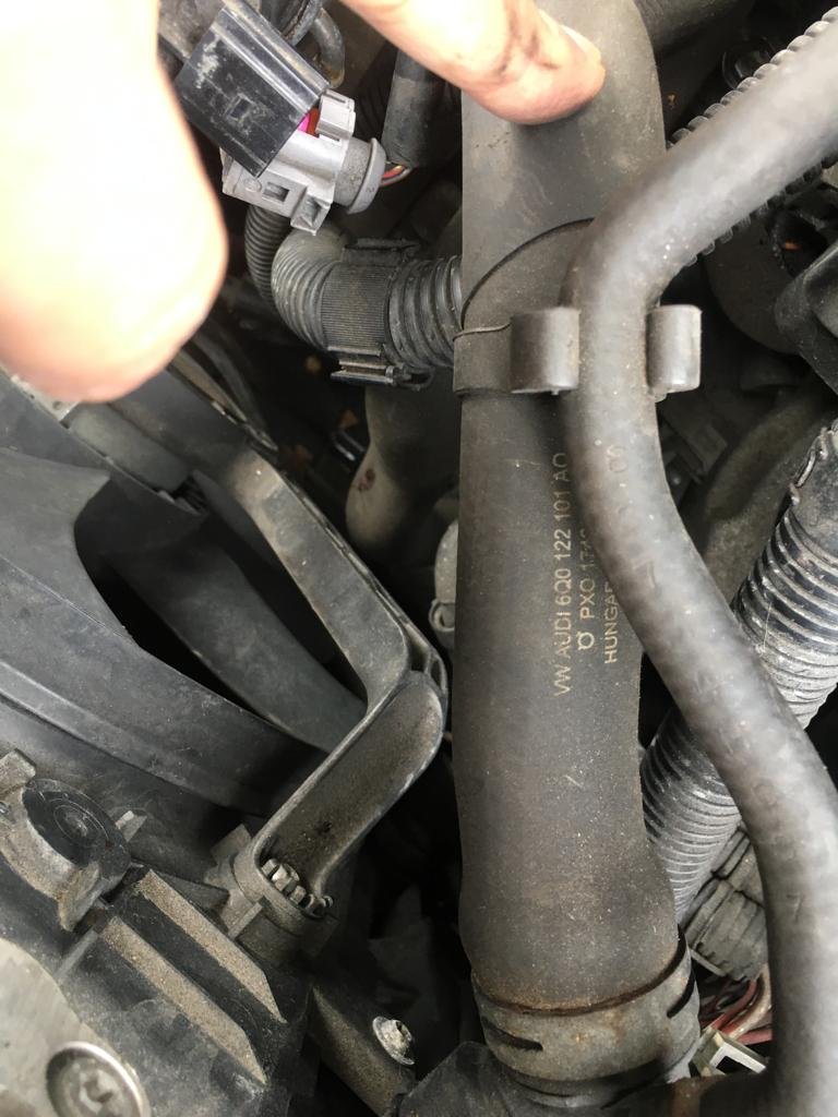

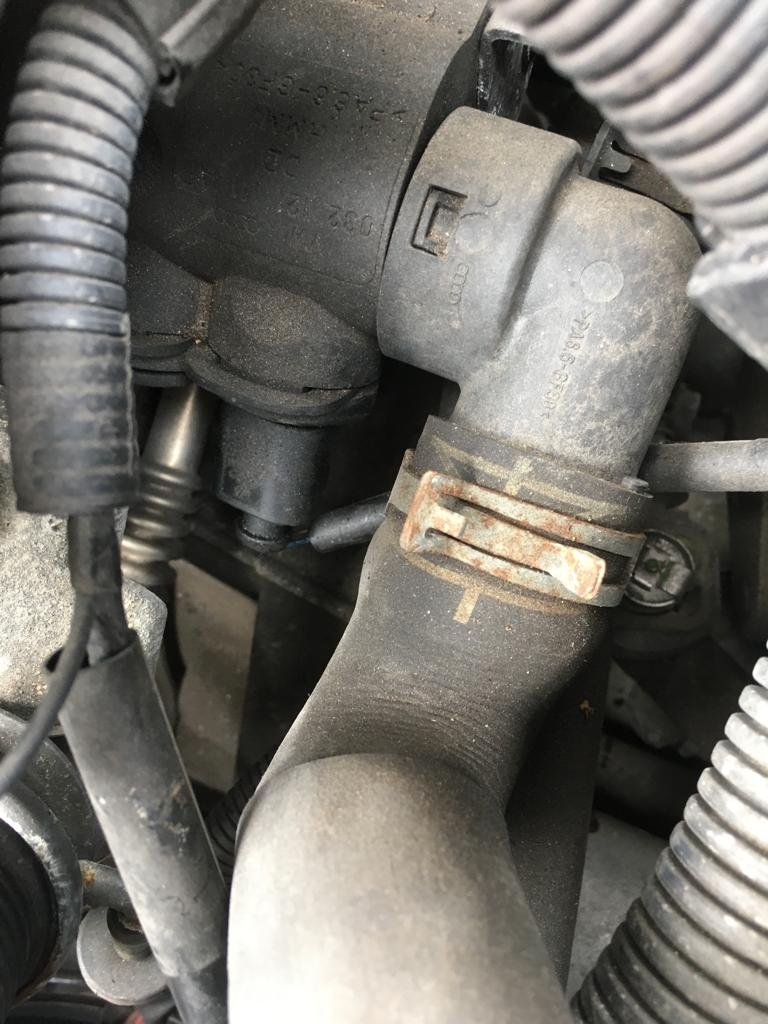

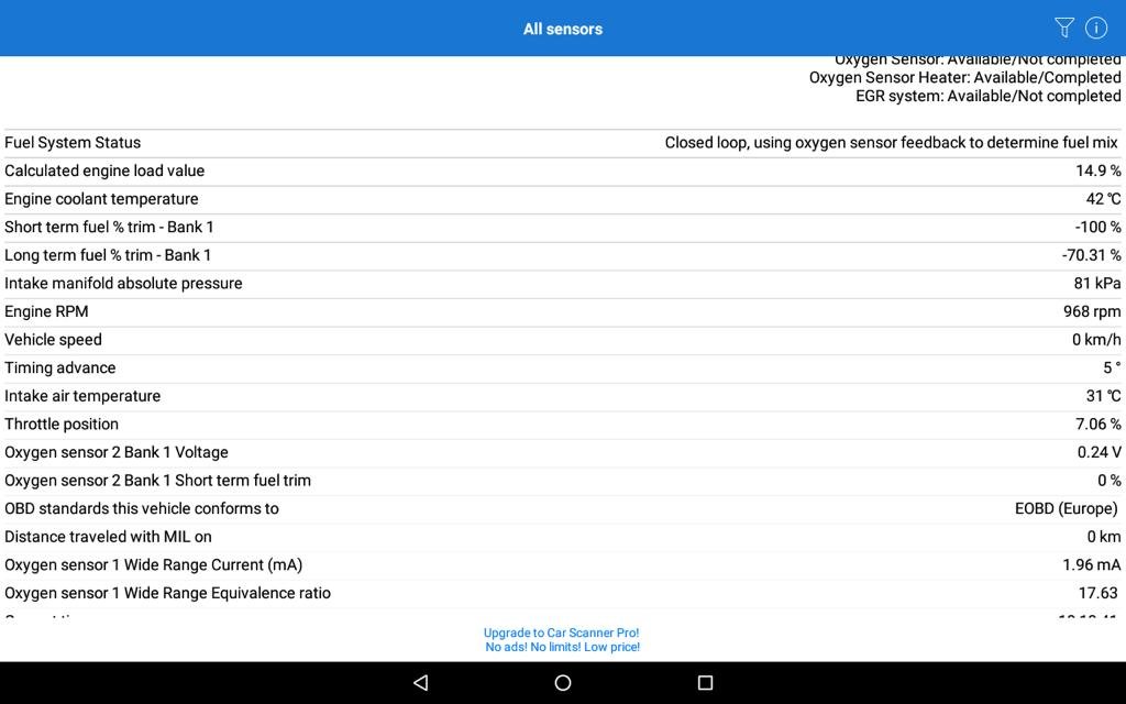

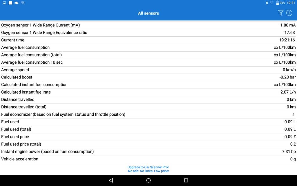

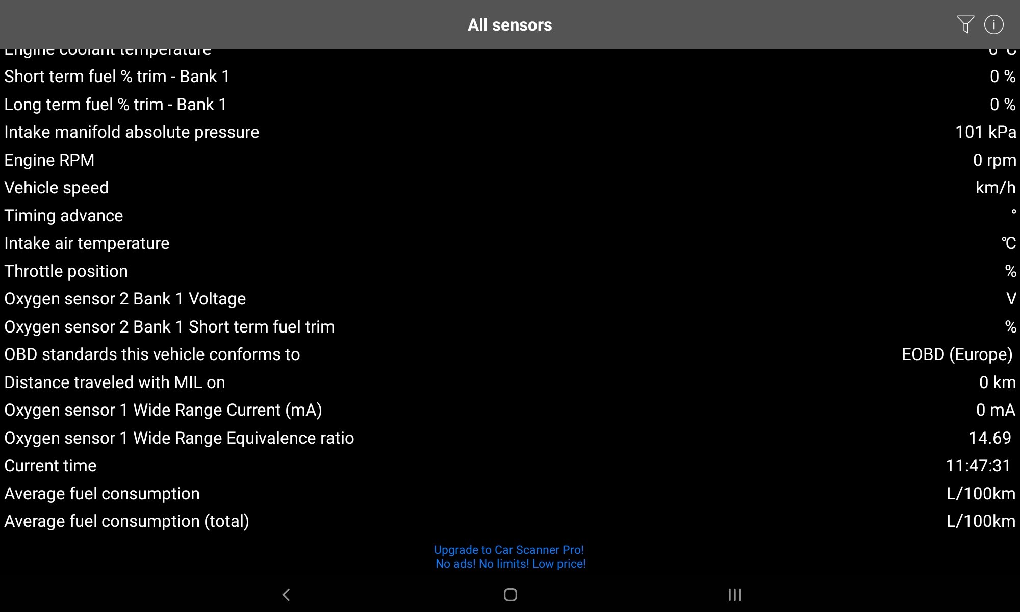

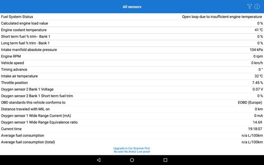

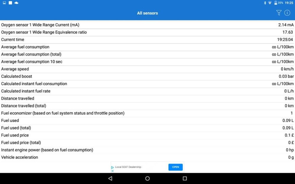

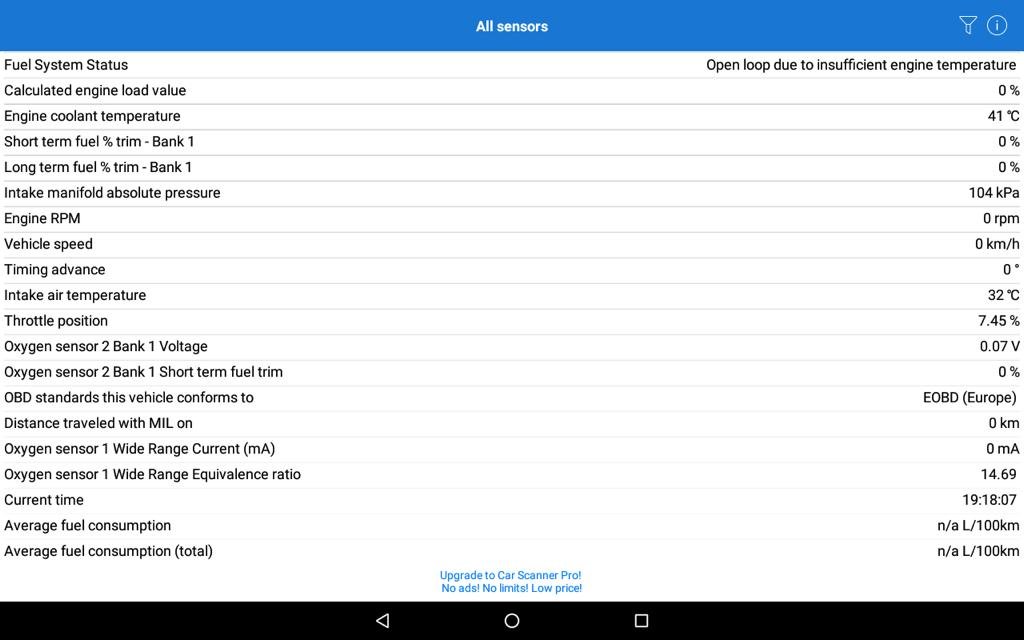

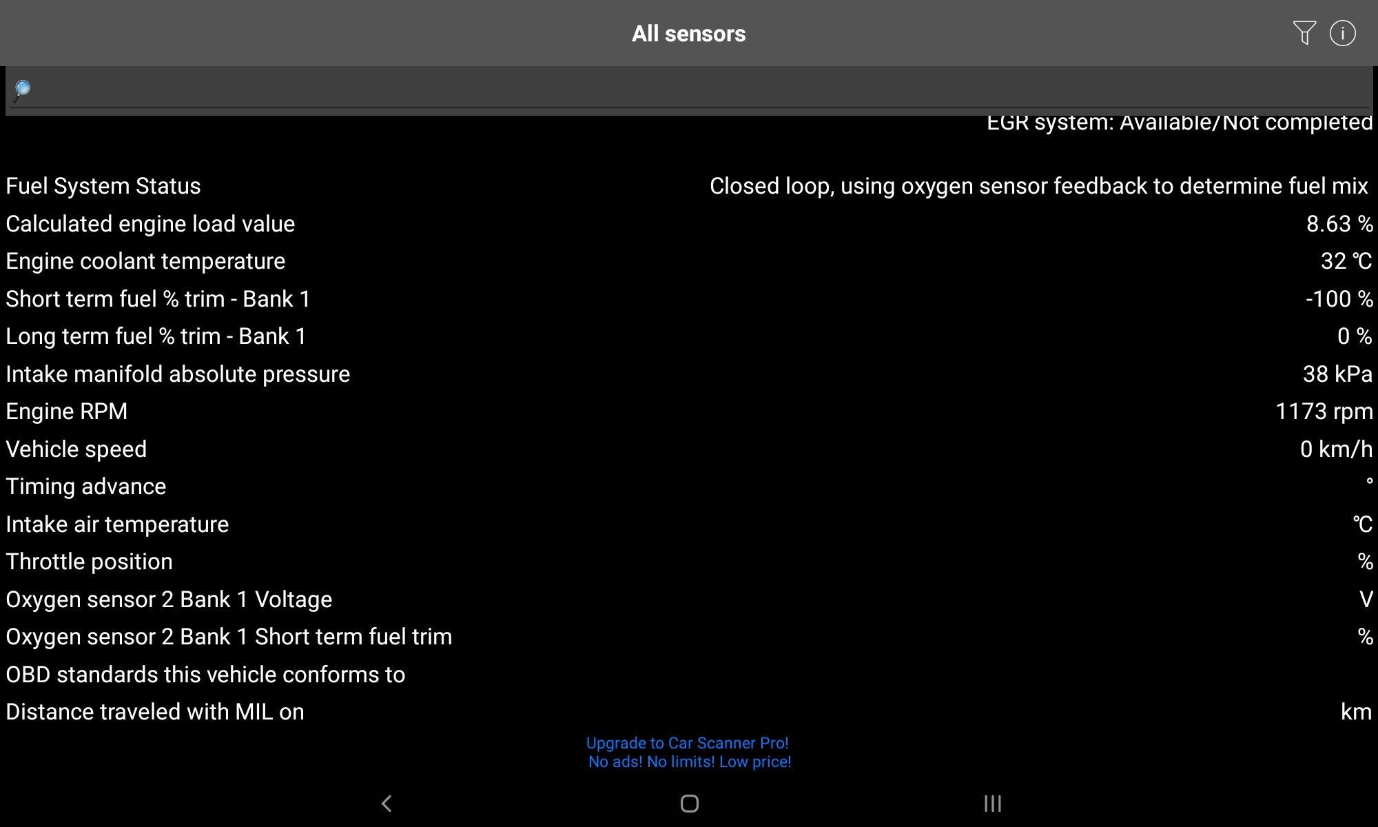

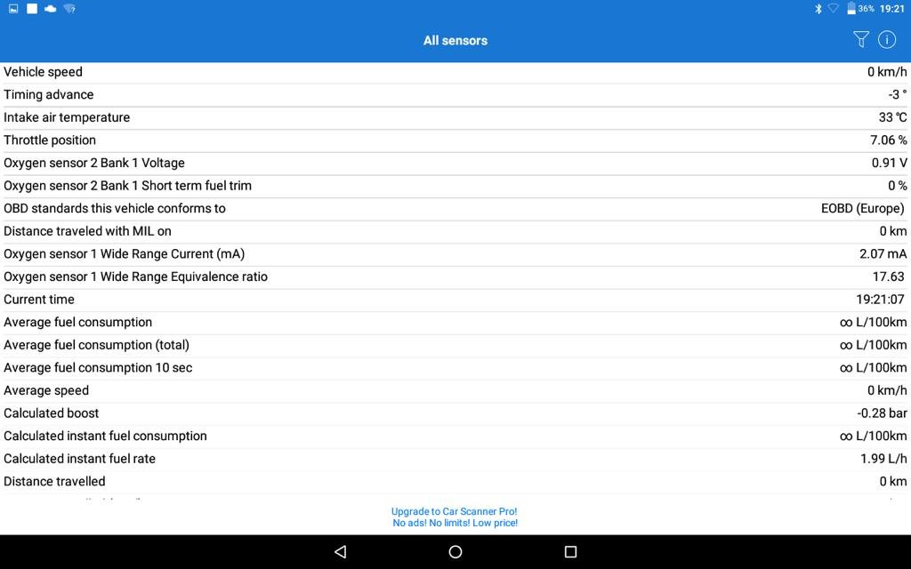

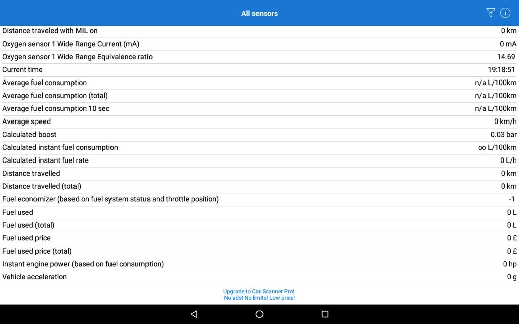

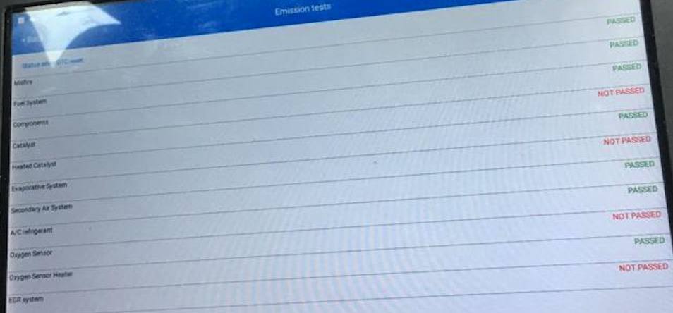

HI Experts, Thanks all for taking their time to share knowledge and experience which is also encouraging me to share progress about my car , Around 5 years ago, my temperature bar was not moving and temperature sensor was faulty so I think if temperature sensor will not move on dashboard if it is faulty.
 Anyway I had visit to 4th garage today unfortunately again without any luck , I have seen some wires bundle  wet after rains, seems rainwater from roof is not draining properly from outlet pipes may be sipping in wiring. Need to sort out that once car is back.
Today  Car driven for 2 miles to garage  without any issue but lot of wet watery smoke, it was quick cold start.  Of course still Radiator fan is not starting and Coolant is expanding at least 2to 4cm  in coolant tank.
Th scan result from this garage was 1 Air Con ( form long time I knew it was there , it never bothered me as I don't use air conditioning )  error and P0171 still exists. Just noticed behaviour when I disconnect the battery for a while &  car runs smooth  without any issue for few good miles but with black wet smoke. Today brought home car  from garage with great difficulty  since mechanic had tasted  the car and engine was hot , it  was getting switched off frequently  when foot was removed from gas , was not allowing any idelining  at all.  Again late evening started again when engine was cold same idliining issue. Now possible disconnect the battery and see wht happens.

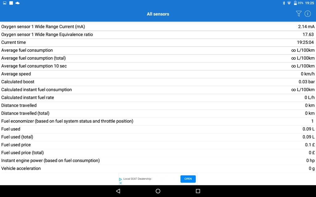

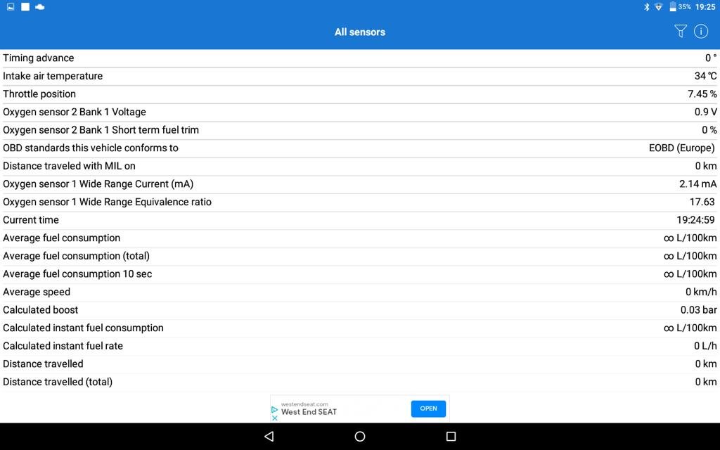

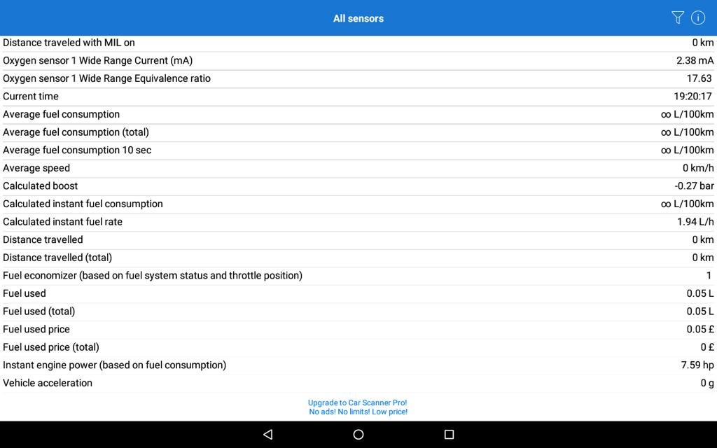

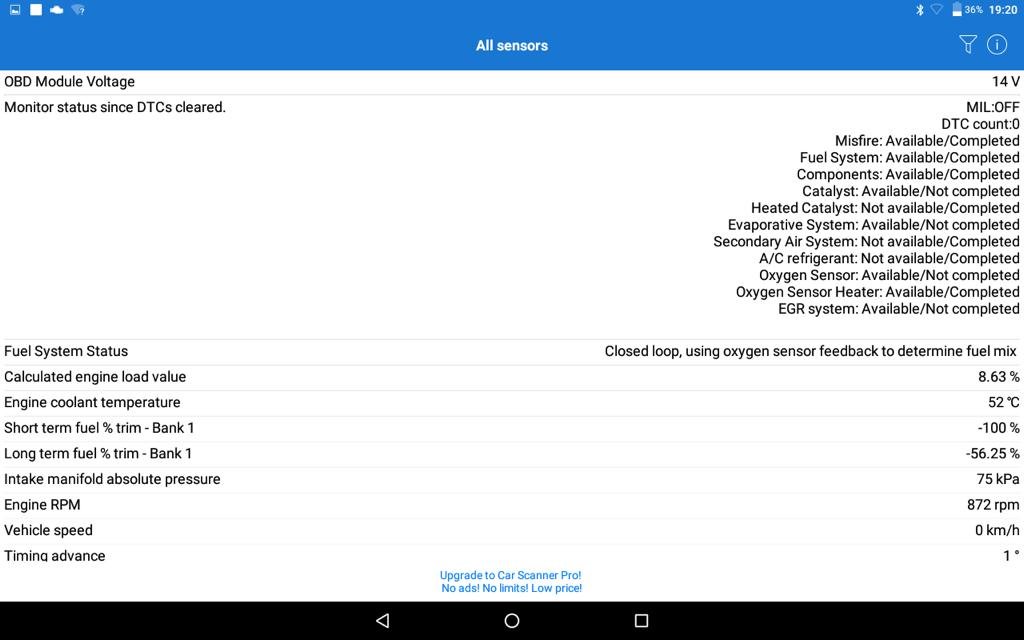

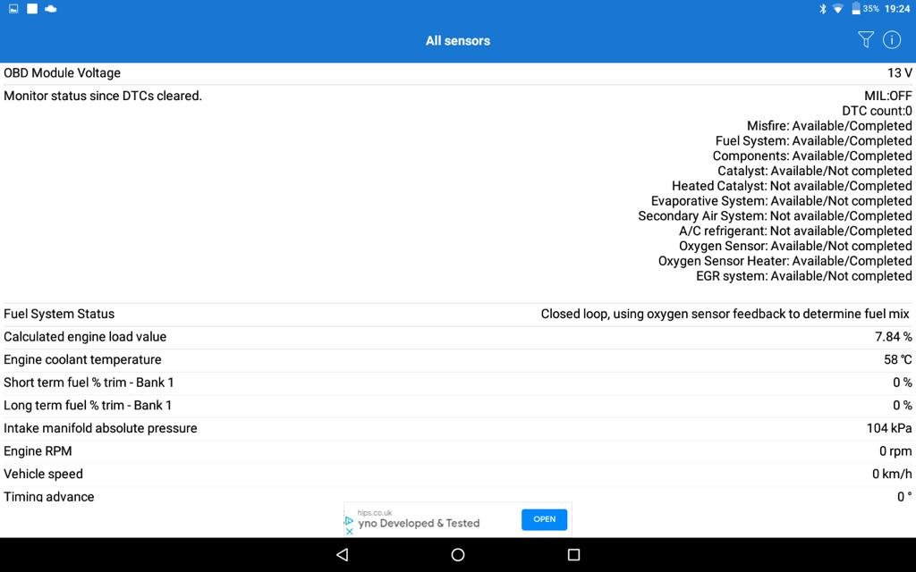

Today I have used different scanner app/version and found some more info which are different from last time - short term fuel trims and long term fuel trims are both negative for todays scan also noticed crank timing was -3 degree and 1 degree after starting the car it was zero in past ,  there was also extra info I got which was very surprising to see the systems checks
- 1. Catalyst - Not passed, Evaporation System - Not passed EGR System -Not Passed , Oxygen Sensor -Not Passed .
I will keep u posted , I would disconnect battery and see if I can drive another 5 miles for different known garage again as they  have smoke test machine , if this garage  fails then I have final option to use 1 expert who charges huge but expert in this field got reference from few garages , Mostly mechanics are thinking that Manifold sensor may be of poor quality, I have bought it from euro parts of £60 GBP. Euro Sensor was made by HAAS Company , I have checked original sensor from skoda and it is £103, worst case scenario I shall replace again with new one or even try cleaning the old one and fit it & see. wht happens.  (Any idea if I can test these sensors out side car artificially please???)
Read experts views in this  forum  ,  look there is some connection of cold & warm engine behaviour once it goes bad then it remembers and messes later , but if battery is removed it resets the ecu and possibly goes smooth for few miles of course with bad wet smoke.  here are some screen attached idle and running , any idea if manifold pressure values are making sense??? , I have also noticed today that shrt term fuel /long term fuel both were negative past scan had  only short term fuel negative ..
 High mileage car possibly need below listed checked as per service manual  -
- Get regular checked all sensors ,
- Get rainwater outlet pipes cleaned ,
- Cam/fan belt change on proper time /mileage
- Change clutch plate on time/milage
-Regularly get checked engine piston/rings health
- Normal serve of engine oil oil/air filters change it at least once in  year.
cheers
raky
Edited by raky
As has already been said, the temp gauge can still show normal readings on the dash even though the CTS has drifted out of spec enough to affect running. They are relatively cheap and the same on all Mk1 Fabias (06A 919 501A), so why not just rule it out? If the one you fitted five years ago wasn't genuine it could be defective.
Edited by TMB
15 minutes ago, TMB said:
As has already been said, the temp gauge can still show normal readings on the dash even though the CTS has drifted out of spec enough to affect running. They are relatively cheap and the same on all Mk1 Fabias (06A 919 501A), so why not just rule it out? If the one you fitted a few years ago wasn't genuine it could be defective.
Ok , Much appreciated Lee, I think that makes perfect  sense as radiator fan is also not working and coolant level is going up when it is heated but it was warm when I opened and checked it, let me please try to change asap as I have Wednesday appointment for smoke test , would have been easy at home  smoke tester DIY but difficult to make had partial success but not fully & gave up ( want to drive car minimum, as rich fuel may be hurting engine ) , I want to buy all original sensors from skoda, as they should have longer life with guarantee but time being I shall buy from euro parts and use it.
