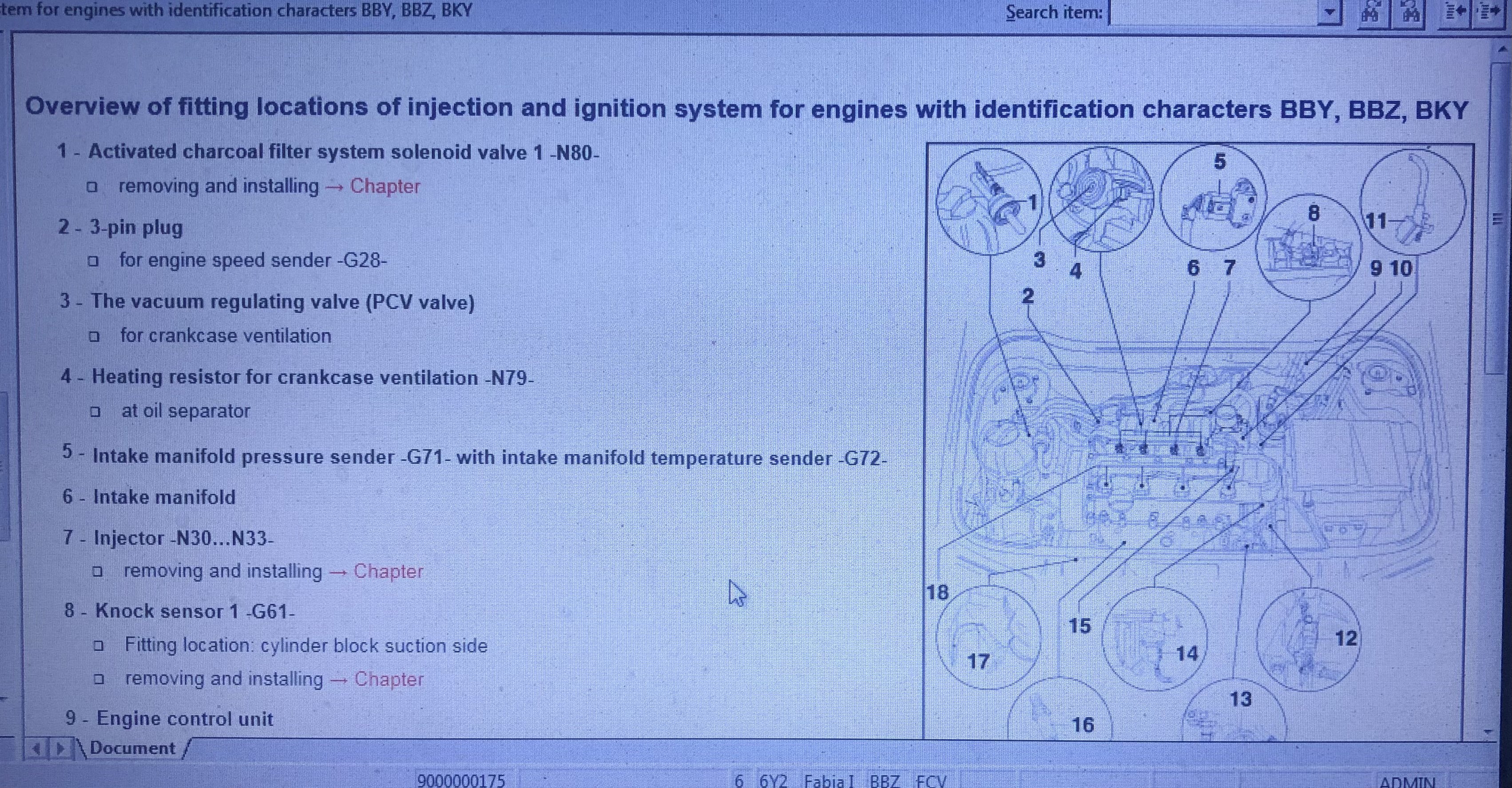

    BBZ engine MAP sensor and PCV valve positions shown with red and blue arrows respectively:

Crank sensor and connector for (dummy) vehicle speed sensor on differential are both 3-pin, I think, and on that leg of the engine loom.

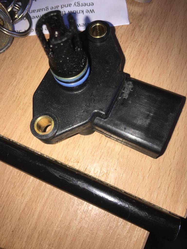

Well party has just started... luckily removed the sensor with very small computer screwdriver  which was quite dirty with its age , was able to fix the new one but now previous two code vanished but new codes had come P0322 P0107 P0113 don't understand why these things happened not sure while testing with multimeter or without removing battery and fixing the sensor had messed up don't know...
End up in big time trouble ,  had app which cleared the code , the idling is VERy unstable  and I also don't see temp is moving though can see water coming out of exhaust but not serious carbon as it had yesterday ...
Finding electric expert would be very hard any thoughts are just keep chaining sensors one by one please.  Just surprised my window motor started working possible due to new battery or something else do know,
Experts any thoughts please ?? please find photo of attached MAP sensor
Cheers

Is there maybe a long captive lead on the BBZ crank sensor that means the plug/socket is up near the MAP sensor??
Seems the G28 sensor does terminate in the dipstick area #2 in the picture

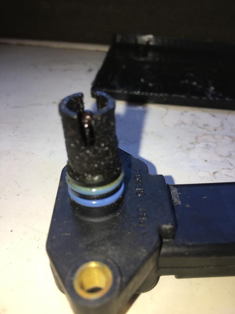

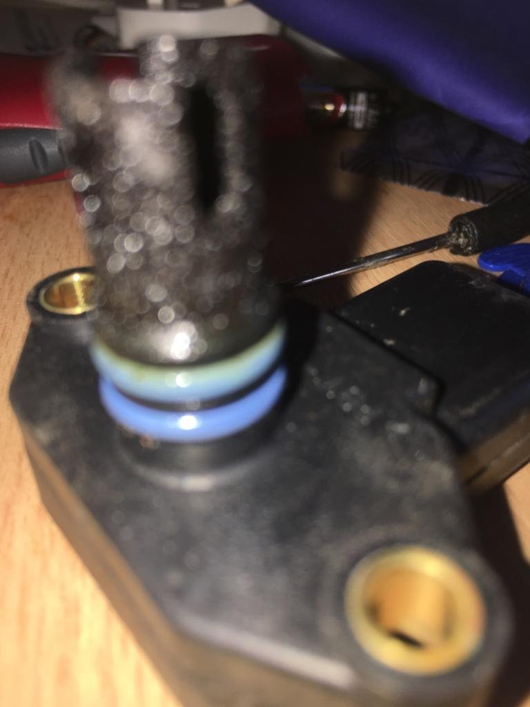

Stop blaming sensors and stop unplugging them.
Map sensor and intake air temperature sensor are in the same housing. In fact, the small bead that is just visible in your photos of the MAP sensor is actually the IAT sensor. This is why unplugging the 4-way connector from the MAP caused two new fault codes P0107 P0113.
The other P0322 came from unplugging the crank sensor, the 3-way connector.
See what's going on with your engine coolant first.
