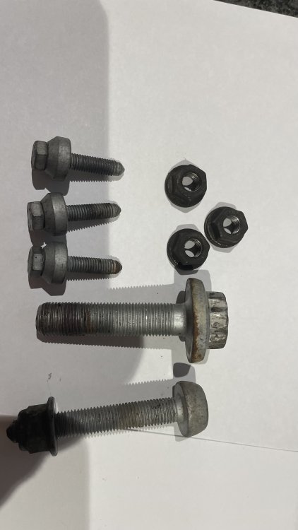

My pleasure Sir. These are the bolts I was given to play with
@Sossages  Were you assuming that an After sales Manager, Area Warranty Manager or even a Workshop manager would be a trained or qualified technician?
That would be an error.
Thanks for the pic, at least I know what they look like now & what to expect. I will try & source some tomorrow & it could turn out to be a good Friday for me.
