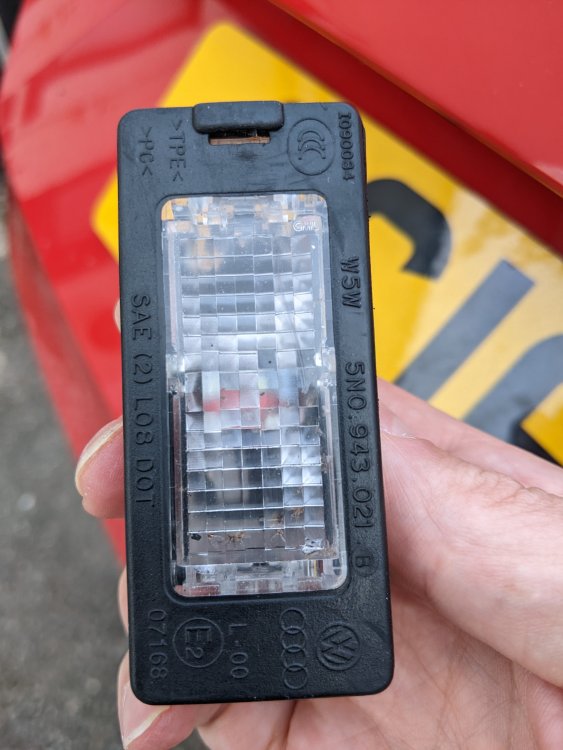

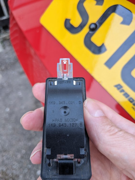

I need to replace one of my number plate bulb holders due to a corrosion issue. On checking the existing part numbers I get the following numbers from the unit. Can anyone tell me if these are different parts and need to be ordered independently or if I buy one of them I get the whole unit? Pics on sites like skoda-shop and Horton's are not that clear. I've attached a couple of photos of the part in question. Also need to recode for LEDs, but I notice there are some great guides on here for that 👌🏻😁.
5N0943021B
1K9943021D
1K9943127B

5N0943021B 1K9943021D will be what's fitted.  The two part numbers just written are interchangeable as VAG share parts amongst the group.
They should be £17.12 inc VAT at official prices, and they take a bog standard W5W bulb.
I guess you were talking about adding your own LED's, for W5W bulb type?
Choice number 2 is to go directly to LED, and have the advantage of these that are build for the task, they fire down the beam nicely onto the plate.
Either solution would both need coding to the car, and save you faffing about with so called CANbus friend W5W LED bulbs
Google 3AF 943 021 A (may have to remove the spaces) and see what better prices you can get.

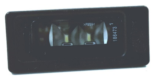

EDIT: If you check this link out, it does show this line of text - "LED lighting for your number plate as a replacement only for the 5N0 943 021 B"
And they label the part number as 000 052 110 - this is another label for the LED units.
https://www.skoda-parts.com/spare-part/000052110-led-number-plate-lights-25075.html

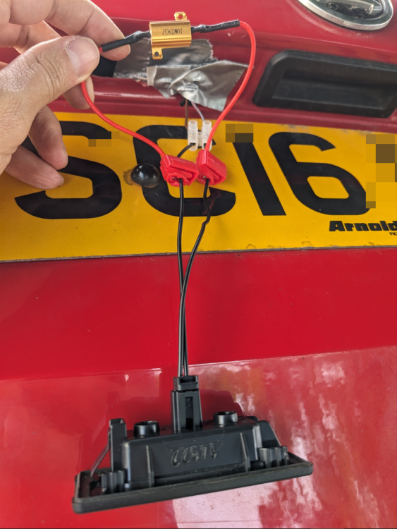

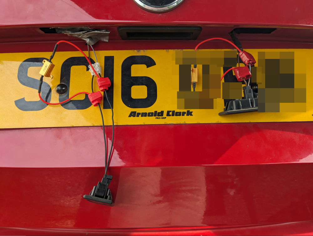

Wow, almost a year has passed and I finally got round to fixing my number plate LEDs.  Bought a set of the Skoda original 000 052 110 units from Ebay for £20 in May and retrofitted them this afternoon.  Everything works perfectly and no VAG error 😁.  However rather than recode them (might be a mistake!) I went down the "resistors in parallel" road as I needed to do a little wiring anyway due to the hatchet job Arnold Clark had made of one of my original units.  Question is, I'm now very aware of the heat these resistors can produce and you're supposed to screw them to the internal bodywork away from anything 'meltable'.
Does anyone know where and how they could be attached to, or know an alternative solution? Idiot I am should have thought about that and done a wee trip to Nairn instead @fabdavrav .  I've attached some pics of the wiring used, but getting a picture of the internals was nigh on impossible.  Easier to take the rear door internal trim off as if I was accessing the wiper motor to screw them I'm guessing?
