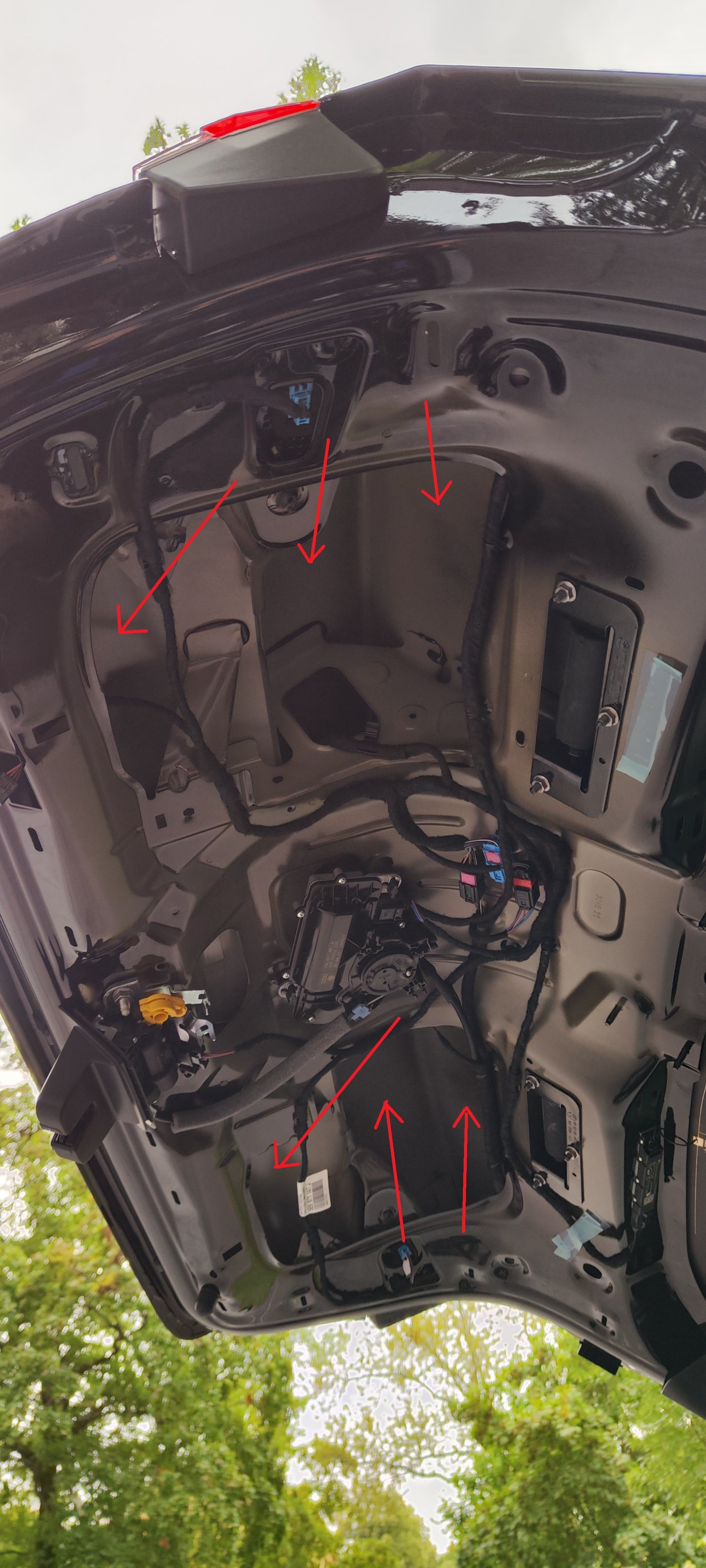

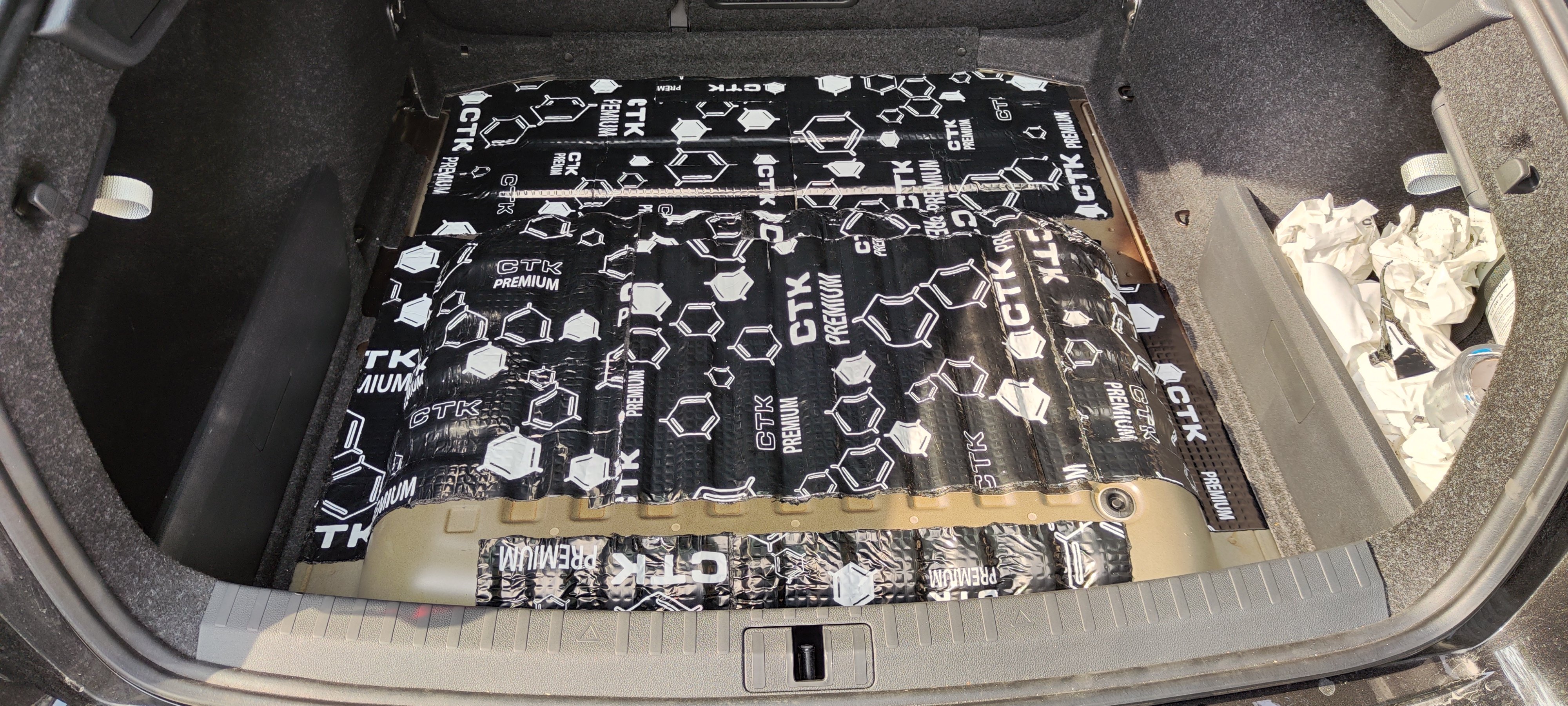

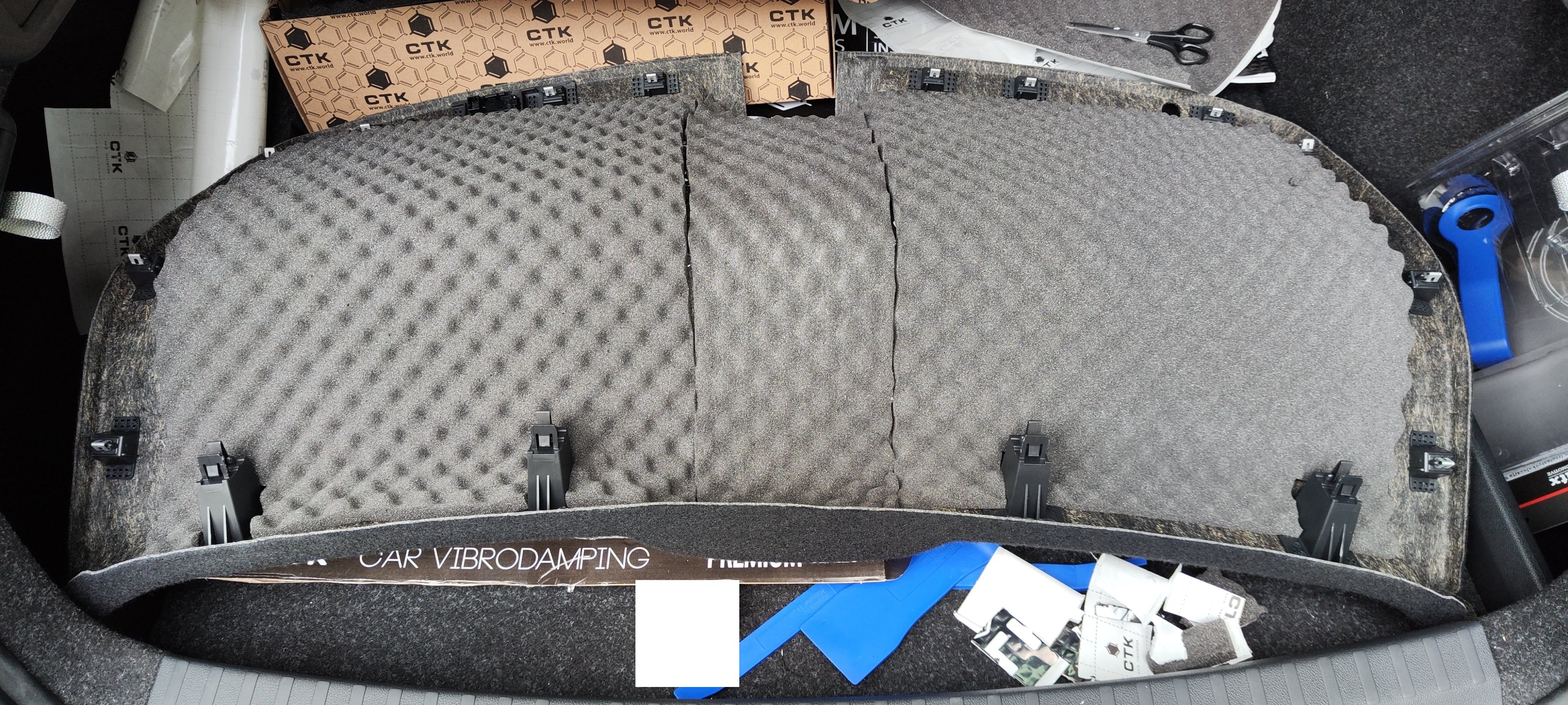

    Will start doing the doors soon. Today I did the boot lid. Added butyl mats in the cavities with a lot of flat surfaces. The trim got some butyl mats and acoustic foam on top.

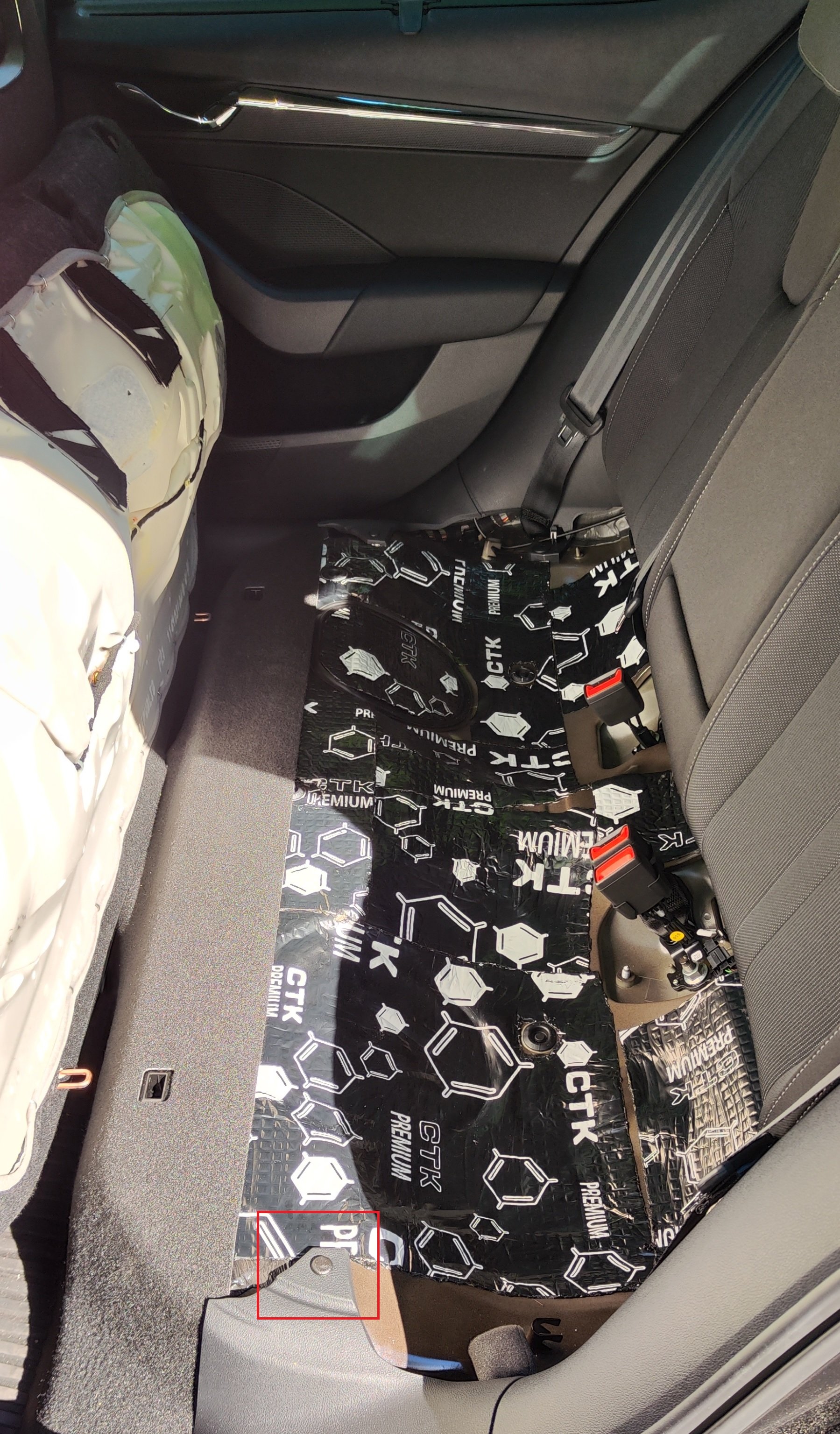

  • So, inspired by the Superb insulation topic and this one I gave a try on my Octavia 1.5.  Did the wheel arches on the outside, the doors, the B-pillars and the floor under backseat. Maybe in the

The Isofix anchoring points have to be pushed downward to release the shroud from the anchor. You can lift the cover to see how it's supposed to come out.
The front part releases with a firm pull upwards. The clips holding the front in place may break or not, so either get some spares or hope for the best. Mine stayed intact.
When both the front and back are loose, push the whole seat a centimeter backwards and lift upwards, to release it from it's notches.
The cable for the weight detectors is on the left side, be sure to disconnect that one before lifting the seat any further, same applies for seat heating if present.

One more question. Do you need to prep the surface before putting on the mats?
It's recommended to clean the surface with some isopropyl alcohol for example, but for surfaces like this where the mat is pulled down by gravity I don't consider it mandatory. I just went over the area with a dry rag and the mats stuck really well.

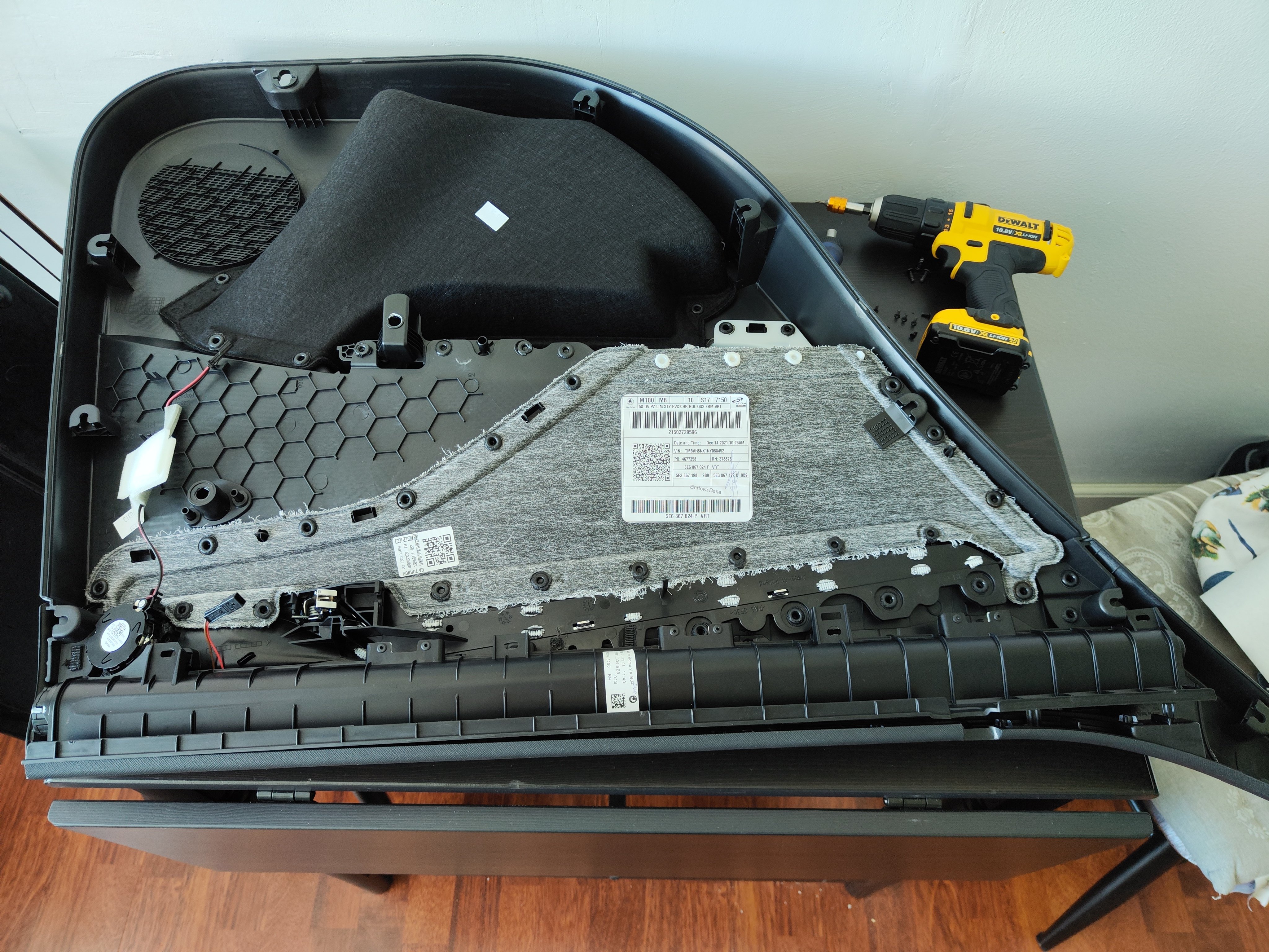

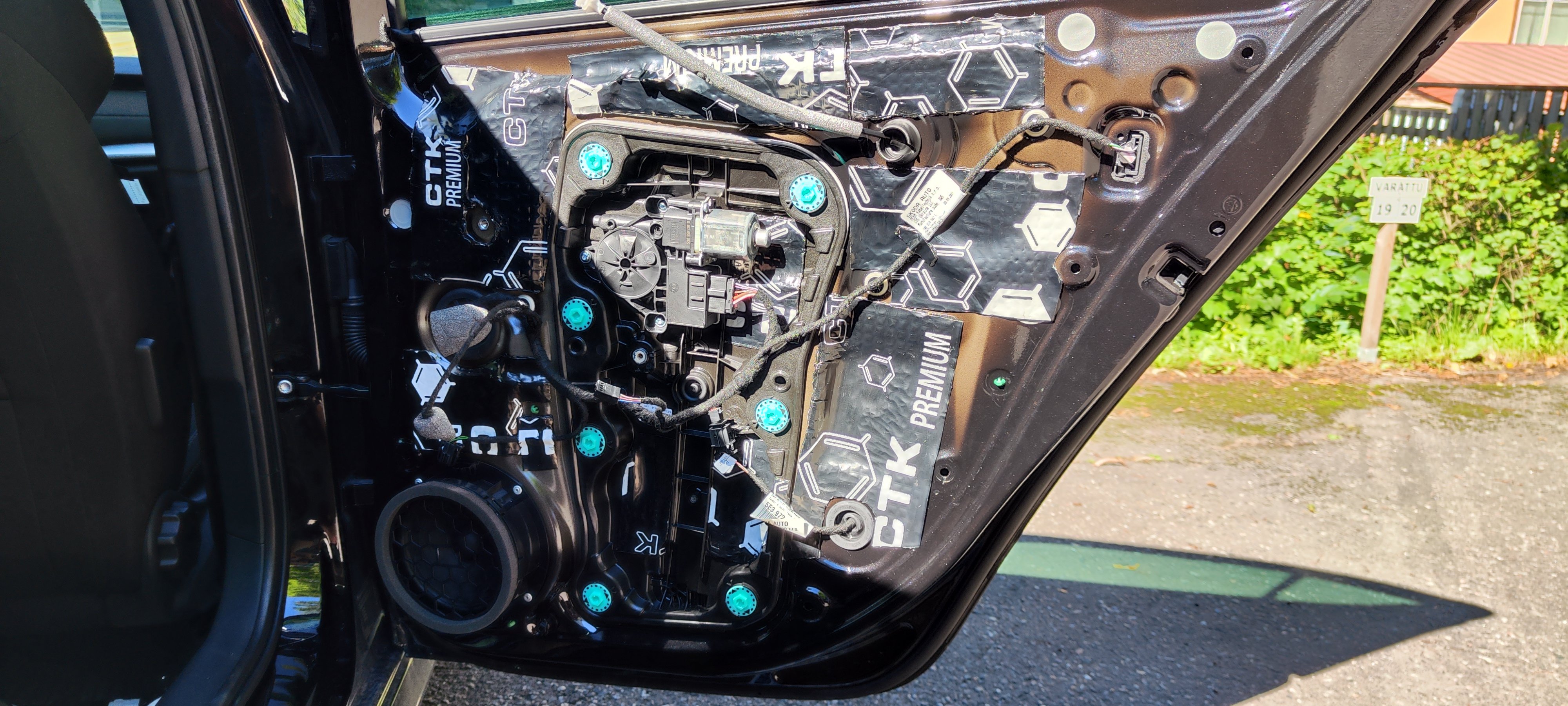

Proceeded to the doors today. Started out with the rear right since I've had an annoying rattle coming from that one. Upon removing the door card I discovered there's no way of getting to the outside panel anymore, without removing the window and the whole lift assembly.
I applied 2.2mm butyl mats to the most resonant parts of the inner frame.

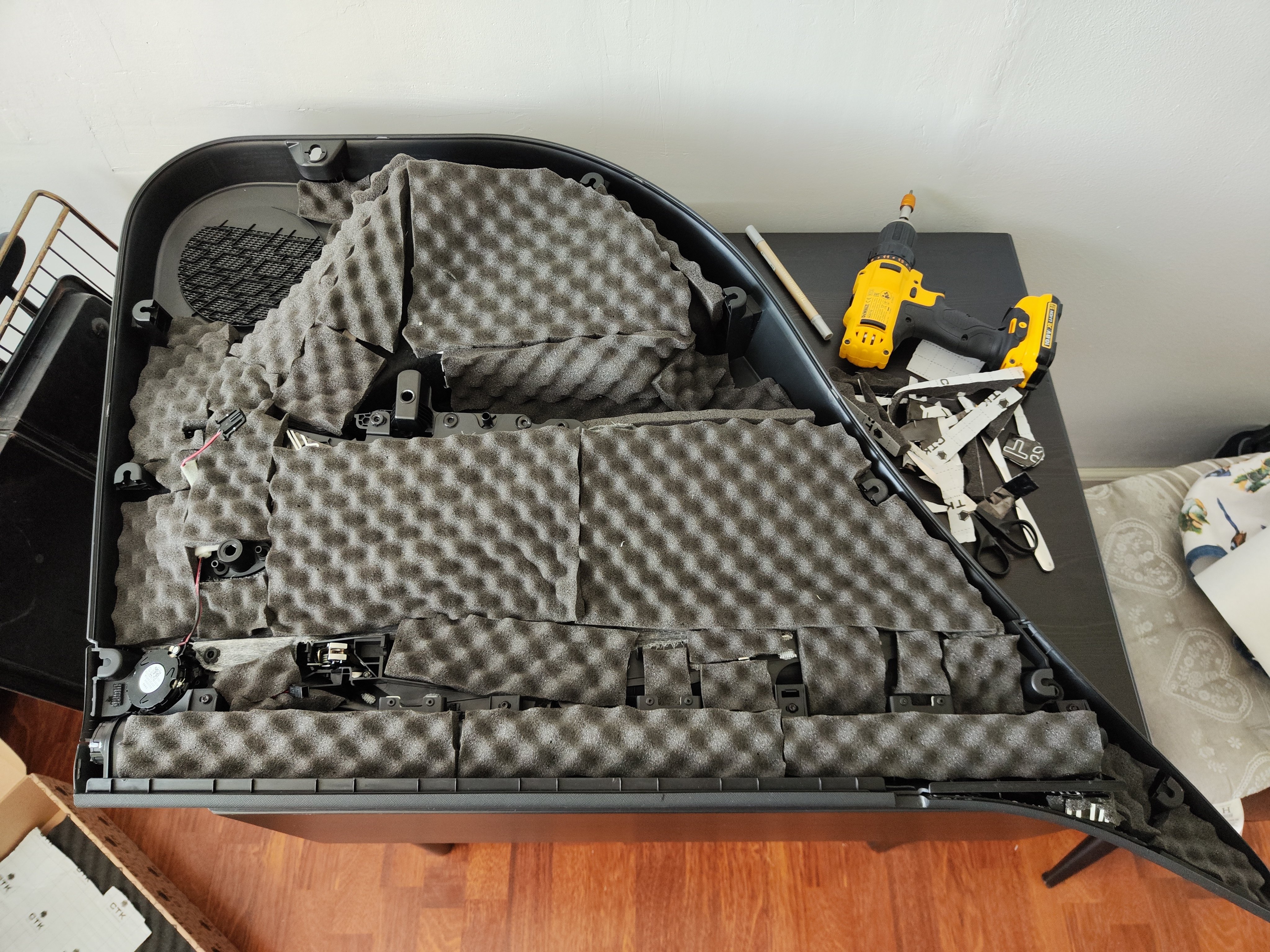

The door card didn't have any sort of deadening material on it, so I applied butyl on the worst sounding surfaces and topped everything off with 15mm CTK WaveFix acoustic foam.

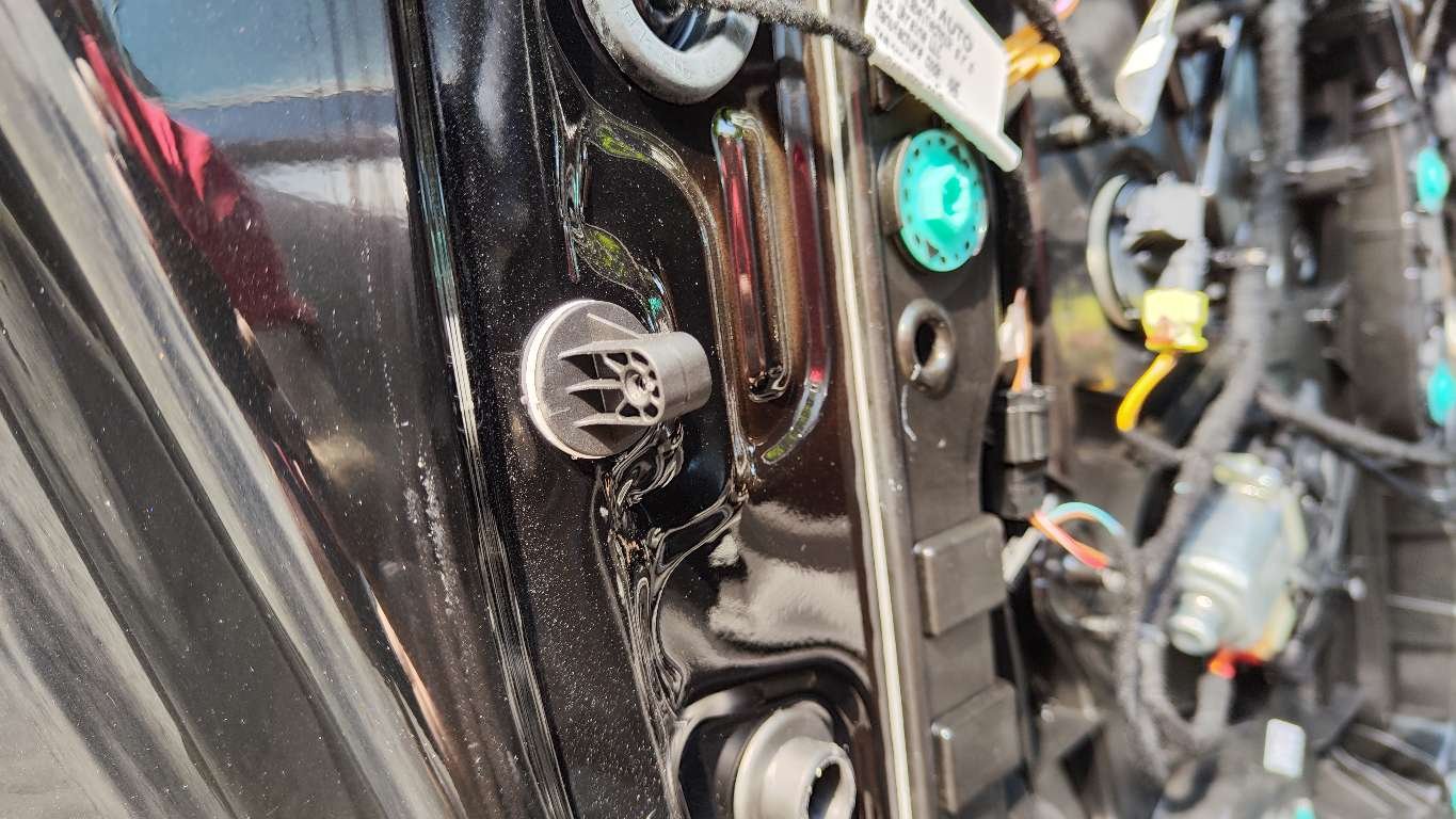

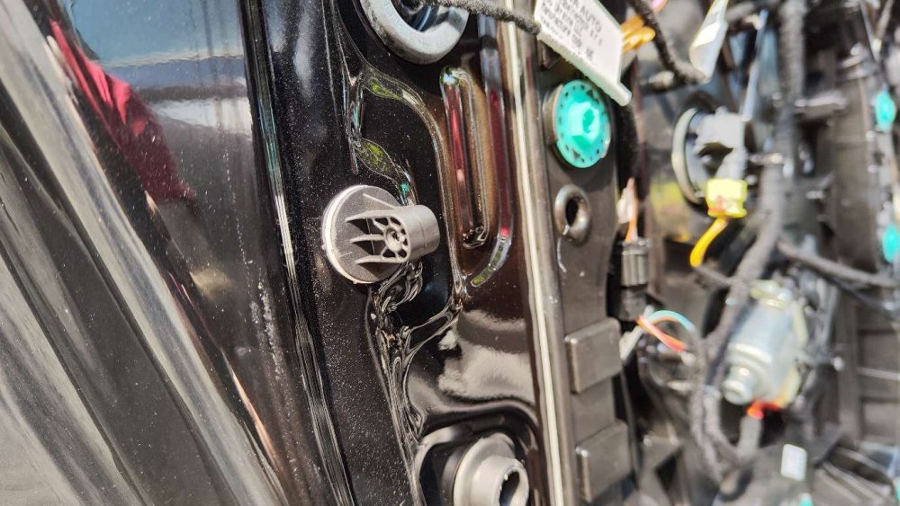

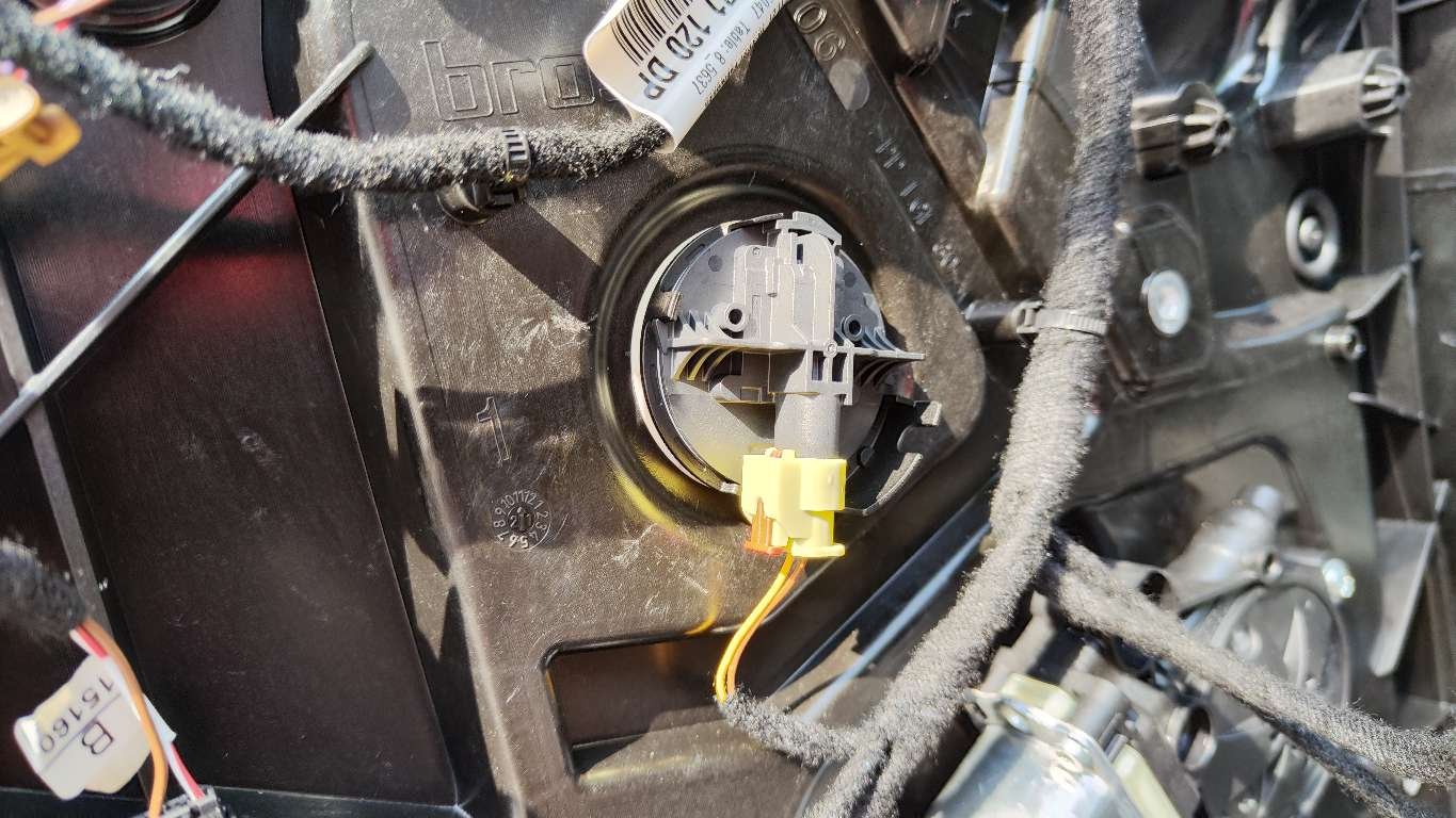

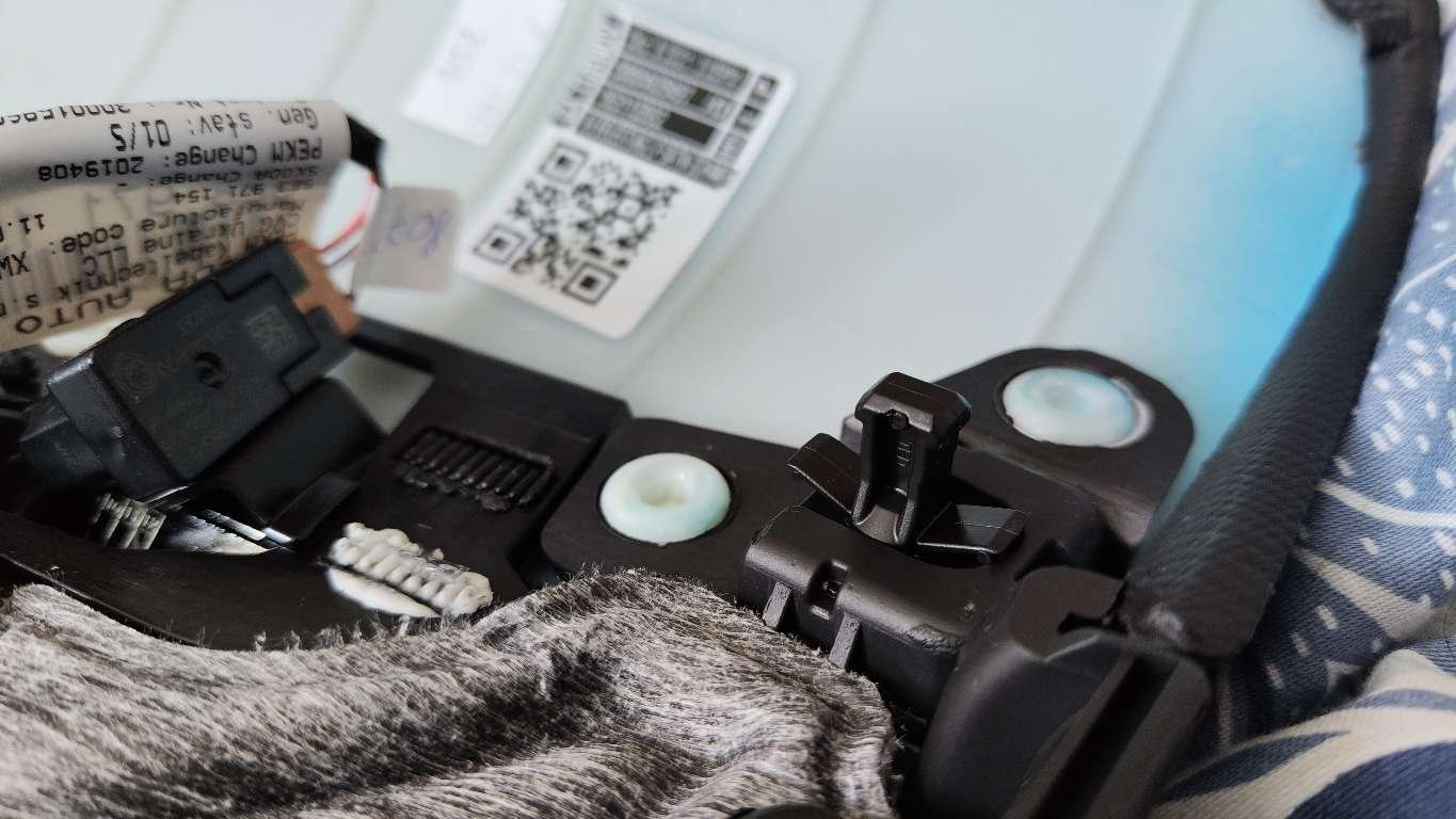

Did the passenger front door today. Mostly the same procedure as the rear doors, except the front doors have two "crash clips" as VW/Skoda calls them. They are both located on the rearward facing part of the door. The bottom one is released by taking out a screw behind a small lid that pops open easily using some thin enough item. The top one is a one way clip that can't be "pulled" out unlike the other rivets. Instead it slides open when you lift the door card out of the window channel, no idea trying to force it out by pulling, it will break for sure.

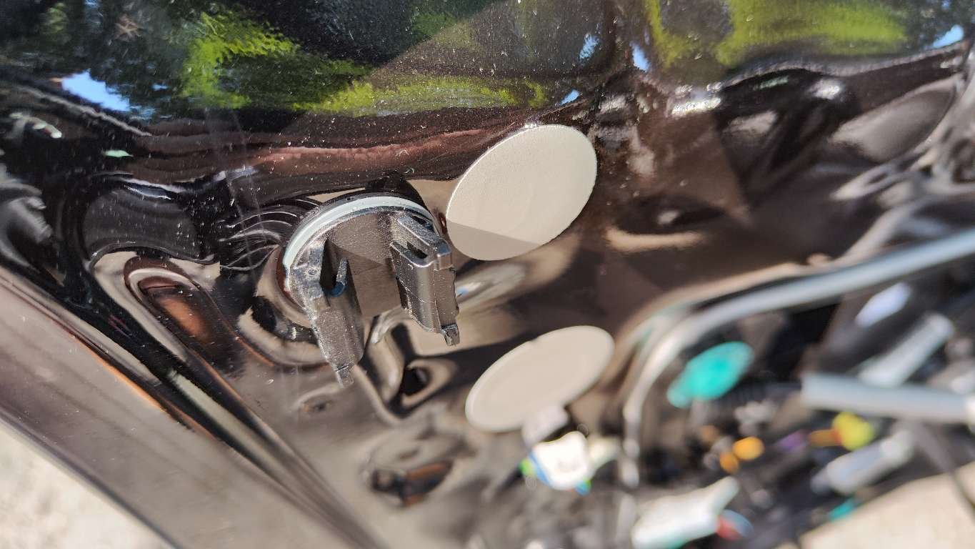

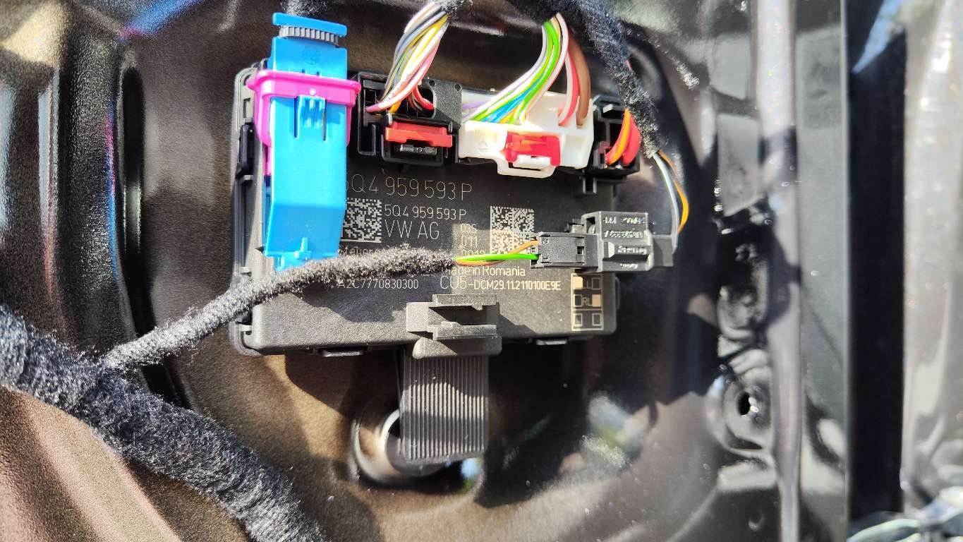

Worth adding: The front passenger door also had an additional control module (made by Continental). One of the connectors was so loose in its socket it would rattle just by giving it a little nudge. All doors have had plastic holders that rattle when the wiring looms move. All rattles disappear when these are tightened up with either foam or a piece of butyl in the right place 🙂

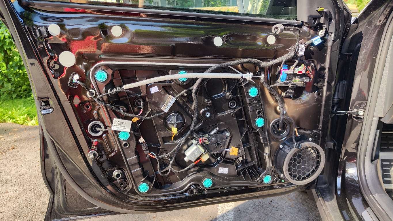

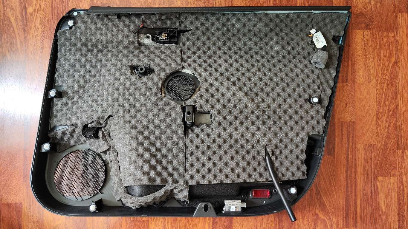

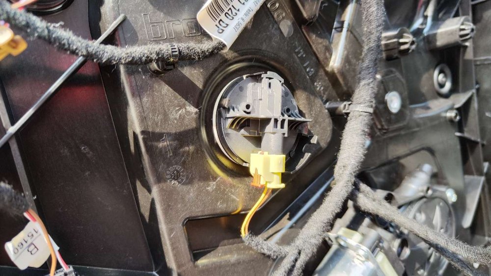

That's it. Doors, trunk and rear seat done. As promised, here are some pictures of the front door.
Overview
Crash clip 1, screw type.
Crash clip 2, releases by lifting the door card.
Anchor on door card for crash clip 2.
Door control module. The connector on the right side (brown/green) was sliding back and forth and rattling.

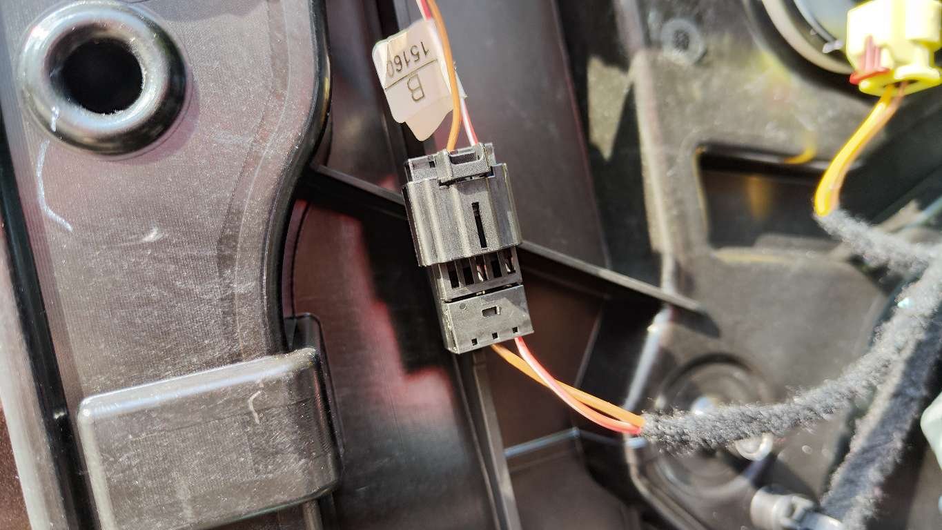

Another potential source of rattle.
Pressure sensor for the airbag system. This should be left connected and untouched.
Door card finished. Didn't put any material close to the LED projector as it has a heatsink that needs some air around it.
