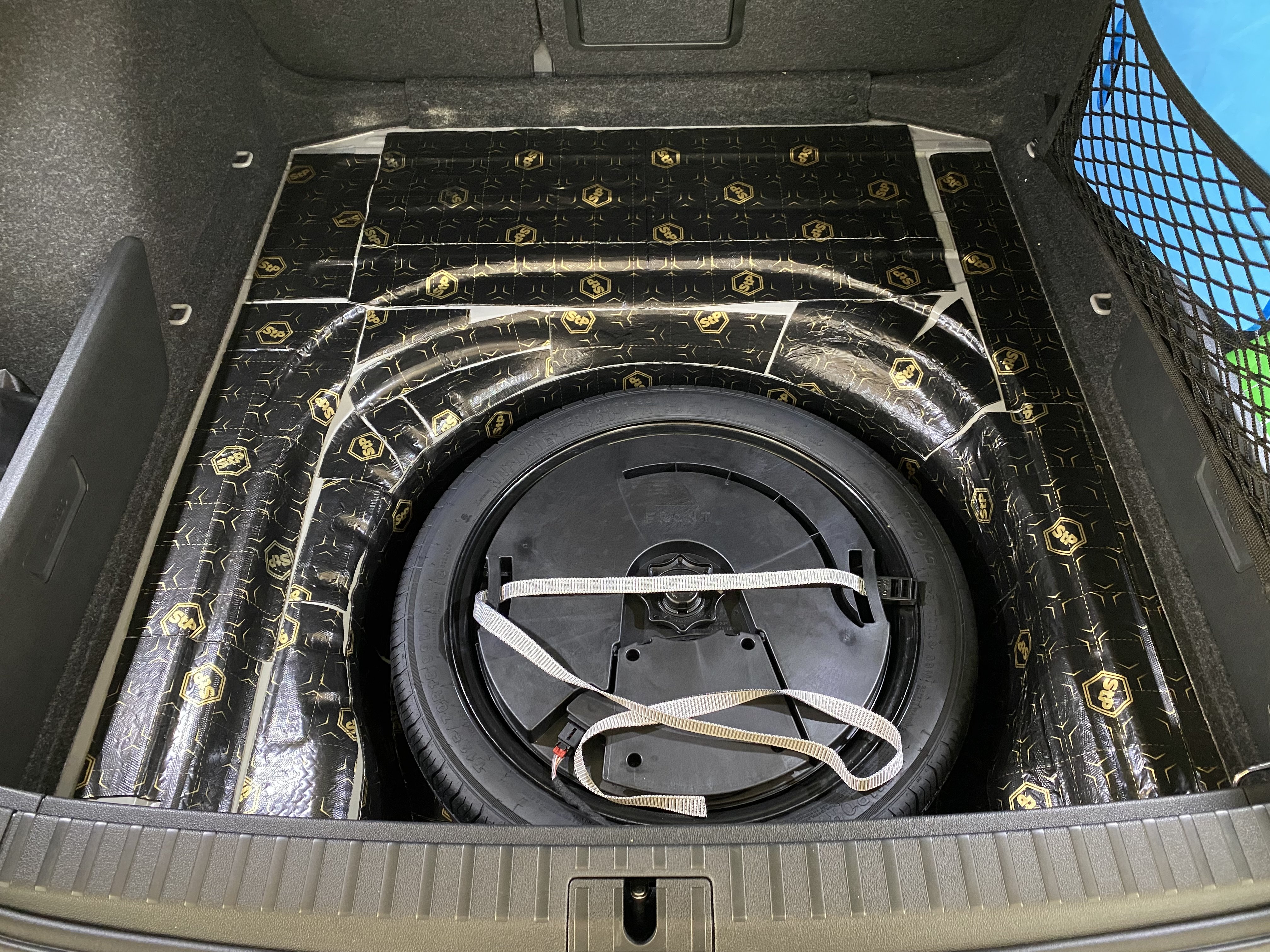

Finished the boot and behind the right boot panel today. Needed two afternoons. 😅 It's quite time consuming since there is a lot of surface around the spare tire and a lot of curves and angles. A lot of cutting and adjusting to cover everything.
Was so into it I forgot to take pictures. 😂

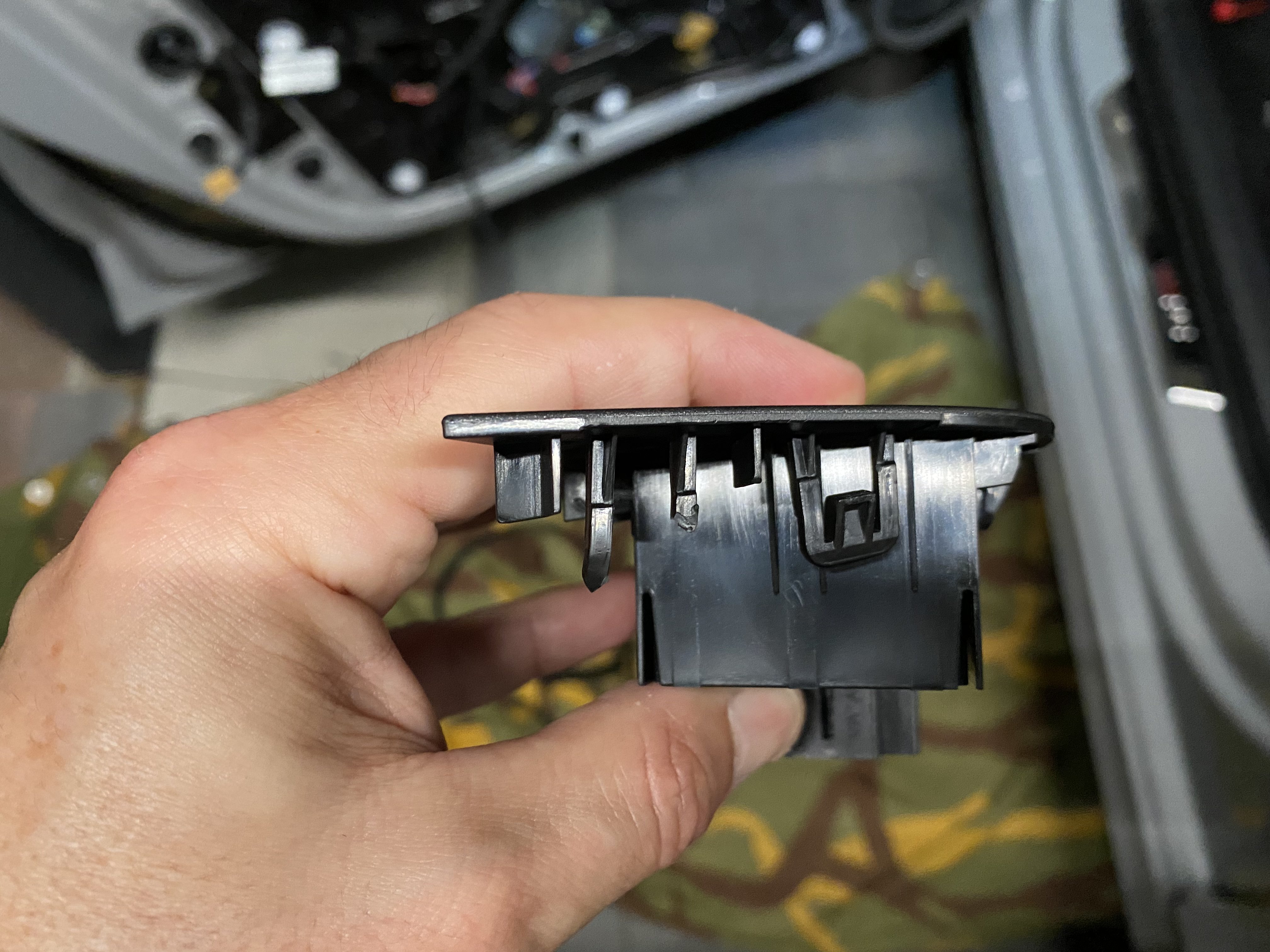

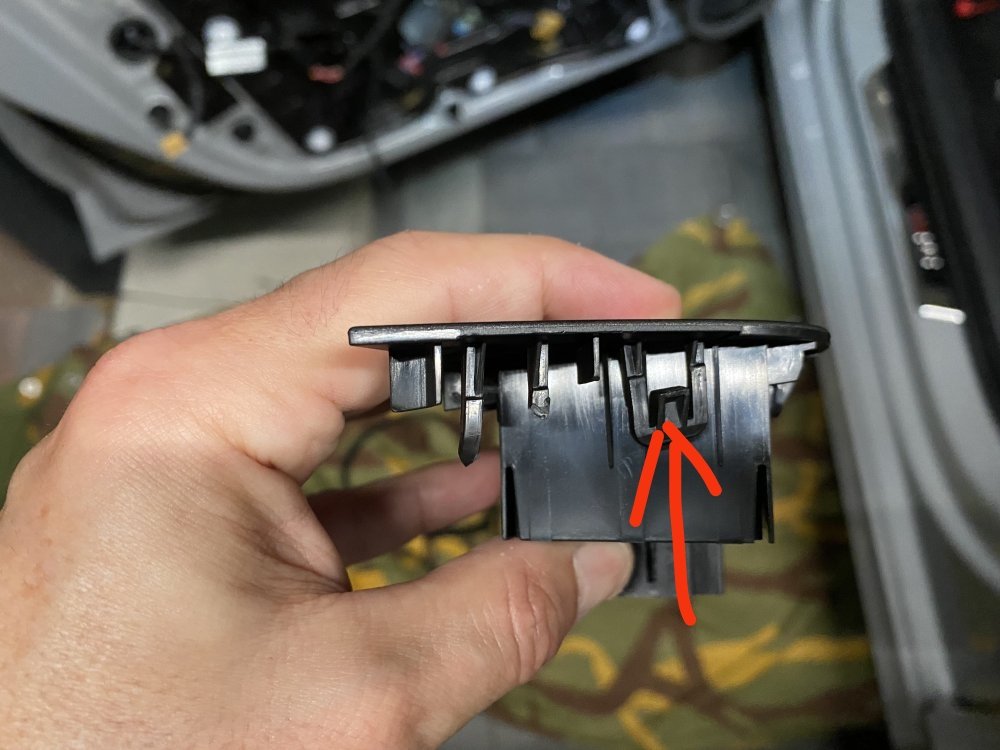

Any advice how to get the button assembly out of the door without braking? 😞 This is the far left side. I just couldn't get it out without braking.
This is how I did it:
1. With my one hand, put my fingers in the button recess and pushed the assembly forward, making the gap at the back as wide as possible.
2. With my other hand, placed a thin plastic tool in the gap and levered the assembly up until the pictured tab catched against the frame.
3. With a second plastic tool, started prying the tab away from the frame while keeping upwards pressure. After a whole lot of prying, the tab released. Patience was required 😅

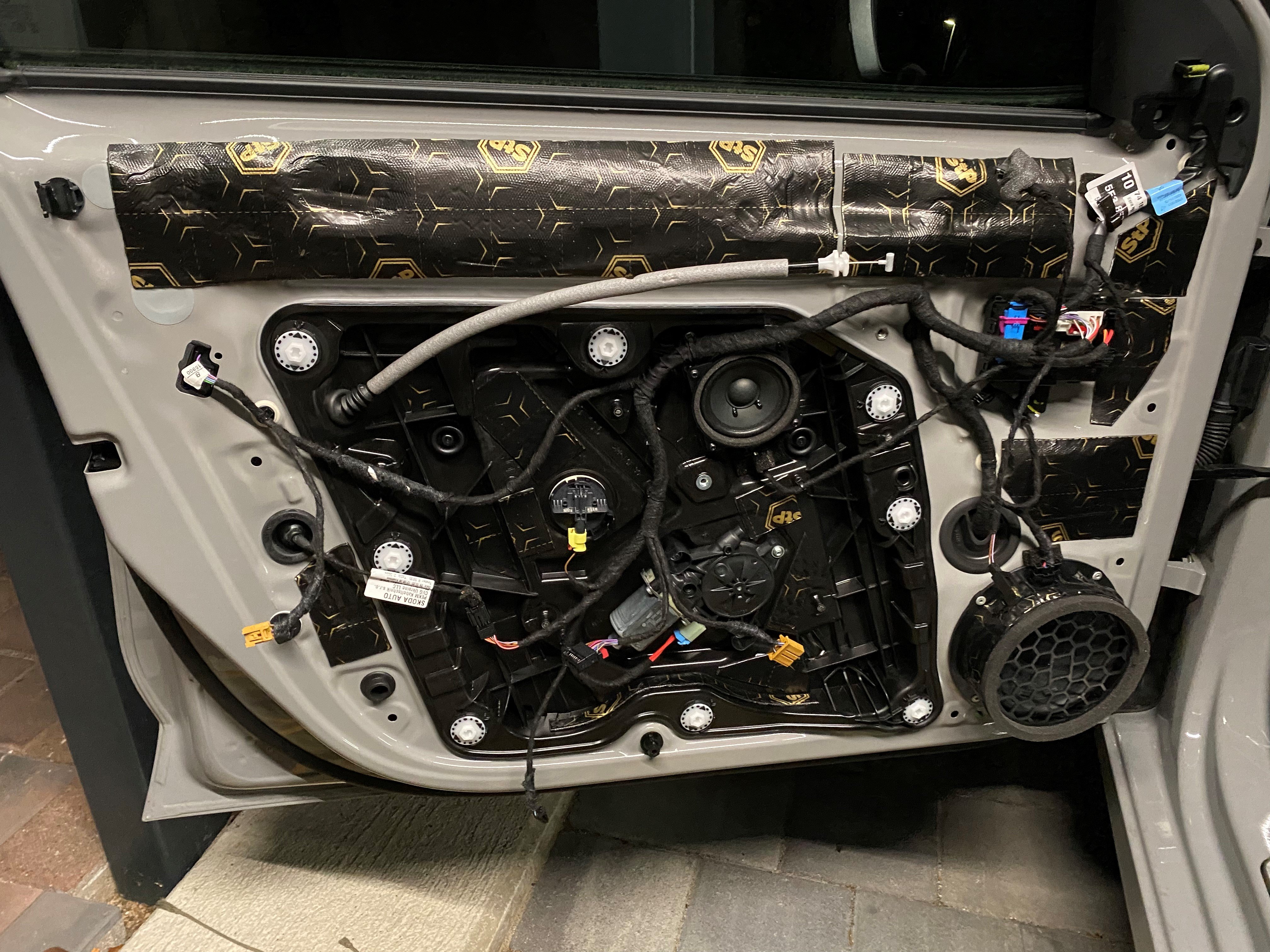

I managed to apply CTK Car Audio Vibration Proofing Sound Deadening Premium to all the doors, under the boot and under rear seat, the car did become a little quitter but mostly overall noise disappeared and feels like there are less vibration which is what you expect!
Some pics of the boot and the left door.

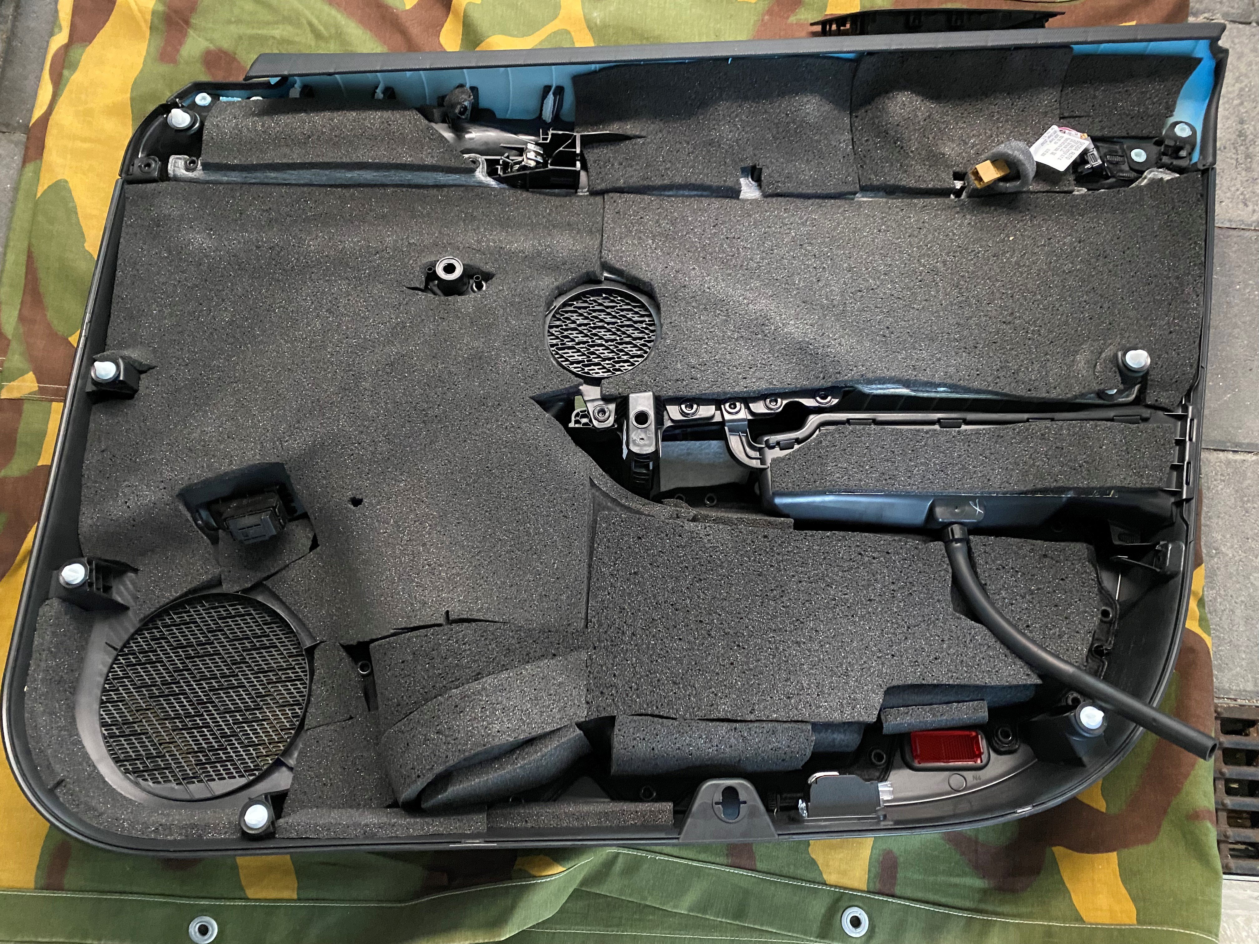

Well done, looks as a very accurate job! Let us know if you noticed the difference in noise. I see you added foam as well to the doors, I wonder how much difference that will make.
Thanks @Vlady I took my time for the boot. There is quite a lot of surface there. 😁
I didn't feel comfortable dismantling the window mechanism on the doors. This is why I tried to be more accurate with the foam on the door panels.
I will do a longer drive tomorrow and I'll report back.

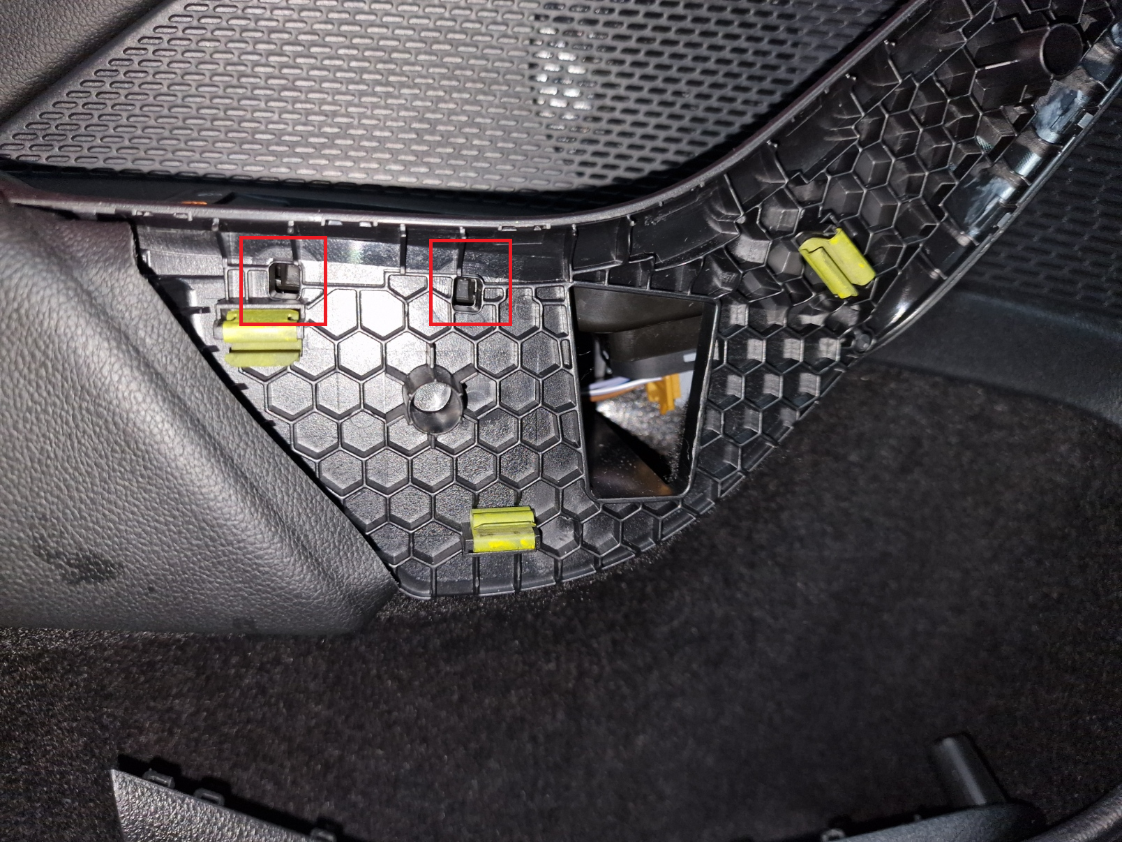

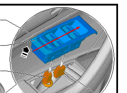

Gent's there are actually special openings/holes in the door card. to release the latches of the windows switch module.
Will try to take a photo on next occassion.

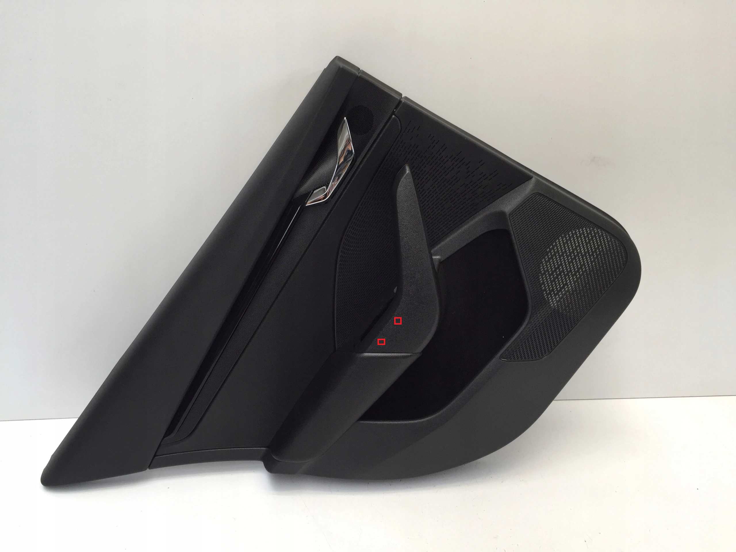

They are under the door handle cover, more or less in the places marked in red:
I know it's a photo of rear door card, but you get what i mean :)
If you want less noise, not only vibration, you need to also use foam for example in the boot.

Here's pic of what i meant:
Just insert small screwdriver or something similar in those holes, press gently and latch is released.

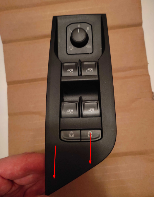

Hmmm didn't notice that. Thanks for pointing that out.
But can you access the two latches on the left side of the switch module (see arrows on the pictures below) through these holes?
I had issues with the two latches on the left side of the module, not with these two in the front.
No, you cannot access those latches.
But it's actually not needed. If you release latches on the side and push gently upwards through the opnening in the doorcard, module will bend slightly, thus releasing the latches in the back.
Used this method several times now, and all latches are fine.
Problem is, that you were probably trying to release back latches first, as it's easier to insert something there because of the "cushion" part of the armrest. This way it's easy to break the latches.
