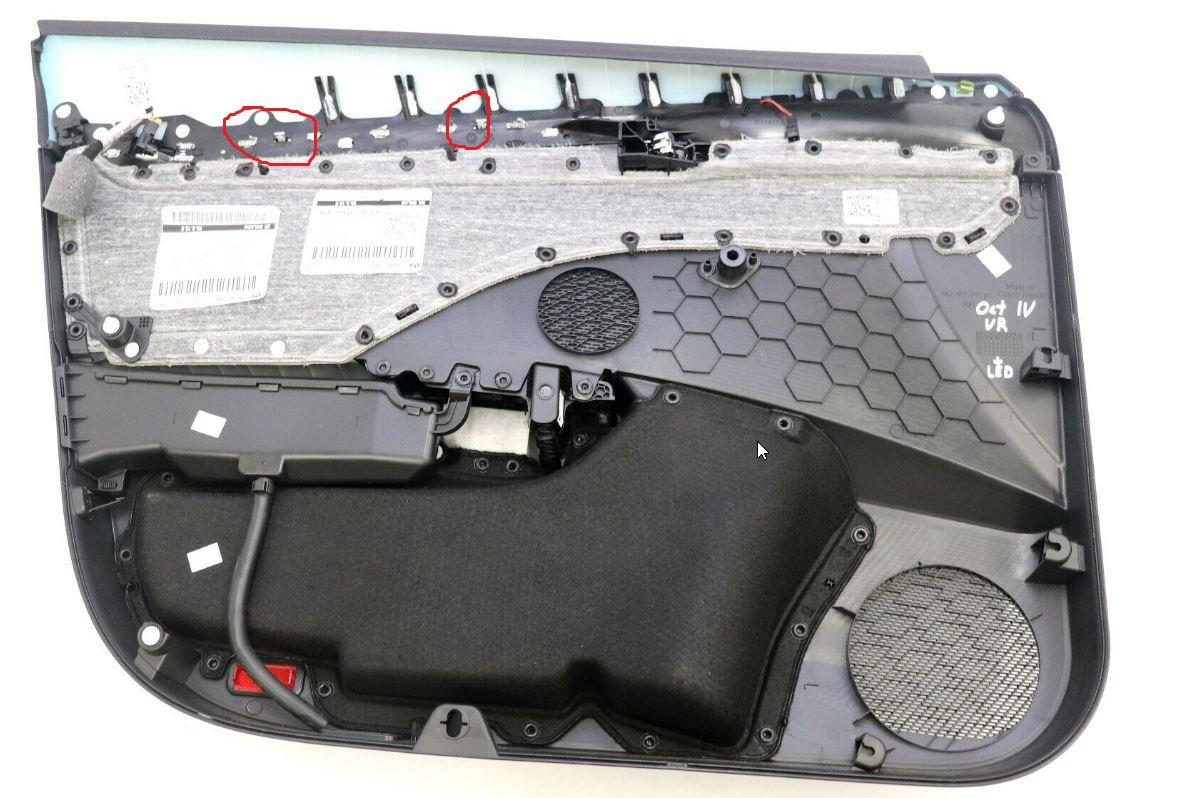

It looks like here are some sound deadening pros 🙂 I hope you can help me. I have noticed a strange noise while pushing on my front door card.
Does somebody know how i can get this quiet and fixed?
My O4 is quite new, actually a 2024 modell, first owner with 59km on it, but its already making noises.. I made a video and uploaded it on youtube.. maybe someone can help me..

You need to remove the complete door card and check from behind. This part, which you are pushing, is one piece and can't be separated. Could it be that when you push it actually hits the door metal? I would start with removing the door card and check what this going on behind. Check if this part makes the same noise once the door card is separated from the door. Then I would start adding some sound deadening foam at the back of the door card.

I already removed it and in my opion the noise was gone while pushing it not installed to the door. I kind of thought the same, that maybe the part is pushing against the metal or something. Behind this part there should be somewehere the "door opener" cable.
I have located the noise coming above the silver trim itself, while pushing in the area in the video. Do you have this noise in your car, as you already put foam everywhere? :)
So maybe something in the area of the pic.
