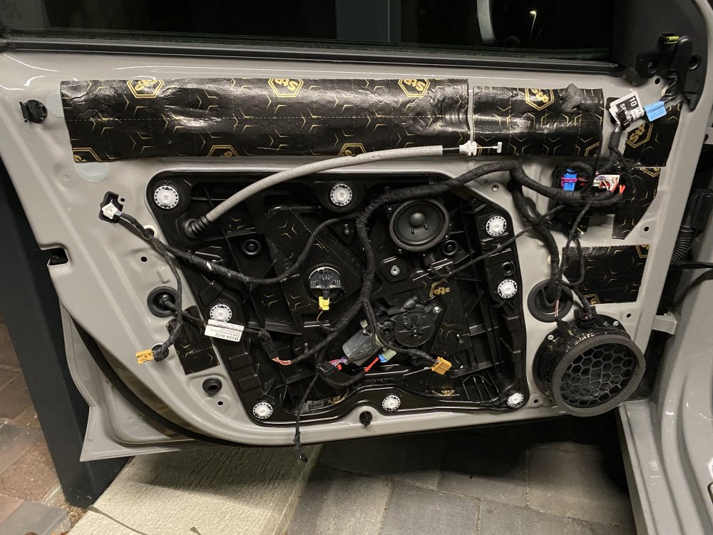

I have zero noise on either of the front doors. In addition to the foam on the door card, I would also strongly suggest to wrap the door handle cable into something soft.
Here is the picture of my door before final installation.

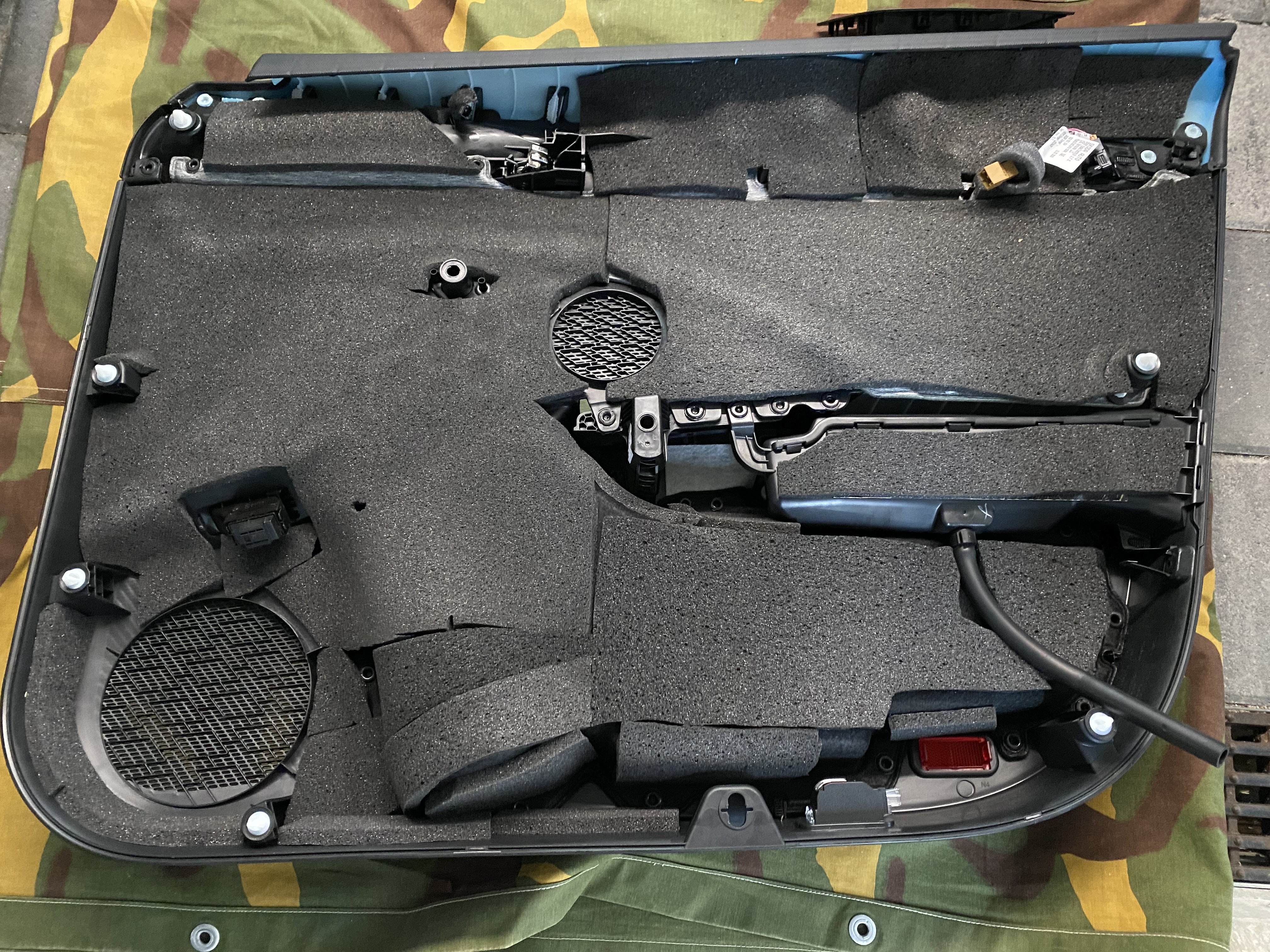

    Will start doing the doors soon. Today I did the boot lid. Added butyl mats in the cavities with a lot of flat surfaces. The trim got some butyl mats and acoustic foam on top.
Thank you! Is the door cable not already wrapped in something soft?
Do you think its the door cable which makes this noise cause its hitting while pushing?
Ohh you are correct. The cable is already sleeved.
I guess your best option is to add the foam to the door card. Or at least add some foam to the area of the sound and where the cable meets the metal.

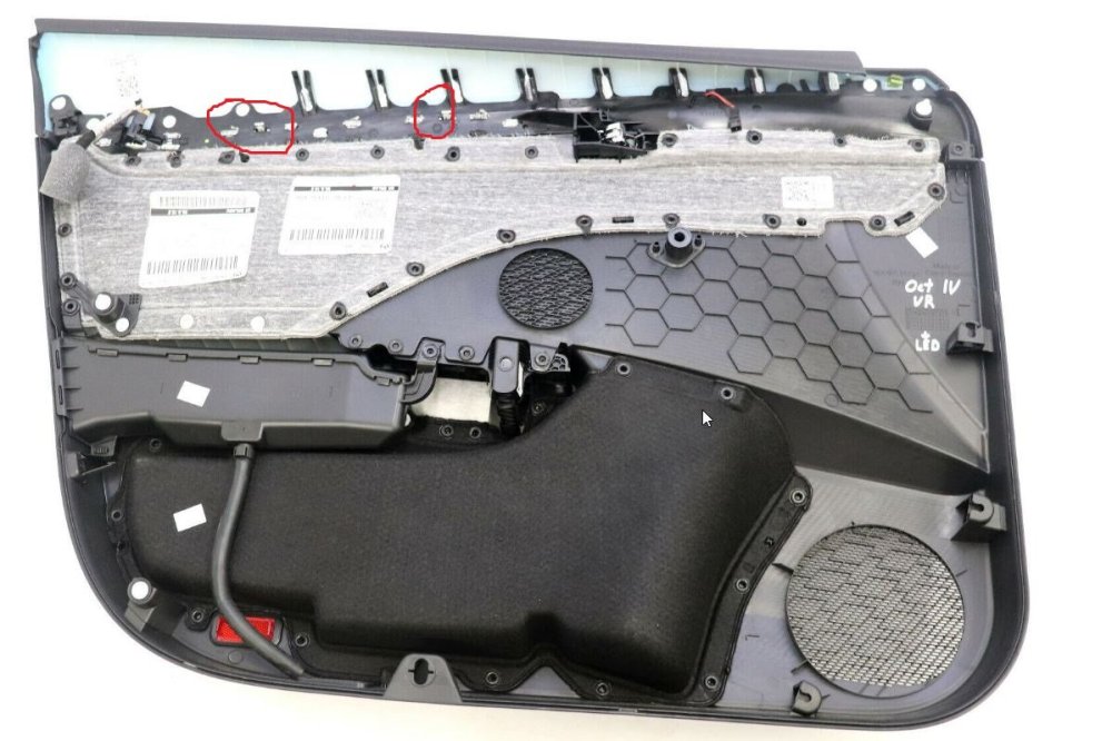

My personal guess at this point is that the door cable hits the door card. On the door card are some black melting points with sharp edges from putting it together.
So the sound could be the foam from the door cable hitting the plastic. I will try and see if putting some foam in this area of the door card will solve it.

I have tried to put some tape behind the door cable, didnt work. While pushing the crackling noise is still there like in the video. I think only a complete sound deadening with alubutyl and foam everywhere can eventuelly solve it. As this is only while pushing I will do it later.

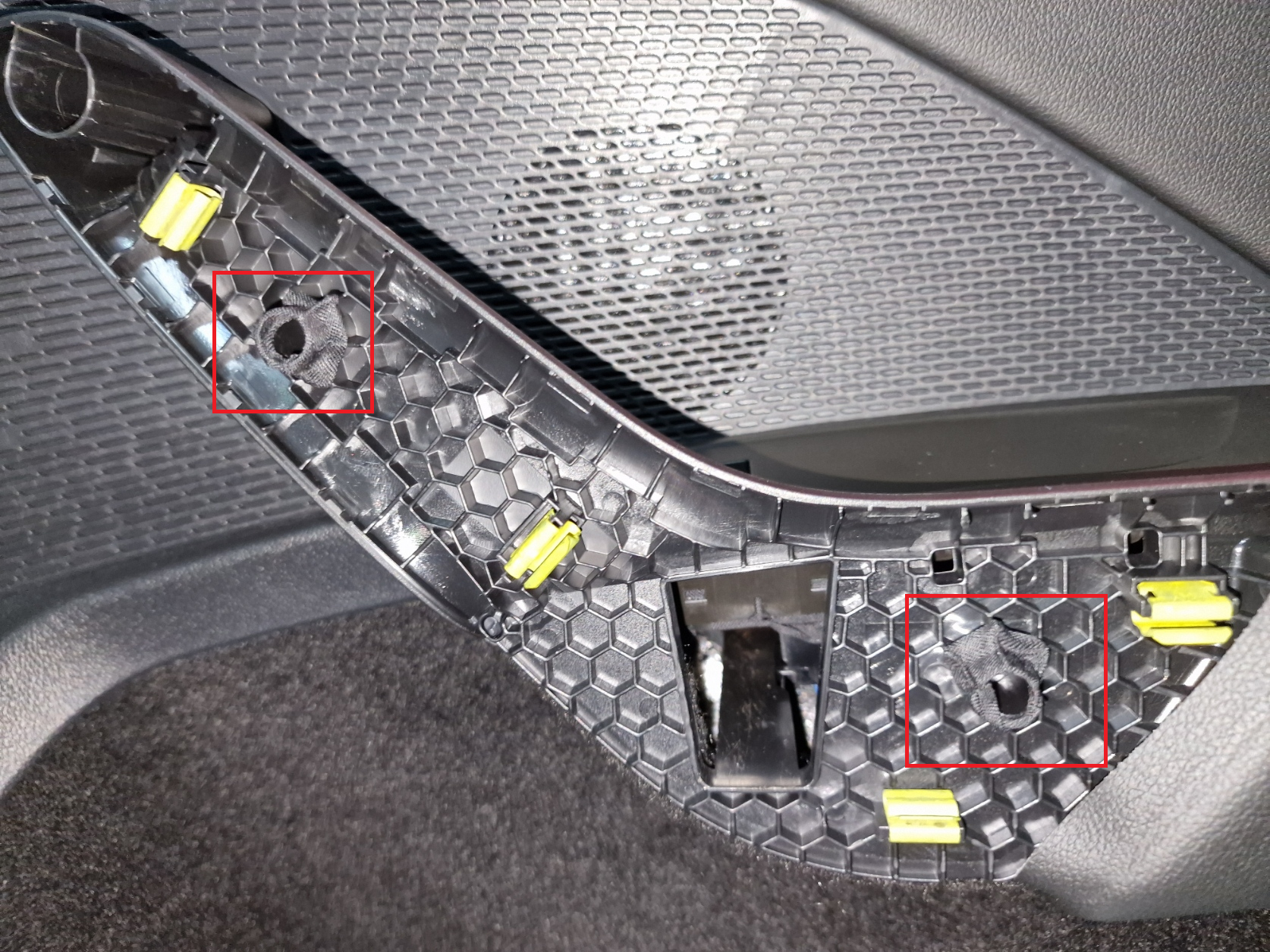

You mentioned in another thread that you had a noise from this crash clip and solvef it. How did the rattle sounded in your case?
In my case it is somehwere in the door area. Maybe the window regulator trim or this crash clip.
The crash clip was vibrating when listening to the radio. Even at mid volume. I think it didn't vibrate while only driving and not listening to any music.

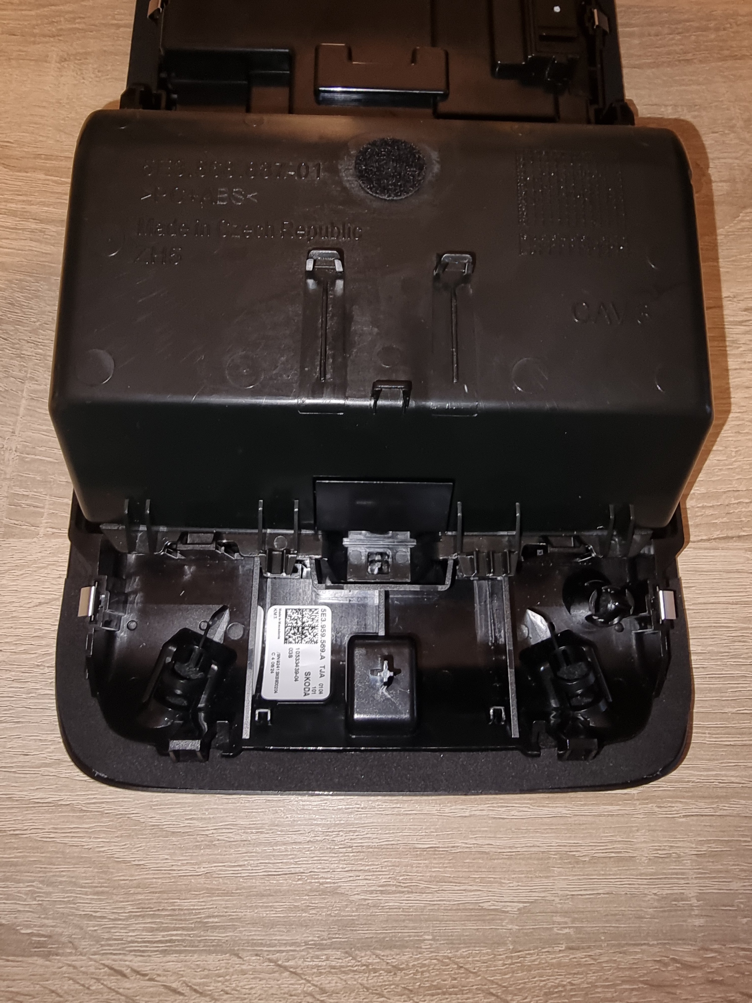

Now my roof console (the console with interior light and sunglasstorage) is cracking on rougher roads...didnt find a solution yet but i am investigating..
Maybe somebody with the same problem here?
  • 3 months later...
I have totally the same problem with my roof central console and alu trims on the doors...
If you have solution for roof console - would be great if you post it, thanks!

I posted my solution in this thread 🙂

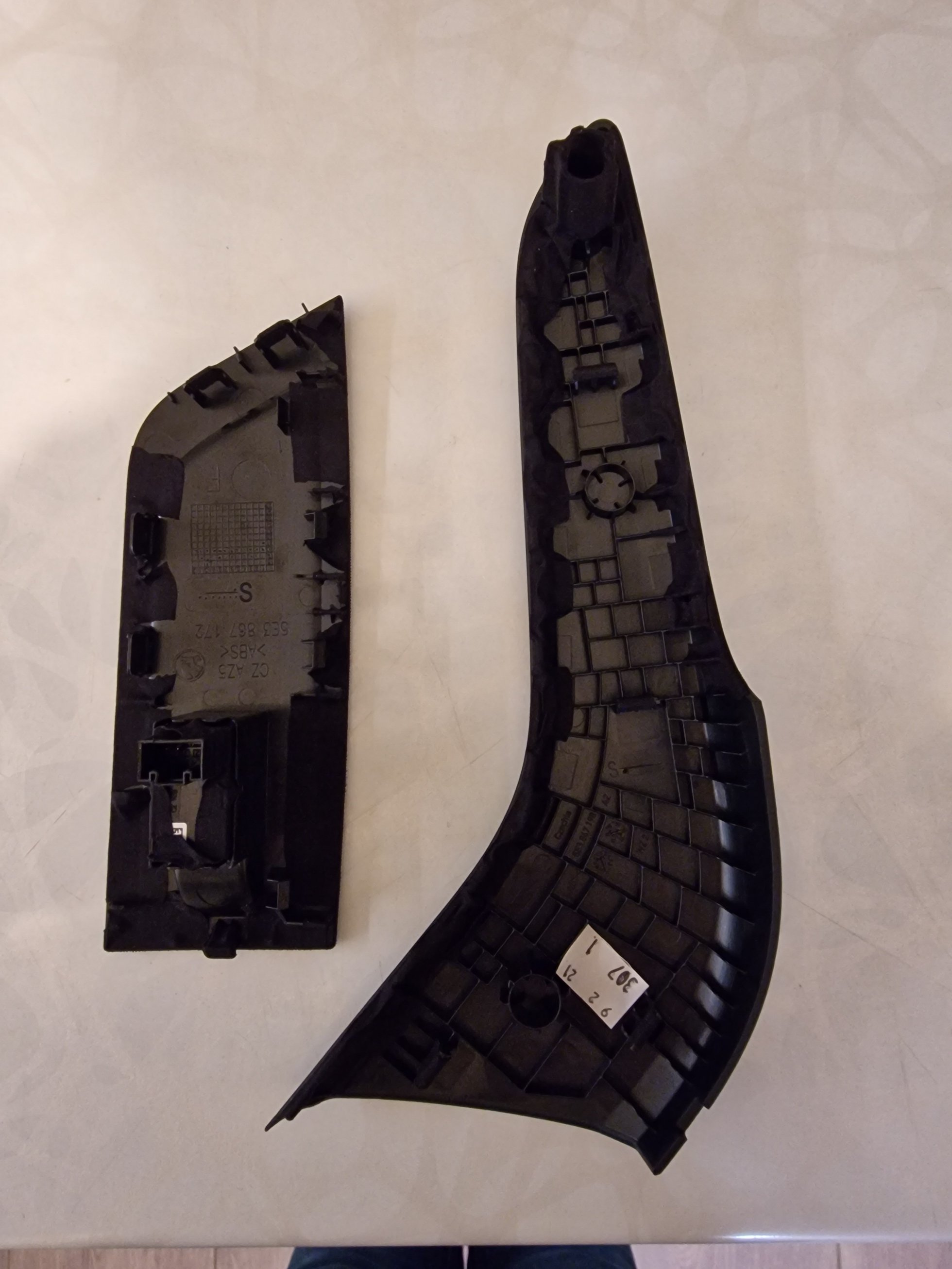

Hello there!
I am trying to get my door handles quiet cause they make noise..
on the picture i cant really see where to put the tape..
please can you help me?
