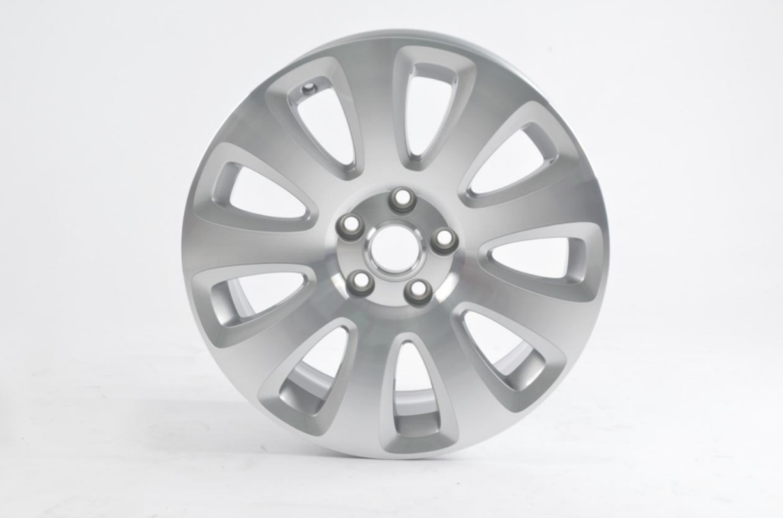

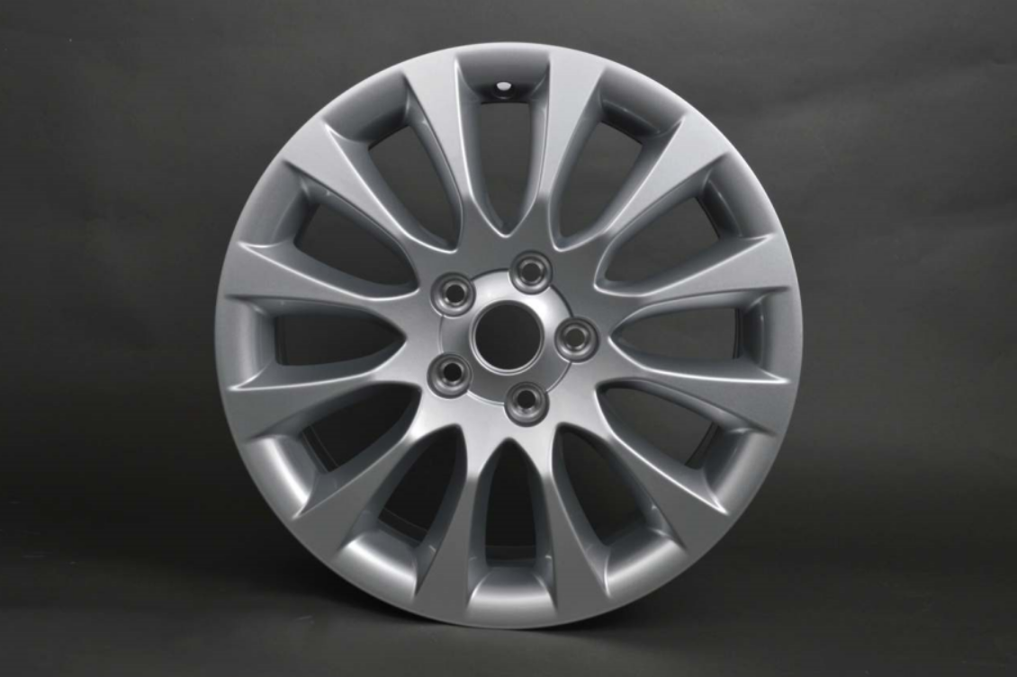

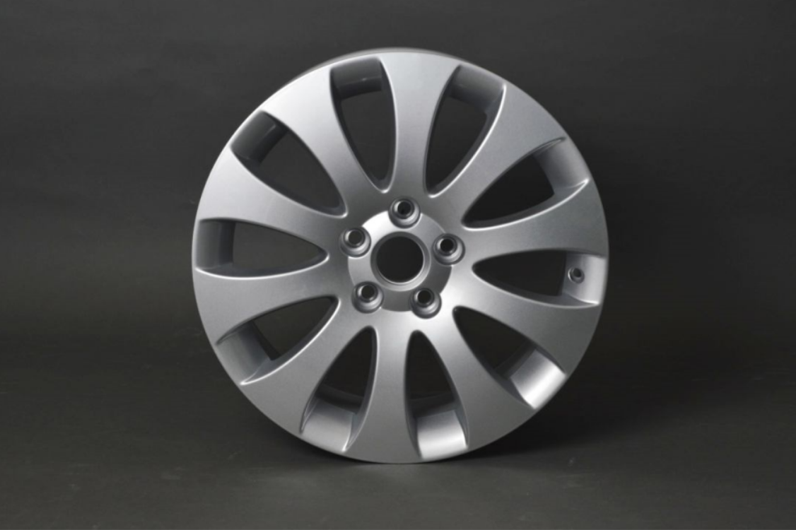

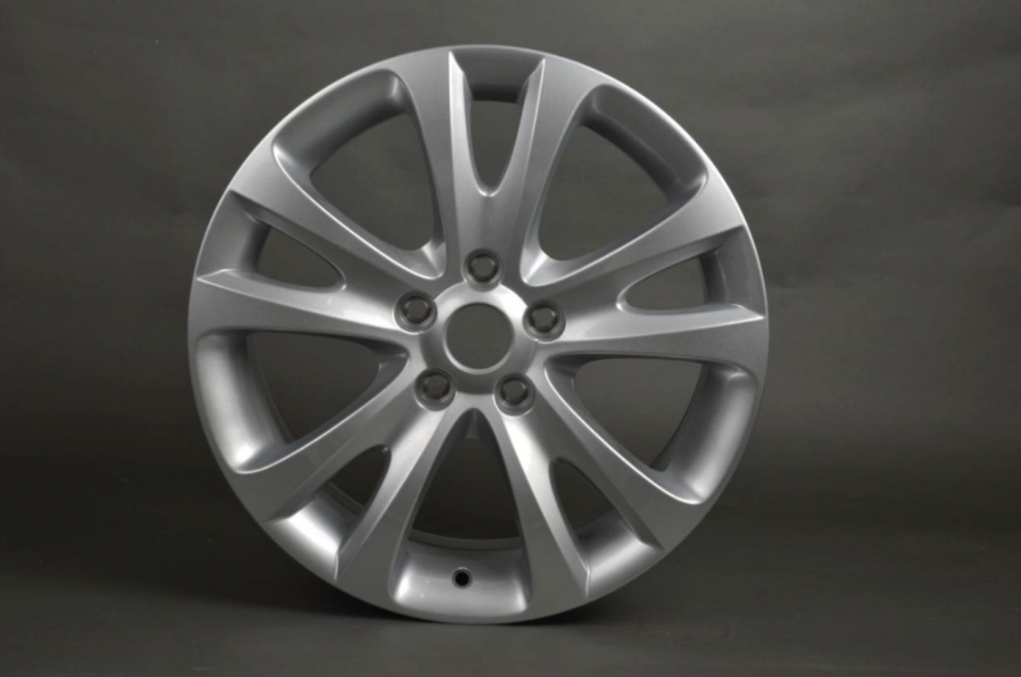

Here you go @Spudskoda here are the wheels that should fit your car.
I would absolutely recommend checking your car was indeed registered before 29.05.2011
You should then be able to just fit one of the choices below that takes your eye.
I do highly recommend that you try to get a quote from your dealers for 17" Alloys, that way they might send you the part numbers in the quote 😁
