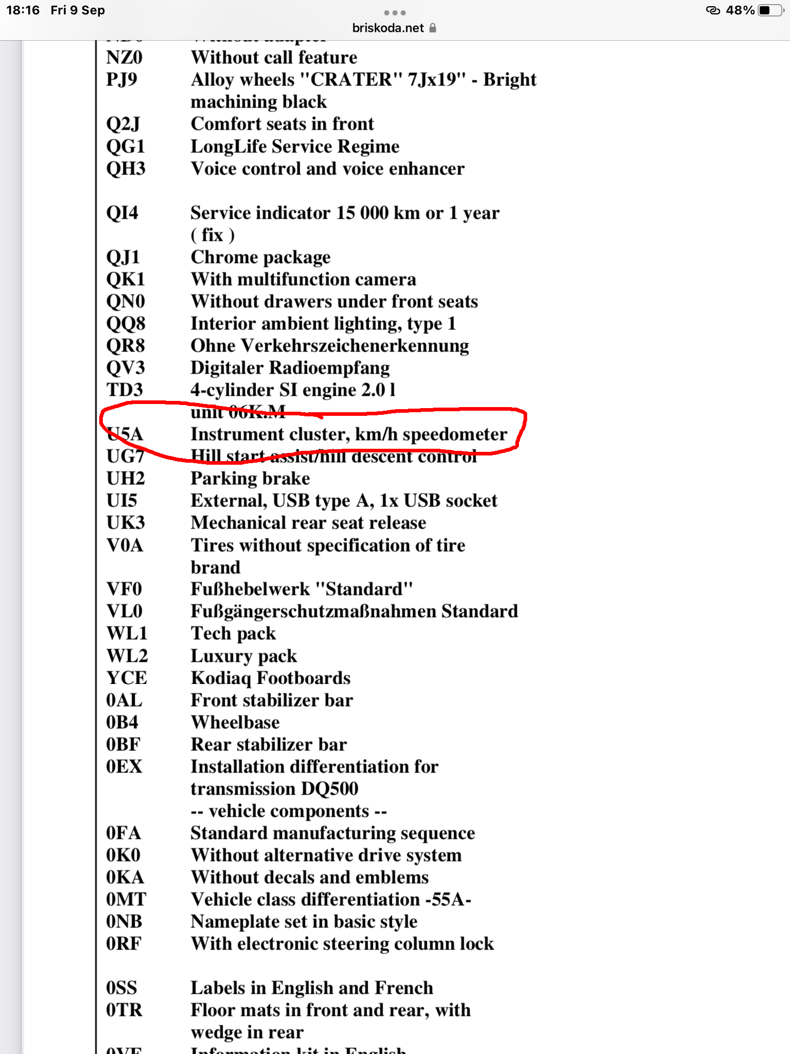

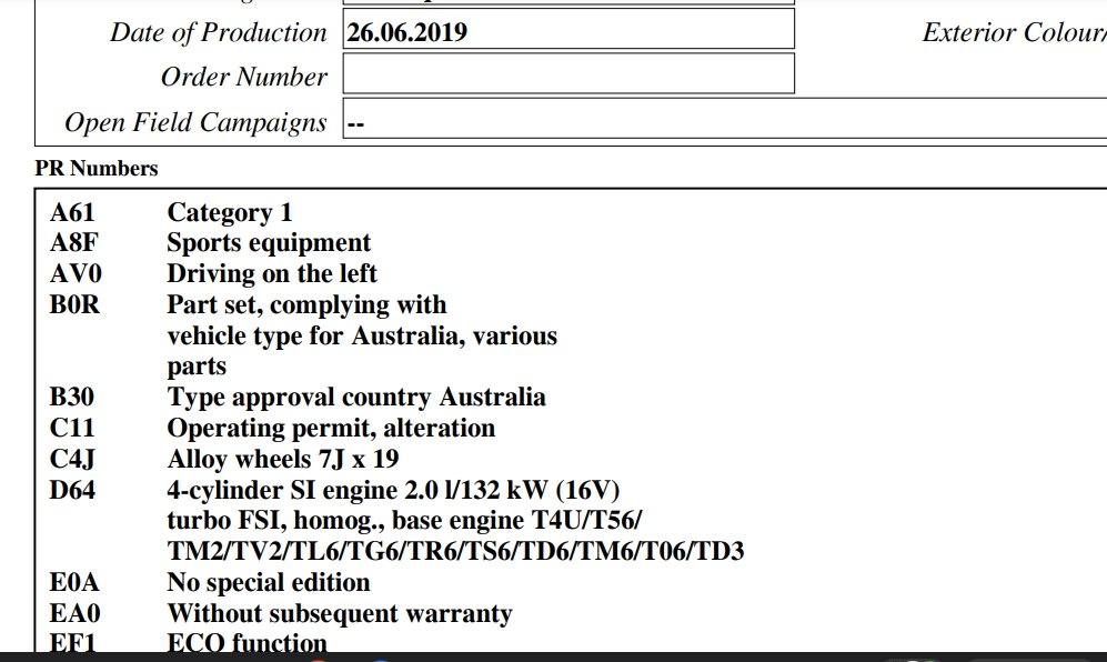

The answer is now in the document... proper head scratcher.
TMBMD9NS0K8------.pdf
Interesting, is the speedo in Kph?
Edited by Kenny R

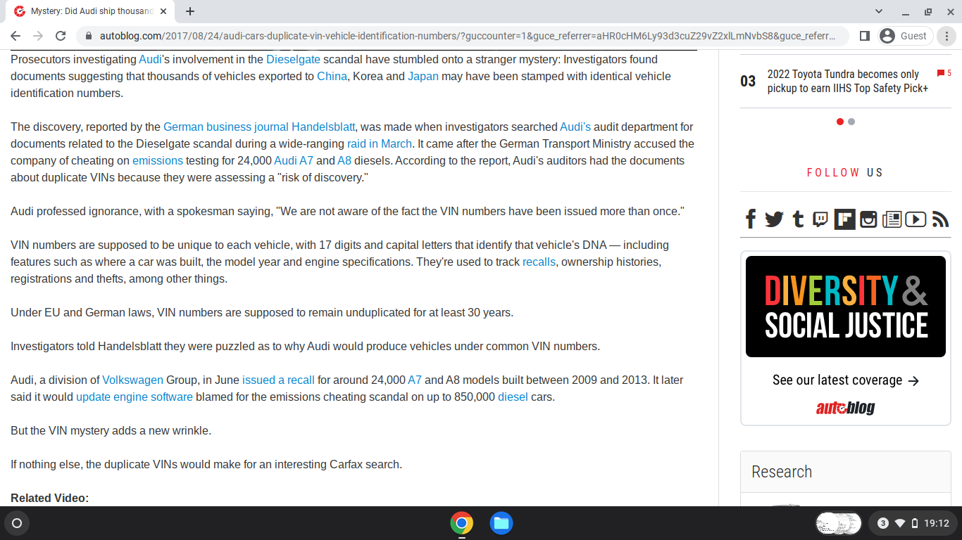

I would want to know if it is Australian Spec and came to the UK for use in Australia or anyplace else with the UK Military or anyone else and never got there.
There were stories of Audi's and a curious case of cars in Australia a few years back with the same VIN's.
No idea what happened on that one.
It is not just the usual of someone asking on here how they can get MPH digital on the speedo and being told to change to Australian for the lights.
EDIT.
My bad, not Australia, unless maybe some ended up there.
Edited by roottoot

Keep us updated on any developments, when I decoded the VIN I was shocked even though you did mention map was AUS/NZ (hoping it was user error of someone loading wrong map)
Let's hope it's not something naughty, and just some massive 🐔up of an Aussie car being shoved on wrong boat.
