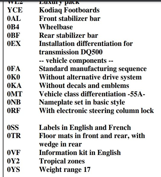

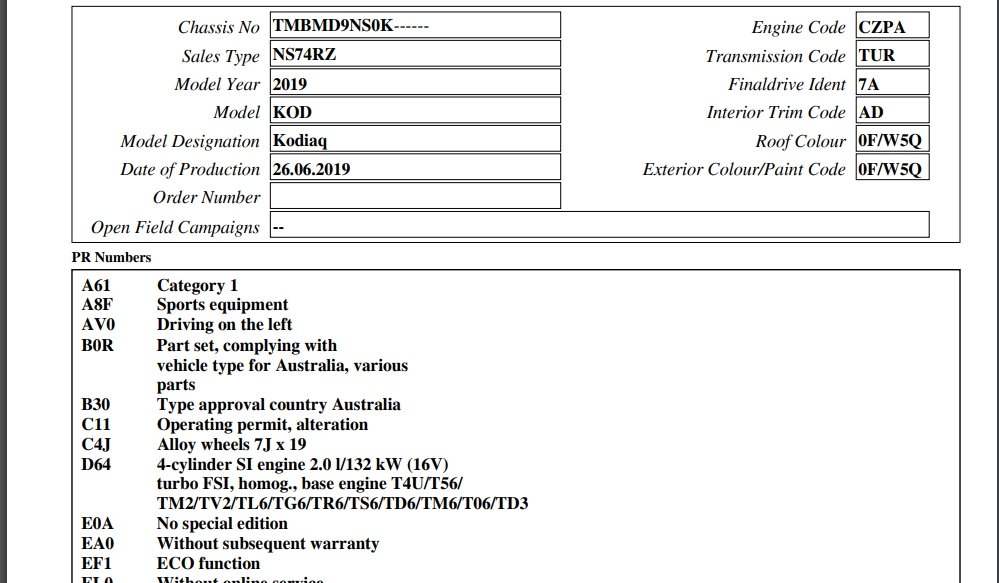

  • The answer is now in the document... proper head scratcher. TMBMD9NS0K8------.pdf

Label in French & English.

So an update....
The Skoda garage (unsurprisingly) failed to sort the sat nav. They have done a full tech download and are going to send this to Skoda technical about how to do it.
They have also spotted a number of things that should have been done (engine oil, pollen filter etc) which the garage we bought it from will sort.
In our investigations we have been told the original purchaser bought the car directly from Skoda UK online and simply collected it from a Skoda Garage. They had no idea it was an Australian car, although we don't know if the sat nav worked for them and got messed up when they cleared their personal data.
We are trying to get more details of the original order from Skoda UK but I presume this means that it was them (Skoda UK) who registered the car with the DVLA in the UK?
So if they supplied an Australian car (which is what the ViN says it is) then they have seriously messed up with no certificate of conformity etc.
thoughts welcome

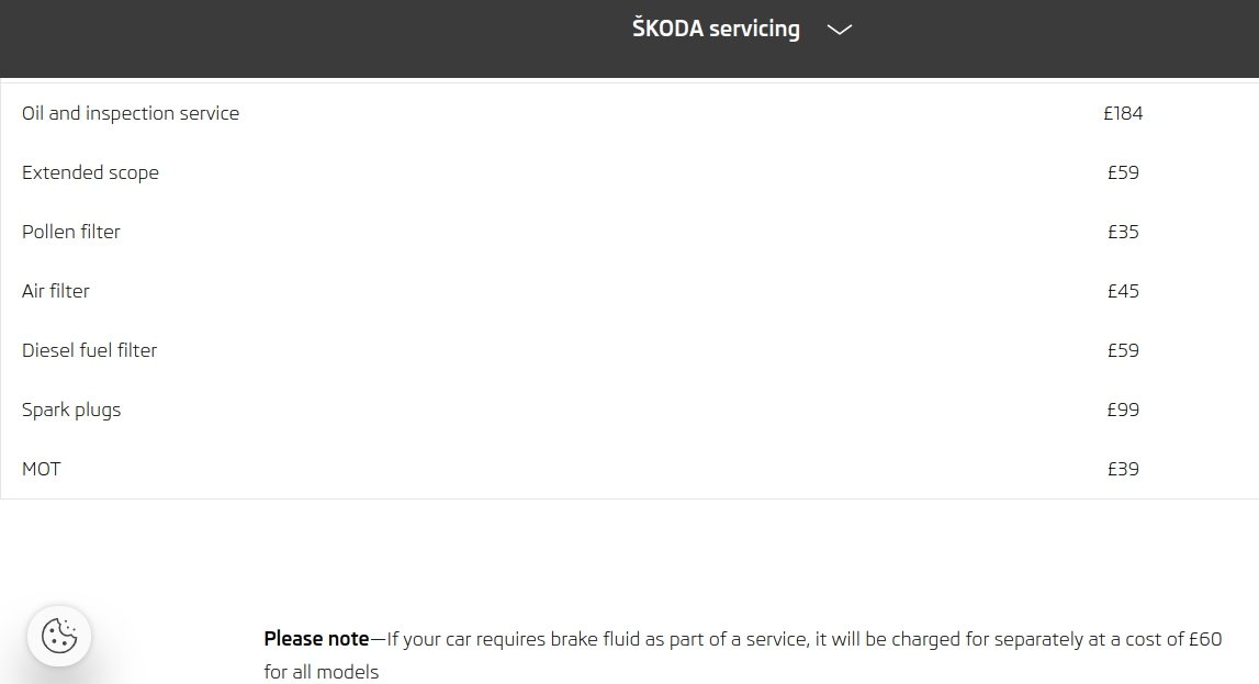

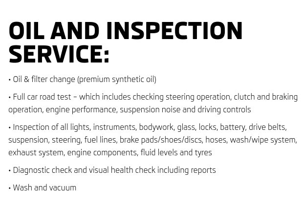

How it was with FIXED SERVICING before Skoda UK started showing Oil & Inspection Services & Extended Scope & 3 years then each 2 years.
*That is 2nd Major Service stuff, at a first Major Service as they called it the difference from a Minor / Interim Service was a Pollen Filter replaced.
Now at a Service that is something you get if you pay for it. Not included in the price of an Oil & Inspection Service.
827614452_SkodaFixedPriceServicing.JPG.3dbea7606c029076ed94e2f0216199b6.jpeg.689c25a185d90e4e44889f342770023b (1).jpeg

Hi all,
Sorry for the silence we have been waiting for various bits of information and dealing with a whole host of issues.
As an update the car is now confirmed as an import that was built for the Australian Market and has no certificate of conformity for use in the UK.
It is registered with the DVLA but not as an import.
Skoda UK confirmed because of this that they were unable to download any UK maps on to sat nav and weren't able to replace the OCU (Onboard Control Unit) to an EU version as they would not be able to code it to the vehicle.
So it
