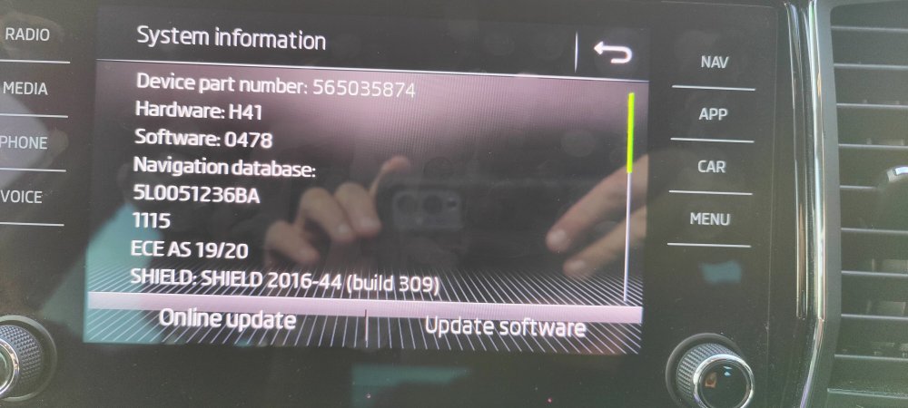

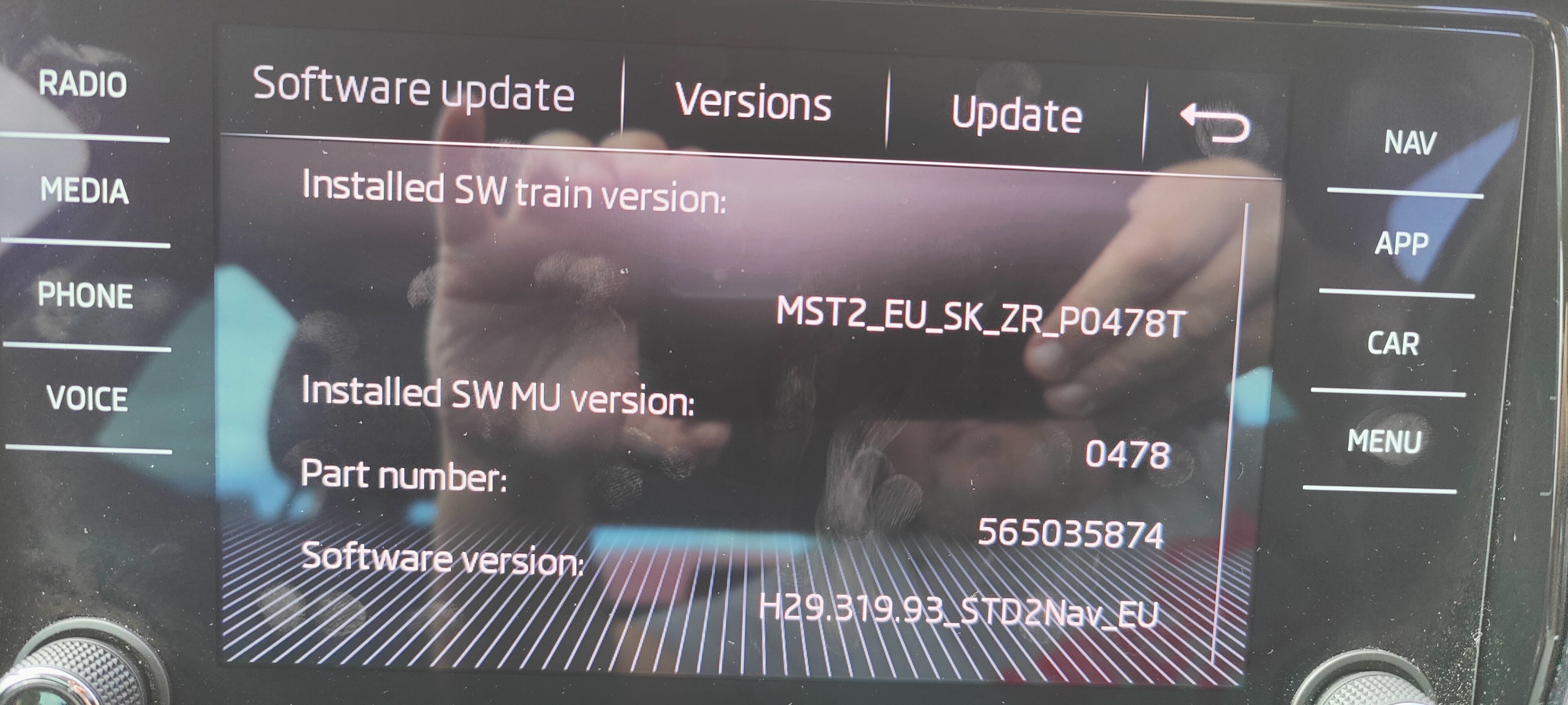

But odds are high that your software train is MST2_EU_SK_ZR_P0478T
Available is MST2_EU_SK_ZR_P0480T so a minor bump.
If it was working before and stable, and is now become hard to connect, then it's either cable as @john999boy mentions or the physical USB port has failure (bent pins or such)

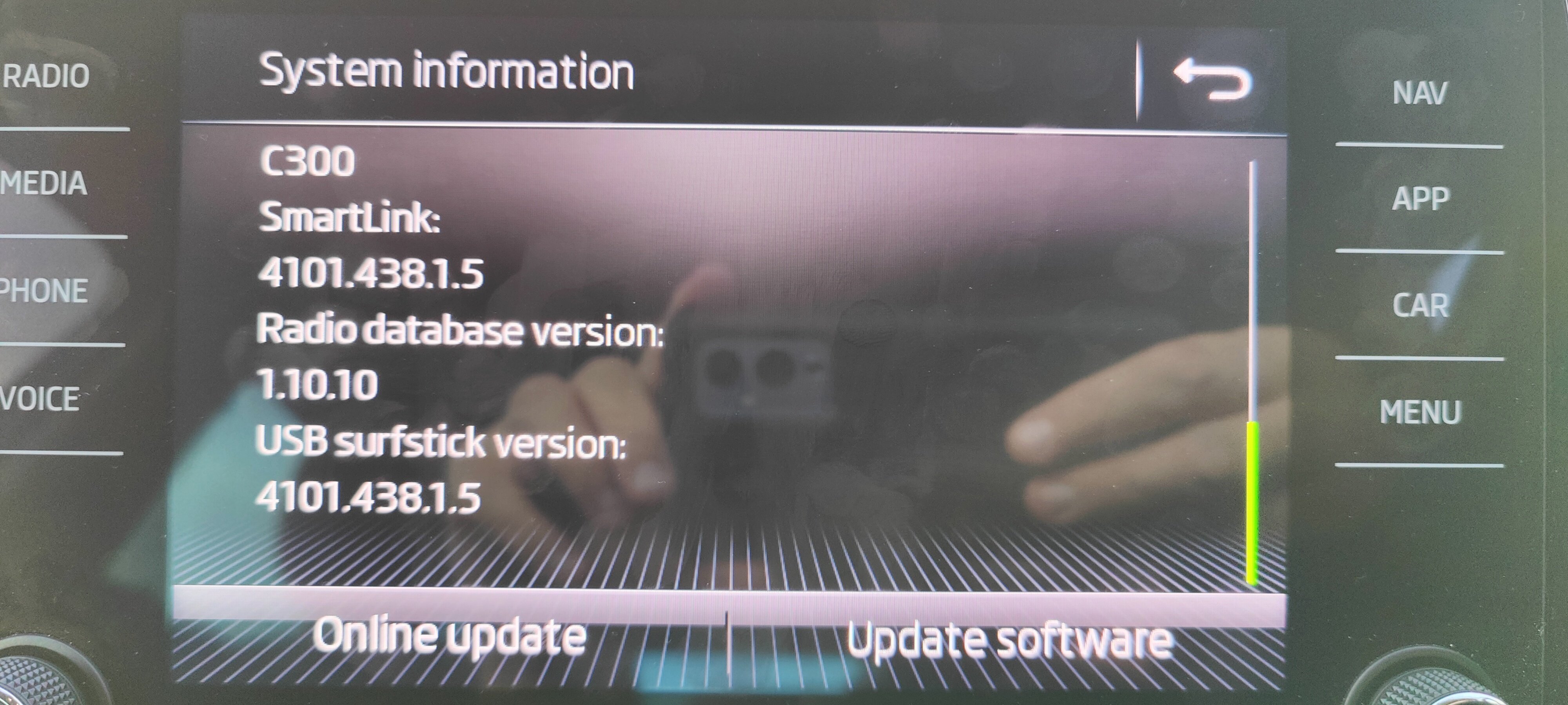

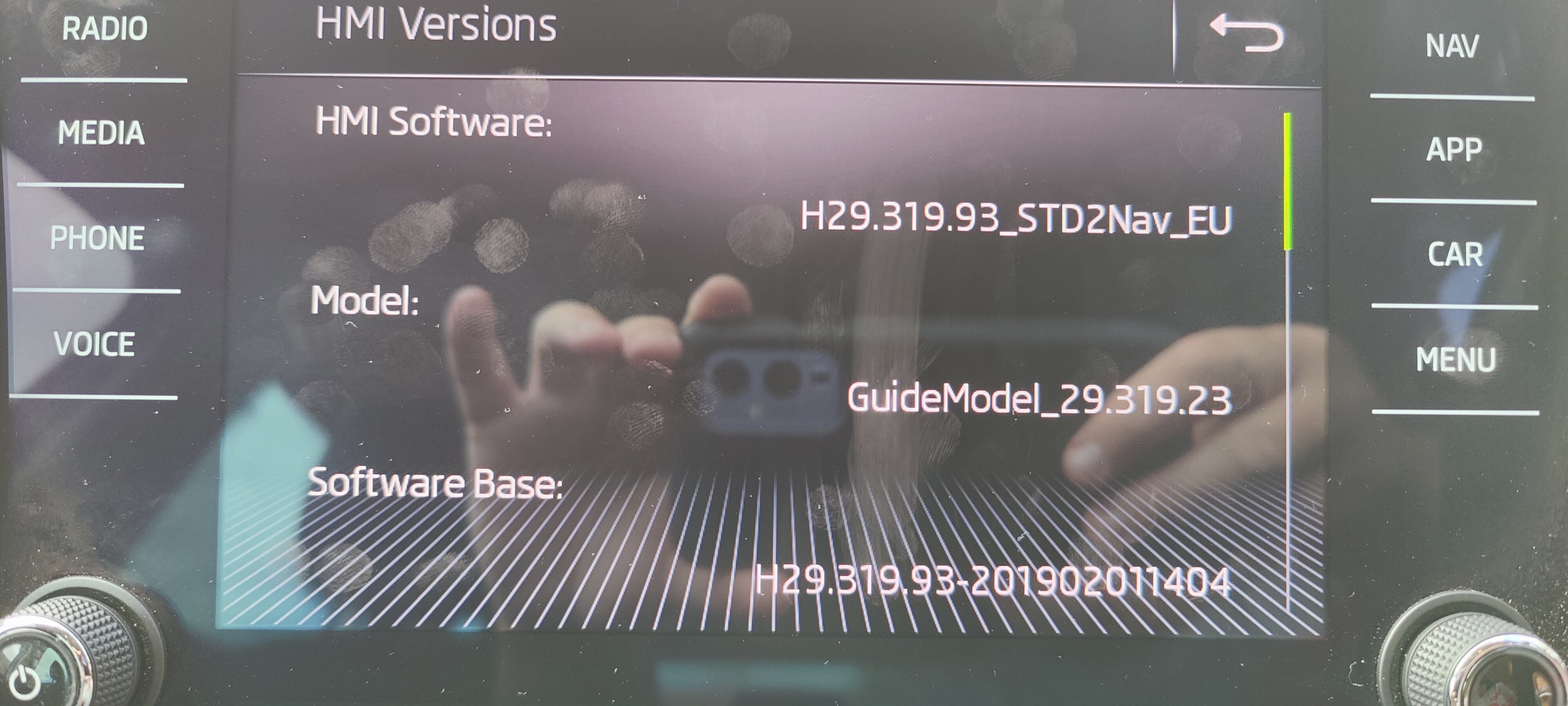

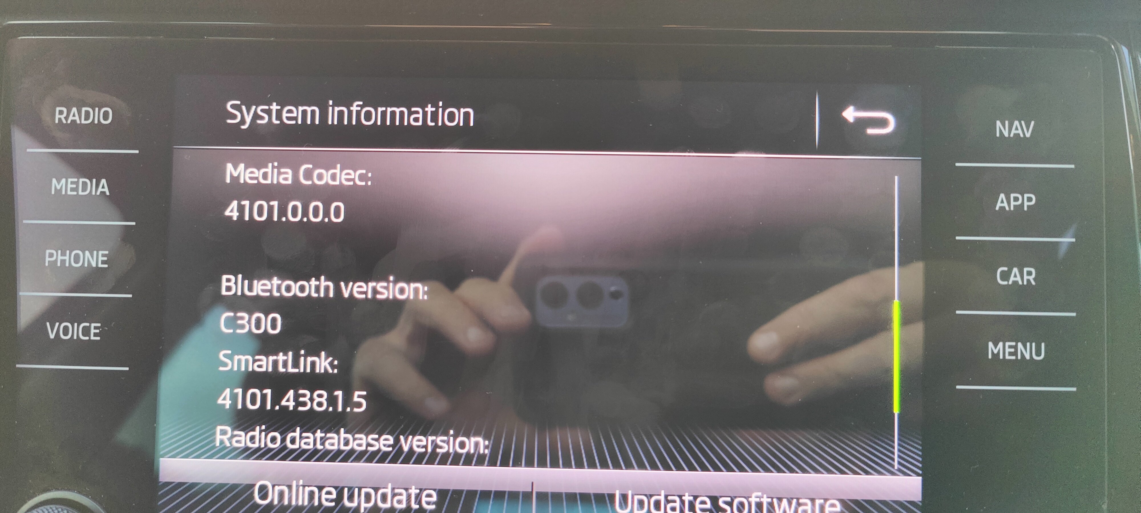

Hi folks , thanks for the replies .
Ive only just got the car , and i have tried different leads with both phones , and still happening
i have included software details , could you direct me for the software update plz
I will send you the firmware, but this does seem more of a physical fault with the acual USB socket (there is a TPI document so VAG are aware)
