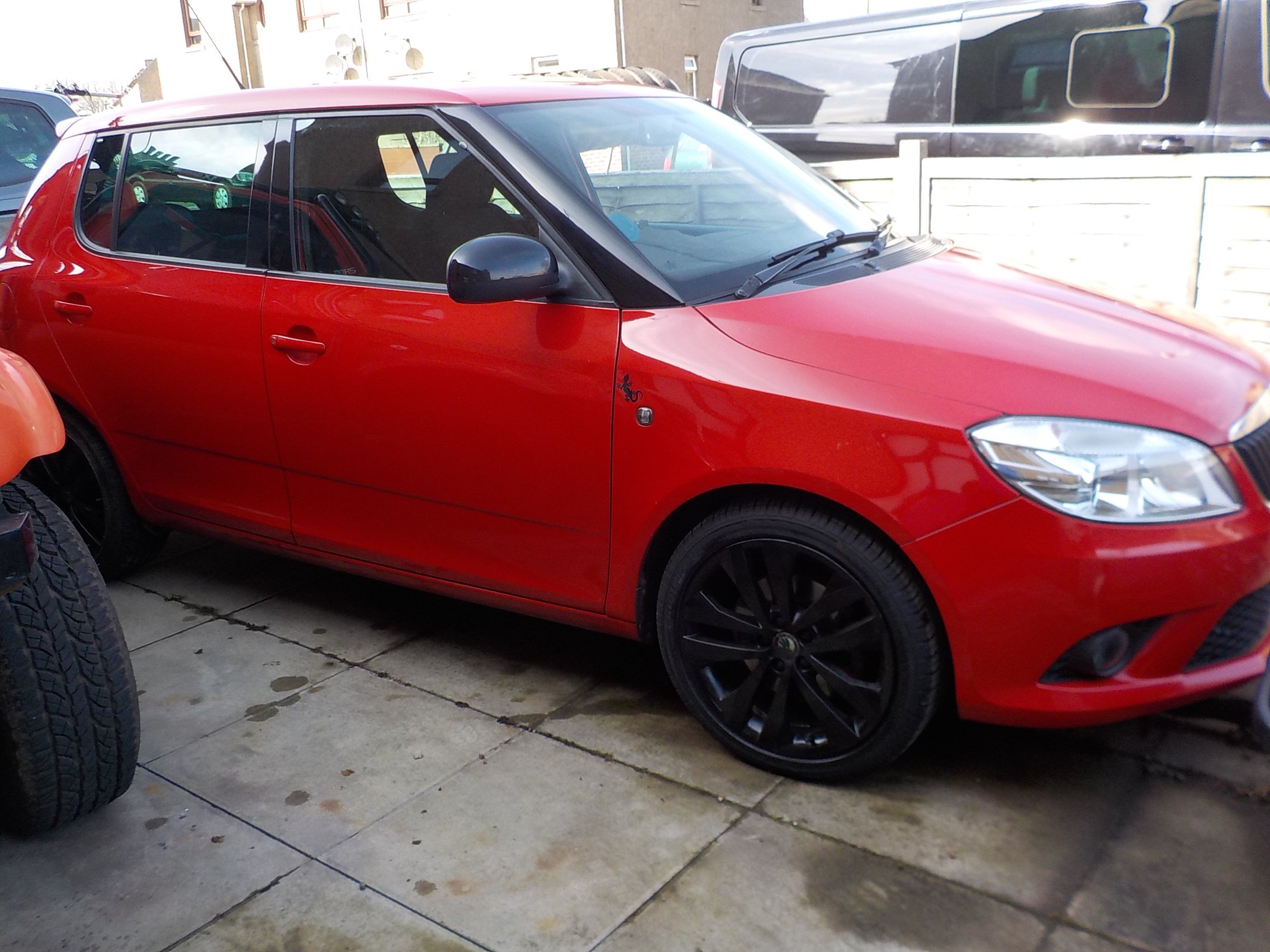

@nta16
Here we are talking Mk2 Fabia vRS Estate or even the hatch.
136 kW minimum and a DQ200 DSG.
Pretty crap suspension & brakes from the factory, narrower tyres than the sister cars from VW, SEAT & Audi got,
parts often shagged in 6 years let alone 12.  They did the job and some might still have the original parts.
Dealer fit option in the UK that people did as a Factory order was the Eibach springs instead of what Skoda called 'Sport suspension as OEM on vRS & Monte Carlos.
Edited by roottoot
