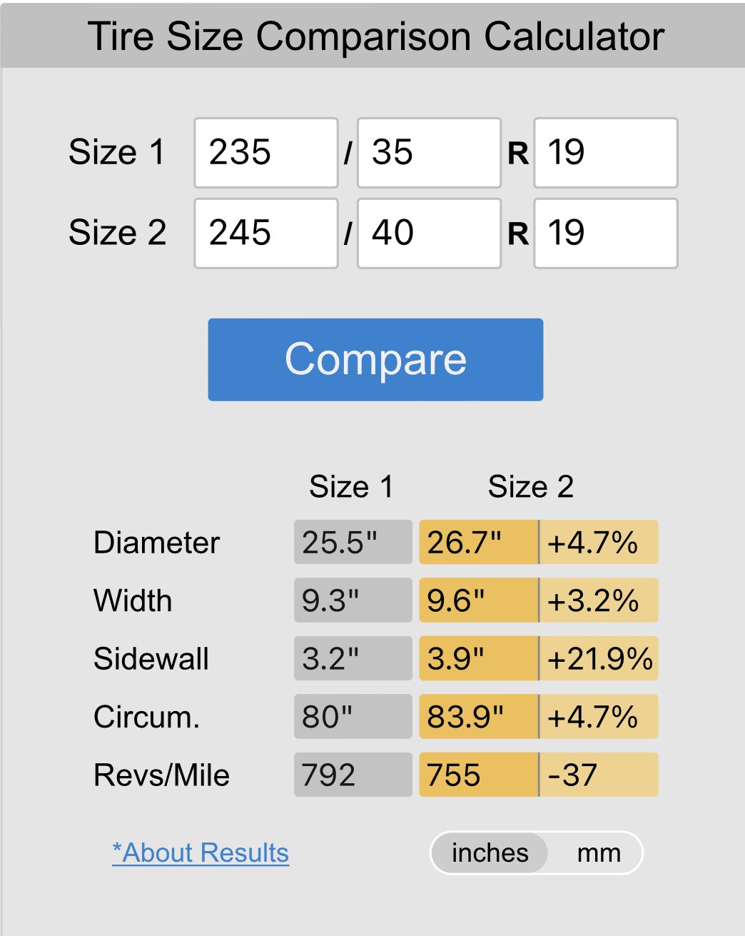

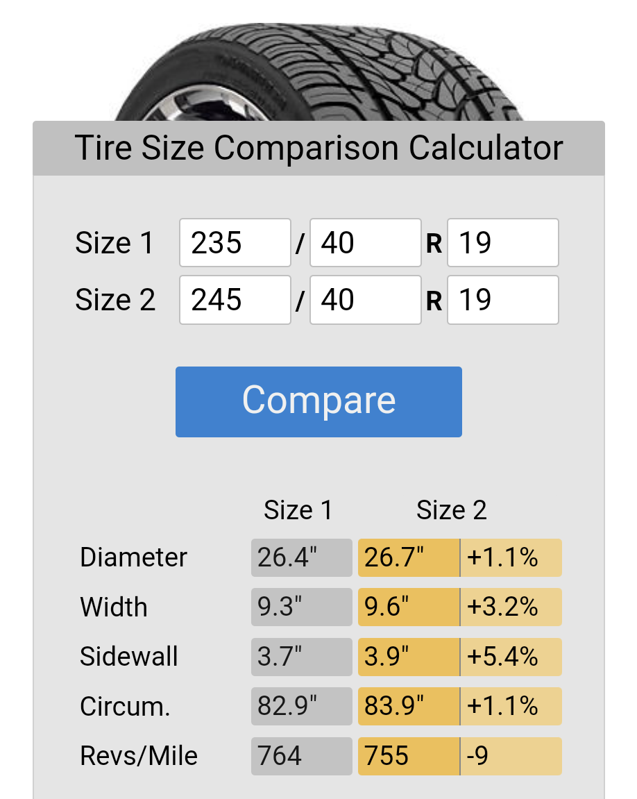

1 hour ago, numskull said:
PS - Would the increase in profile make any significant difference to the indicated speed?
Yes it will make a slight difference as the 245/40 has a larger circumference compared to the 235/40.
See tyre comparison below.
I found when I went up to 245/40 - the speedo reading was closer to the GPS speed.
Also, the 235/35/19 are NOT the standard size on the 272/280 models.
They also get the 235/40/19 size.  It's there on the tyre placard.

2 minutes ago, numskull said:
It certainly does!
235/35/19s are not OEM 272/280 tyre size as well bro. The OEMs size are 235/40/19.
245/40/19s are only 1.1% larger than the OEMs in diameter. While 235/35/19 are 4% smaller than OEMs.
And consider the speed shown on the speedometer is actually higher than real speed (100km/h on speedometer while the real speed is 97ish), go with 245/40/19 is a much better option than go with 235/35/19.
