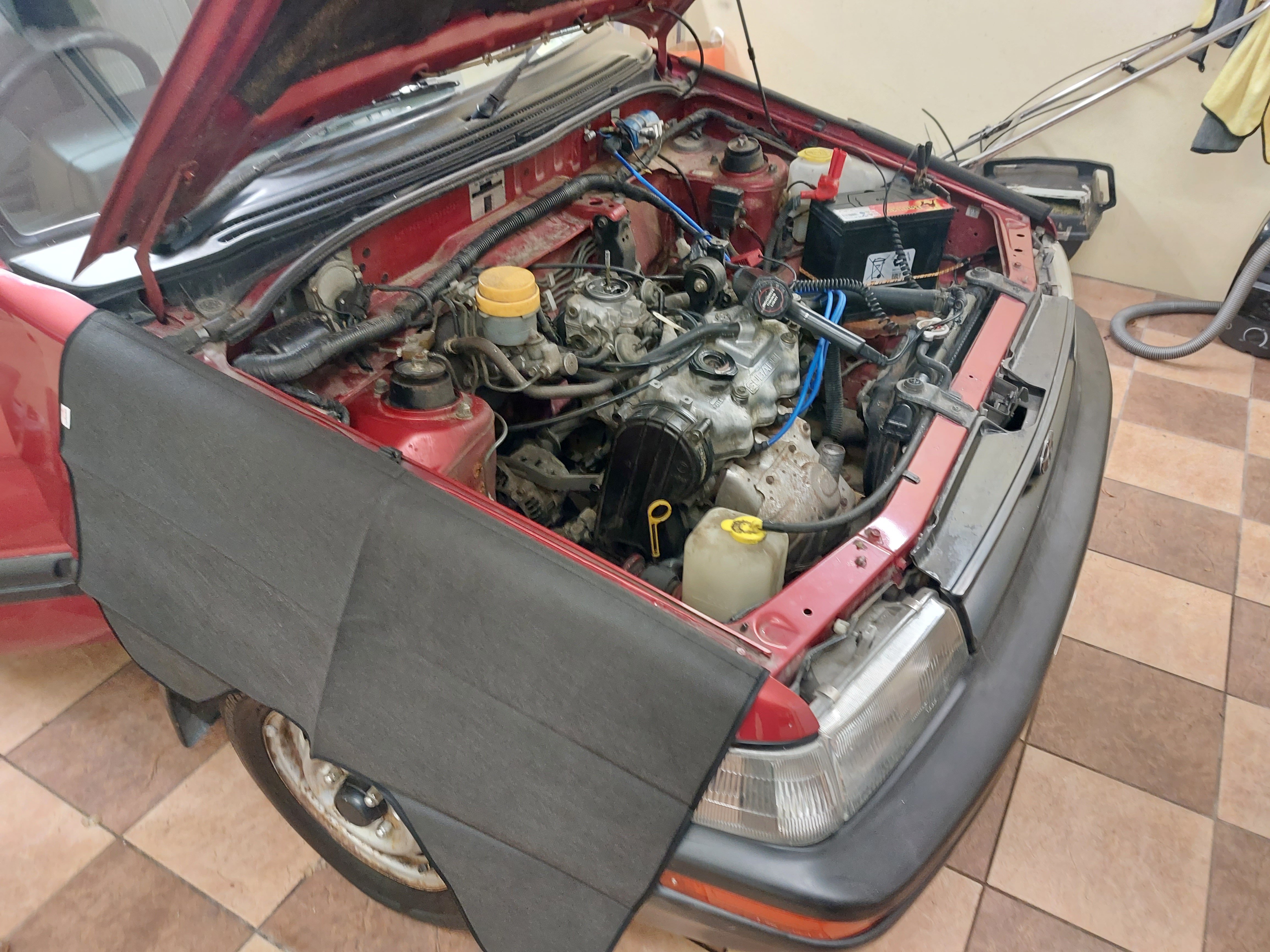

More Piccies
Needed to take it to put petrol in, have sussed the fuel float is stuck, will probably free itself up with some driving me thinks.
On advice from a friend I raised the idle, it tried to idle just around 500rpm before, raised to 1000 now.
Slow as anything and I did need to hold the choke a fair bit to get it to smooth out, but it is running, driving and amazingly, extremely comfortable.

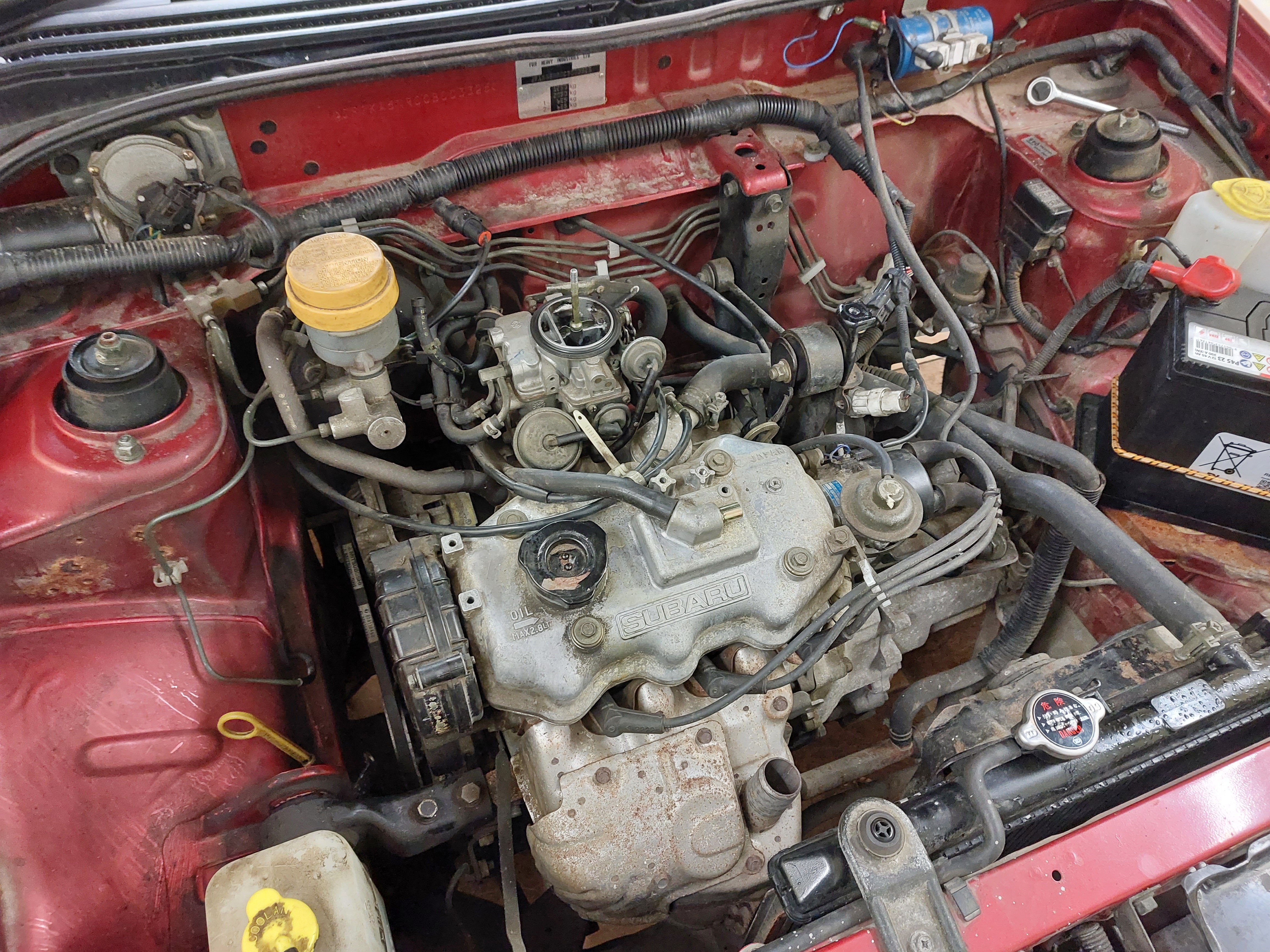

Went and got a timing light since I figure I'll need it for this at some point.
New air filter put on, old one was rotten
Have a big order of stuff for this coming in the next week or so.
Seems to be clearing itself out a little bit more.
Might have a thermostat stuck open as It takes a while to heat up while idling and the temp goes off the bottom of the gauge once you start driving and air gets through the radiator.
The closer to operating temp it gets the better it runs at part throttle.
The fuelling will be much improved if you sort out the thermostat, I doubt that it will need a new one, just some corrosion removing from the spindle or a foreign body removed from the valve orifice.
The original part if its serviceable will be better than any aftermarket one.

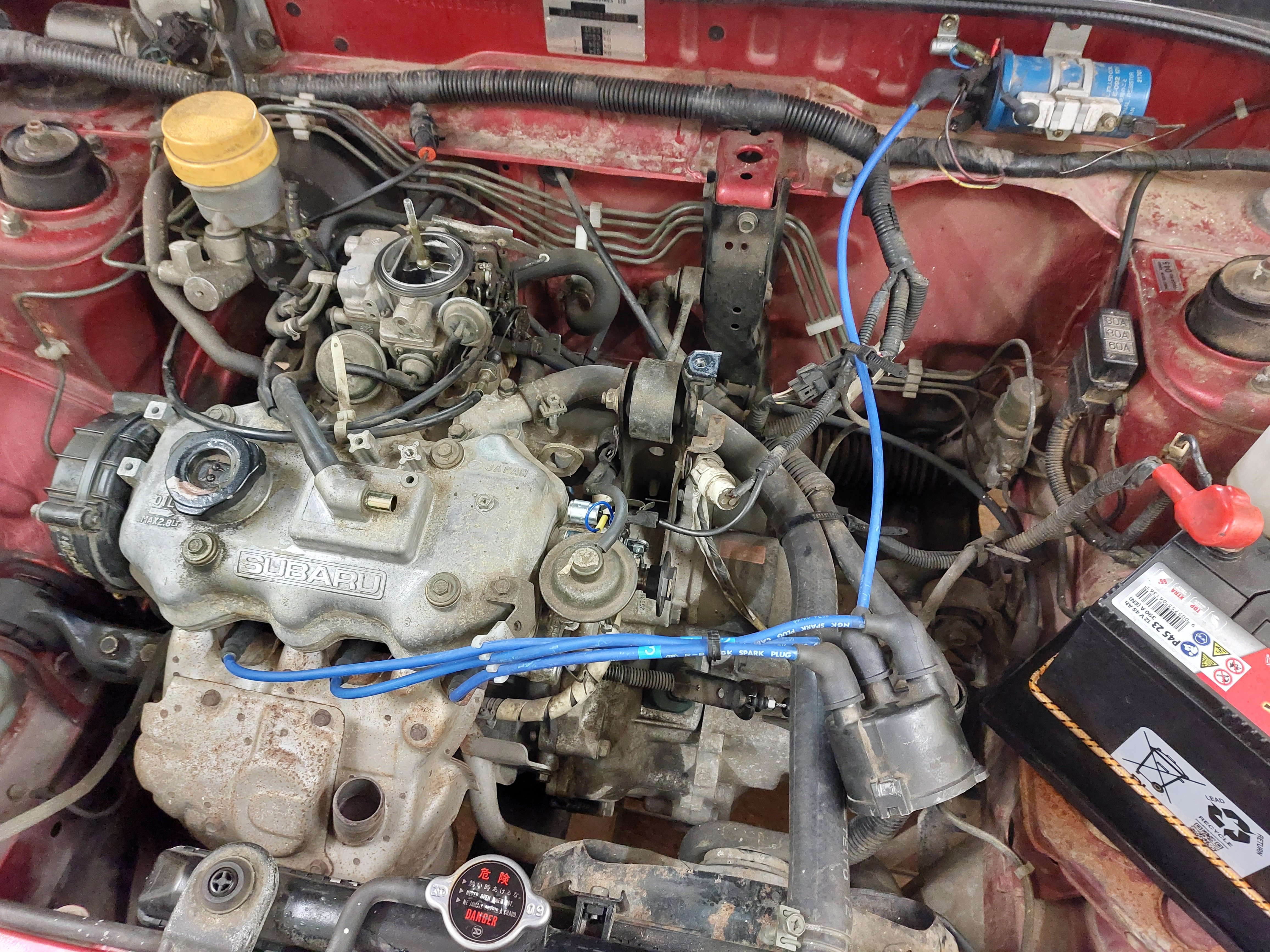

Update time:

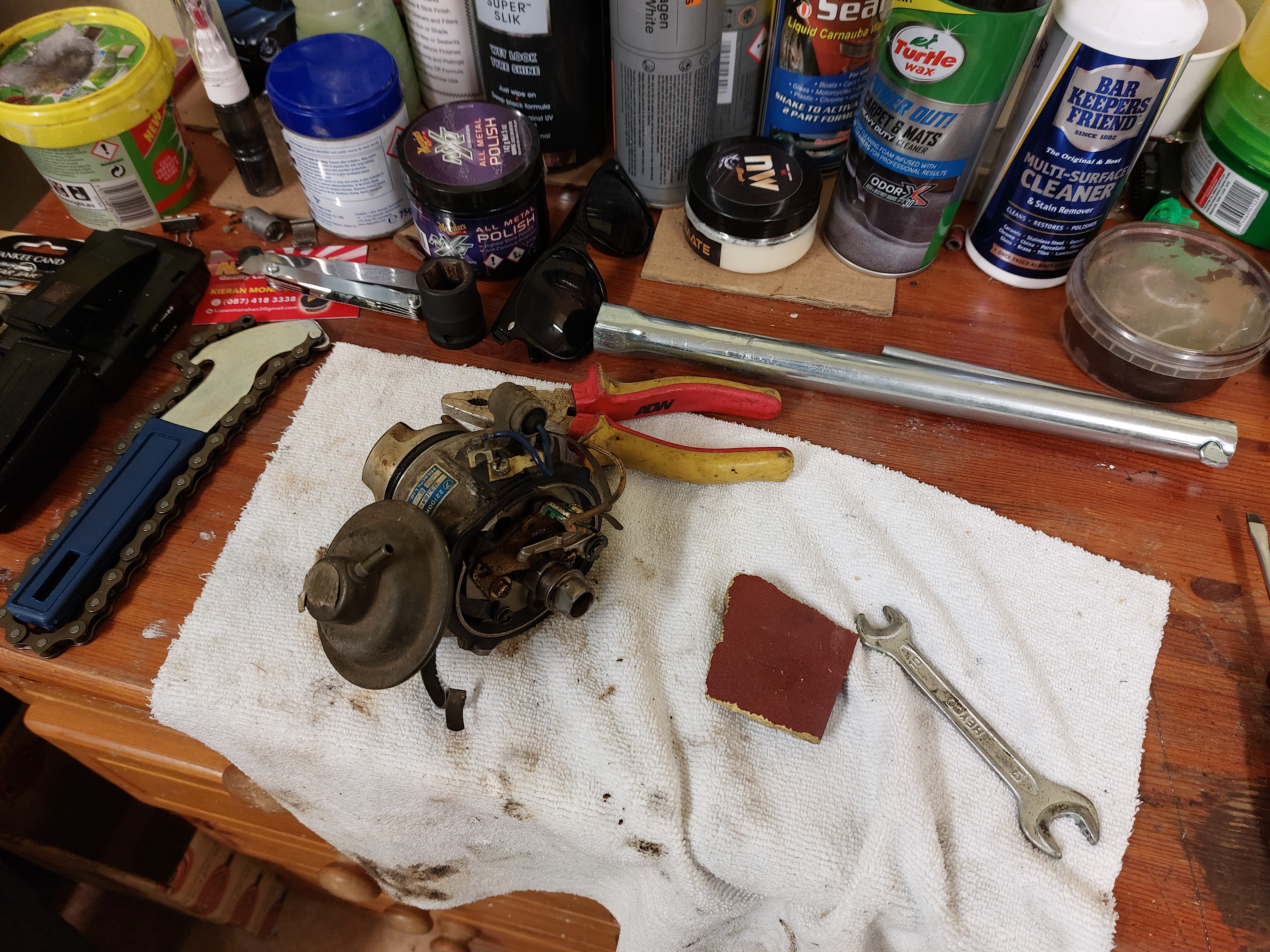

Had this thing idling away in the garage and it just died on me and wouldn't restart. No spark.
Day after that I got my big load of parts so saw to putting them on.

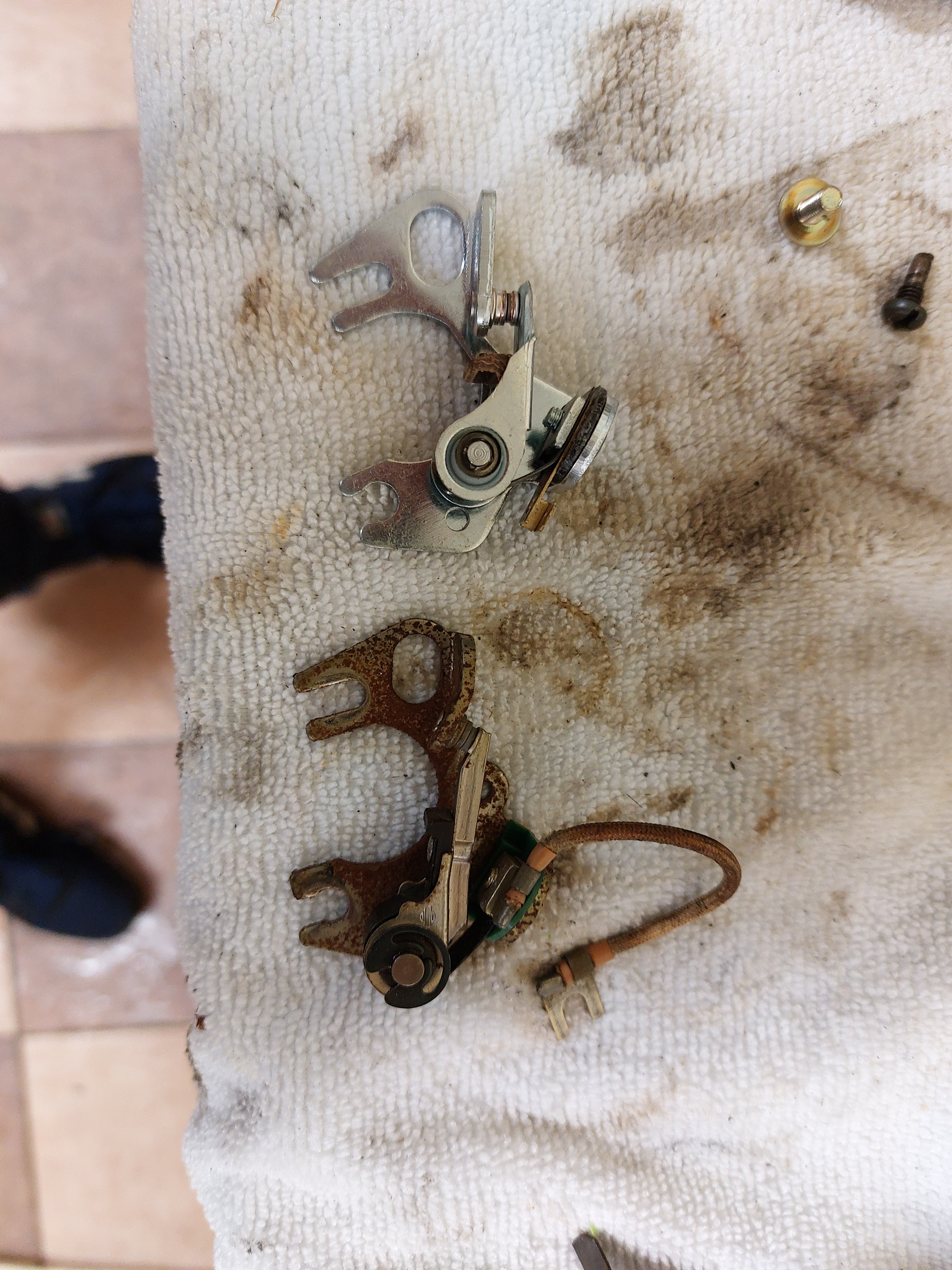

New HT Leads
Points
Did take the distributor off to fit them because the screws holding the Points in were ready to strip. Marked it so timing should be relatively close to before.

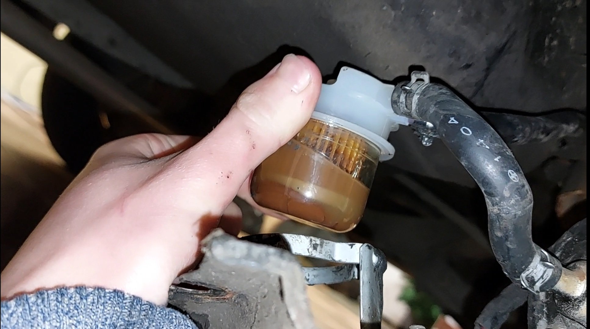

Checked the fuel filter I put in a few weeks ago, definitely doing its job, have yet another one I'll replace it with soon.
Still no spark, however I have it narrowed down to the coil. Traced the positive wire to the coil and put the timing light to it.
Lead up to that white box. Just to be sure I did the same to the wire coming from the other side of the box that goes onto the positive of the coil.
So It's getting power to the coil, but no power comes from the big lead that goes to the distributor.
Have a coil ordered, should be here Tuesday.

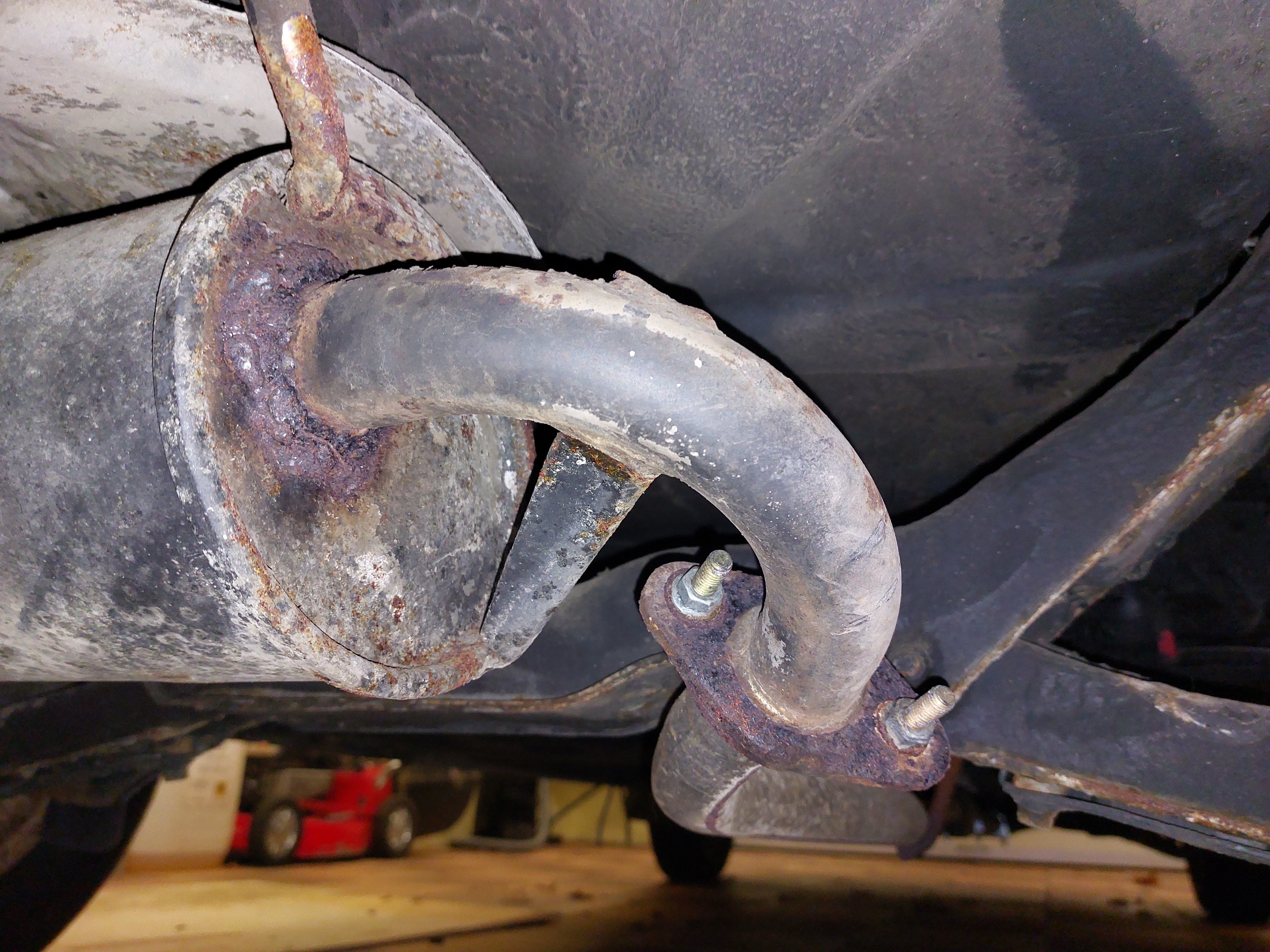

One more thing to mention.
Said before the backbox was solid but just the tailpipe looked crumbly
I was very much wrong there.
It's leaking from the gasket and on the weld where the exhaust goes into the backbox.
No wonder it sounded so angry.
To fit the backbox I got I'll need to have the mid section redone as it goes from 2" at the manifold down to 1.5" to the rest of the system. My backbox is a 2" one. It's a more or less straight piece of pipe from the manifold to the backbox so shouldn't be *too* expensive.
Should sound quite nice and maybe even give a bit more pep when it's done.

  1. I really wish I could remember who it was on here who claimed that "petrol engines don't need fuel filters".
  2. I'd agree the missing HT spark is coil, cap or rotor arm, unless you've misconnected the new points?
14 minutes ago, KenONeill said:
Matters arising:-
What Knob said that?
Most of that is probably coming from it being run with low fuel (and old fuel) for a bit.
Should be about 20l of fresh fuel in it now. Have been chucking Redex down it too to try clear things out.
Points are connected as the old ones were, did take photos to help remember what wire goes where.
That filter is literally weeks old but considering how cheap they are I think I'll just keep changing them until that ****e is cleared out of the tank.
Just checking - did you make sure you gapped them correctly?
Gaz
Gaz
Manual states they're to be gapped between 0.45mm and 0.55mm. Split down the middle at 0.50mm
And that makes me wonder what the dwell angle is; it would be unusual to have that big a range.
Looked through the manual again to check.
Doesn't say anything about dwell.
