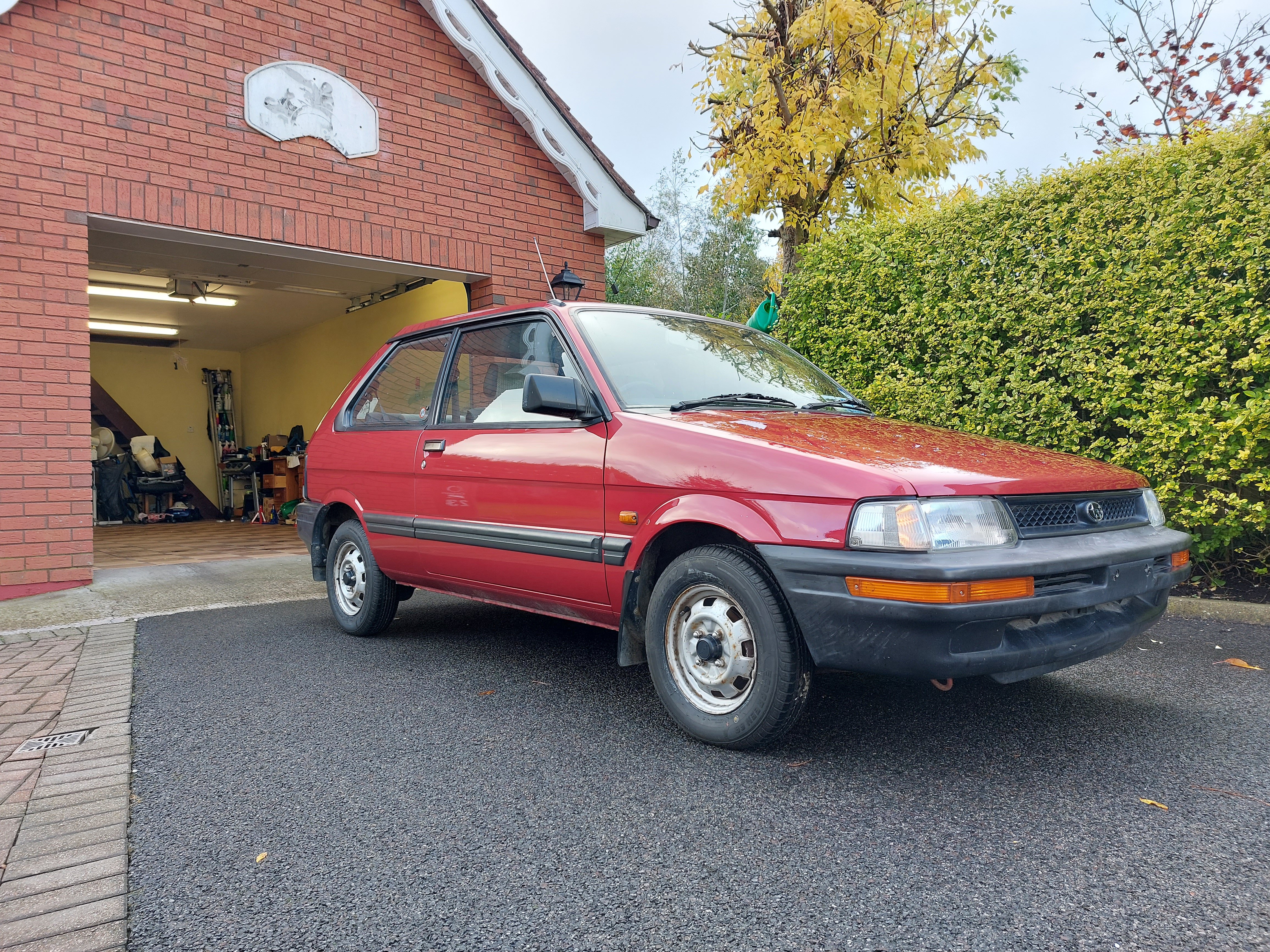

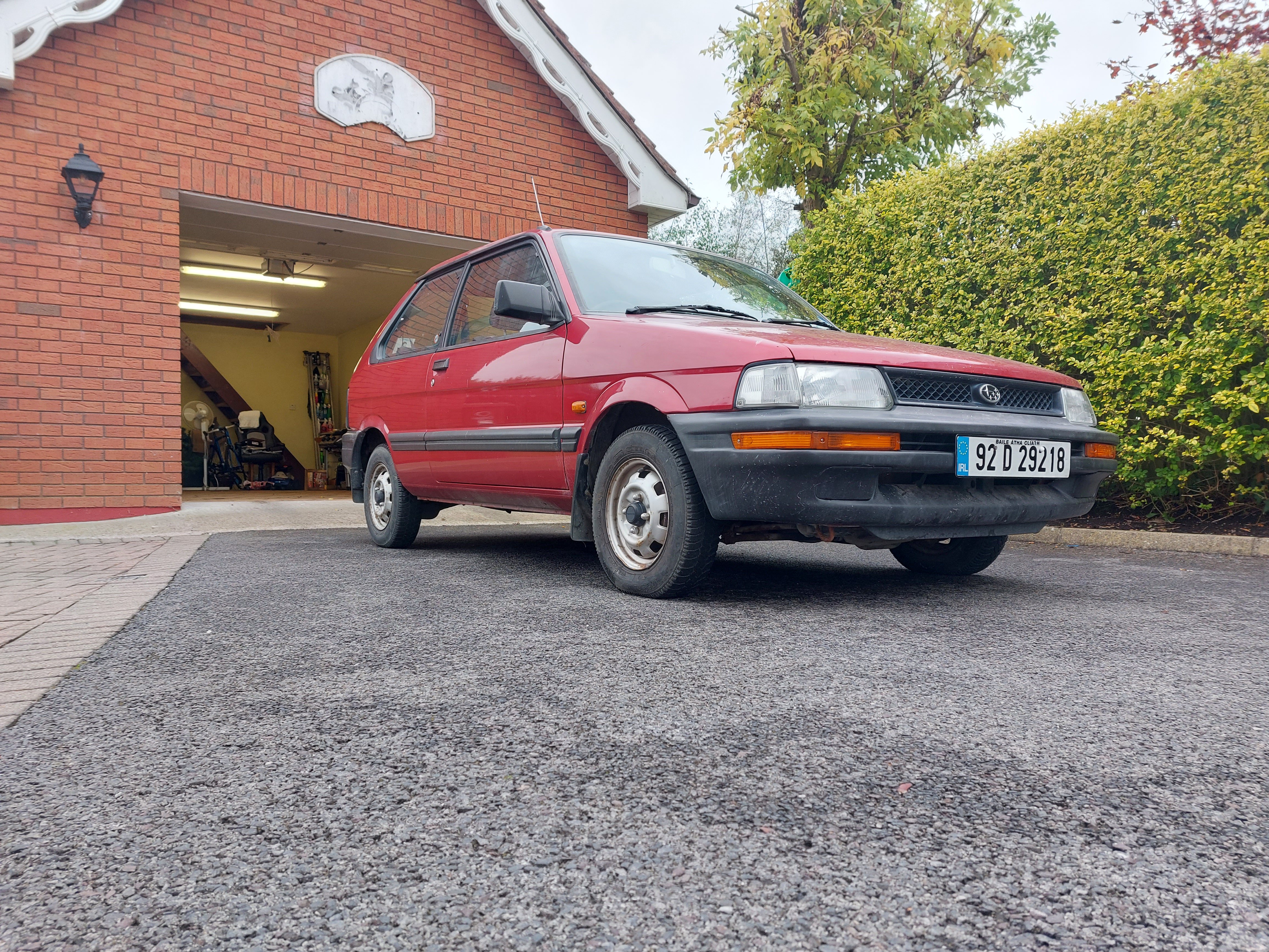

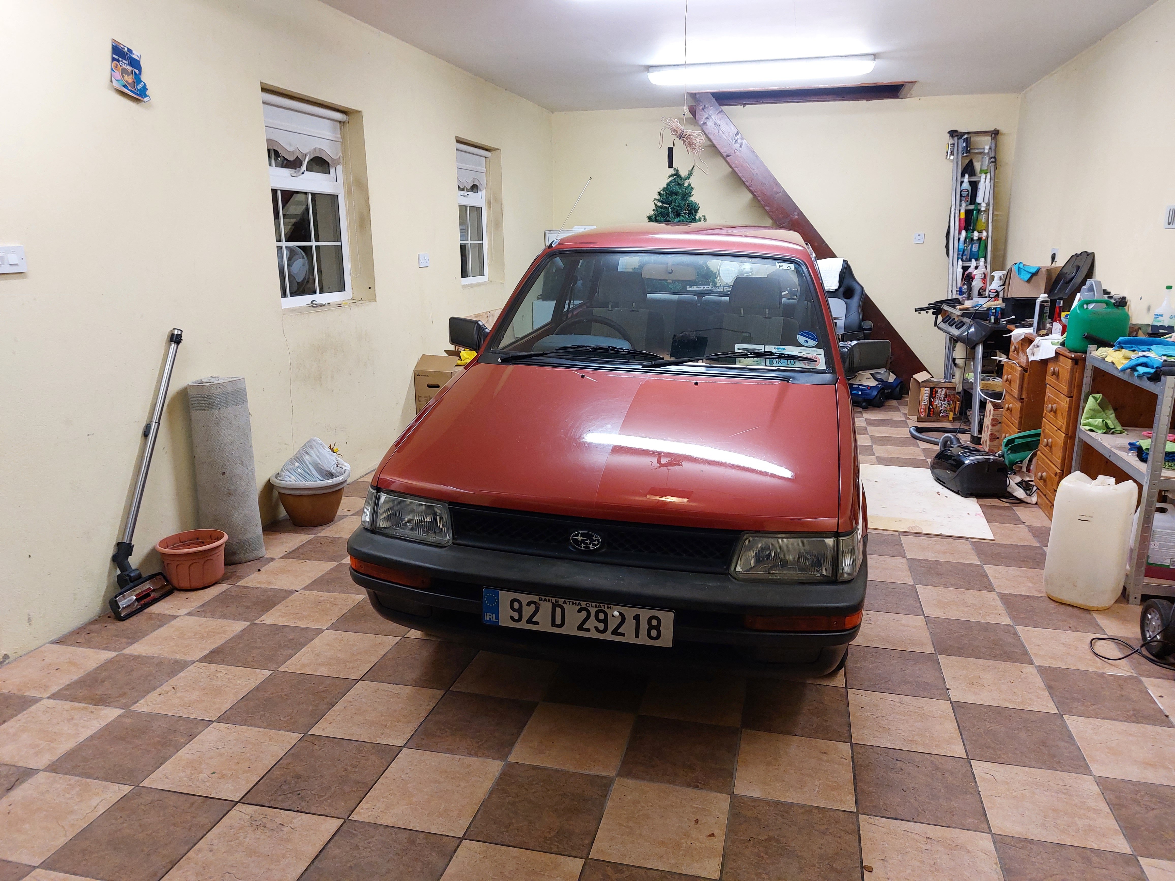

This is my new to me 1992 Subaru Justy.
It's a 1l Carbureted version and while most were 4wd, this one is front wheel drive.
It is a one owner car with 37000 miles, bought new from my work in 1992.

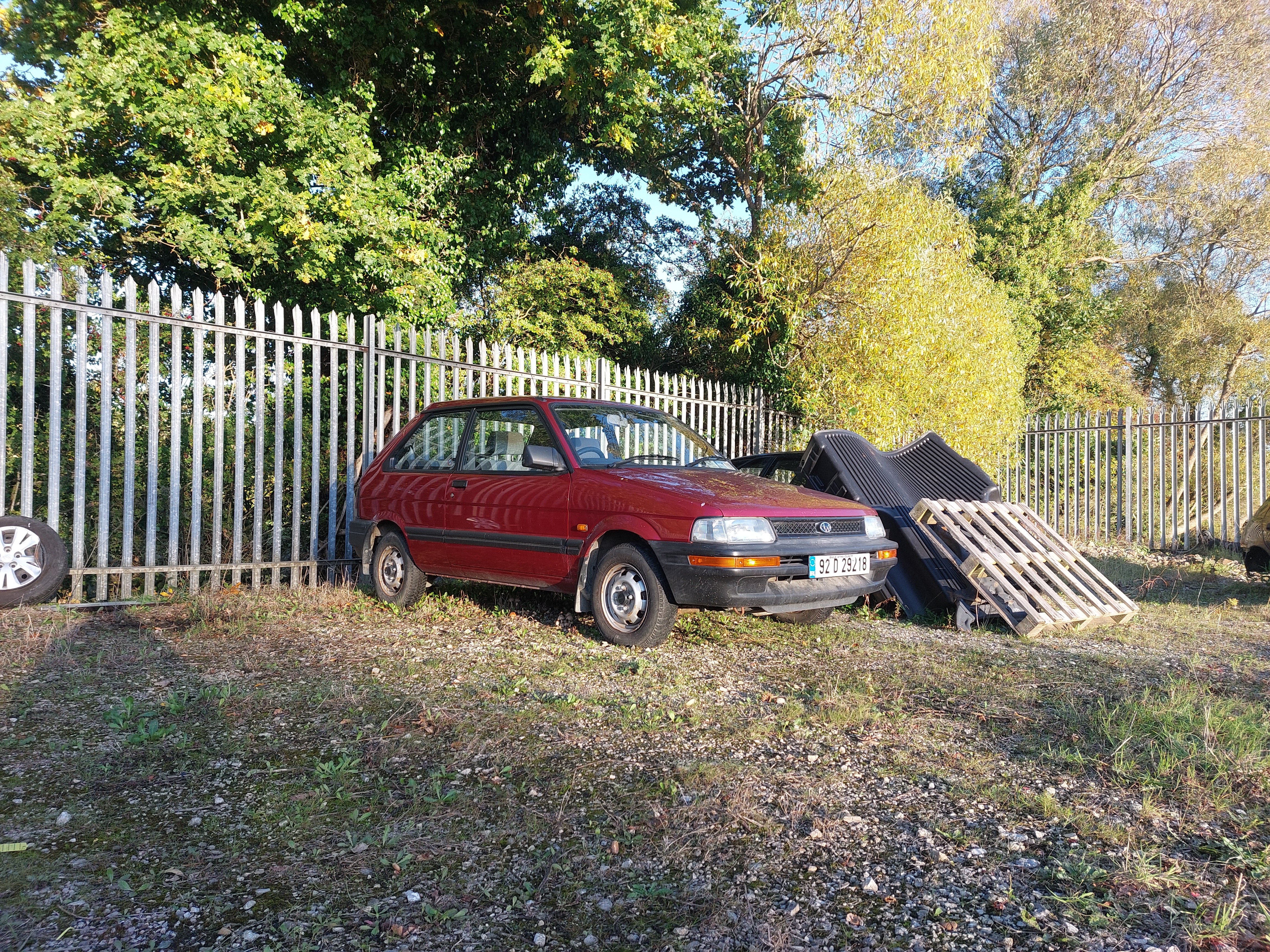

Has been sat in a barn since 2010, started up and drove back to my work. Very stale fuel in it but it runs and drives well considering.

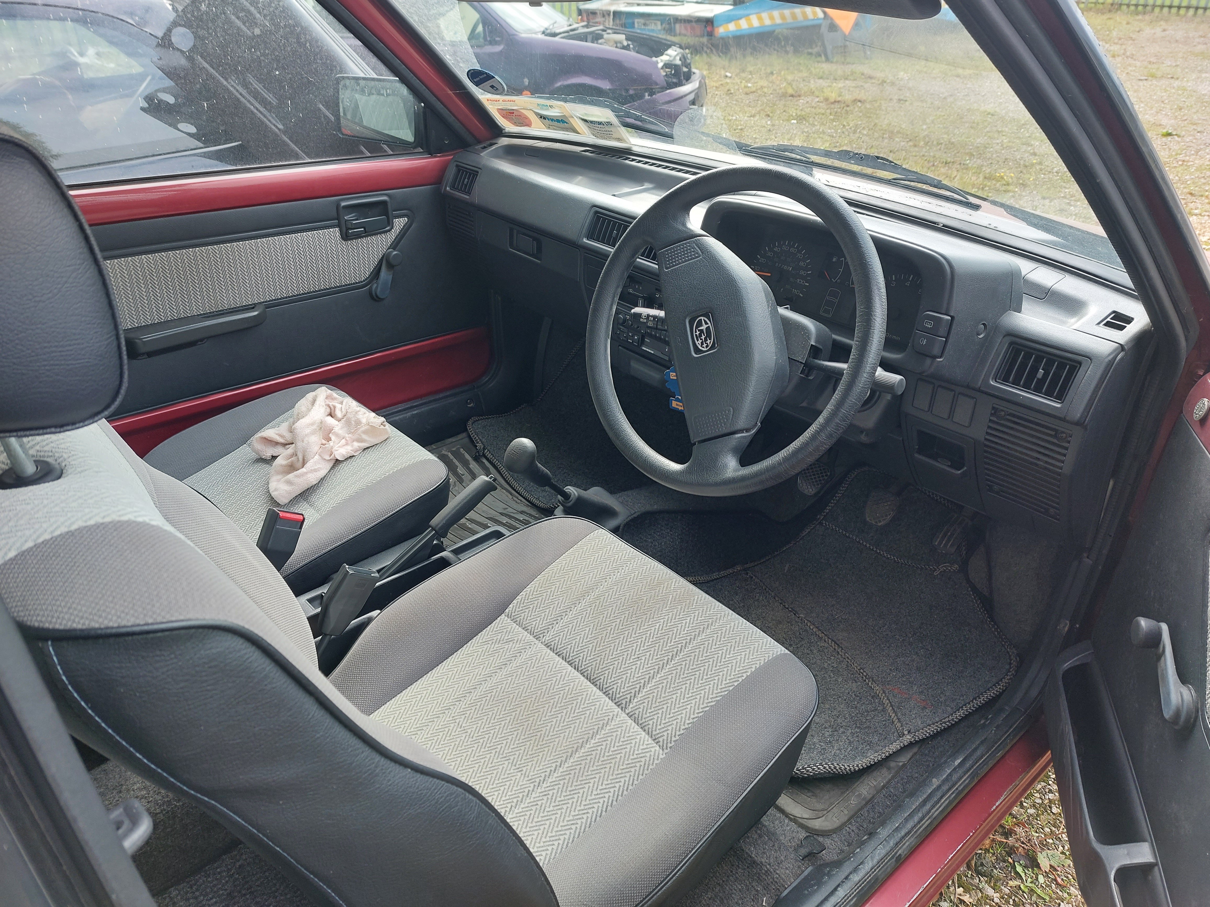

Interiors like new inside

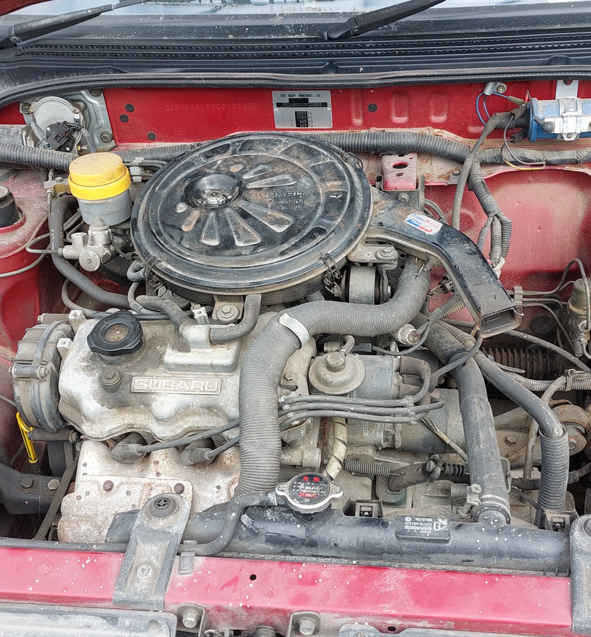

Engine bays dirty but original.

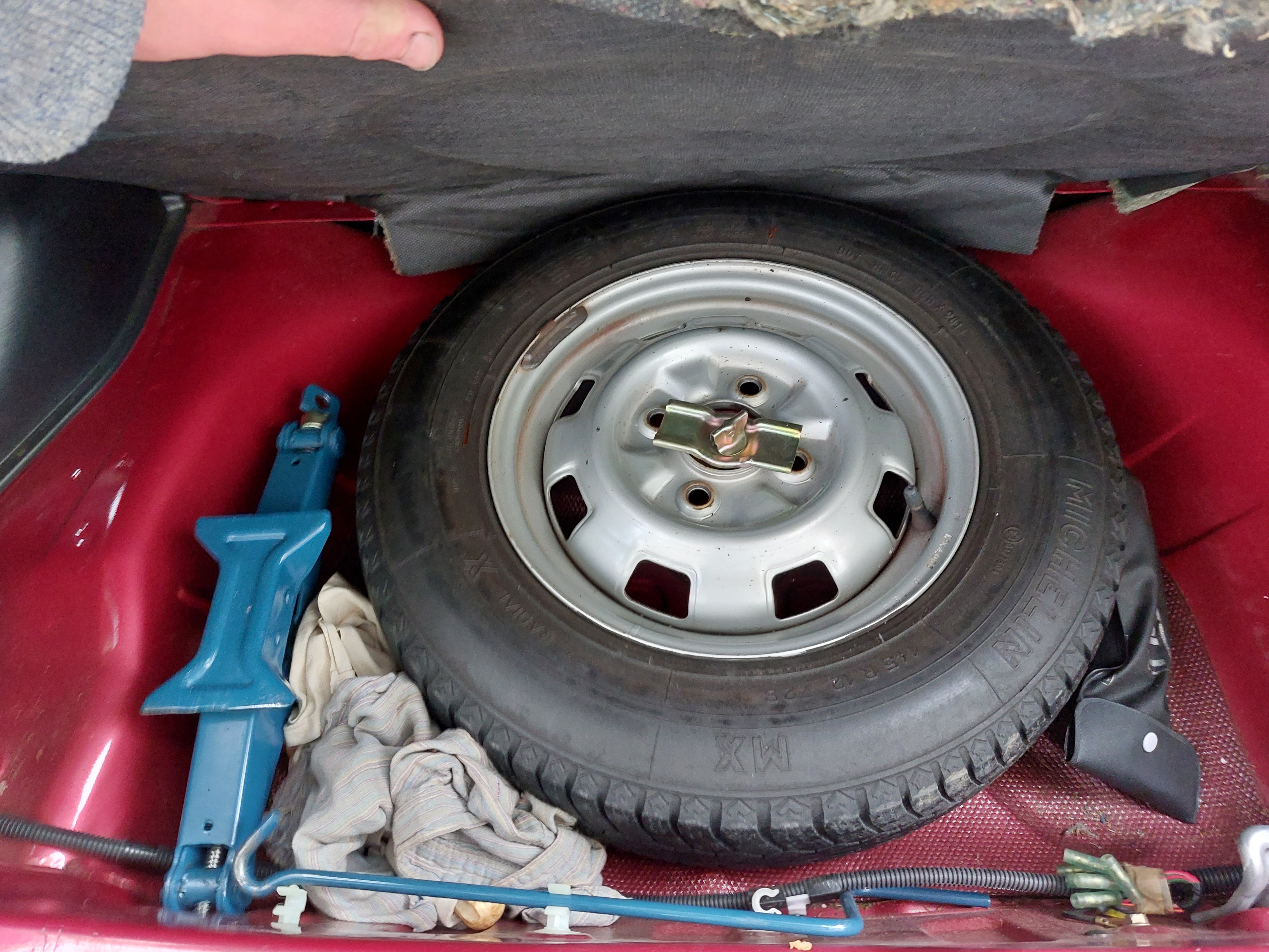

Original Spare tyre even
Did sit outside for about a week before I could get it home, happily seems pretty watertight.

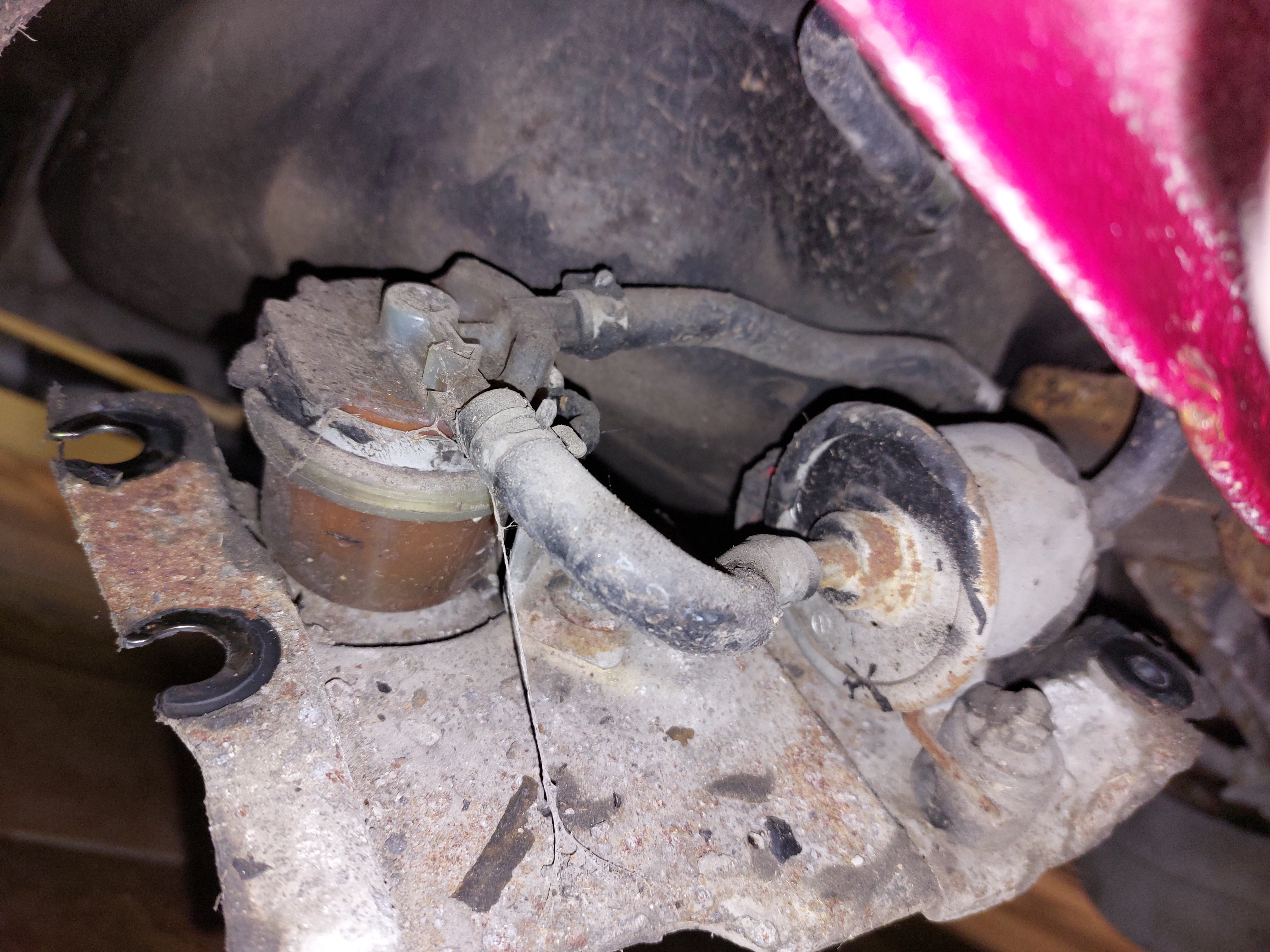

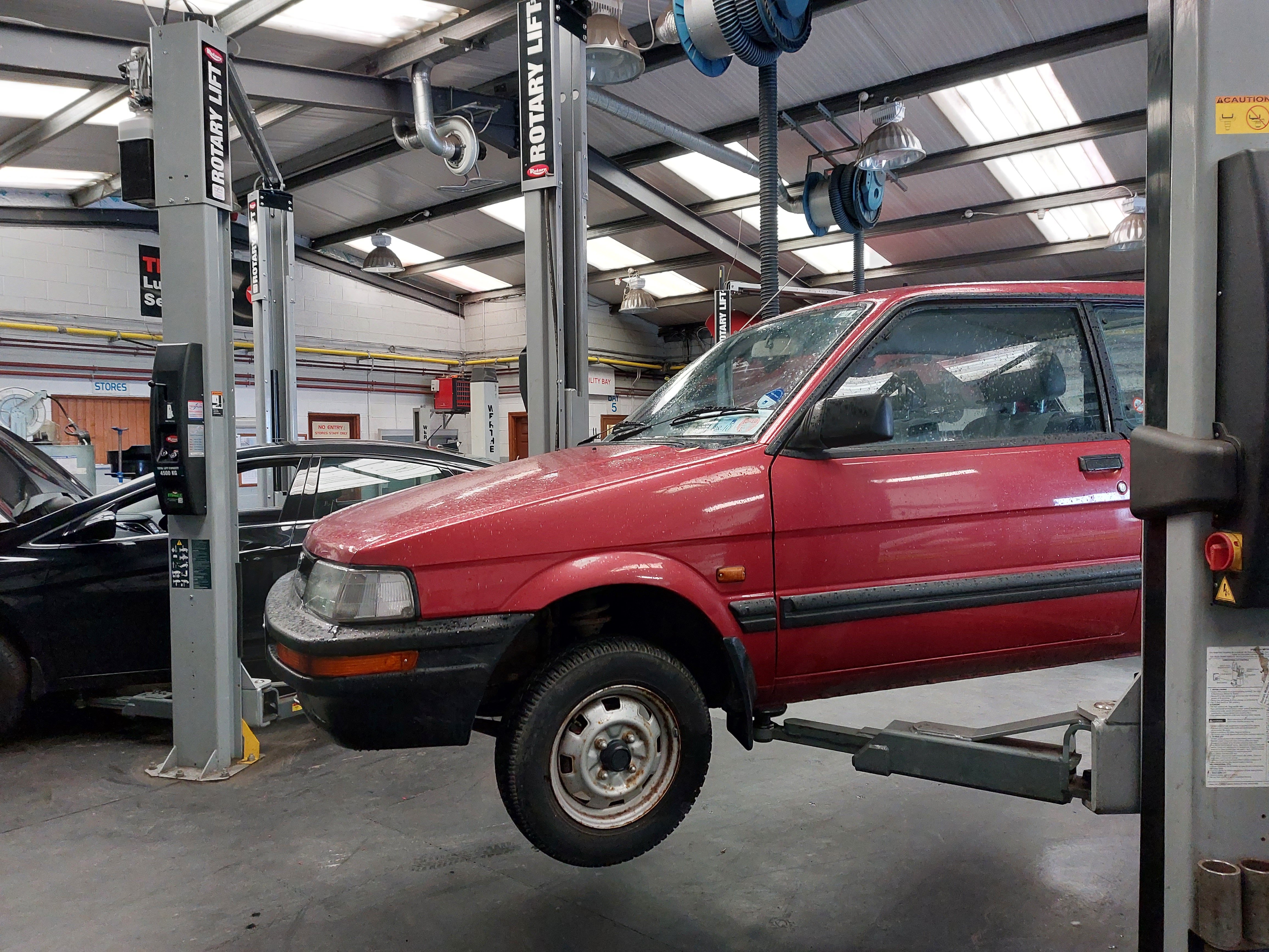

Up on the lift before I got it home, solid underneath and the mid section of the exhaust is brand new.
The weather turned ****e so it went into the garage later.

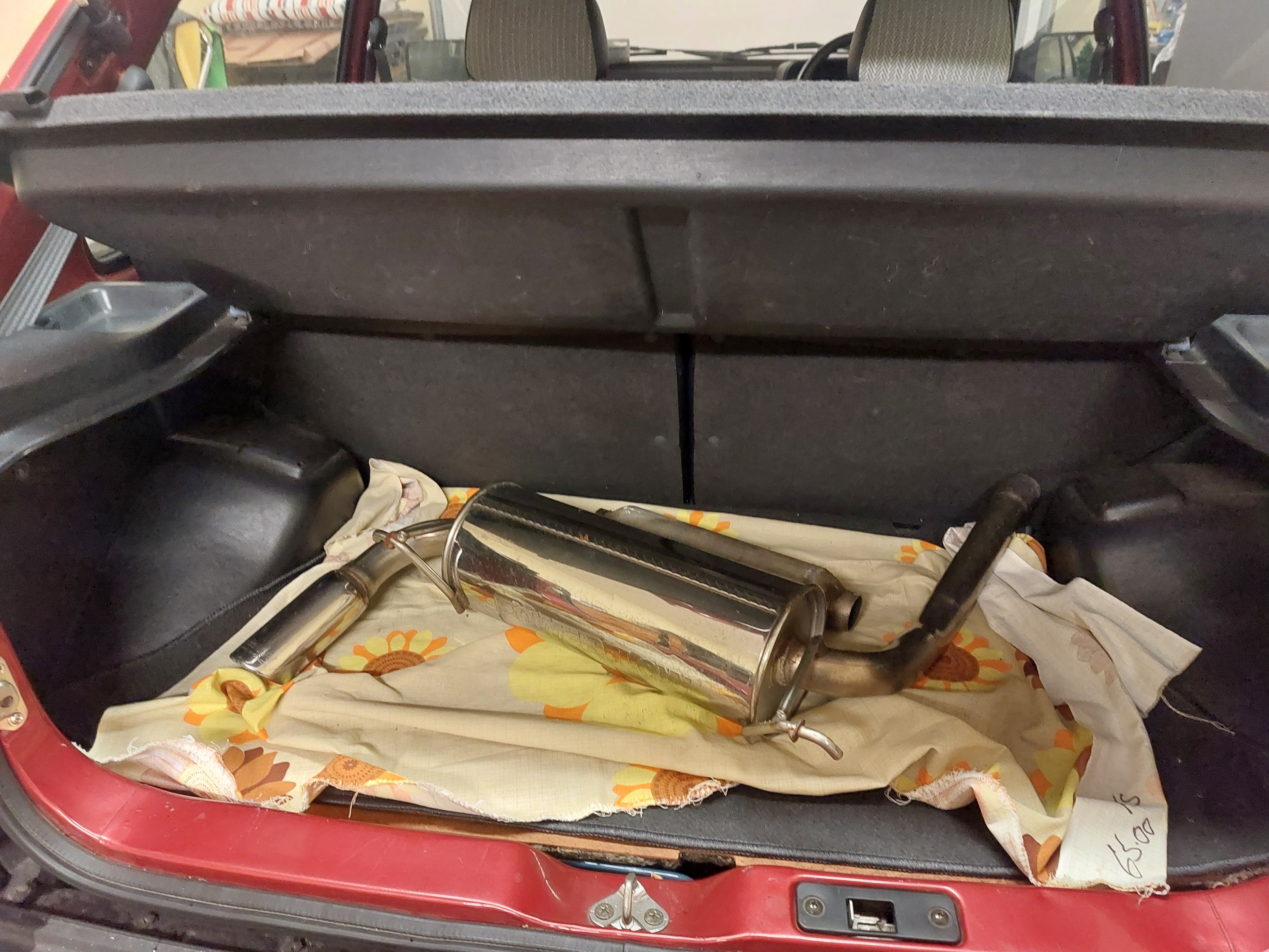

Not long after I took this pic, I took a quick trip to roscommon to pick up a powerflow (stainless) backbox for this, the backbox is actually solid but the tailpipe looks a bit crumbly.
All I have done to it so far is put a new battery in it.

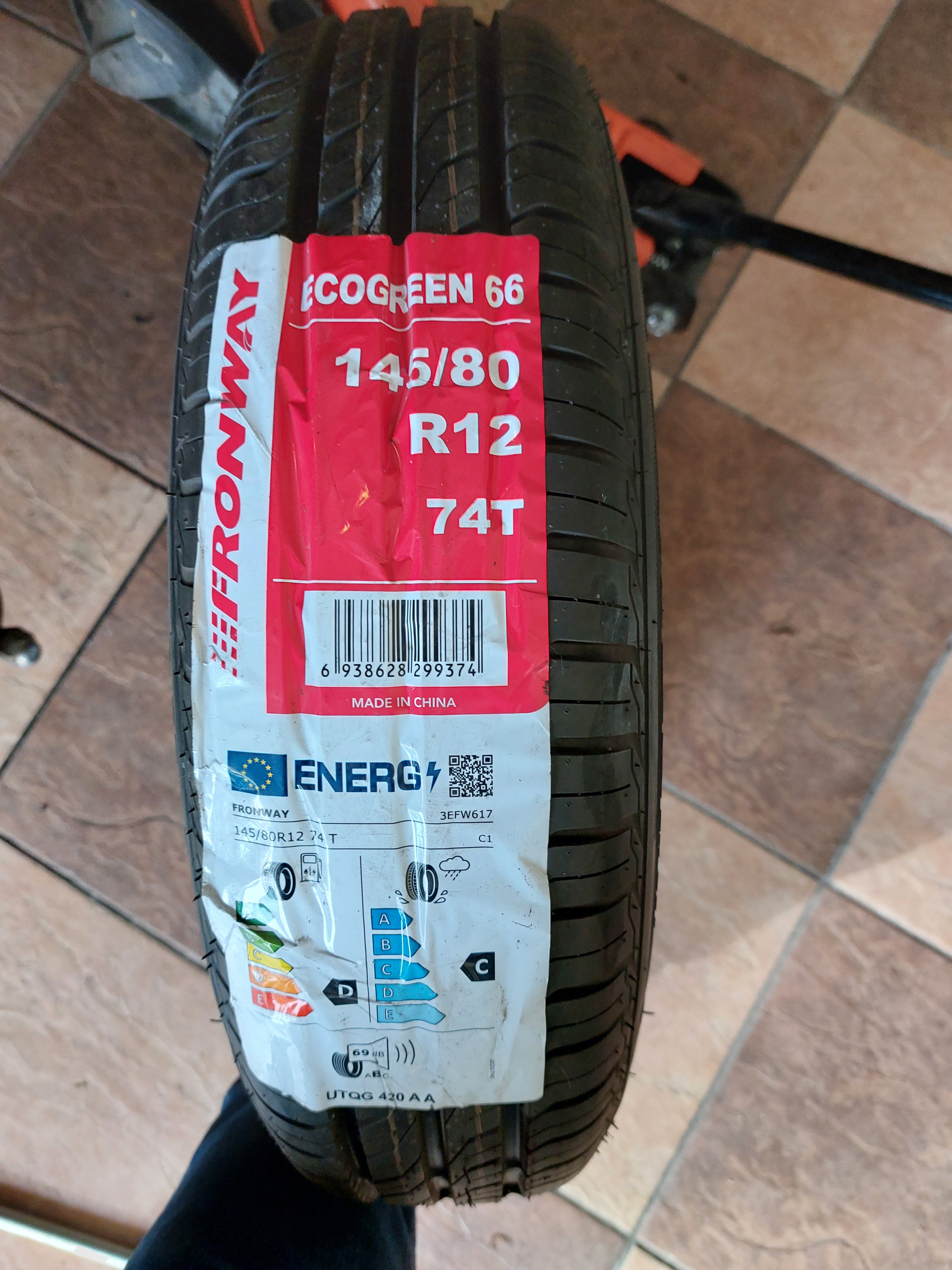

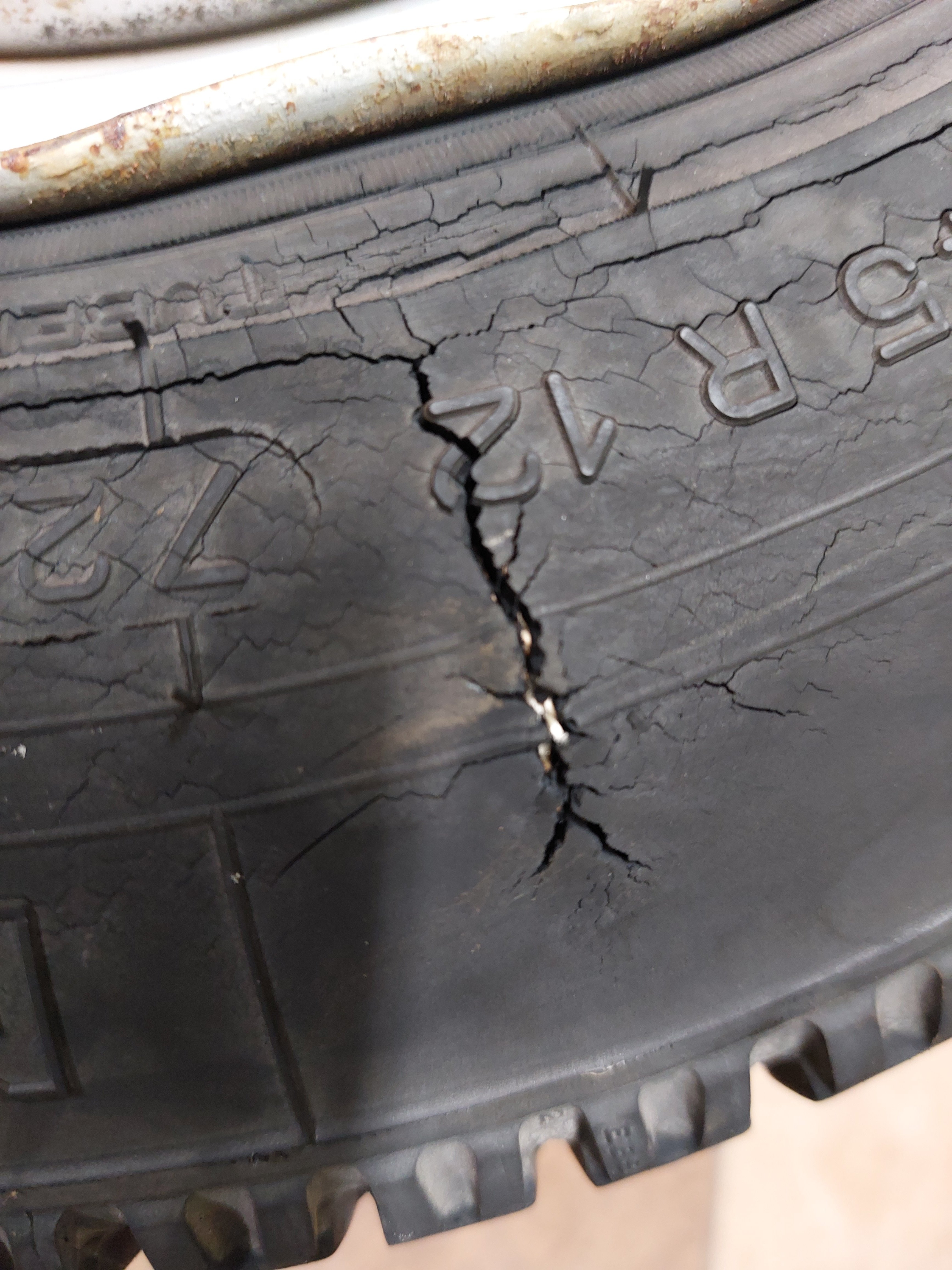

Definitely needs tyres as these are ancient Michelins, 145R12, no profile on them. Original fit michelins can still be got but they're 90 euro each plus fitting.
Probably get something a bit less than that.

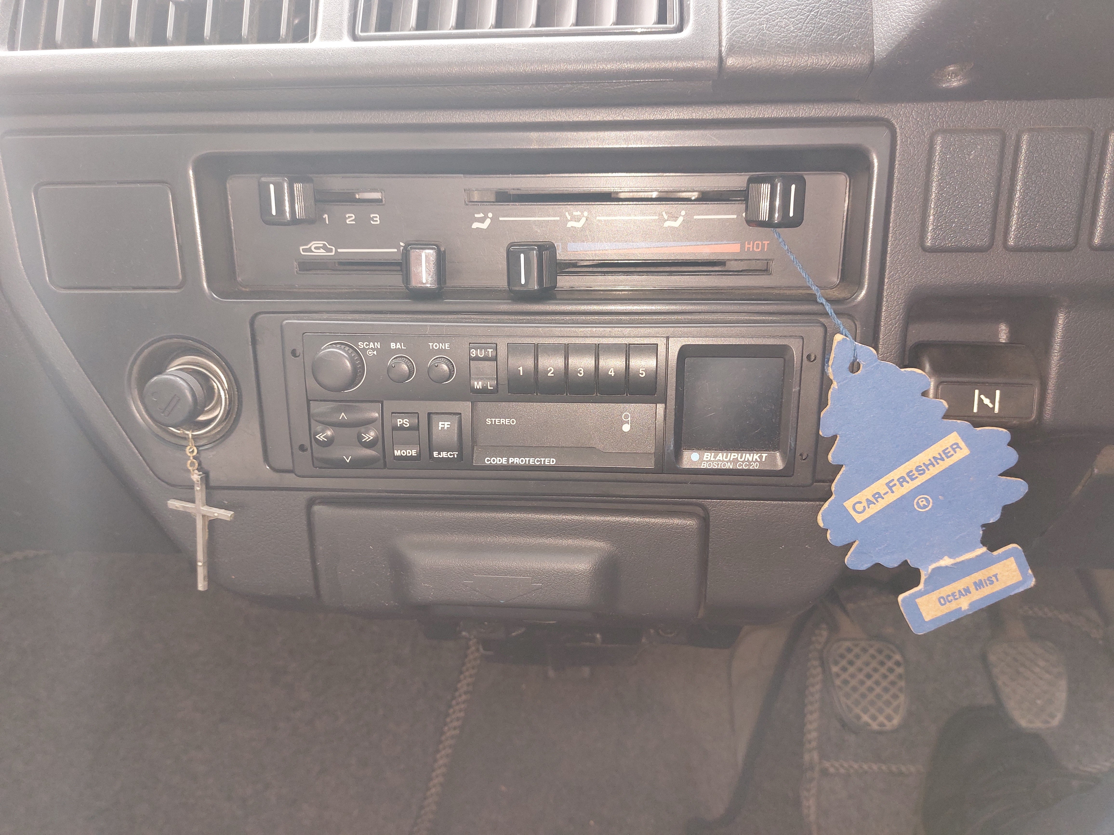

So far as I can tell, everything works as it should. Even the original radio works.

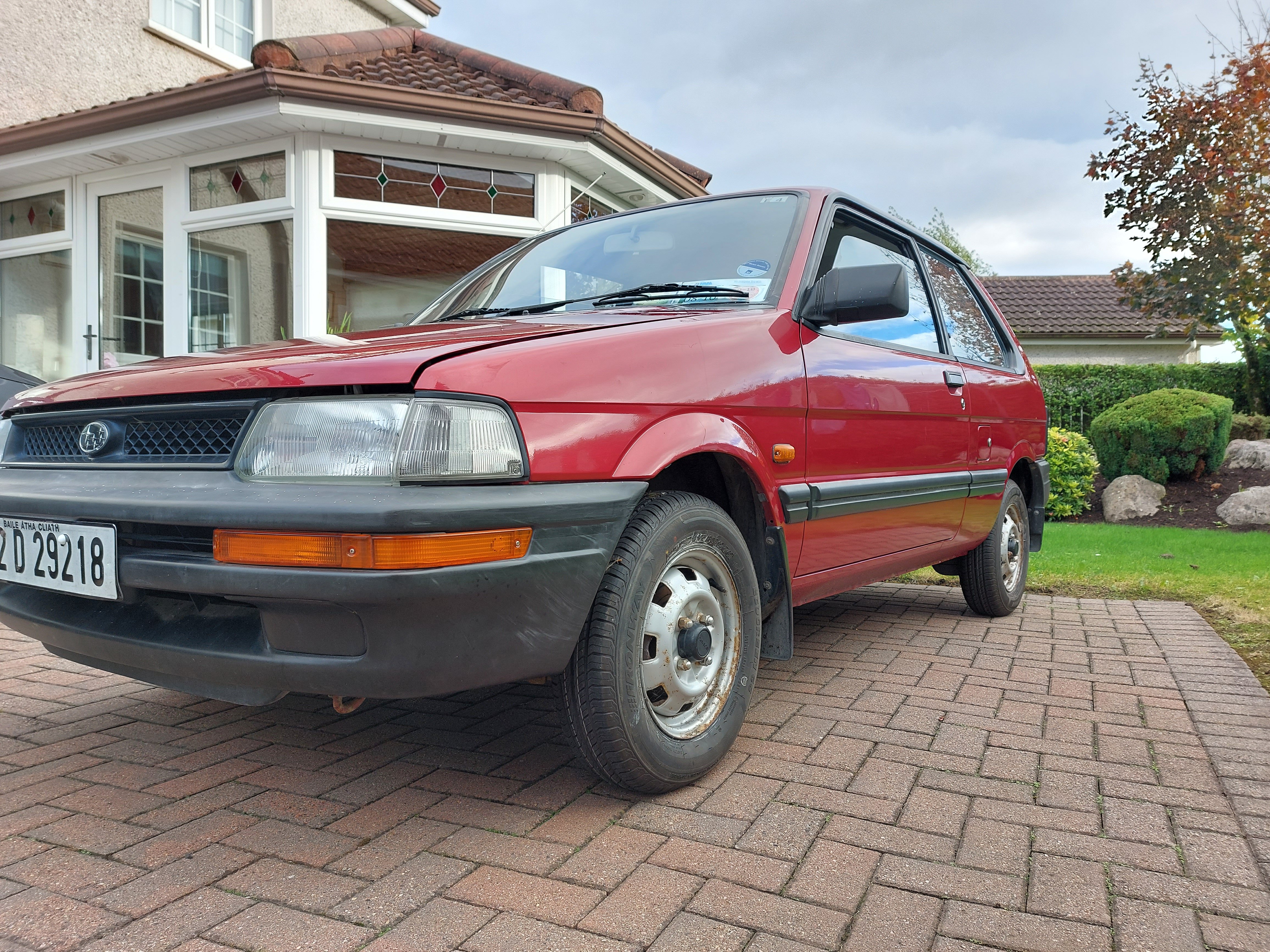

  • Just turned 30 too, registered 1st of October 1992.   I'm really pleased to have got it especially considering it can still move under its own steam even after all this time lying up.

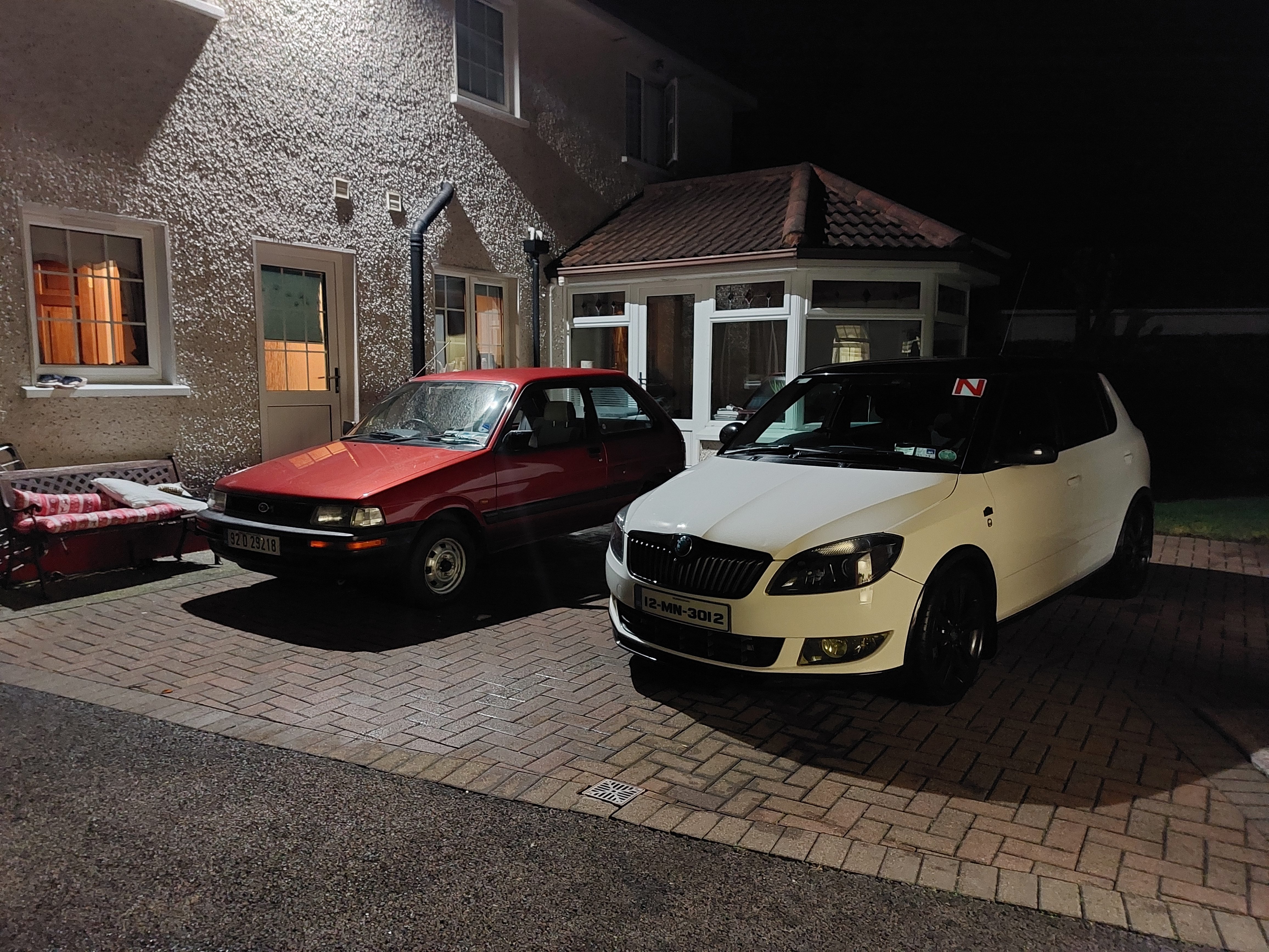

  • This is the more or less finished product.  Its pitch black outside but hopefully I'll get some pics in the morning. Cleaned up well, thick layer of film came off the inside glas

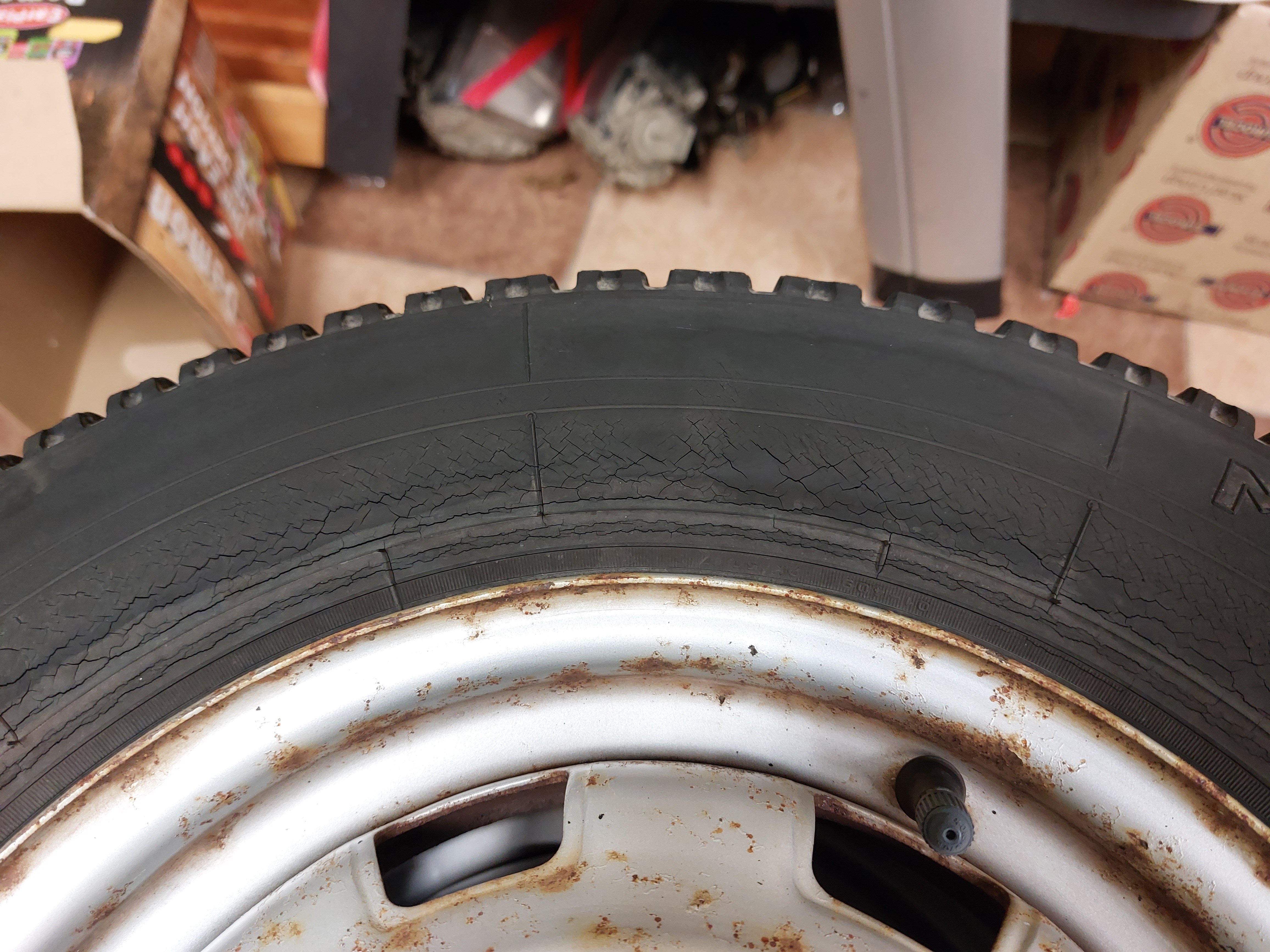

Which means 145(/80)R12.
Figures, strange for me to see it though.
That does help me somewhat in narrowing down what tyres to get, so thank you!

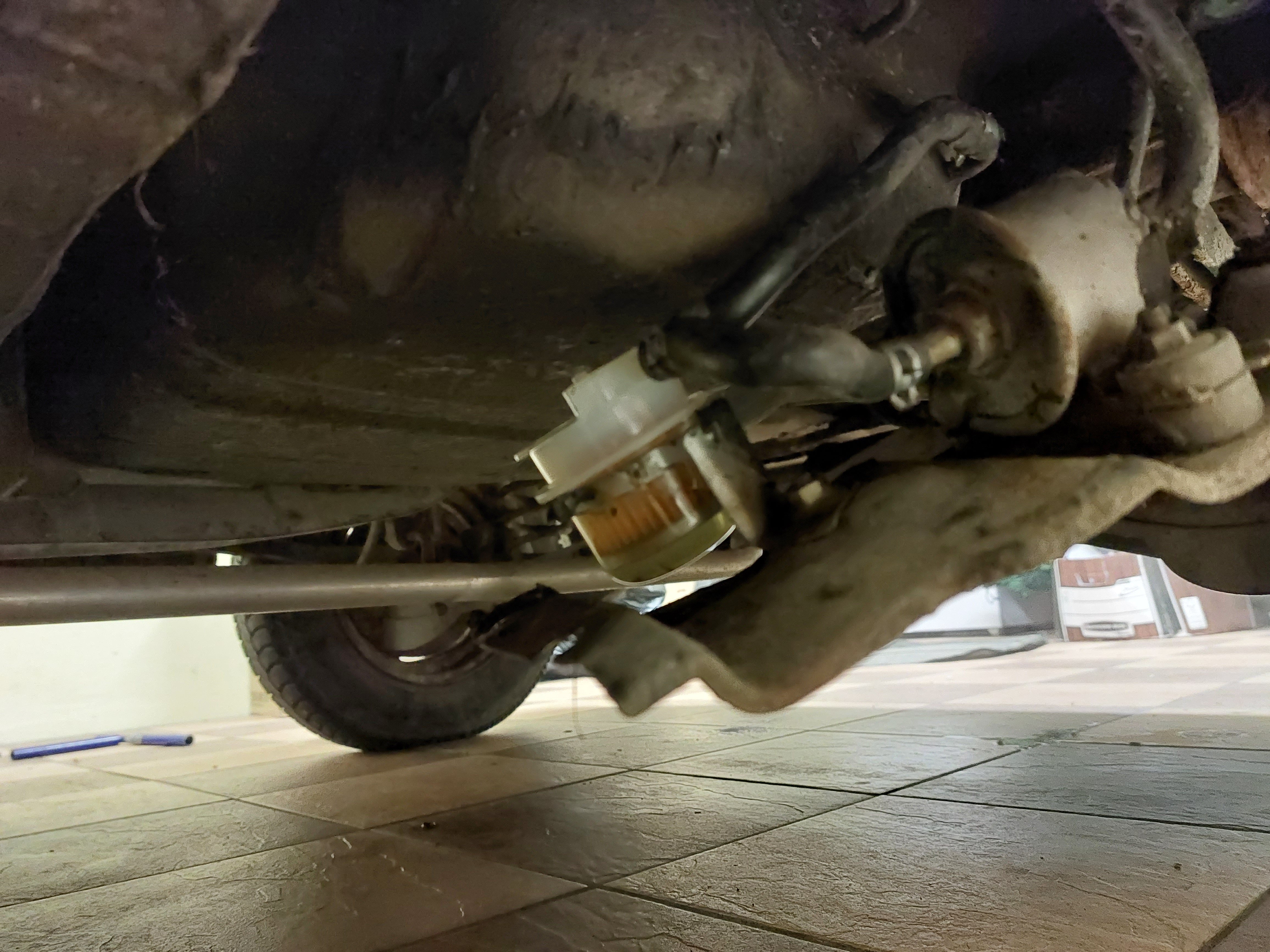

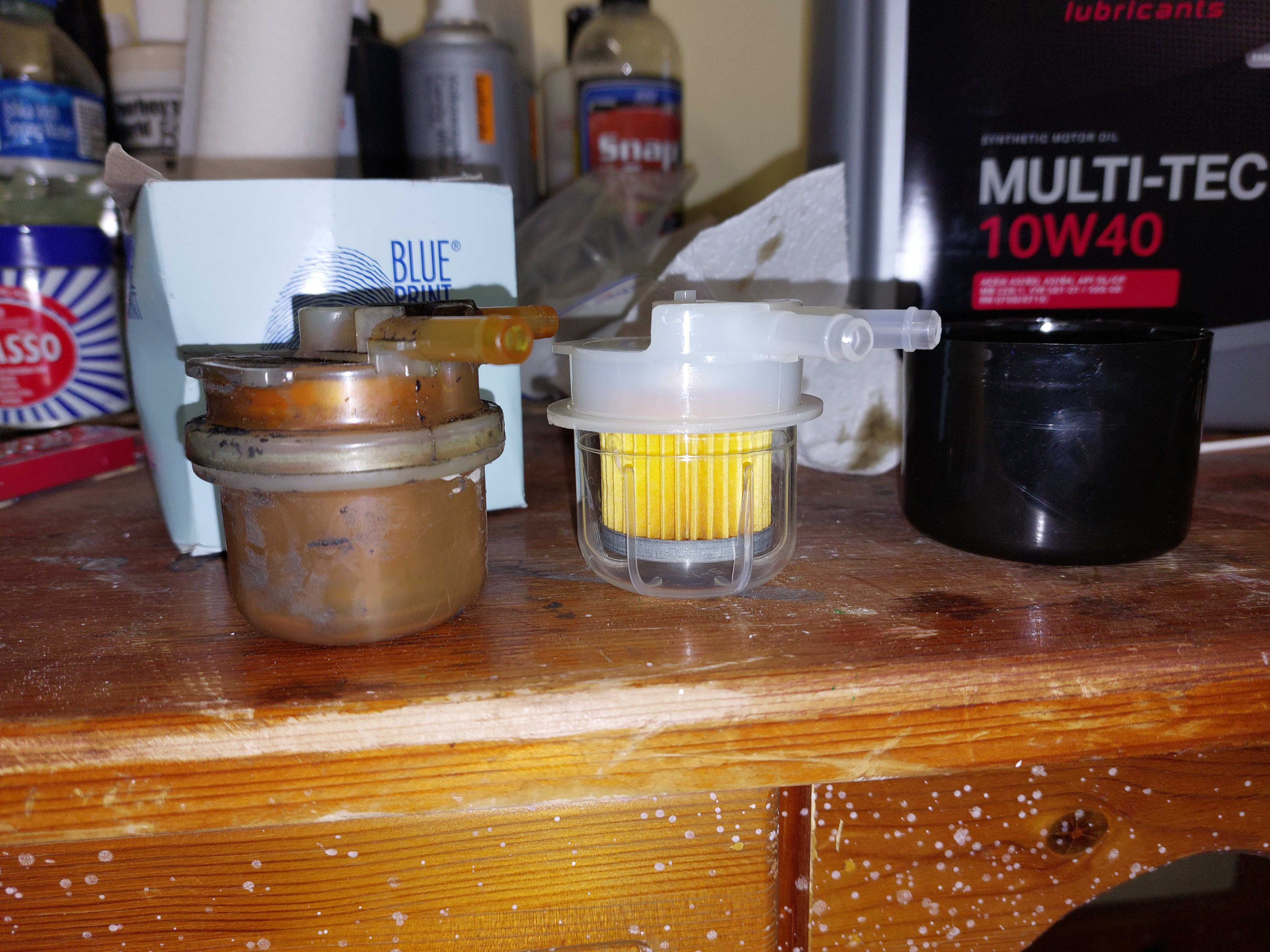

Jacked it up on one corner to get as much as I could out.
Fresh fuel and New filter in
Ran for a bit and looks like it's running clear fuel through the filter.
Couldn't get every drop out but as much as I could.

Seemingly a place not too far from me does 145/12 tyres for 50 a corner.
Should be OK for the driving this will see.

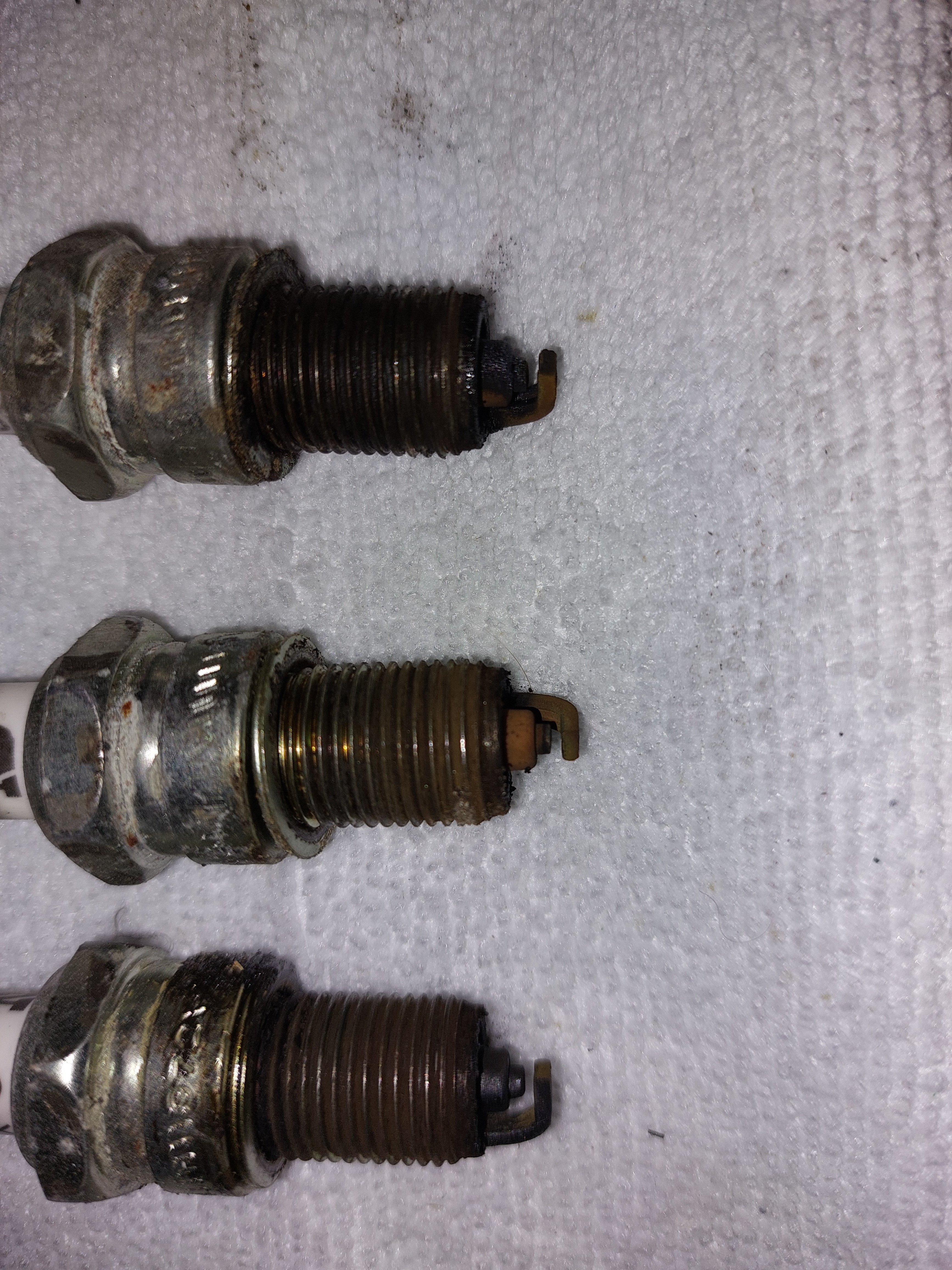

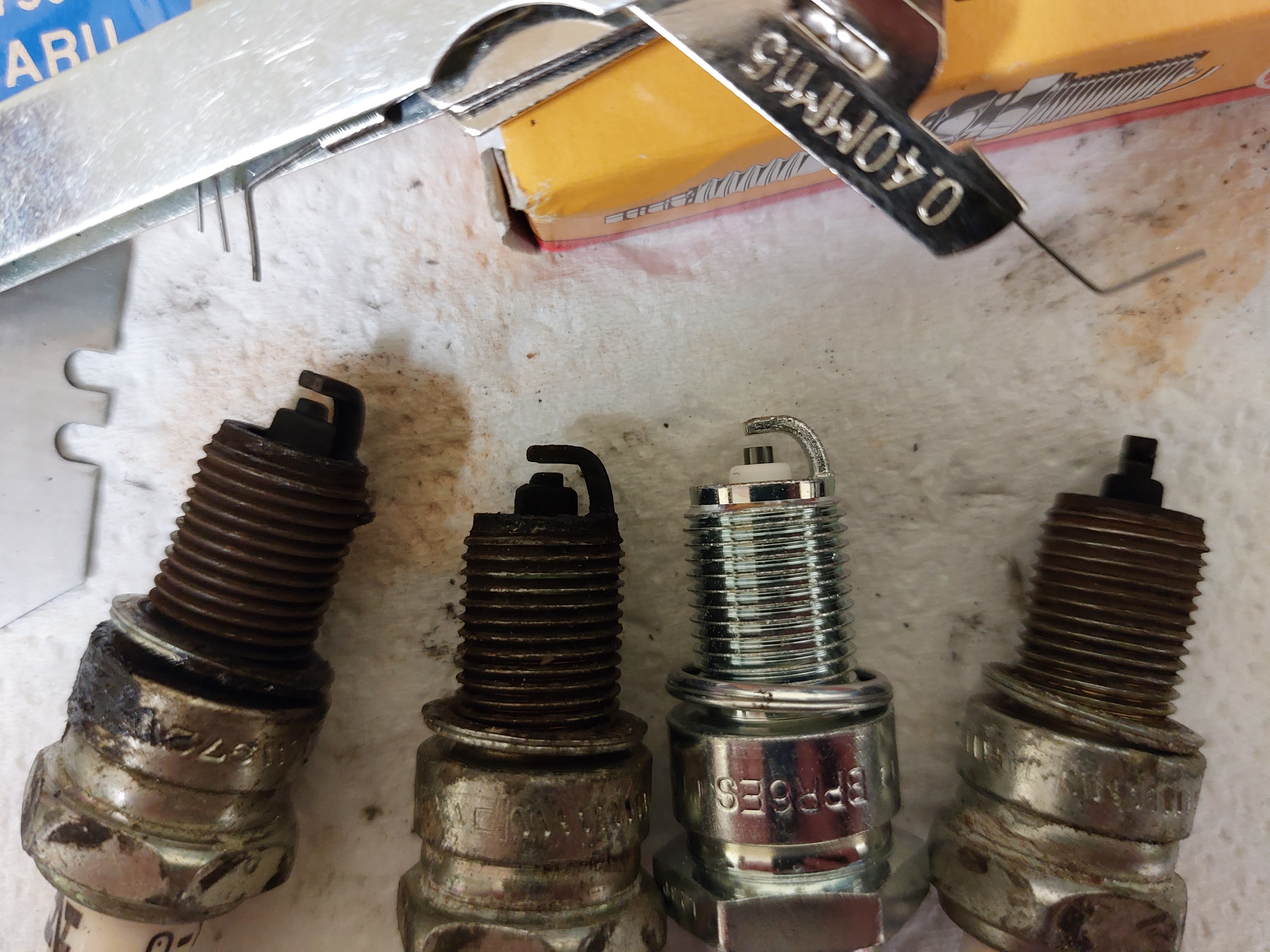

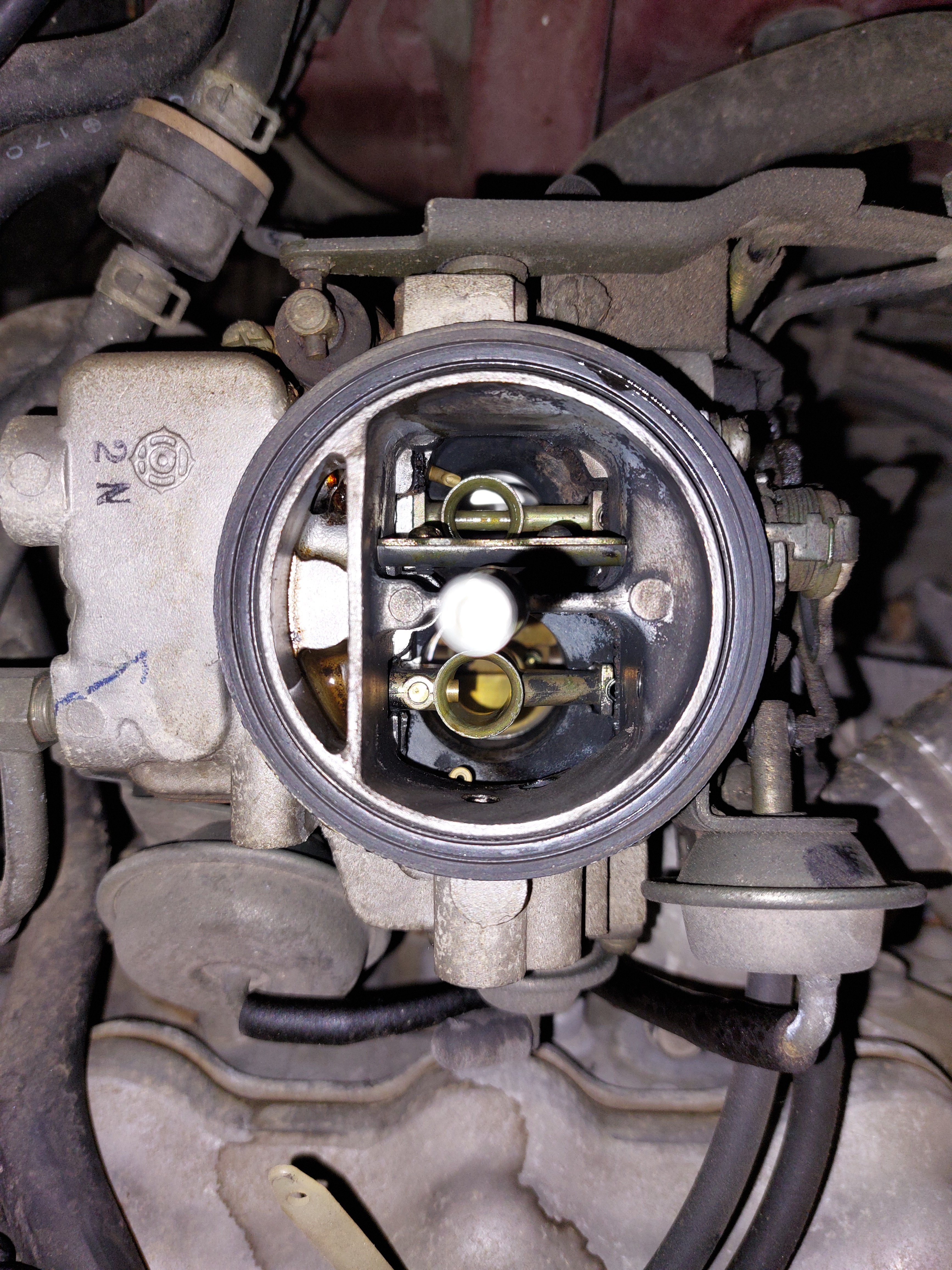

New spark plugs put in, they made a noticeable difference.
Revs a lot more freely now, still a bit stumbly under 2000 rpm when you're driving it however. Clears up above that.
Sounds quite nice with an open intake.
Only Like this because the air filter I ordered has still not arrived.

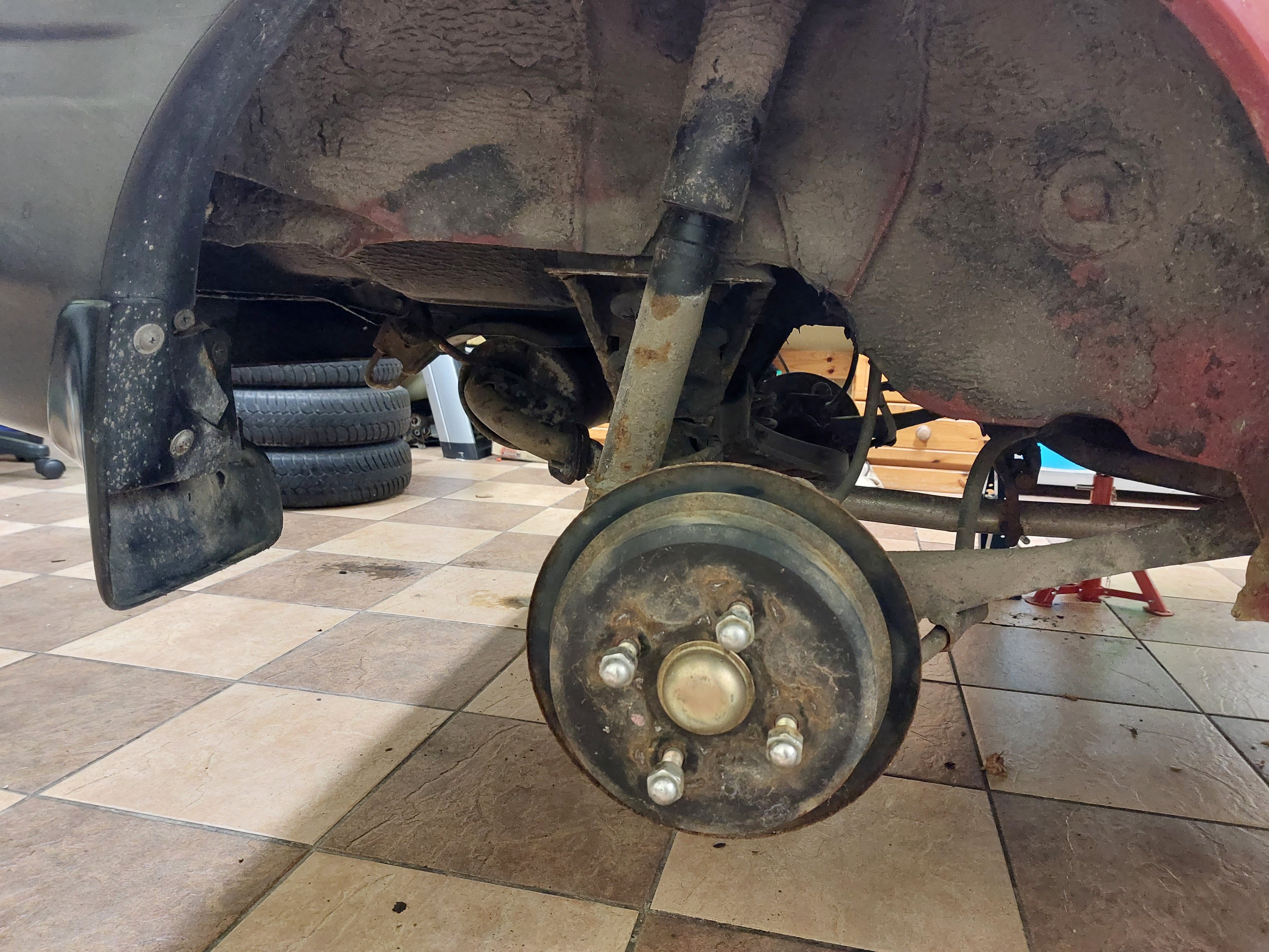

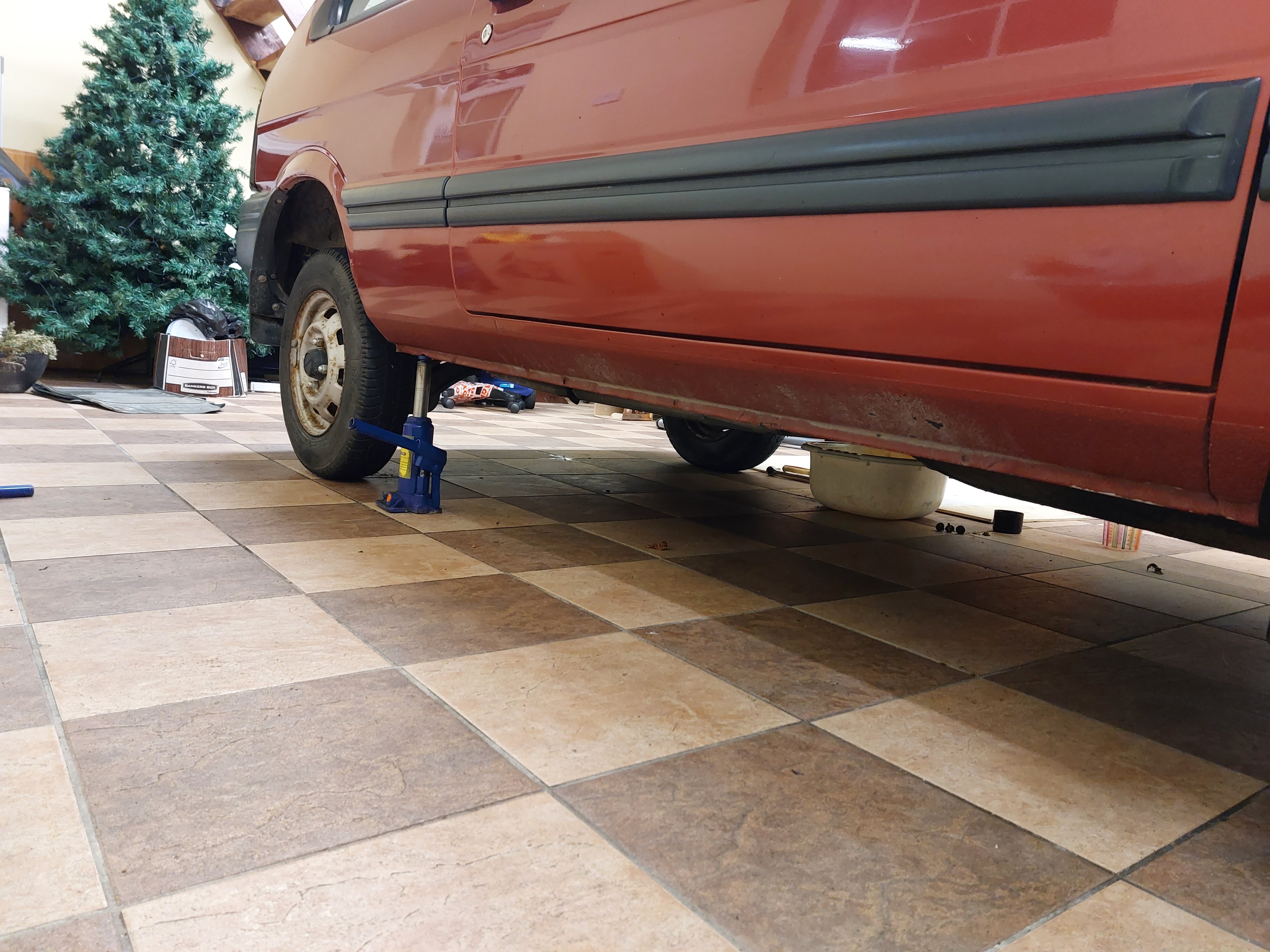

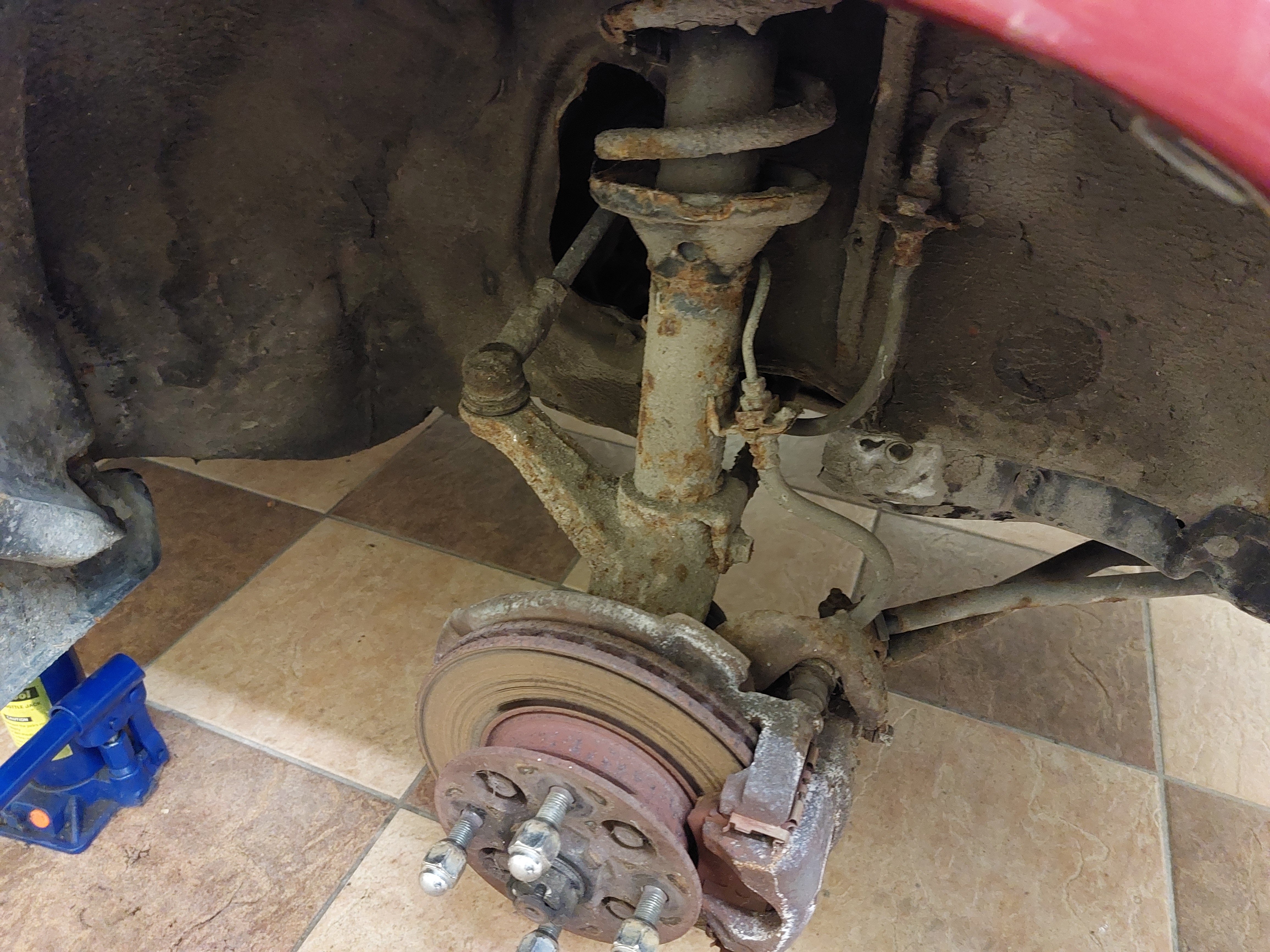

Got the wheels off it to get tyres on.
Pretty good shape underneath considering.
And you can see why I needed new tyres. All of them were like this
And one was like this
Got some ditchfinders fitted for 50 euro a corner.
All the driving this will see, they should be fine.

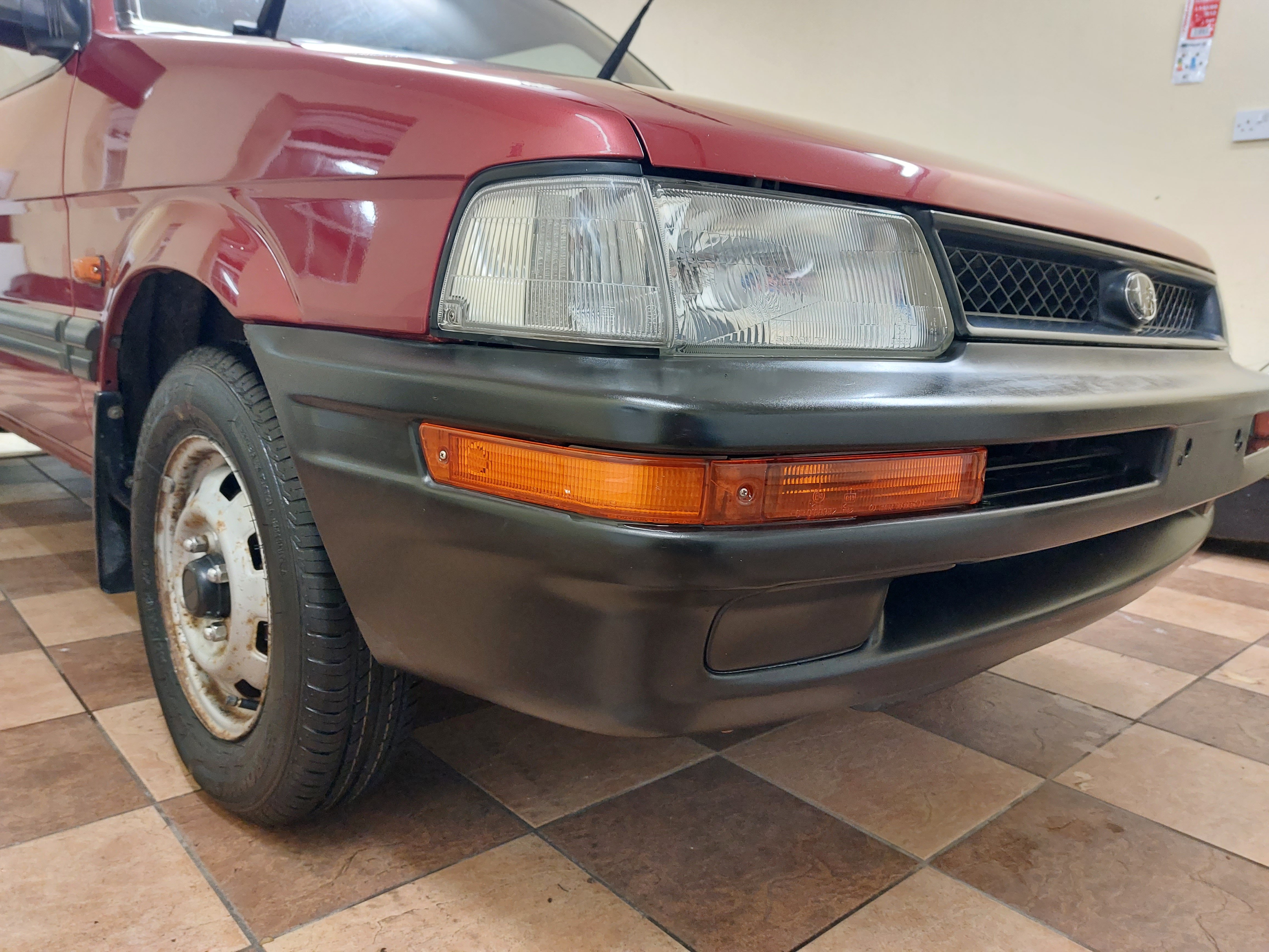

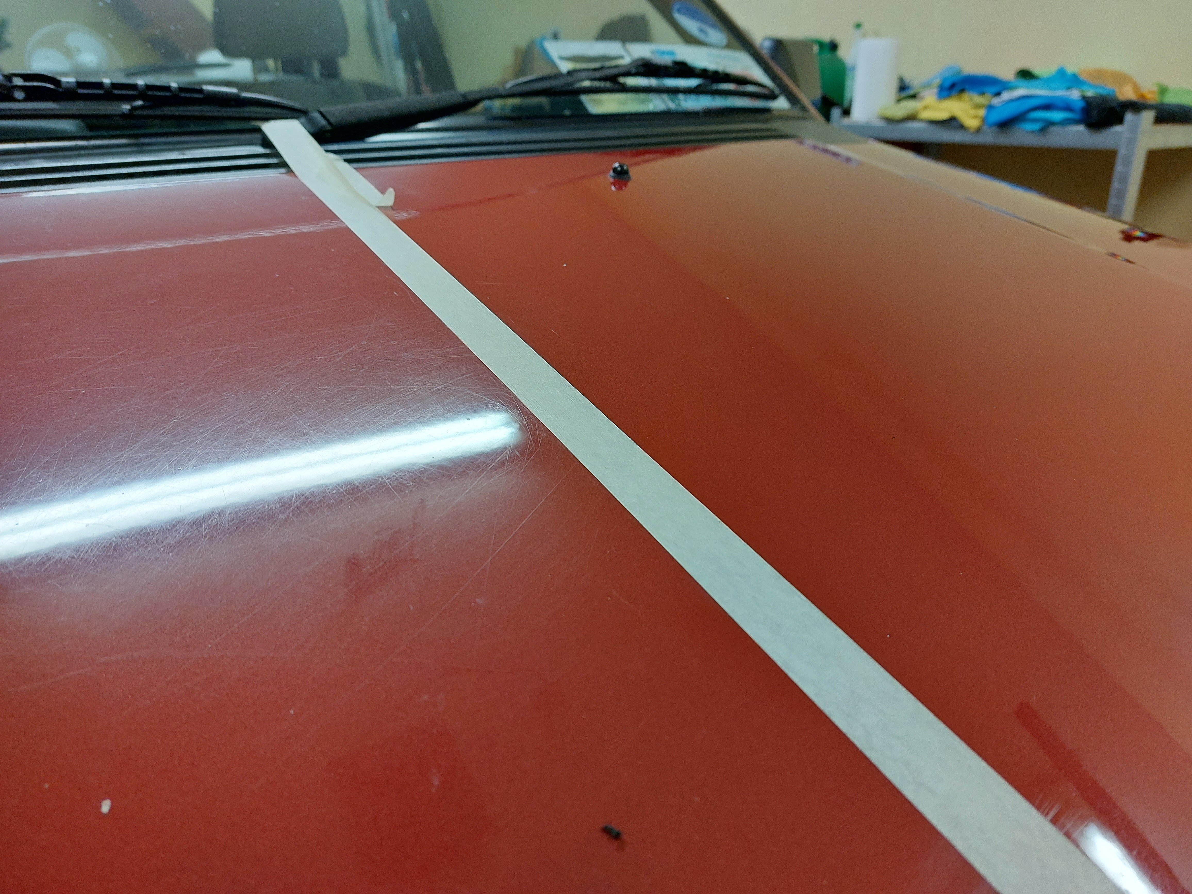

Too many photos to put in one post but I've finished polishing the paint, wasn't glazed or waxed in that photo, so might come out a bit glossier when I'm actually finished.
And I used trim restore on the bumpers,
Didn't get a good before/after shot like I did the bonnet, so I did one on the boot trim.

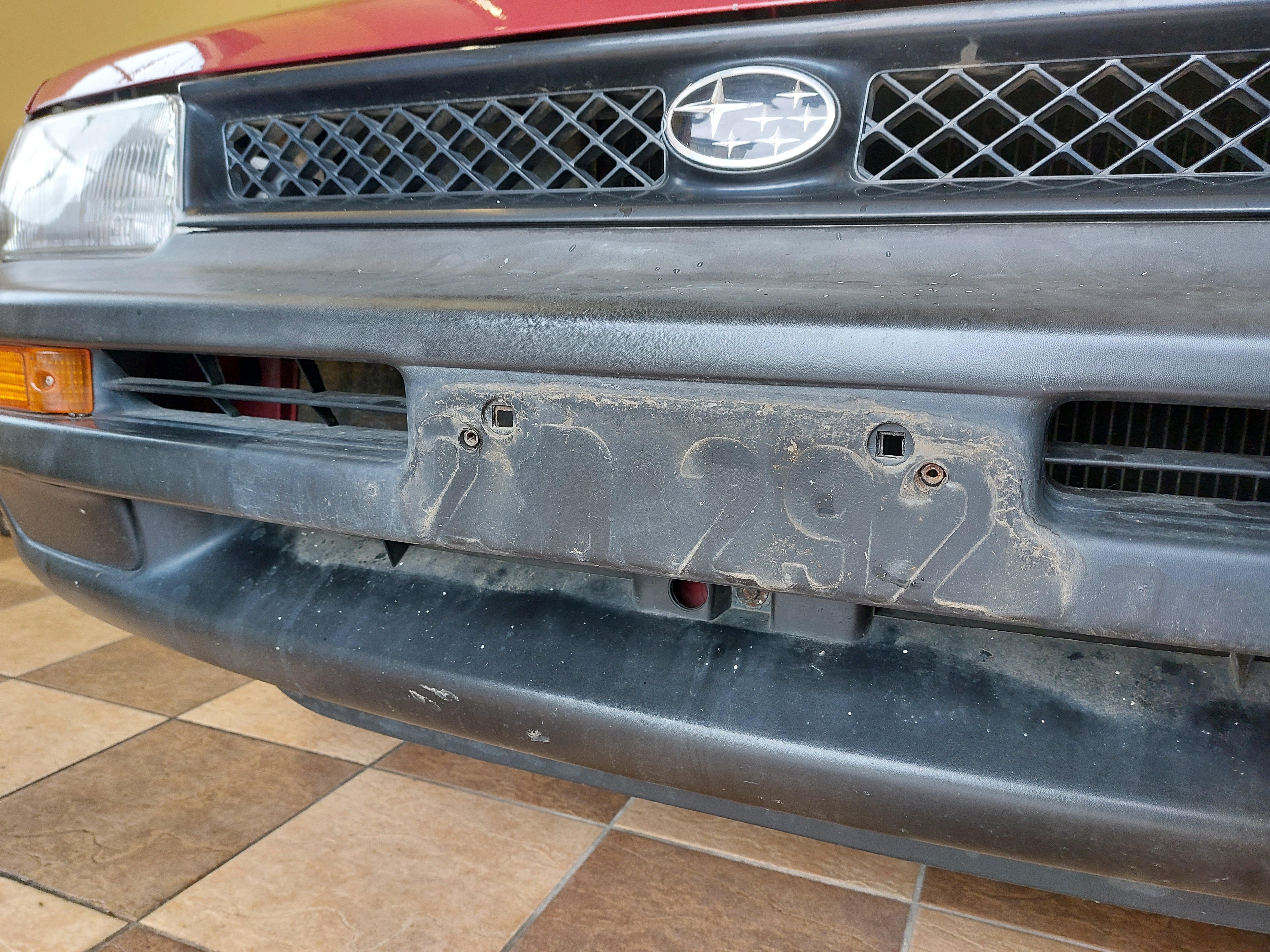

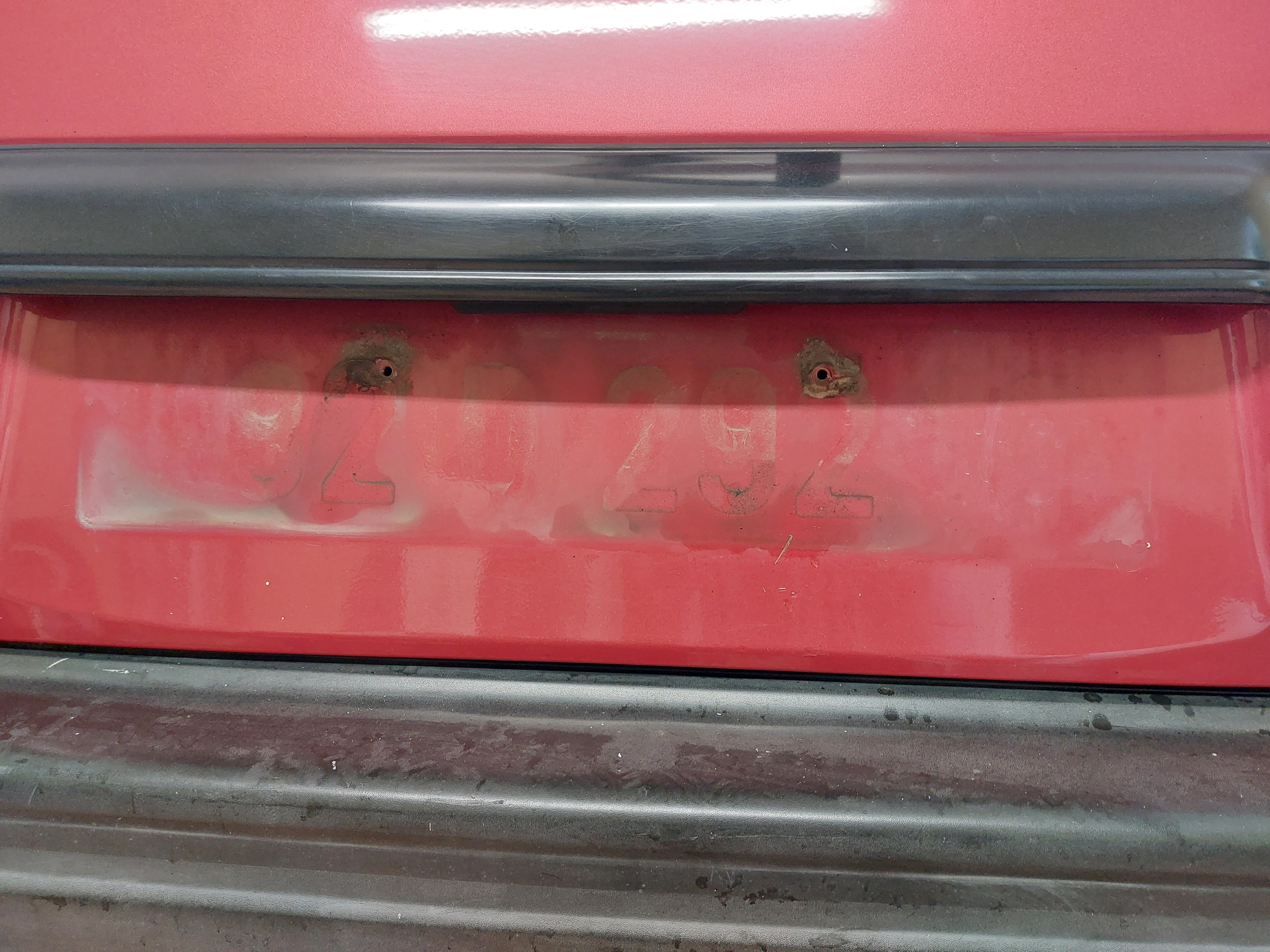

Took the plates off for probably the first time, as evidenced by the imprint of the numbers behind them.
Not sure whether I'll keep the old plates or maybe get new metal ones. Might put a jap/square plate on the front as it seems one might fit it better than the original one
