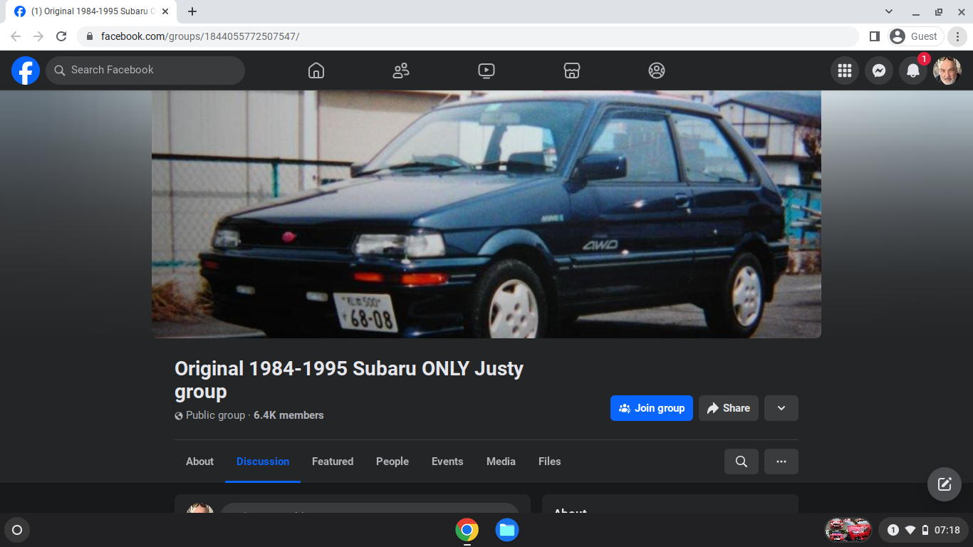

@DieselMonte  Are you a member of this group?
5 hours ago, Paws4Thot said:
Could be either. I'd probably know if you can do a good photo of just one of the aux lenses.
I'm pretty certain they'll be spots as most jap cars of that age had them in a 'pod' under the bumper and I recall a similar grille with spots being available for my 1990 Mitsubishi Colt.
I am yeah and the 4WD turbo one.
