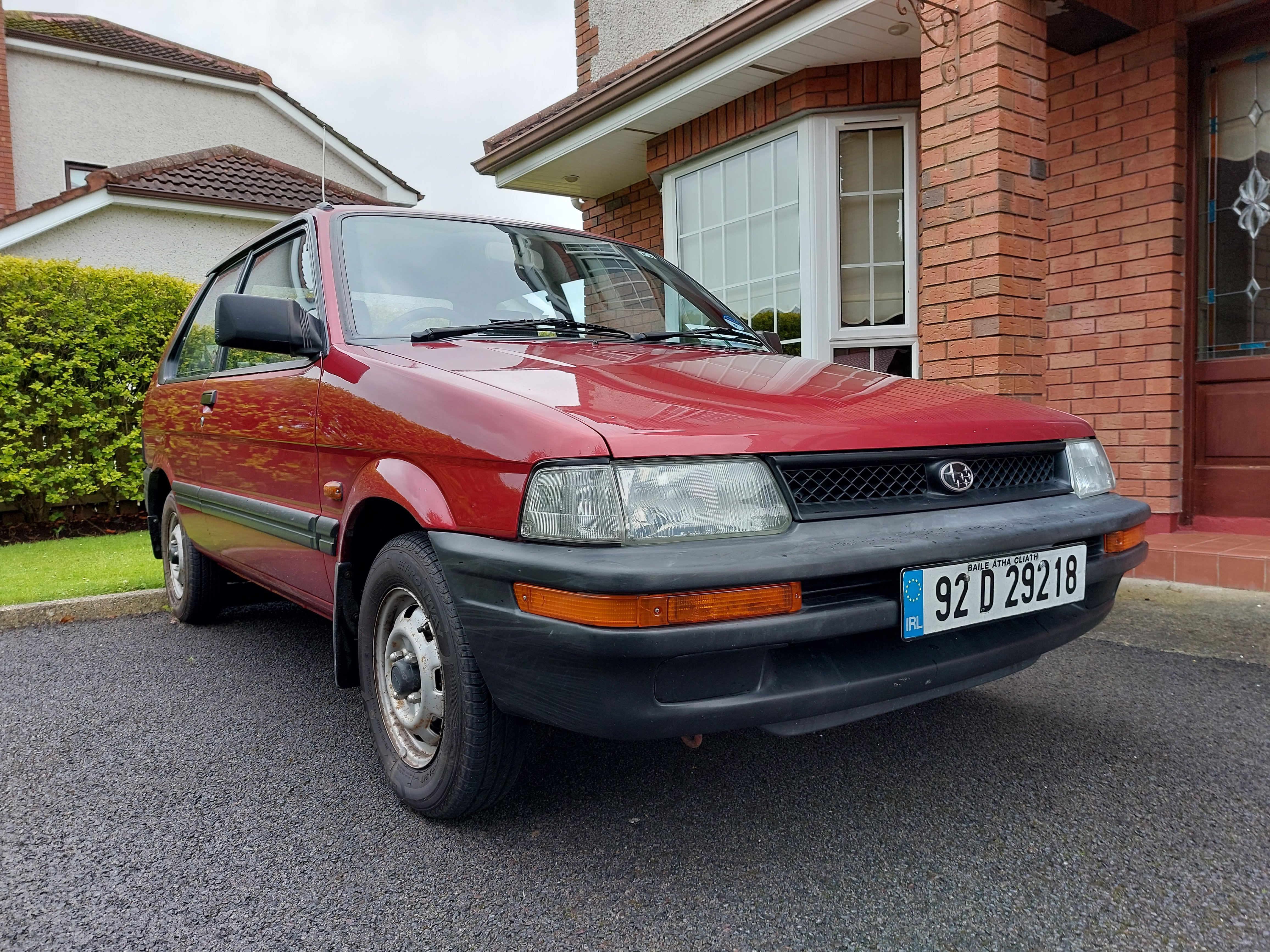

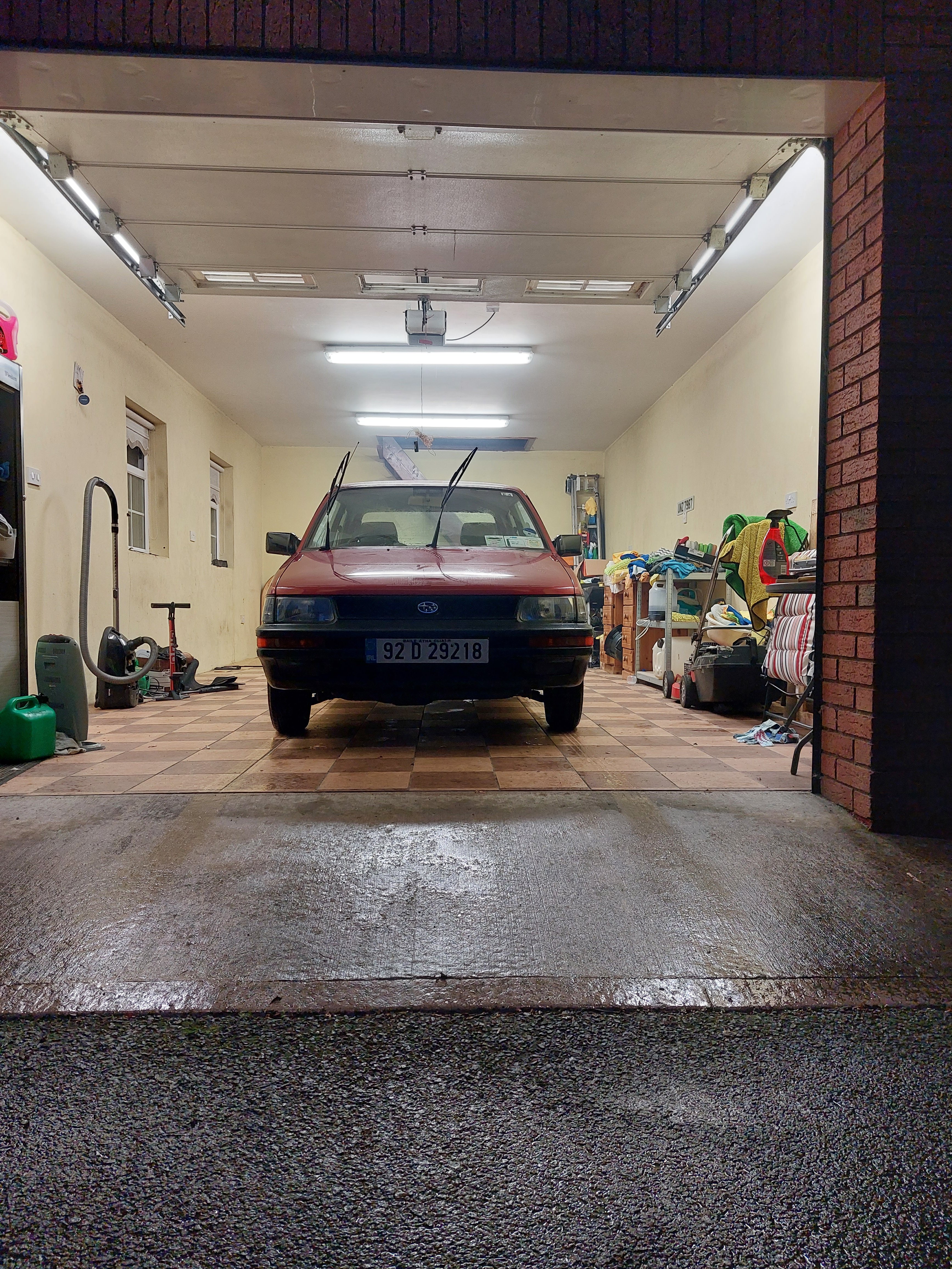

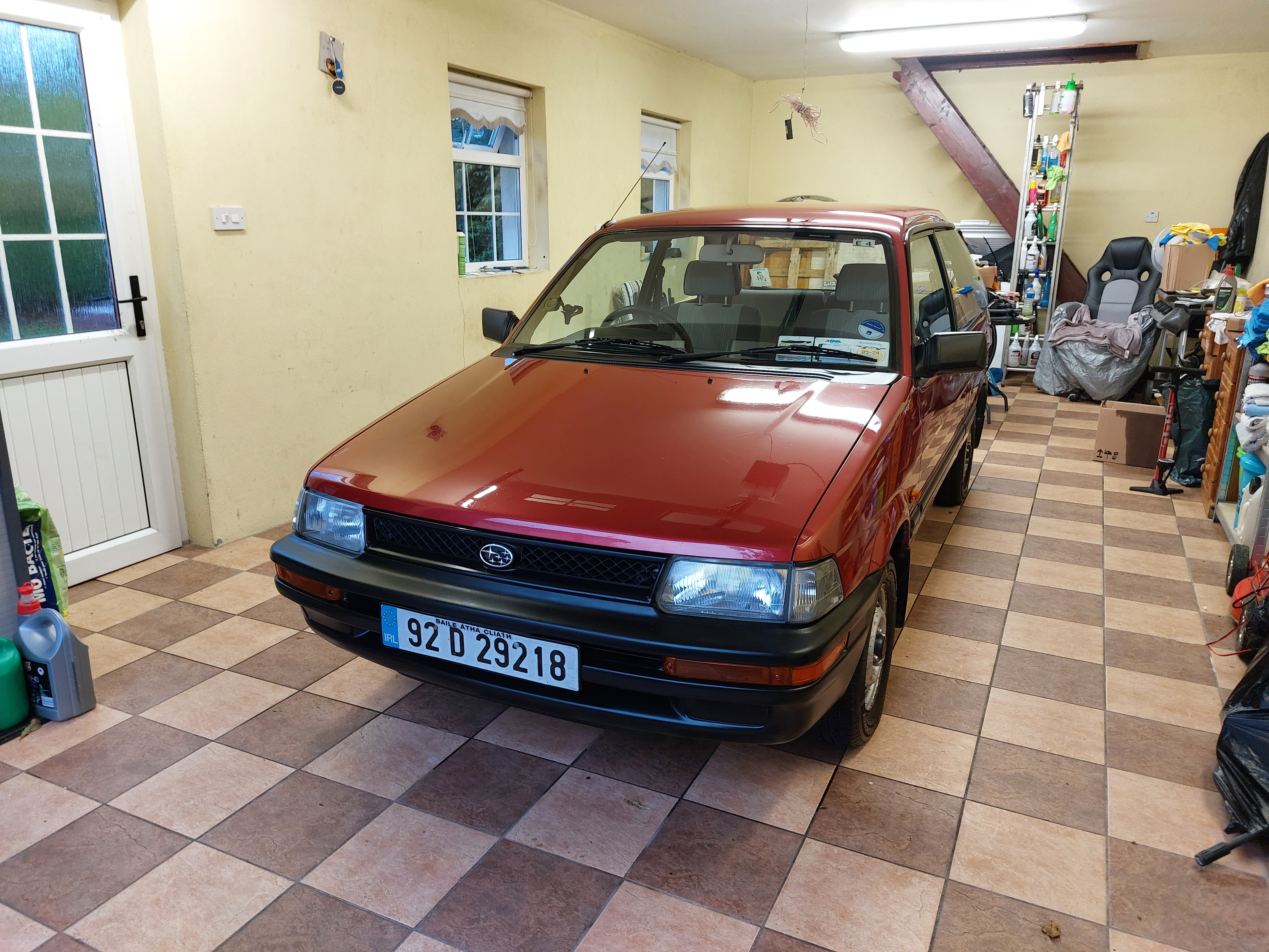

  • Just turned 30 too, registered 1st of October 1992.   I'm really pleased to have got it especially considering it can still move under its own steam even after all this time lying up.
  • This is the more or less finished product.  Its pitch black outside but hopefully I'll get some pics in the morning. Cleaned up well, thick layer of film came off the inside glas

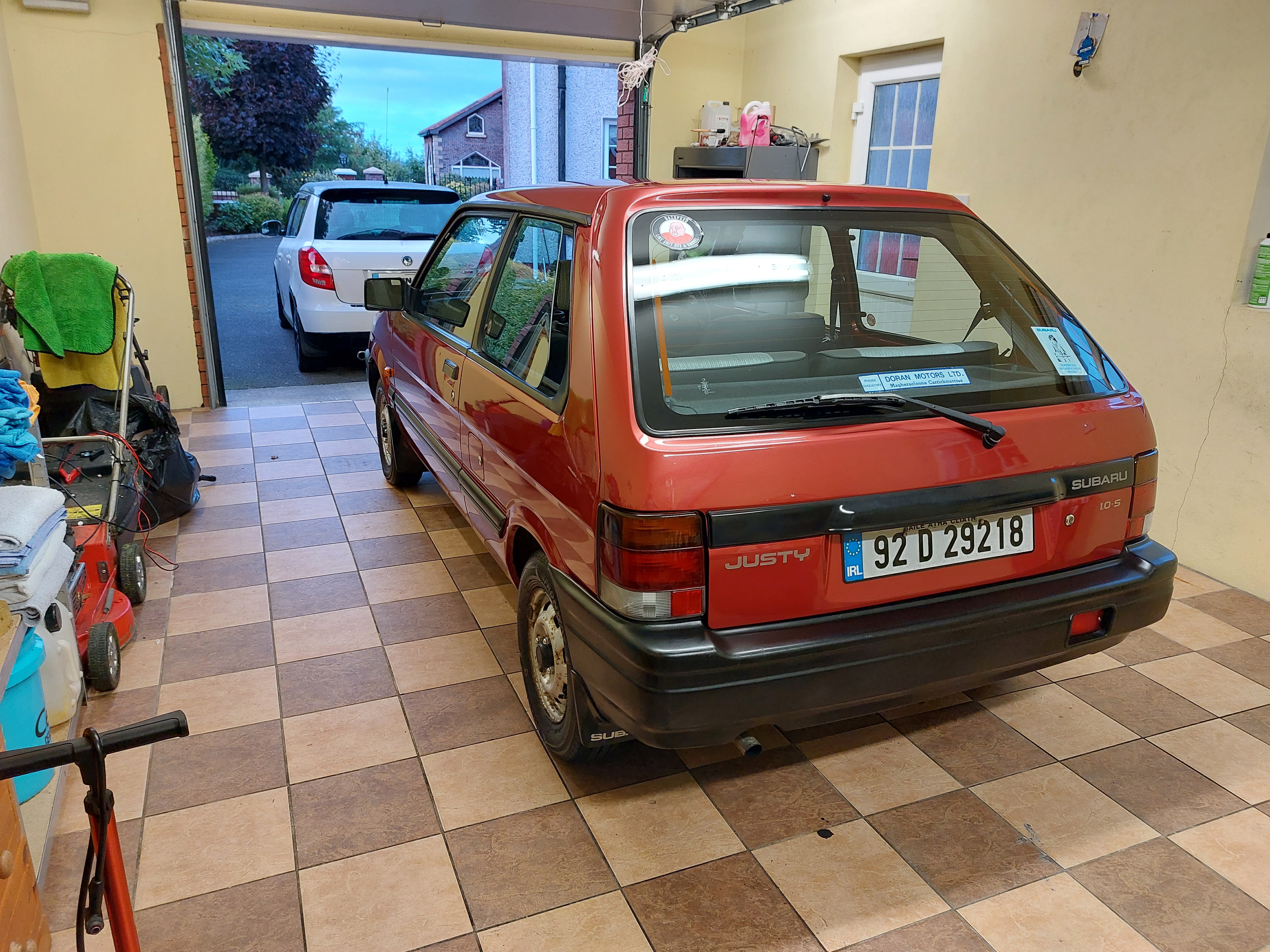

So It's now taxed and insured. 190 a year insurance, 56 euro tax
Been driving it about locally to make sure its running right. Drives out great comfy, pretty sharp handling, tyres good, brakes are fair.
Small bit of stumbling at times but I think I've the idle mix set a touch lean, for nct. Fatten that up and see.
Looks are deceiving, it's covered in an inch of dust cause the garage is full so it's been sat outside for over a week.
 Radios fantastic in it.
I'm sure its gonna break constantly now its back in service, but for now I'm happy.
Again, not cost me much to get it on the road and insurance and tax is very cheap, figure it's getting about 40mpg so it's not hard to run.
Considering that the Monte is getting on a bit now it's nice to have a useable second car.

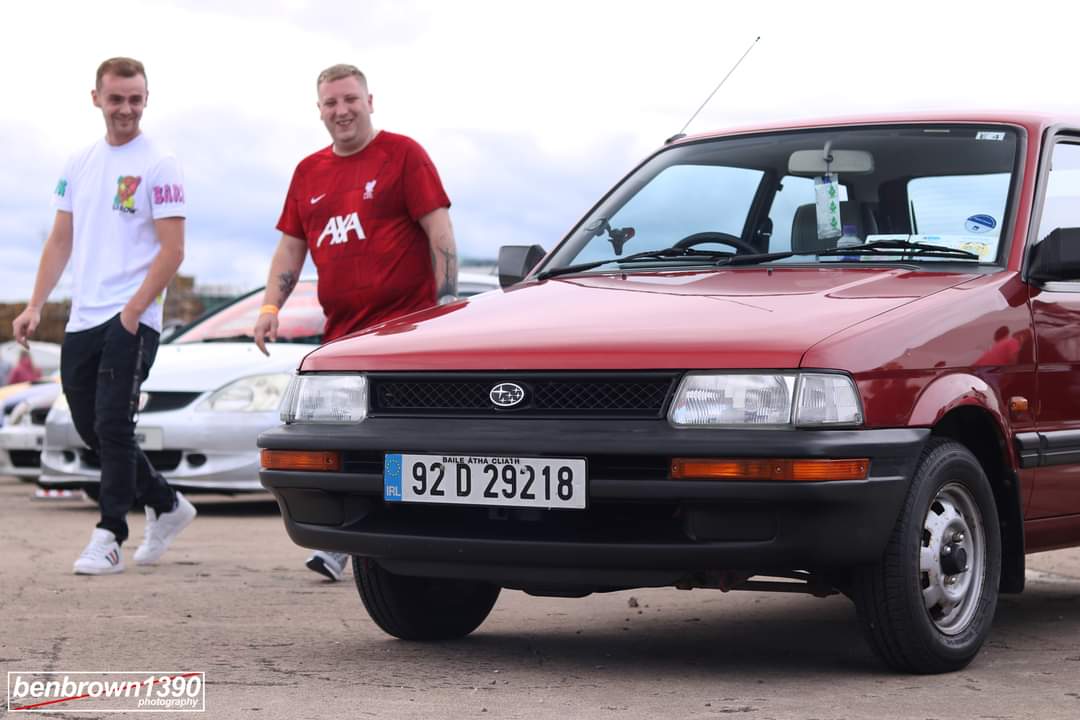

Washed and waxed it last night for cars and coffee today, was behind a ferarri 440i there and on the way back too.
Place was jammed when I arrived, so was put out in the bleachers, know to get there earlier next time
Plenty of cool stuff there though
Sort of out in the bleachers but still got a few looks and photos. Seemed to get a fair bit of attention.
Even driving it had people come up to me asking what it was, or saying they hadn't seen one in years, which was nice.

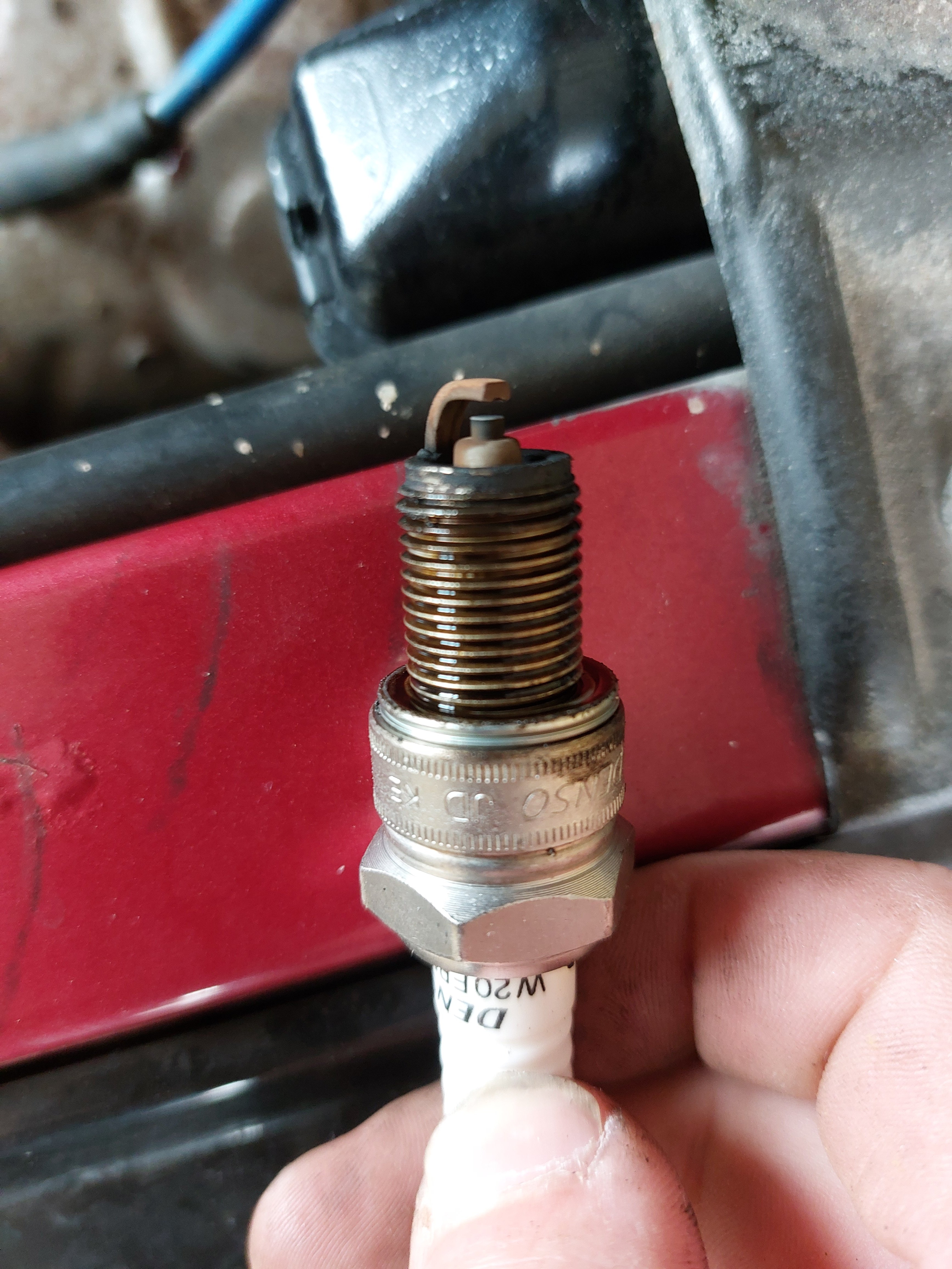

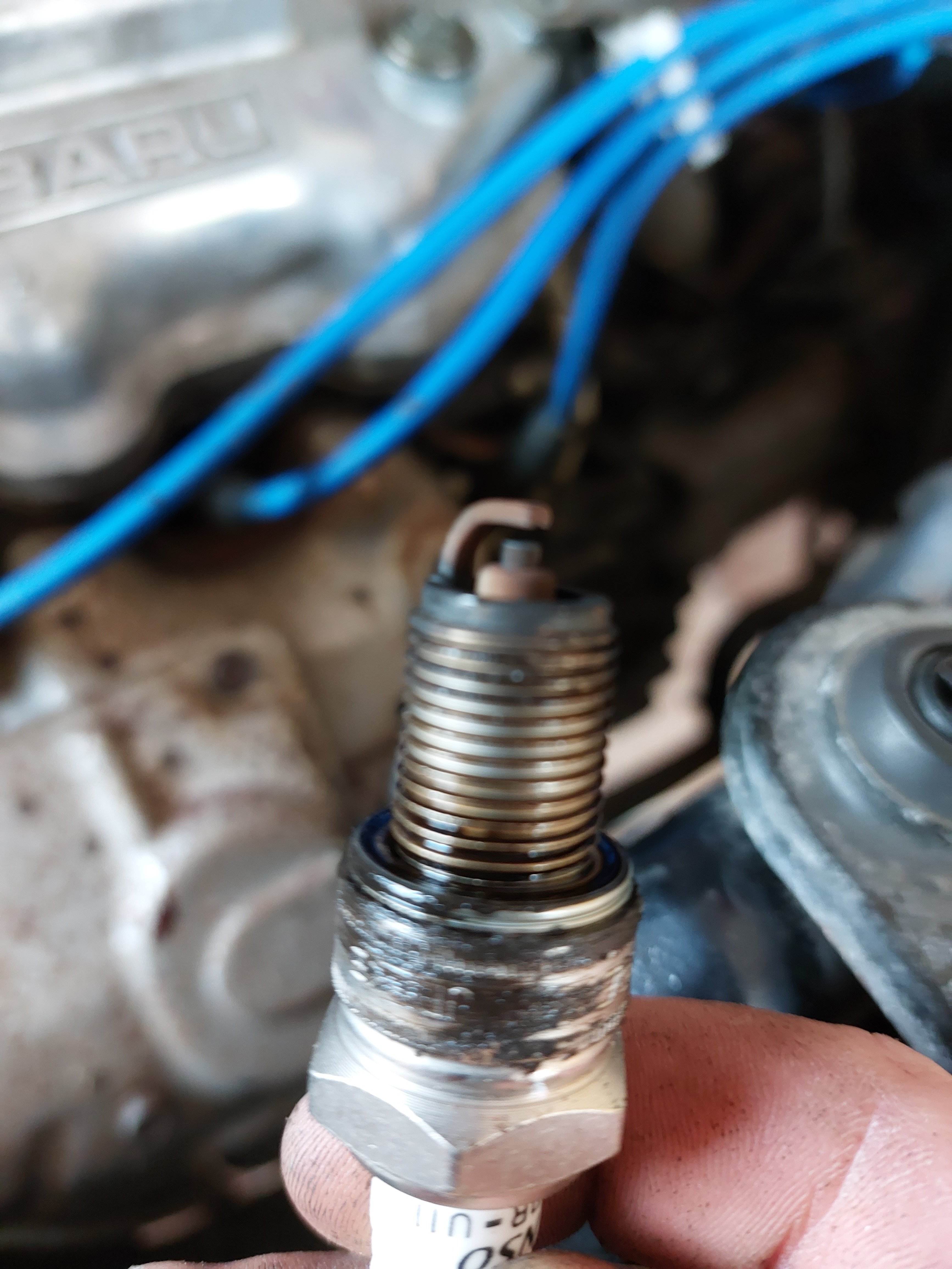

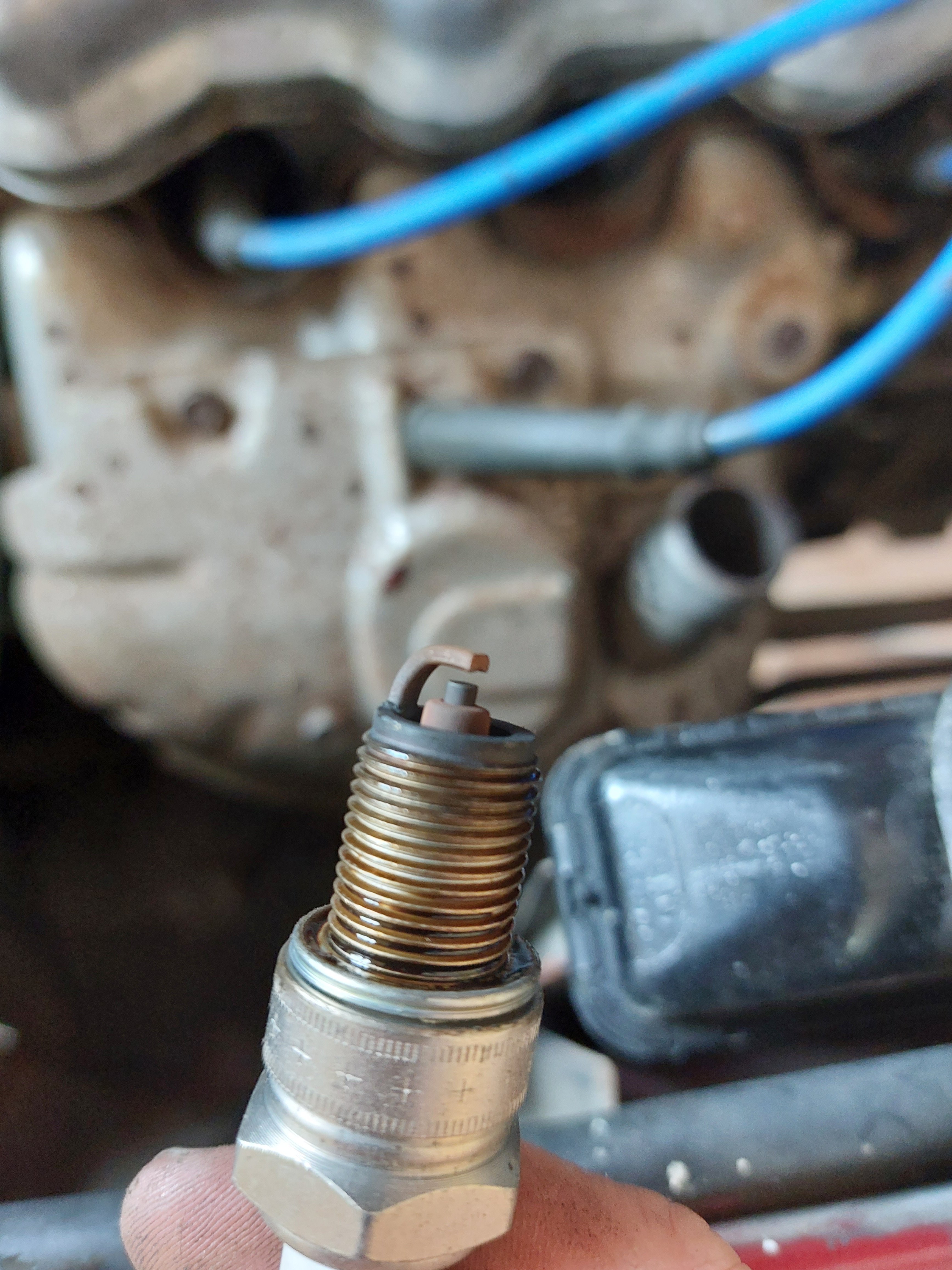

Did some checks on this today.

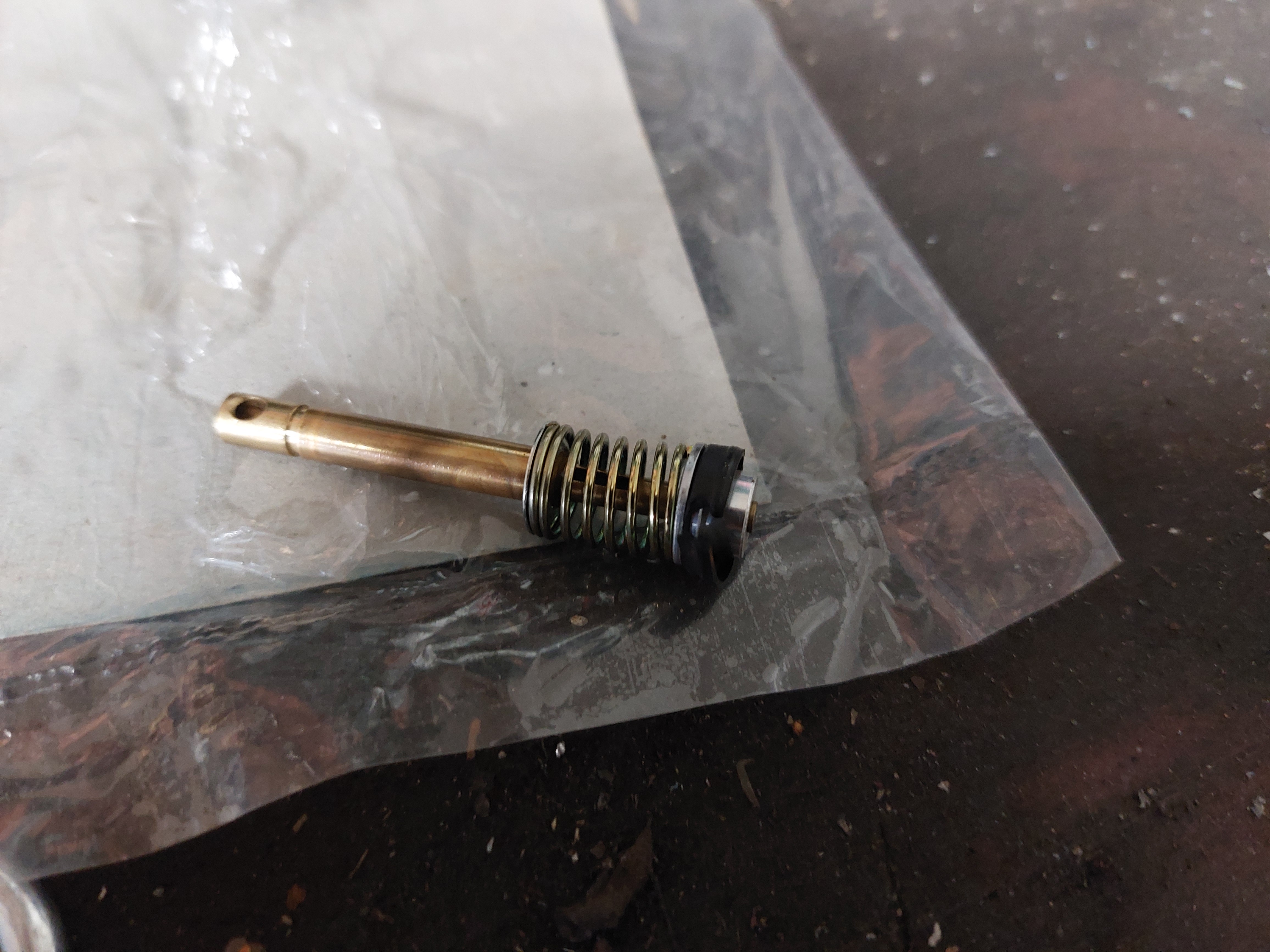

Pulled the top of the carb off to check the jets and bowl for rust. All good. Lowered the float slightly as I was told it might help with hot starts somehow.
Pulled the plugs and 1
And 3
Seem to be burning pretty good. Cleaned the contacts on the cap and rotor and lubed the cam for the Points. Running well. Gonna recheck timing, idle mix and idle itself next time I'm arsed.
Still need to change the brake fluid, change the coolant. Replace a coolant temp sensor (gauge reads low).
Intending on making retrorides in it. So far it's proven to be reliable enough, considering it's been out of action since 2010.

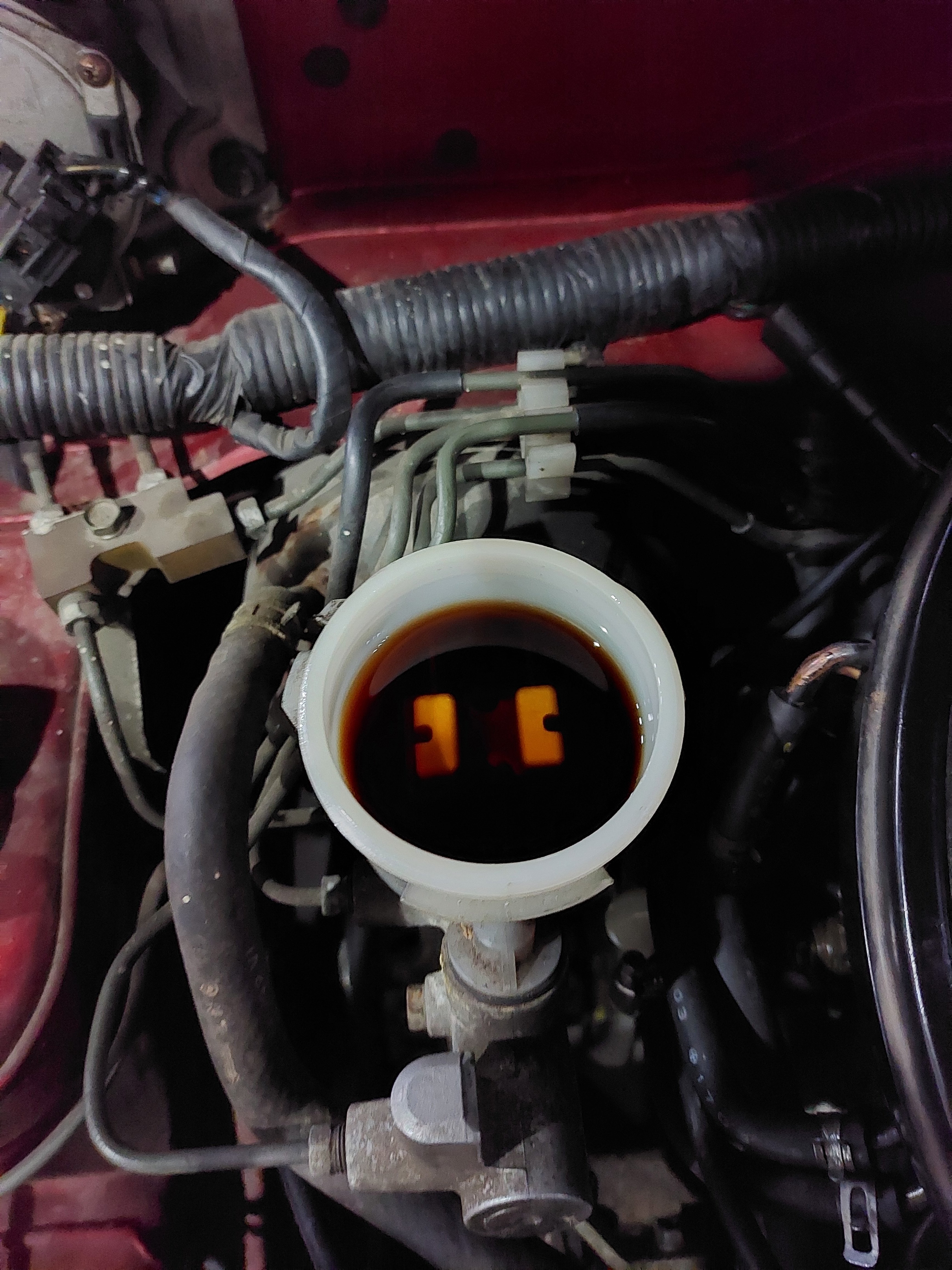

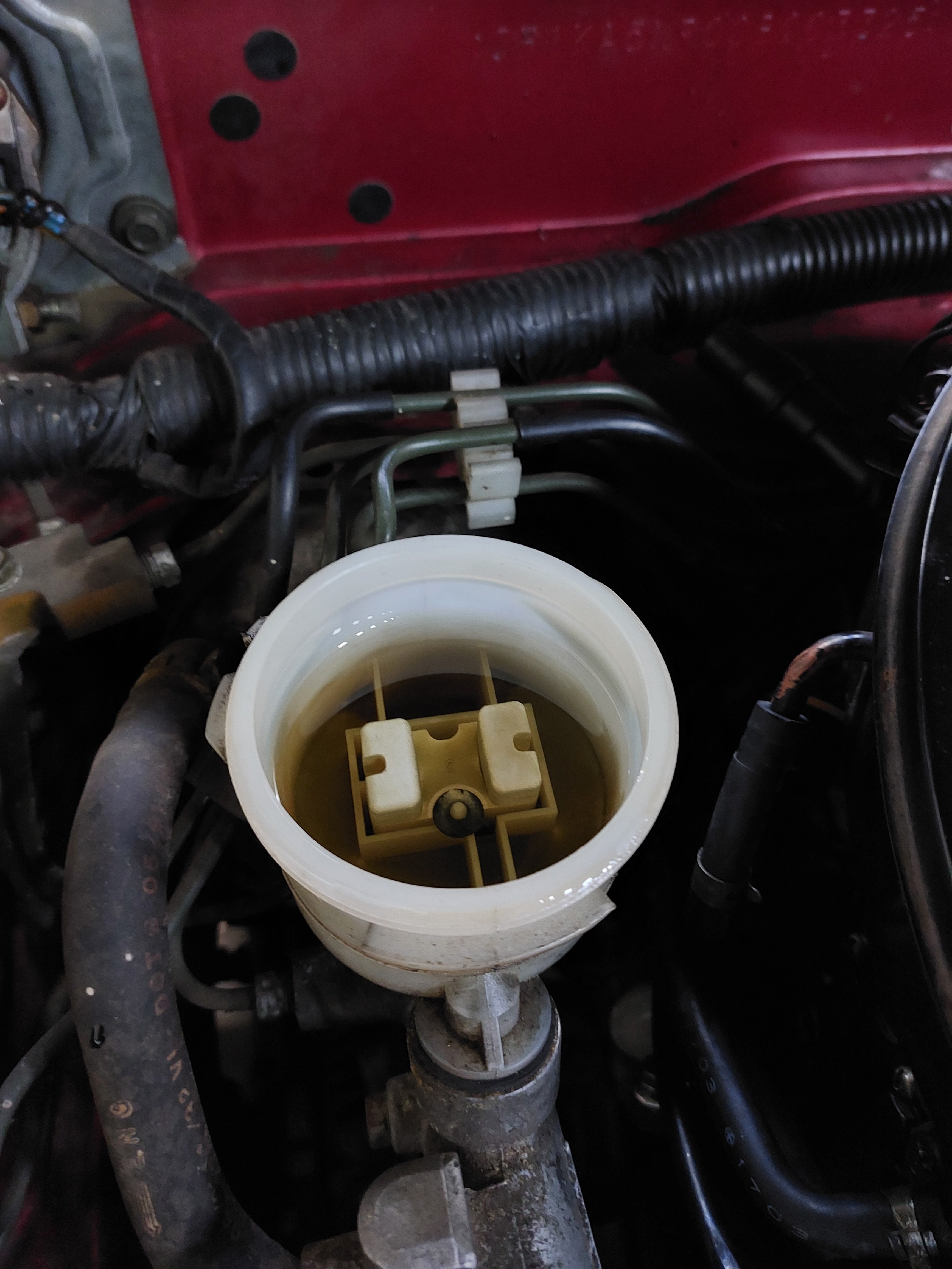

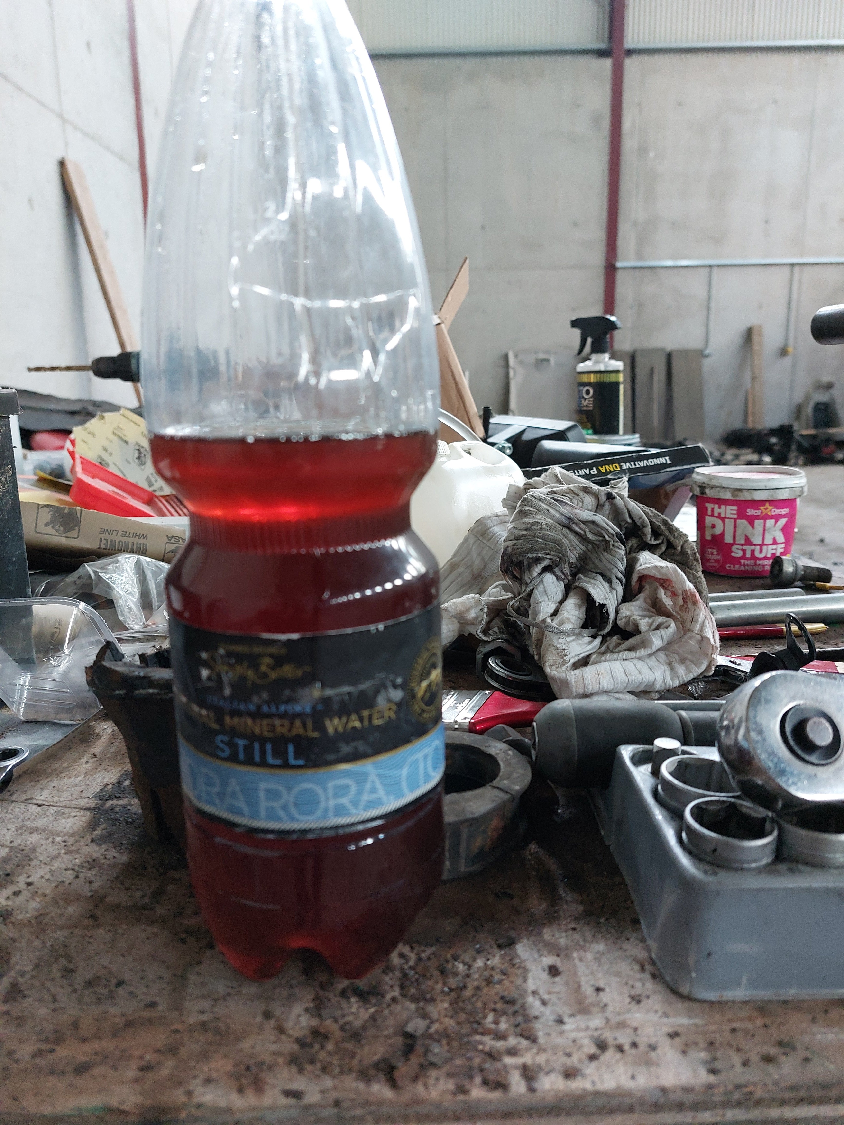

Firstly flush the brakes, as the fluid looks like this. Brakes feel absolutely fine, yet to have an issue with boiling them or anything. But I never did it, it's obviously not been since long before it went off the road so I may do it now.
Secondly I'll change the coolant as it is also quite old. Again not had an issue with it yet, but I want to do as much as possible to have it good to go.

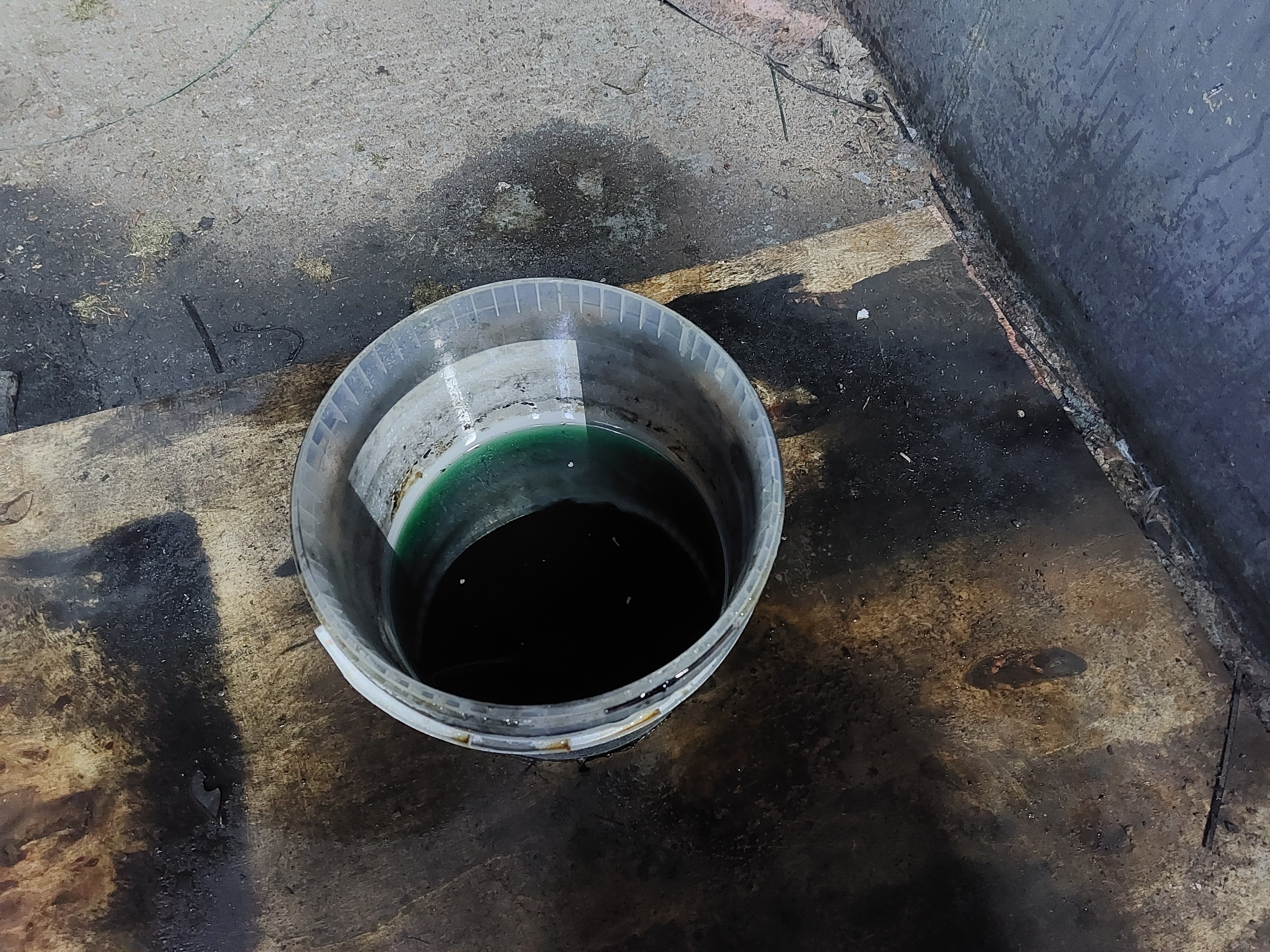

Bled the brakes and Flushed the coolant ahead of going away.
Waiting on some sealant to dry.
Brake fluid was old. All new stuff through it. Pedals firm and so far no leaks. Old fluid was not great.
New stuffs a lot better. Just generic dot 4.
Have an eezibleed but just bled it the normal way.
Coolant looked perfectly fine but was old. So out it goes.
Flushed it with a radiator flushed then 2 runs of deionised water. Refilled with 50/50 mix of coolant and water.

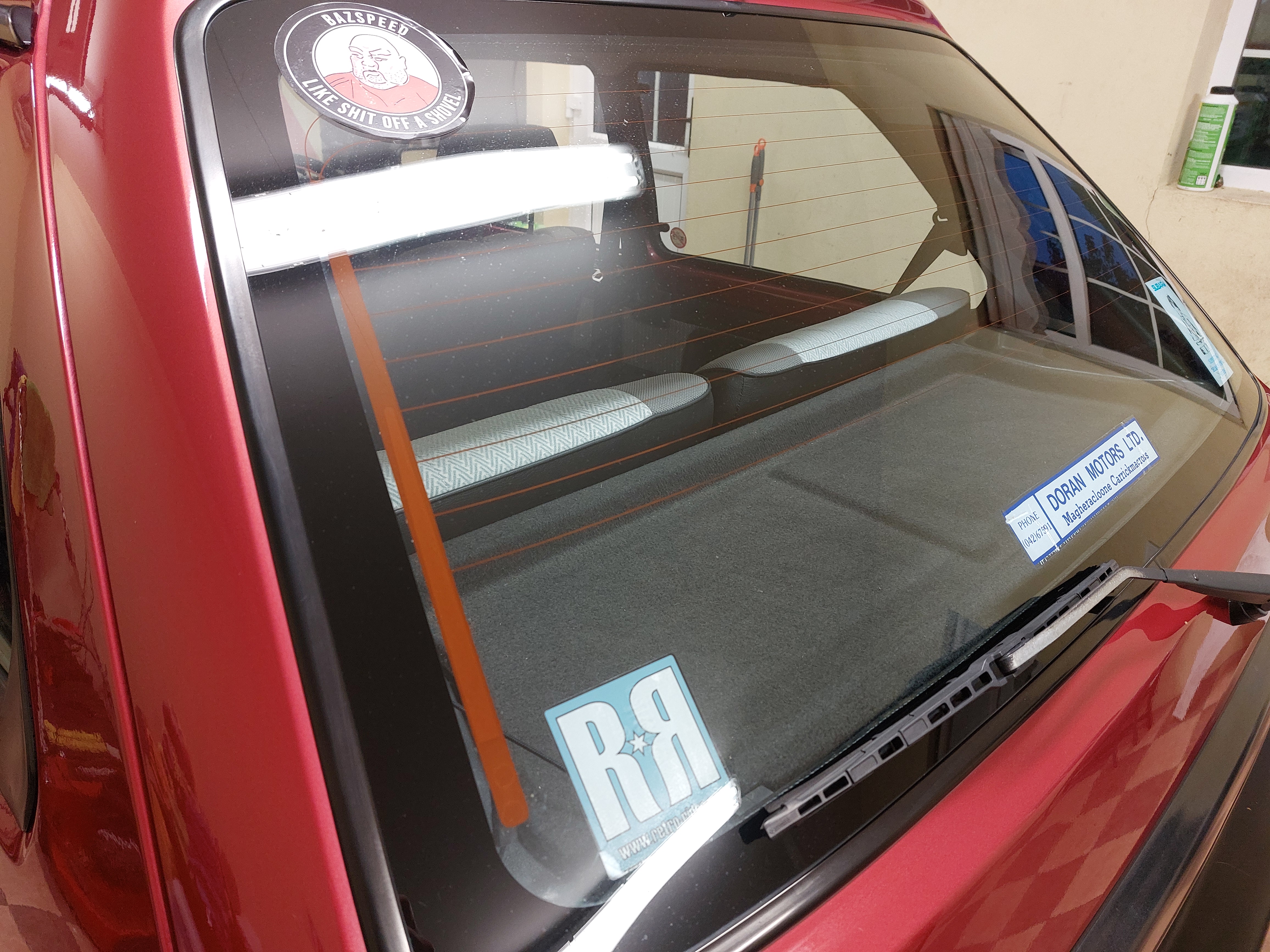

Thought it was a carb issue but it was clean, turns out it was the Points. Which I had spare in the boot so did that when I came back.
Going alright now.

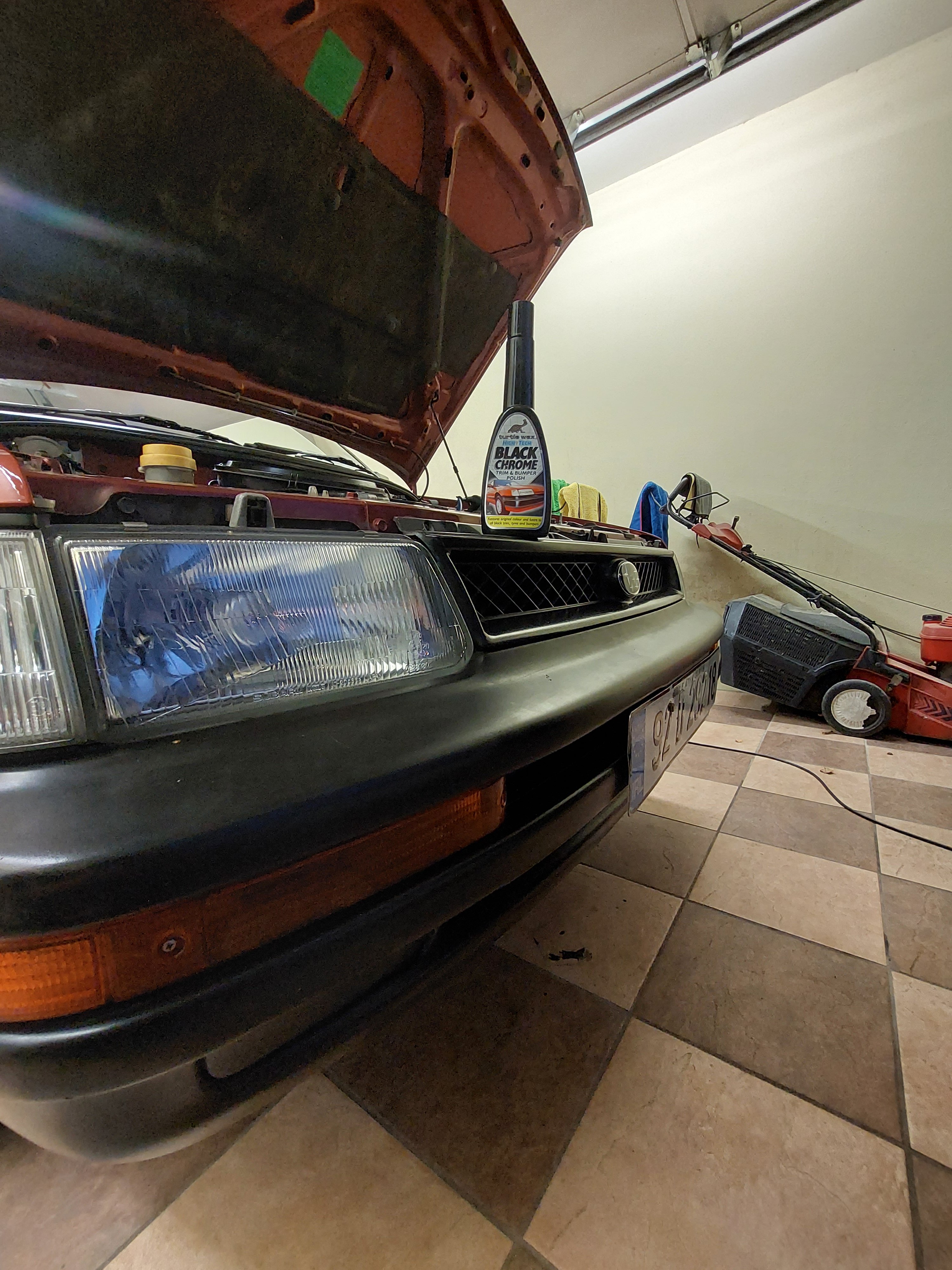

Had a bottle of stuff in the garage that's been there for years, made good work on the bumpers but was very messy. Seems to dye the bumpers instead of just shining them.
Did put a RR sticker on it, was there in spirit.

This thing wrecked my head with no spark
Changed the coil first, nothing
Changed the points, nope
Plugs?
Nope
Condenser?
Nope
Checked the wires, nothing odd
So I got annoyed and it sat in the garage.
Saw an accuspark kit for the the older ea8X series Subaru's and bought it to try.
While it didn't work, it included a new coil so put it on and it started.
So most likely I ordered a dud coil first and didn't check it properly.
That was fine. Got it driving, tried to take it to work one morning and got to the bottom of my hill before it started acting weird. Got halfway back up said hill and it died.
Which caused this.
So spark was fine, but wasn't working right
Timings fine, spark is wrong.
What could possibly be wrong.
Have spark, have air, guess what wasn't getting through properly?
But it would start and drive, then sputter and die when accelerating.
So the C word once again.
