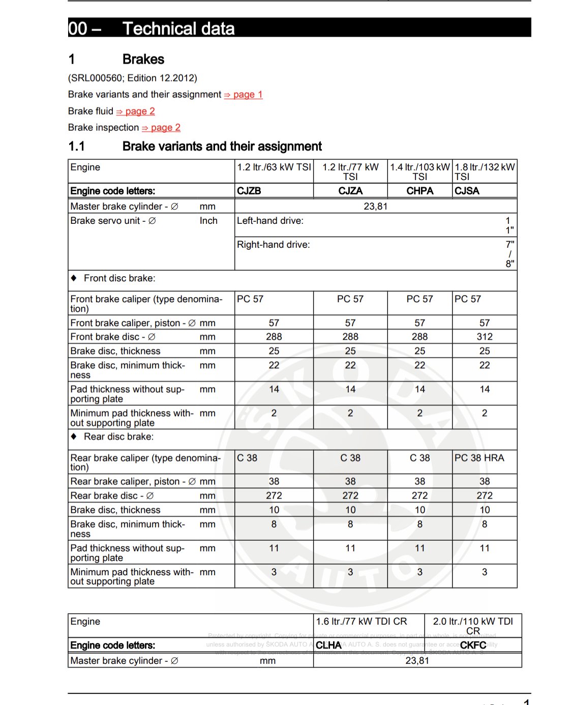

There’s the thickness values. Can measure with a set of vernier callipers pretty crudely by using a couple of nuts and zeroing it to get over the lip at the edge of the disc.

Nowadays esp on European make cars anyway, as you'll see from the specs 1mm or 1.5mm mm wear allowance on each face, generally you'll find your pretty close to that by the time the pads are gone..

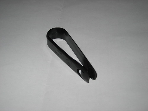

This is not the tool you are looking for.  you want the Plastic Tweezers in the tool kit.

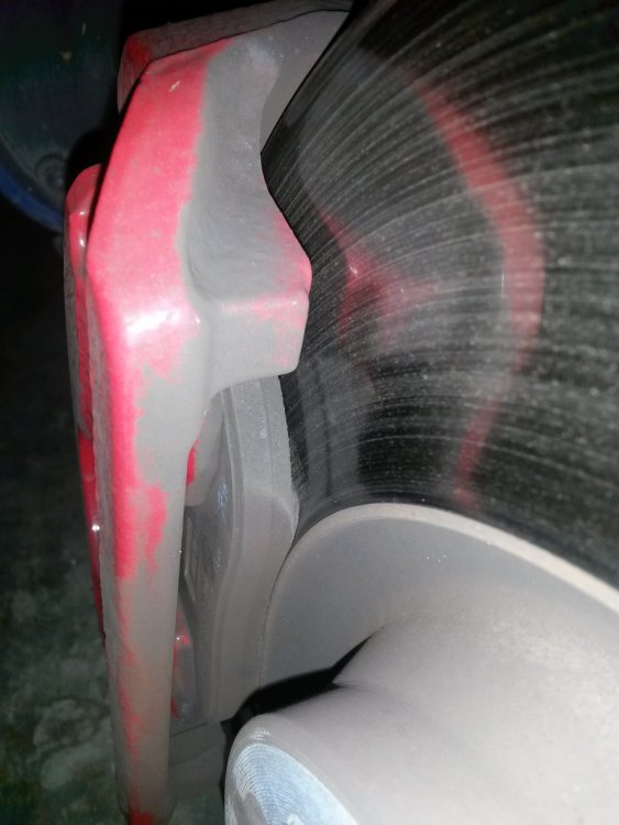

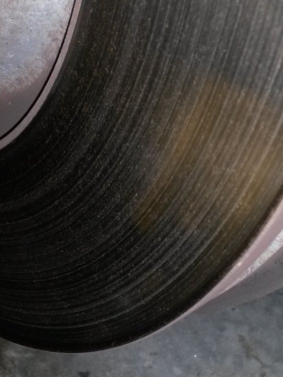

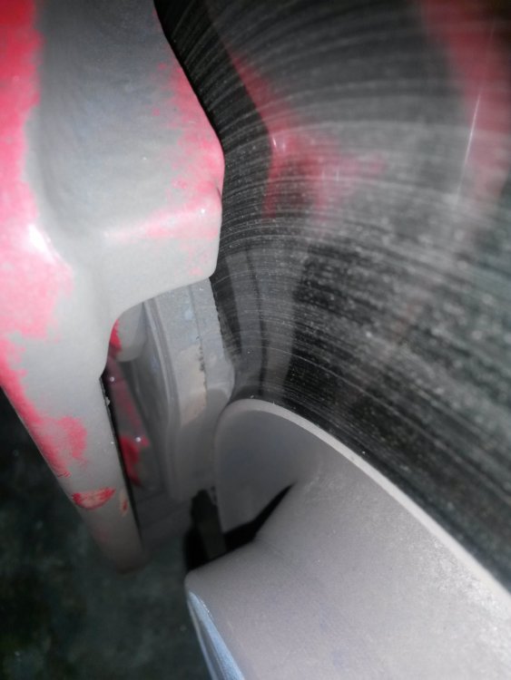

Thanks for all the assistance with this. Yes, they were caps on top of the actual wheel nuts. I finally had a chance to pull the front passenger wheel off and take some photos. Hopefully they capture the necessary detail.
Thanks
Well, we are only looking at 1 of 2 wheels. So ideally inspect both. Computer screens and photos are not the best for measuring things either to be honest.
Also, there is an inner pad and outer and I'm not sure if your 2xphotos show the same pad or an inner and outer. Anyway it is hard to measure from screen but the friction material left is not too dissimilar to the backing thickness of the pad. At a guess, and that is all it is, maybe 6mm?....  If that is so, possibly 2/3 warn (14mm-2mm=12mm new vs 6mm-2mm =4mm left. The disc does seem to show a wear lip and will likely need replacing when you replace pads.
Fronts do more braking than rears, so do wear quicker and depends on your braking style. But if you've had the car for a while you'll know how long it has taken to wear them 2/3rd.. Check the measurement I have guessed and check other wheel both pad sides as well.
You could measure the lip on both surfaces of discs as indicative of disc wear, or better use a micrometer but I would confidently say you will be replacing with the pads anyway.
