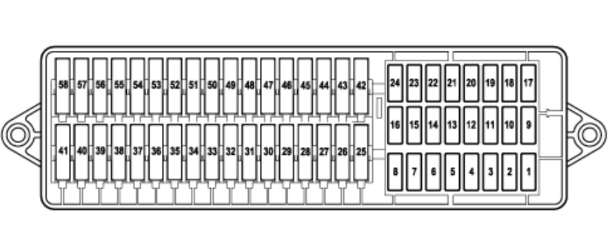

I did find what seems to be a good link for fuses in general, and has a great diagram, if, as you say, it is correct...
https://www.servicetutorials.com/2022/04/14/tutorial-skoda-fabia-mk2-2007-2014-fuse-panel-box-location-diagram/#:~:text=The fuse box is located,screwdriver to open the cover.&text=If playback doesn't begin shortly%2C try restarting your device.
Thank you again for your help. I'm very grateful! This forum is amazing and I hope to contribute back as well.
Martin

RHD fusebox is a rotated version of that, like this:
I would think removing fuse 46 may well solve your problem, and probably easier to do than snipping any wires.
Doubt it will have any other consequences.
Edit: Does the car have start/stop? If it does not, it might be fuse 54 you need to remove, if it is 15 Amp fuse?
Confusing mismatch between what that site you've quoted shows and what the official wiring info says about fuses 46 and 54.

Sorry if that diagram is off it's just what I found and seemed reasonable...
I'll let you know what I come up with!

In that case I'd expect fuse 54 to be the alarm horn, if it is a 15 Amp one.
Hi Pete and NTA - so, update.
Battery replaced. Siren goes off still.
Changed key fob batteries. Went off again.
I think thankfully there's a timeout on it or I'd lose my mind - I only have hearing in one ear and this is excruciating.
I also disconnected the main battery.
Stranegly, I went to pull fuse number 46. There's not one there! Could this be the issue?
The garage that was checking it out for me was testing down there a few days before this started? could they have left out a fuse?
Otherwise, Pete, I may try your fuse 54.
I may just have to cancel my Christmas plans... Dunno. I am tempted to just open thte top and remove the darn siren. It's a 2011, is not mint necessarily, and I don't leave anything of value in the car. This is too upsetting and I can't keep disturbing the neigbours.
thanks for any further ideas.

PS. Is THIS the darn thing?

I'd follow the advice of pulling fuse 54 especially as it's there to be pulled (I thought it related to stop/start alternative).
I totally understand about the alarm going off when you open the door, personally I can't stand car or house alarms.  If you're only third party (can you still get that?) and not third party, fire and theft then there's no worry about not having an alarm.
Sorry I've no idea what that thing is.
For tagging (I'd forgot that's what it's called) put the @ symbol in front as in @mlbSK2011
Once you've stopped the alarm going off you can get to take more photos to get help from others with the other electrical problem.
(I was hoping you'd be back by now saying you'd pulled the fuse and the alarm didn't go off.)
Do it, it's the right one on your car.

33 minutes ago, mlbSK2011 said:
one more -
Not to confuse things, but this source shows alarm at fuse 20... It's marked specifiacally for Skoda Fabia Mk2 2007-2014.
https://fusecheck.com/skoda/skoda-fabia-ii-2007-2014-fuse-diagram
Yes lots of info about but what is correct and what applies to your car,  your VIN should get you to the correct Owner's Manual.
Just about to put I'd follow the advice you'd been given before to try 54, so I'll just a triple up on that.

The report is, I stopped checking the computer, and opened up that bonnet, took up the plastic skuttle cover (?) and removed the thing. MIRACLES! I just didn't feel confident messing about with the fuses and having it go off anymore - some of my neighbours are elderly and it got late in the afternoon.
I'll have it in the garage 5 January and let them sort it, but I feel very empowered - am not a newbie to cars just to Skoda and such.
I noticed in another thread someone was saying they replaced with one made in Italy. Italy is also marked on mine. Appears someone's replaced this already.
The fellow this morning could not get any readings from the computer reader - so, we'll see how we figure this out...
