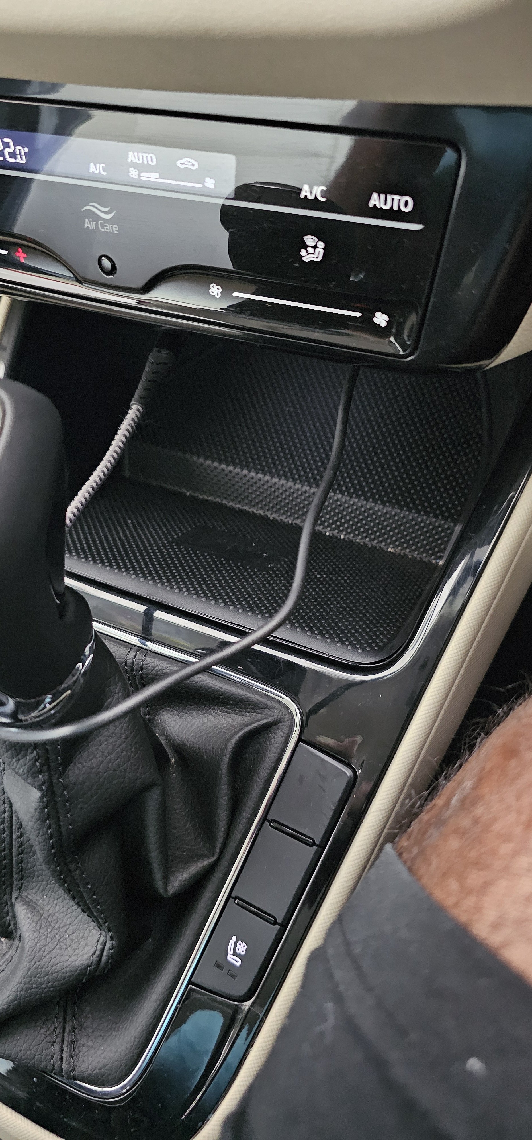

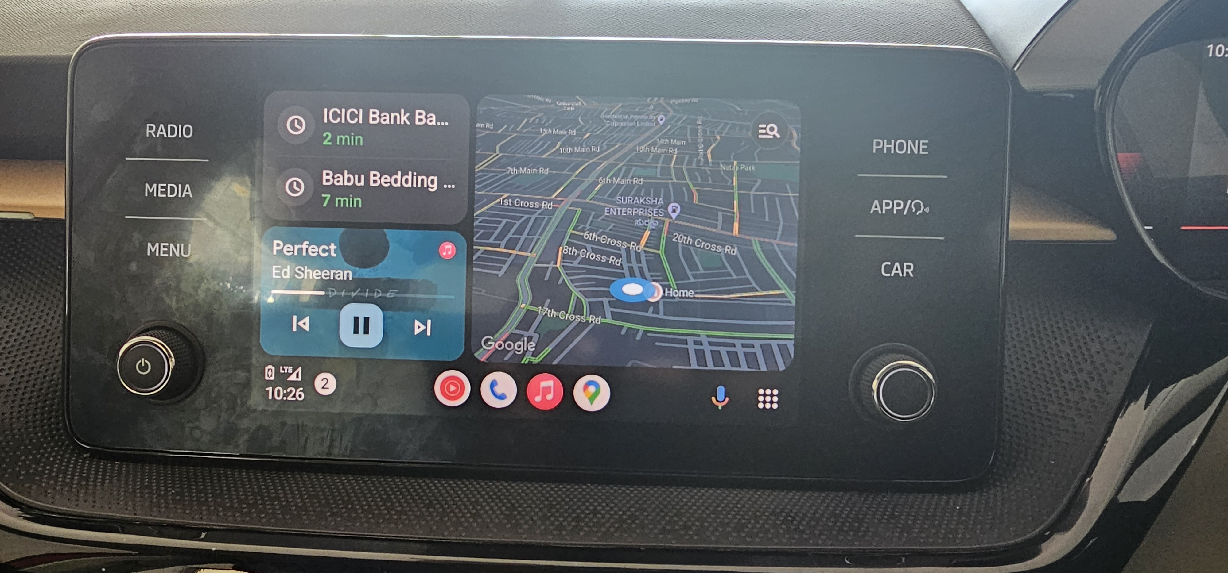

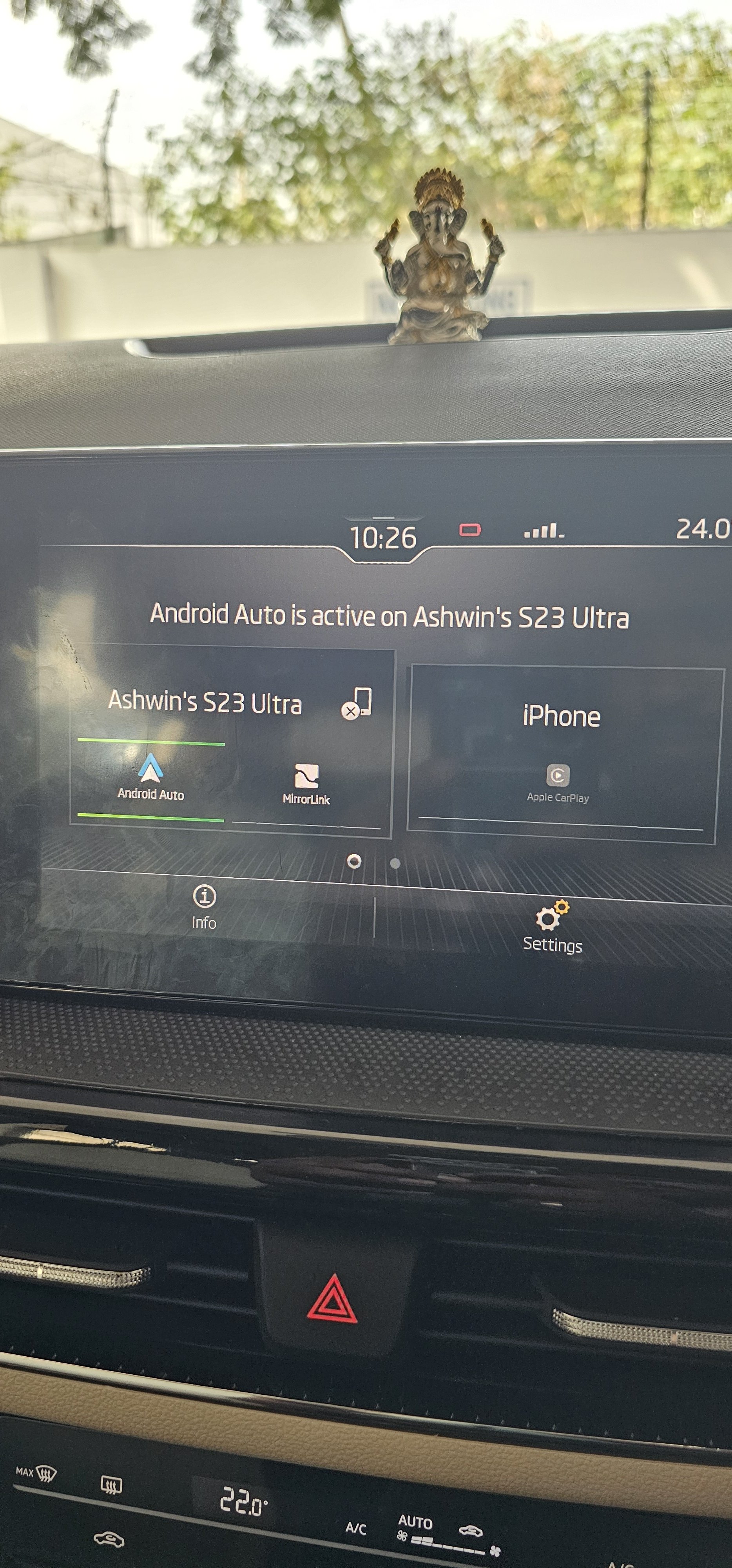

    I just updated to 1800, I have a Skoda Slavia in India with the Bolero system. I can confirm that the issue with S23 Ultra is finally resolved! Attaching images.

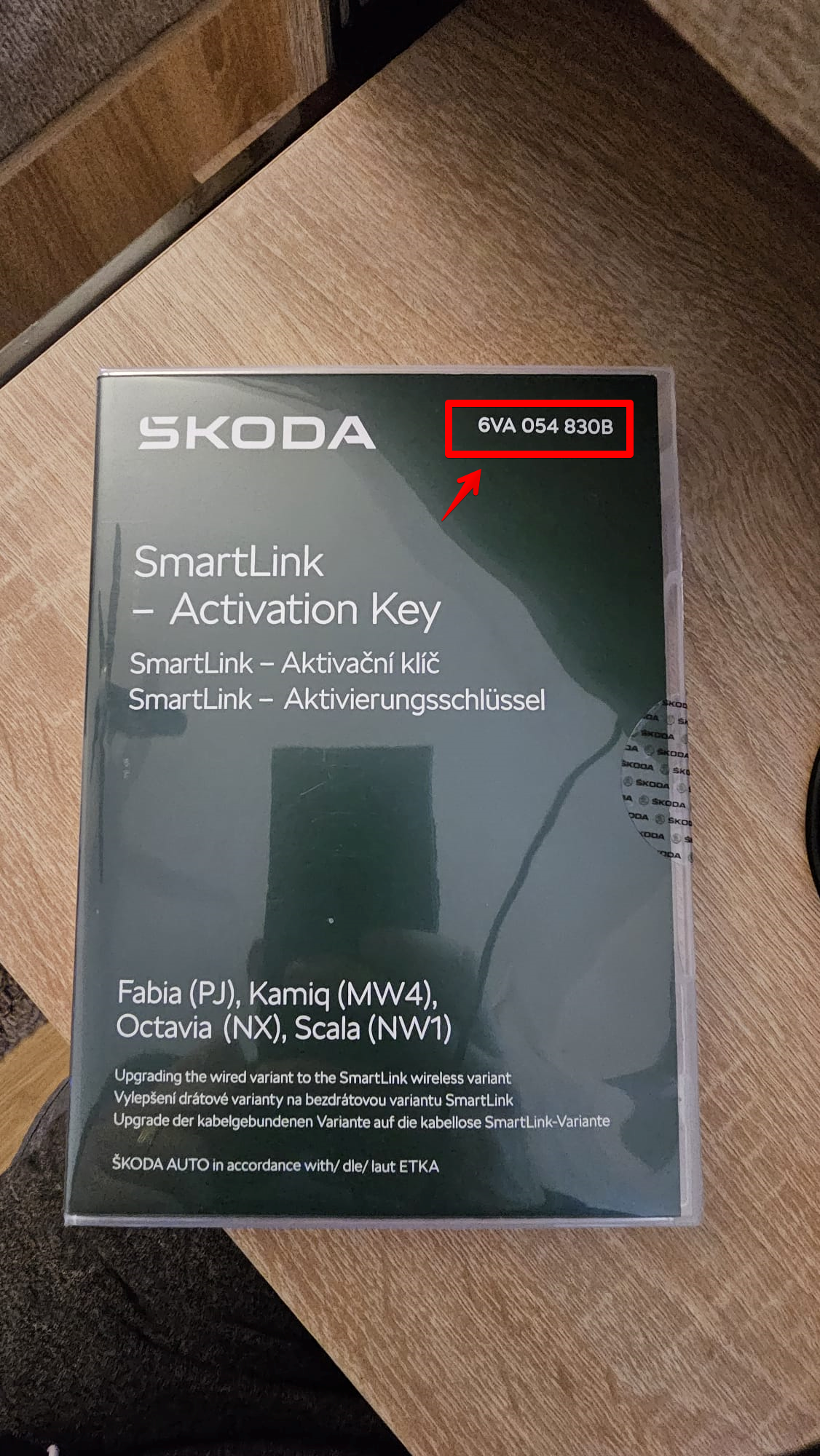

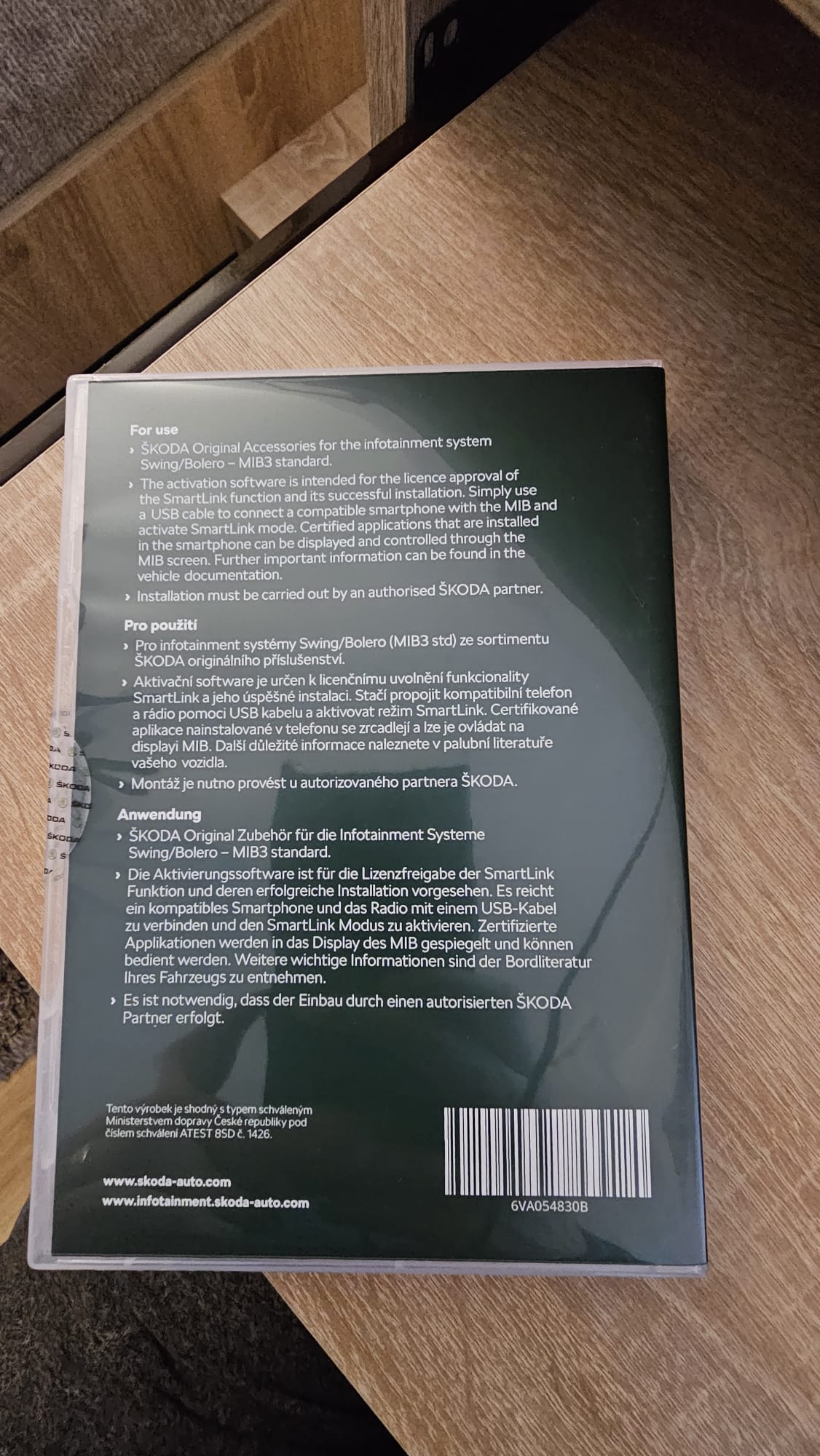

Sure. Will it be possible to share the front and back snip of the activation key package please? You can mask any PII information. I would like to show the same to Skoda India to check if they can confirm if it is available in India.
Thanks.
Thanks.
Yes here it is, it seems part number is 6VA054830B, not sure about availability in India.
