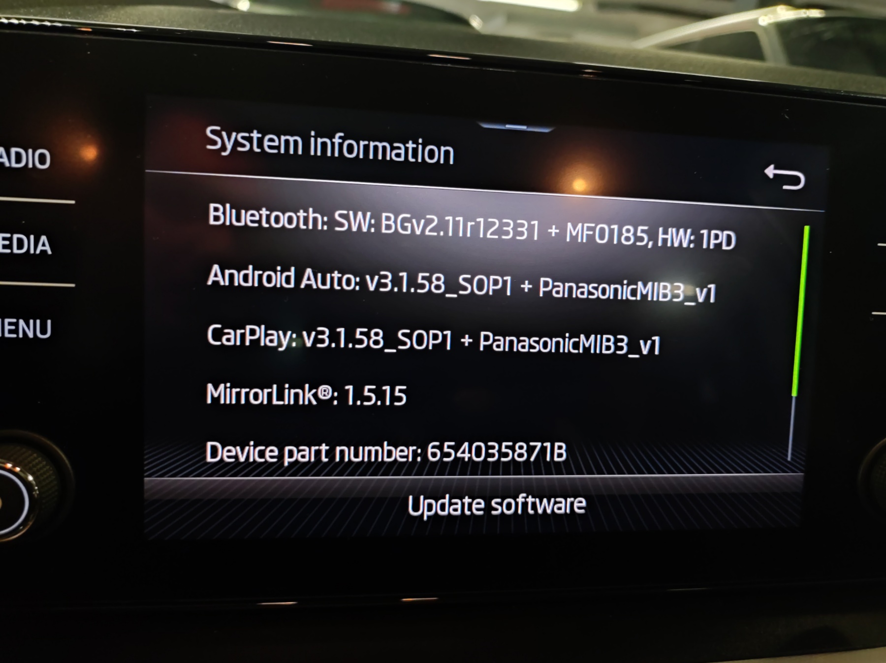

I went to the dealer and they made an update from the version in the photo below(0469) to 0742. They did not say that there were any newer version for this media unit.
Does anyone know if 0742 is the dead end for me or can I proceed to updating myself to 1800?
0-02-05-bcd6ffa95e7936aa292cd11afca5d04d668aa6069e8af41b8c289edea4aebd2f_a161f7ddfc634fcc.jpg
742 is the latest for your MIB
1800 is for other versions , not yours

Sorry, but how do I figure out which is the latest update suitable for my case? Is there an official summary? Because I read that some with my same MIB3_V1 are advised to update to later versions. While you tell me that the final version for my Bolero is 741 + 742. Sorry, it's not a lack of trust, it's just really confusing... 😦

for older scala/kamiq, 741+ 742 is the latest version curently available, you can ask the dealer.
