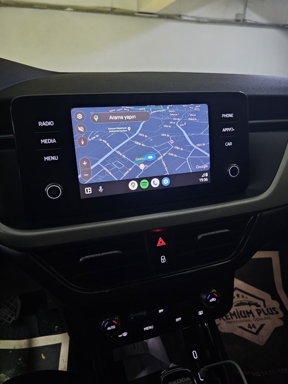

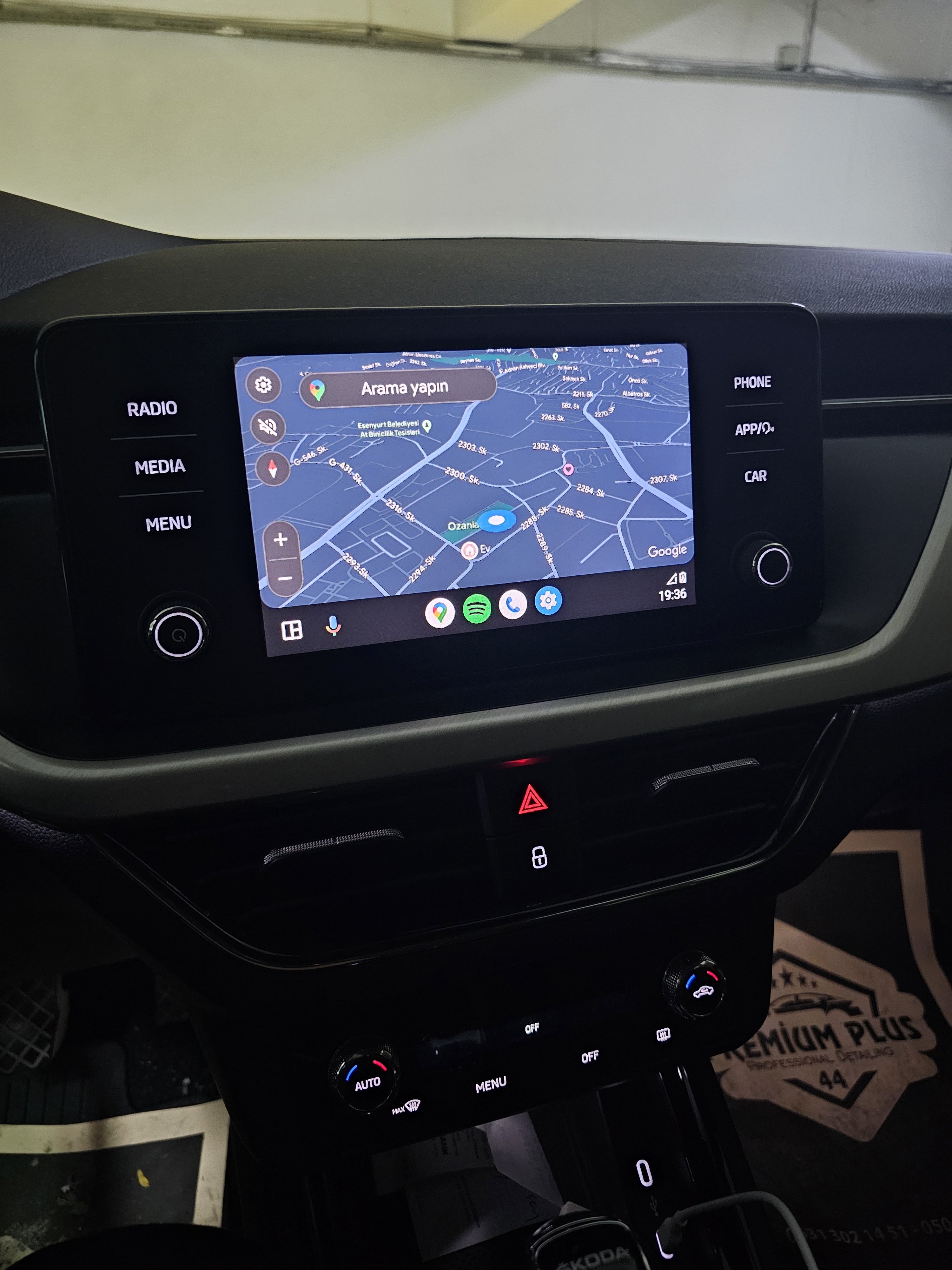

    I just updated to 1800, I have a Skoda Slavia in India with the Bolero system. I can confirm that the issue with S23 Ultra is finally resolved! Attaching images.

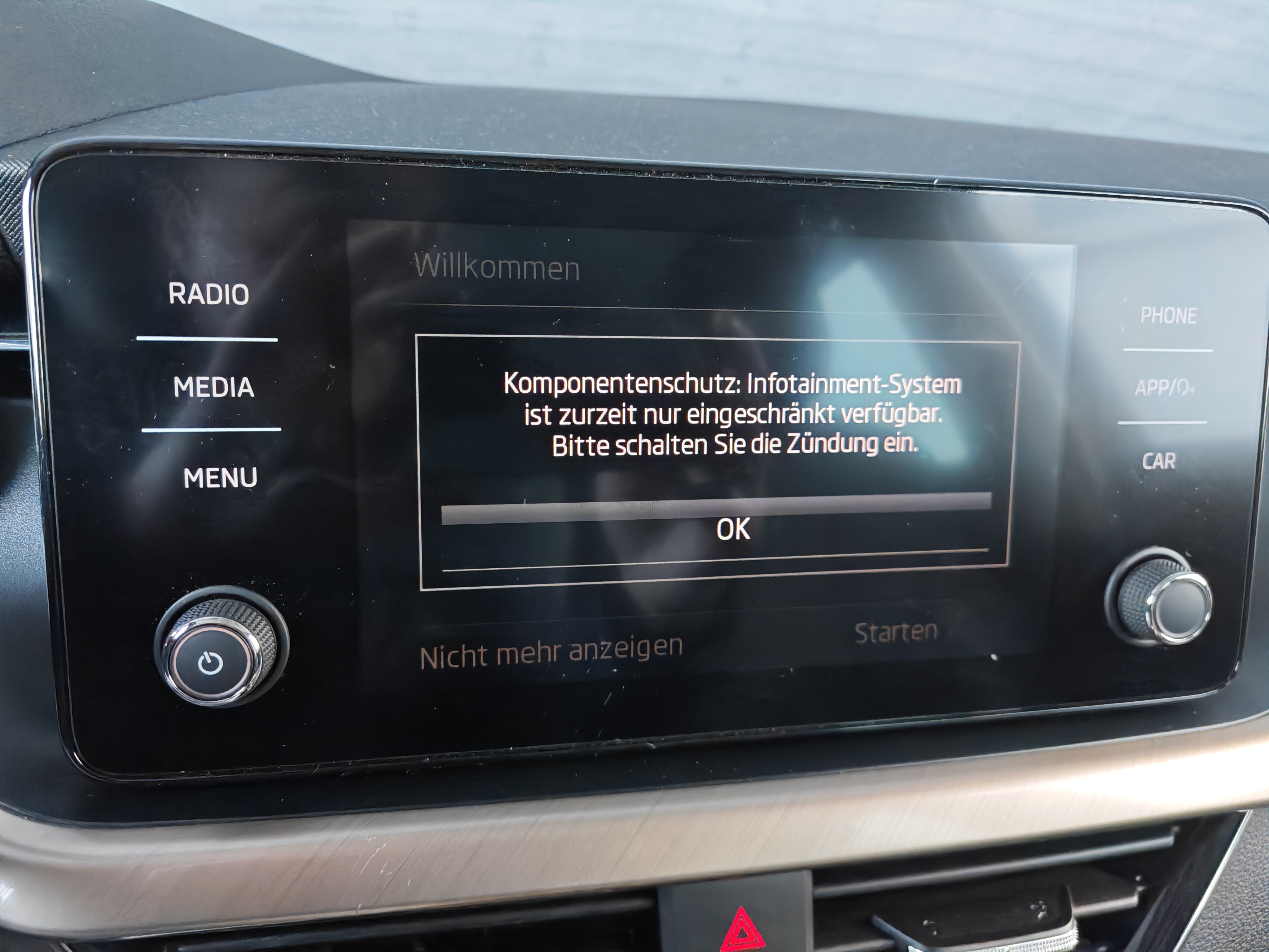

Was Error 28 but i forgot to do a picture. Now i buy a new device. Have any a Adresse where i can ASK for repair the old one ?
If i Install the new device in few days i need so anything or ist IT Plug and Play ?
did you press and hold power button?

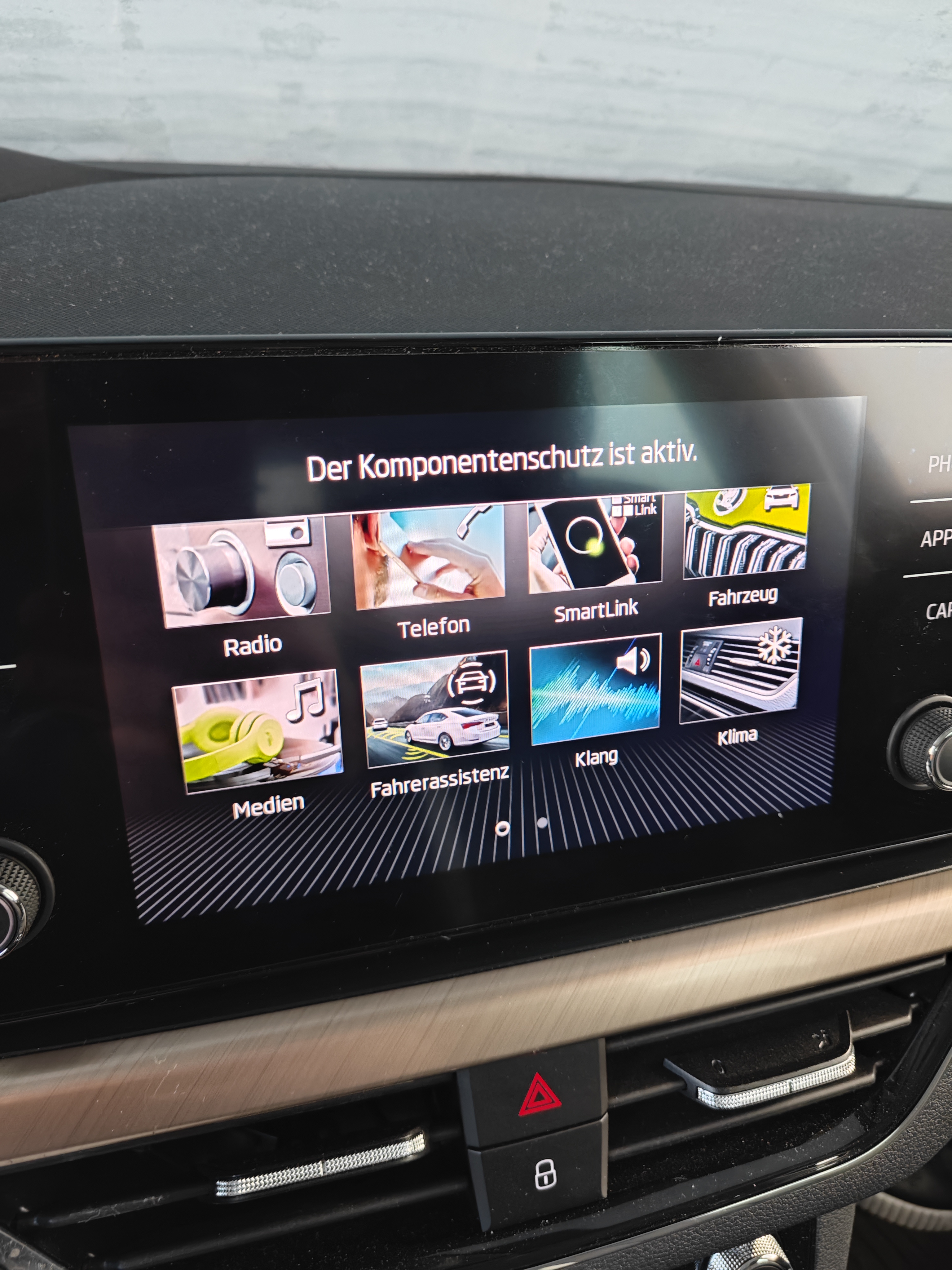

if you buy original, it has to be paired with factory Component Protection

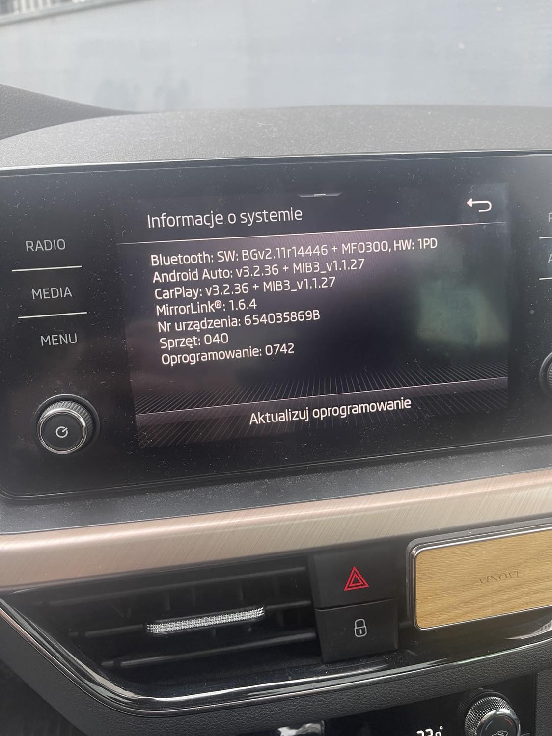

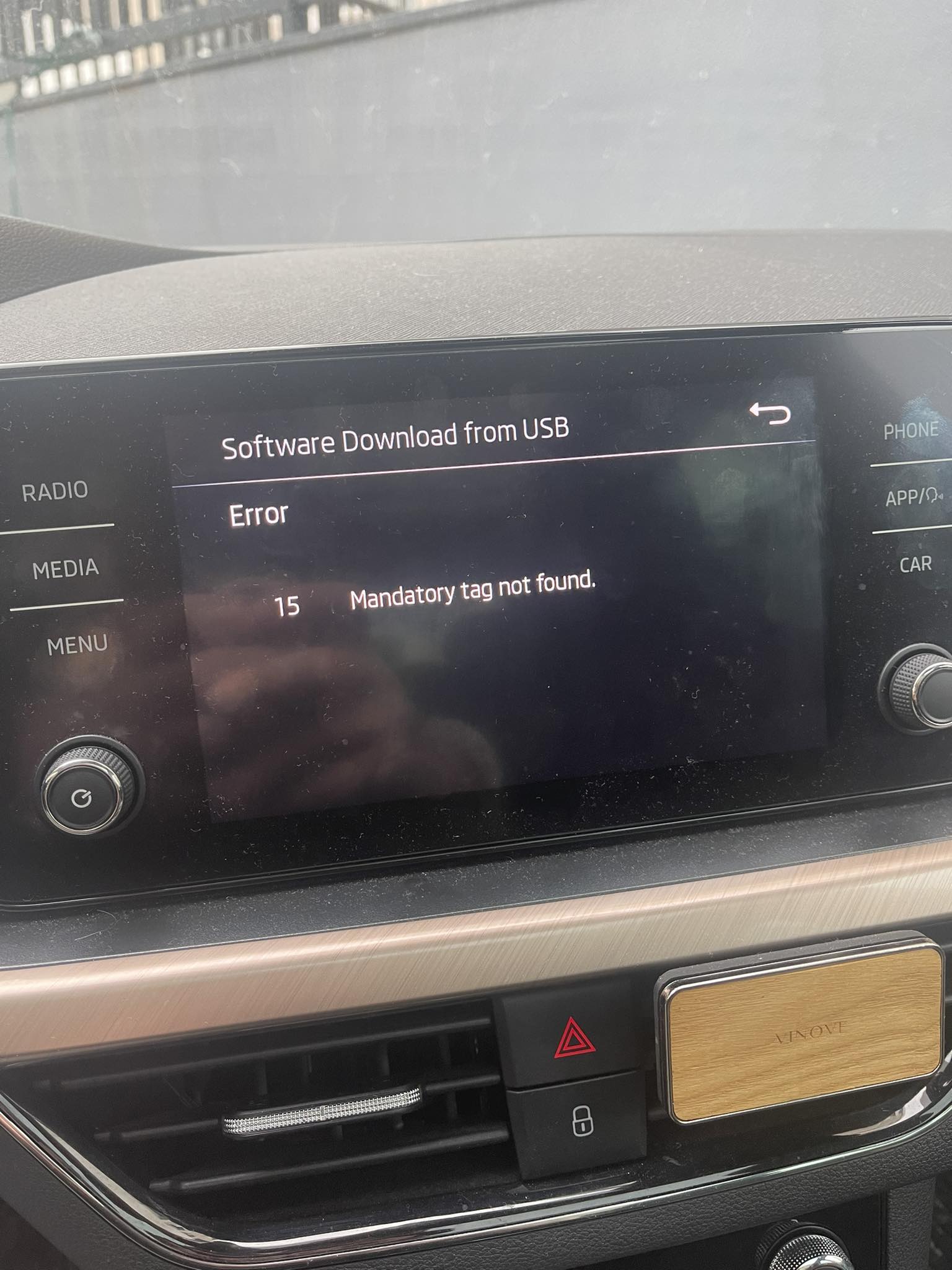

I made an upgrade from 0469 to 0742. At first there were problems, but after another attempt everything looked fine(in the logs device name scope everything is 'OK'). I proceeded with another update and got 'error 15 Mandatory tag not found.'. I found a thread about this error on the site, but I do not know how the user(@fastyk) dealt with this problem  https://www.drive2.ru/l/660221549181157763/?page=0#comments
what is the SW that gives this error?
0742 is the latest firmware for your unit, you should not go higer
Edited by andreiro221
MEN3_EU_SK370_P2135P - 0742
This error is displayed depending on how many folders are on the pendrive for example, if there are three folders on the pendrive then each is displayed as this error . Before the update from 0469 to 0742 everything displayed correctly, each folder.
Today I scanned ODBEleven and noticed that I have error F5 B201A, I don't know if it can be related to this error when trying to update
Error B201A will occur after each software update, to remove it, calculate the appropriate checksums using, for example, this tool: https://mib-helper.com/im-so-xory/
