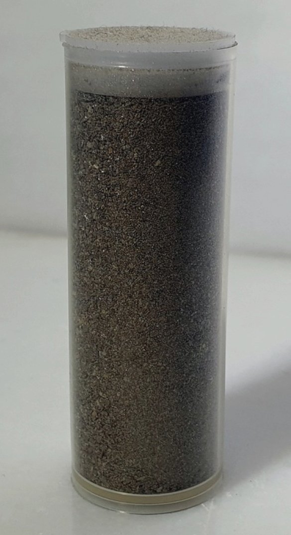

As for the sealant (dust) that i have used in the past looks like this
it must be the culprit for those ''glitters''.
You would not like 4-Life as it will find the slightest opportunity to leak.
I would imagine that sealant dust might well be your glitters, usually it's in a liquid for use.  One example only, used (or was if not now) by at least on large breakdown/recovery service in the UK. - https://www.kseal.com/uk/products/k-seal

I have no ''suspicius'' symptoms for gasket failure (for those which i read in relative articles) but i bought the Bromothymol Blue test, it will arrive in 2 days.
Since i have no radiator cap i will use it in the expansion tank (in the place of it's own cap) and as i heard the car must be warm.
