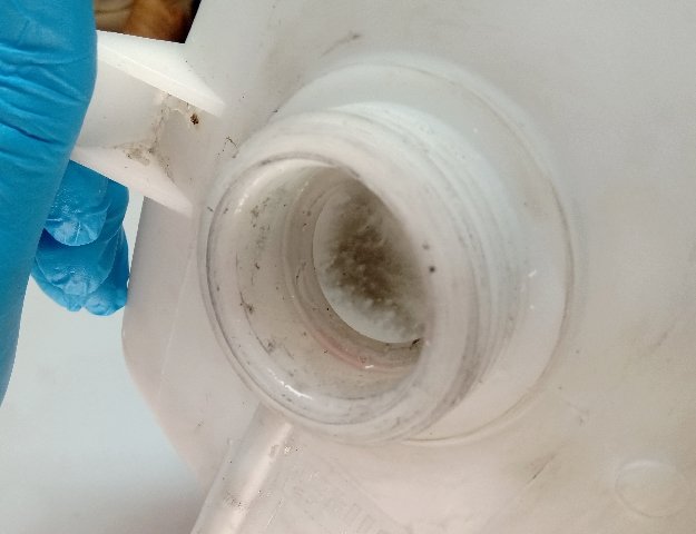

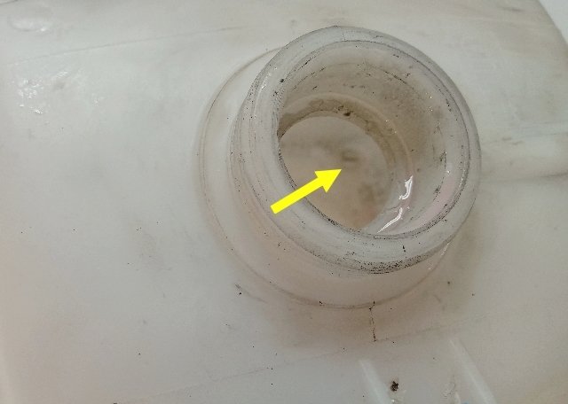

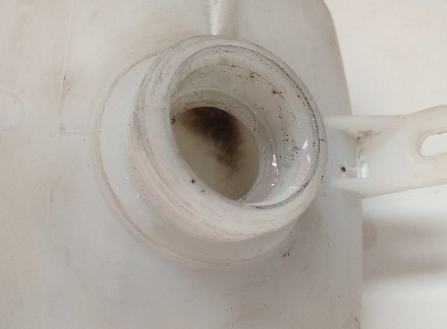

Here are 2 photos from inside the expansion tank, isn't compleately clear.
I want to do a 2 stage flush, first with a 80% of a radiator cleaner (as Liqui Moly or Wynn's) and the existing coolant BUT then another one with the 20% remains and tap water.
I wonder it's absolutely necessary for the radiator cleaner to work ONLY with coolant? That 2 stage task won't clean the whole system better?
Try asking the manufacturers but I would not be surprised if they only say they can recommend using their products as the directions on their packaging and data sheets but it might depend on who you speak to at the companies.
Doing it the way you want is diluting the cleaner from what is recommended on the first stage and a very diluted cleaner on second stage and you will still have to flush thoroughly to get everything you can out of the system.  Better IMO would be 100% on first stage then thorough flushes and back-flushes until the water coming out is very clean.

First impressions: i left the car to the repair shop, later the mechanic said that immediately the additive start to make something like "chemical reaction" and after few hundred meters (to get the coolant hot) saw some dark spots on the expansion tank (now has distilled water and the additive which also has clear colour).
So there is still some muck left inside the system, i will know more in the next days because due to hot weather i took my motorcycle to go to work.
Tomorrow i will have in my hands the old expansion tank (install a new one) and i will post photos of any remains.
Let's hope that in the new one i wouldn't see anything and the whole system will be clean after 2 flushes.

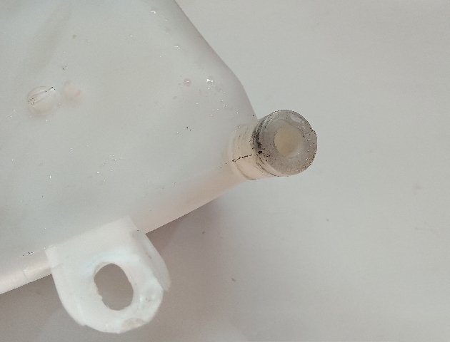

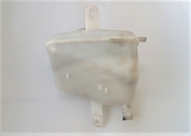

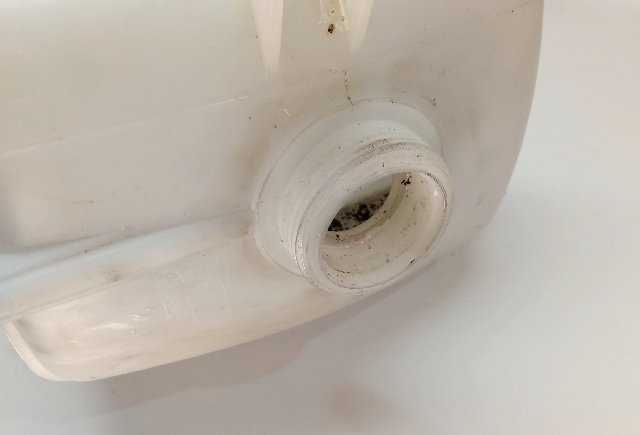

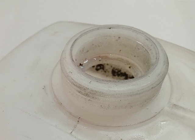

Here are some photos from previous expansion tank, the last with G11.
As you can see still there is some muck inside,not as the first one but exists. I see no glitters by the way.

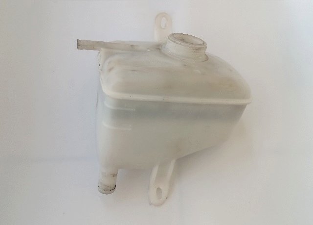

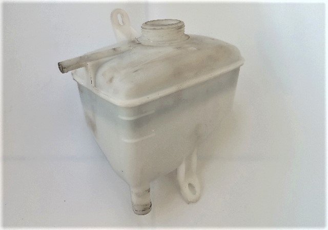

The arrow shows the exit of the tank
from there via hose goes to the bottom of the radiator. As you can see there is no muck stuck in there.
Lets' hope that i will never see again such a dirty expansion tank. Now i have new with G12 which everybody says about it ''Oh, you put G12; the VW one" because in their mind the G12 is interwoven with the VW group.

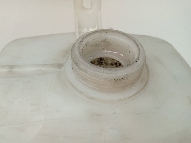

Last photos before goes to recycle bin.
Let's hope that i will never see again an expansion tank like this in my car.
