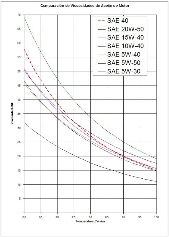

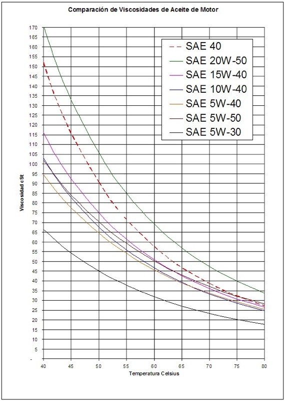

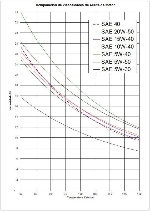

And i long as i live i will never return to 15W- for my Felicia.
I'm still trying to find a good 10W50 to switch and try but I can only find racing oils and the ones from Ravenol are not available even on Autodoc.
Switching to 5W is strictly prohibited so my only remaining option is what I've been doing since I got ownership of the vehicle and that is 15W50
Why? Either a political reason with no technical background or a proper technical explanation as to why a low Winter viscosity oil may not be used please.
Skoda prohibits it, but really the intermediate viscosity at room temperature is problematic, not so for the engine itself but rather for the gaskets...
Edited by Thefeliciahacker
  1. Skoda may not recommend using a 5W-Something multigrade oil, but have no legal power to prohibit anything.
  2. There are only 2 known values for a multigrade oil, a W (winter) value measured at an oil temperature of 0C and a hot value measured at 100C. At all other times unless the oil is extremely hot or cold the viscosity is between the quoted values.
  3. Other than on the edges of the sump, cylinder head, rocker cover and oil pump if applicable, engine oil does not contact gaskets, and where it does, these edges are not wearing faces. If you doubt this, please go and look at a scale drawing of an engine showing accurate gasket thicknesses. Ok, oil may contact seals (eg crankshaft end seals), but the only known issue with them is if reverting from a "synthetic" oil to a pure mineral oil you may have contraction of the seals.
