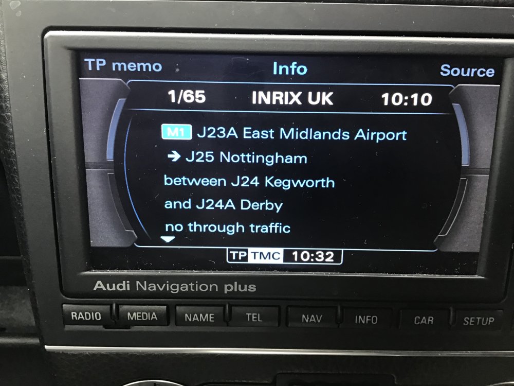

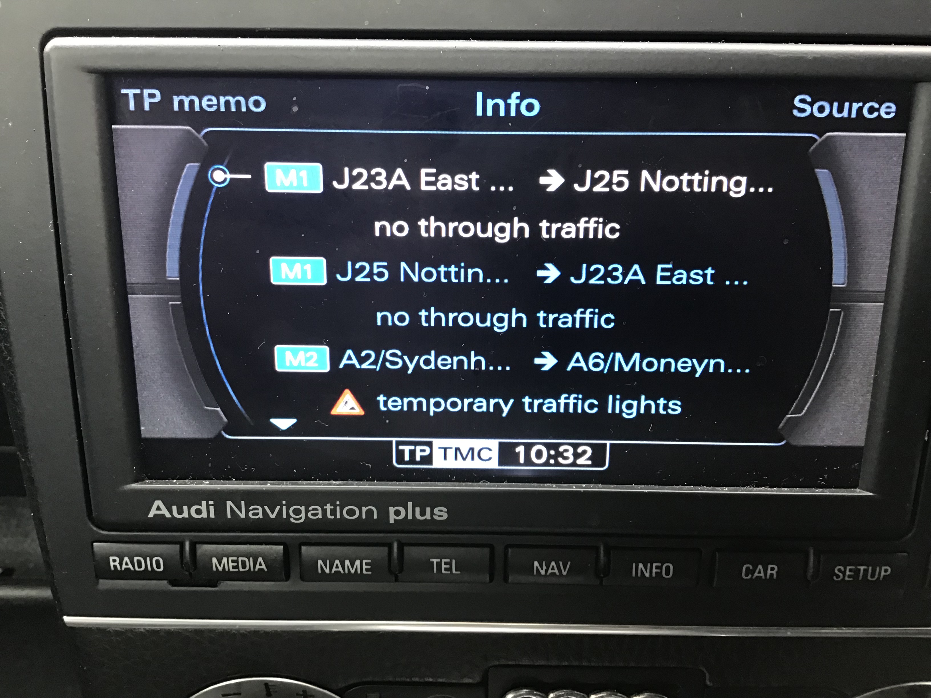

I’m as sure as I can be from looking at the Audi RNSE firmware (which has also suffered loss of its TMC service) that TMC elsewhere in Europe is completely unaffected. I have a lot of customers based there using my updated RNSE firmware and not a single one (other than those in the UK) are reporting loss of service.
In fact I even switched the firmware to listen to INRIX, and the missing TMC messages have reappeared. However the indicated locations are complete and utter garbage since the location tables used by Trafficmaster are completely different from INRIX as they are competing commercial suppliers.
That is interesting. So it seems that a Firmware tweek along with new maps containing the INRIX location tables would solve the problem. I hope you don't mind but I have sent this info to the person I am dealing with at Audi obviously not mentioning your uprated software in case they have a problem over it.

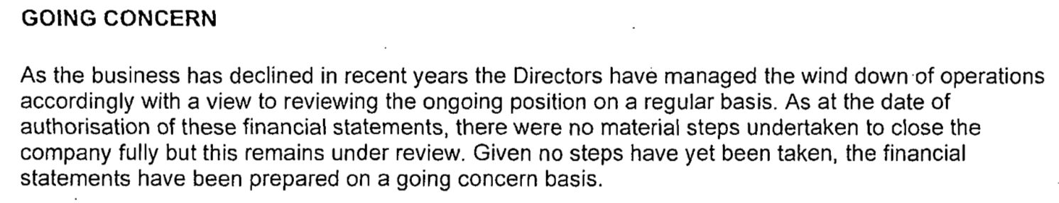

I’m not sure what the deal is with Trafficmaster, but Ofcom do not appear to be responsible for auctioning their licence. Ofcoms only responsibility is for the national additional services licence on Classic.
It seems likely that due to the way their networks came about, Capital and Heart probably own the rights to use their additional services bandwidth and it is therefore not subject to a competitive tender process. I draw this conclusion from the Ofcom documents, and the fact that even the last tender process (for the previous period in 2010) mentions only a SINGLE national additional services licence, and yet we know that TrafficMaster used to broadcast on Capital/Heart in conjunction with the service on Classic.
Regrettably it seems to me this whole process is conceptually flawed. Since the location tables are owned and maintained by the service providers, it means that a change of licensee will result in a termination of service to existing devices, unless by chance they are still receiving an updates from the manufacturer, and the manufacturer chooses to contract with the new provider. Typical non-joined up government thinking if you ask me.
To emphasise: that’s not what’s happened here, the termination of the TrafficMaster service on  Capital/Heart seems to be down to other factors. But I’d be surprised if they weren’t also commercial in nature. Their 2021 accounts don’t look particularly healthy and note the directors comments…
Edit: Adding link https://find-and-update.company-information.service.gov.uk/company/03666090
