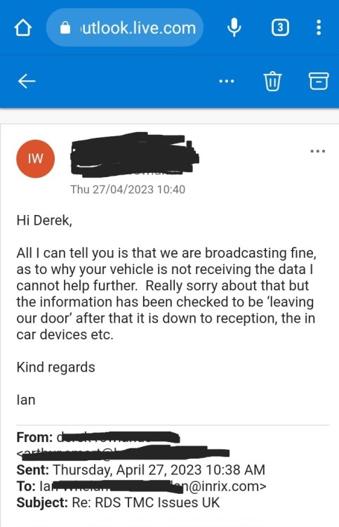

Just to confirm,  INRIX are definitely the current supplier of RDS TMC FM in the UK at the present time.
I have been discussing the issue with them and they tell me that their systems are working correctly........

Is it still sent via Classic FM?
Yes, Inrix have stated that it is still carried on Classic FM signal and that nothing has changed their end...

There are two TMC providers in the UK:
- INRIX who broadcast via Classic FM
- Trafficmaster who broadcast on various local/regional stations
VAG use Trafficmaster for TMC over FM in the UK which has now been turned off. They haven't got the licence to use INRIX afaik...
VAG need to decide where they want to get TMC data from and then roll out an update to switch to it. This may involve paying INRIX for their service or switching to TMC/TPEG over DAB but it's down to VAG :)
