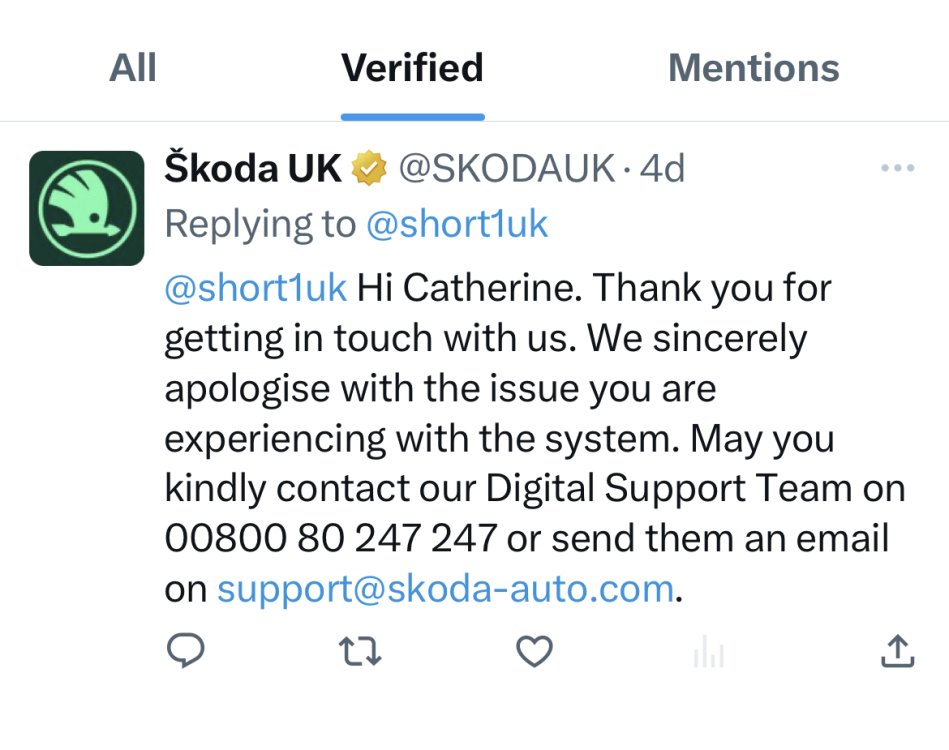

1 minute ago, short1uk said:
Get on twitter let’s raise awareness
This seems to be the standard reply from VAG group. The Digital Support Team will now tell you they do not deal with RDS-TMC because it is not digital and refer you to a main dealer for an unnecessary and expensive diagnostic check which will reveal that their are no faults and that they do not know how to fix the problem.😡

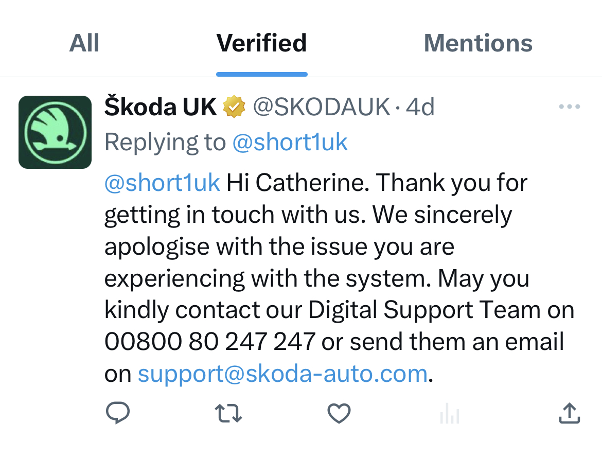

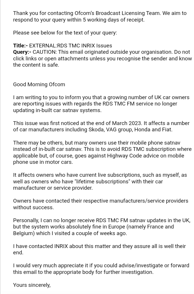

Further to previous info, Ofcom have allocated an Investigation Number to my email.
Here is that email.......
Excellent mail, but the problems not with INRIX. There are (or were up until a month or so ago) 2 separate and competing TMC service providers in the UK. Trafficmaster, who broadcast on Capital, Heart etc, and INRIX who broadcast on Classic FM.
INRIX is indeed continuing to broadcast and functions perfectly normally for receivers that have a licence to use their service. Unfortunately it seems most (maybe all) VAG systems are licenced only to use Trafficmaster broadcasts. Trafficmaster appear to have decided that they no longer wish to provide a service on FM.
