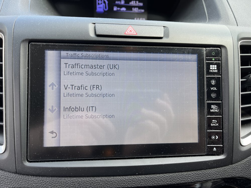

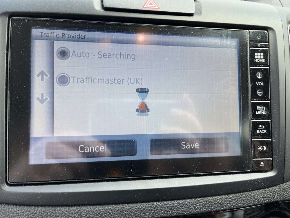

Exactly same issue on my mums Honda CR-V
This shows graphically that it is not just VAG cars. It is also Honda.....  along with many other manufacturers.  The problem also affects stand alone satnavs that use Trafficmaster RDS TMC (such as Garmin).
As noted earlier, this will affect hundreds of thousands of UK vehicles and satnav owners, as well as those tourists travelling to the UK.
As for your mum and her Honda, she has a few options......
