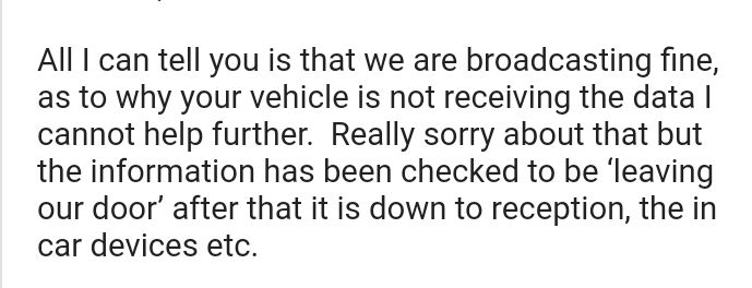

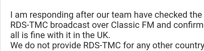

Busy morning for me !!!
I can now confirm that INRIX are the current provider for RDS TM in the UK.
Their engineers have check the system and advise of no issues there end.
I'll continue to pursue the matter.
Here are a couple of screenshots of excerpts from my email replies form INRIX......
