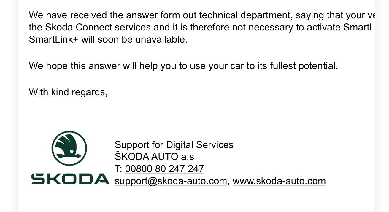

Slightly off topic but  this was the response I got re smartlink+ No longer working after an update on my car.
Is this car play for my iPhone?? Or just android?
Smartlink (CAR PLAY) will still work but not the additional plus stuff , really just the Skoda app and some data displays . I was annoyed as it just stopped working when my app upgraded. I do have the connected services so no big deal in itself apart from don’t like services dropping off and having to use subscriptions. I  use an iPhone so cannot say for android.
Same has happened with media command you cannot download the app to make it work anymore on the Uk store
Edited by David55
Mistake
I have a data plug and Skoda connect it’s free. That gives me trip info etc and detects refuelling.
And I use car play with my iPhone for music and maps
