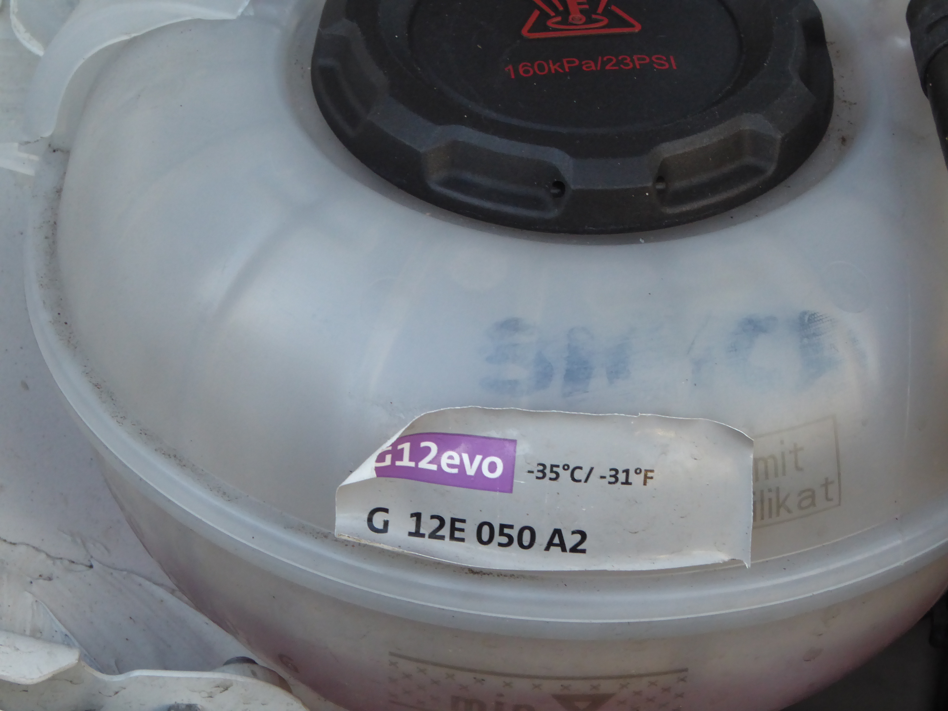

Example, pic attached is my expansion tank. It's pretty clear what coolant is in the system. (Or at least is claimed to be in the system.) I also wrote (NO SILICA) on the tank, but the permanent marker was not so permanent. 😞
G12evo coolant is pretty pricey, so the additional parts cost of changing the relatively cheap expansion tank isn't prohibitive, if you're going to change the coolant anyway. However if you're 100% sure the silica bag was removed intact and without having leaked any silica into your coolant system, it's a cost you could potentially avoid.
Of course it might be that the previous owner replaced the coolant with G12evo when they removed the silica bag, in which case you don't need to do anything.
If I were you, I'd get a torch and have a very good look inside that expansion tank. I'd be looking for the silica bag, but also for any evidence of any sediment of any description in the tank. I've uploaded a pic of my expansion tank with the silica bag in-situ prior to me fishing it out, but the silica container can vary. (Just for the hell of it I've also uploaded a pic of my engine bay, because it's so clean and lahverly. :D)
If there was no silica bag and no sediment, I'd play it safe and change the coolant to G12evo and be glad someone else fished the silica bag out so I didn't have to.
If I found the silica bag, I'd uhm and ahh about deciding whether to fish the silica bag out or just change the expansion tank for one without a silica bag. Then I'd go with whatever I decided after all the uhming and ahhing and also change the coolant to G12evo.
If there was any trace of sediment in the expansion tank, probably be asking for advice on whether it was worth flushing the coolant system before changing the coolant to G12evo.

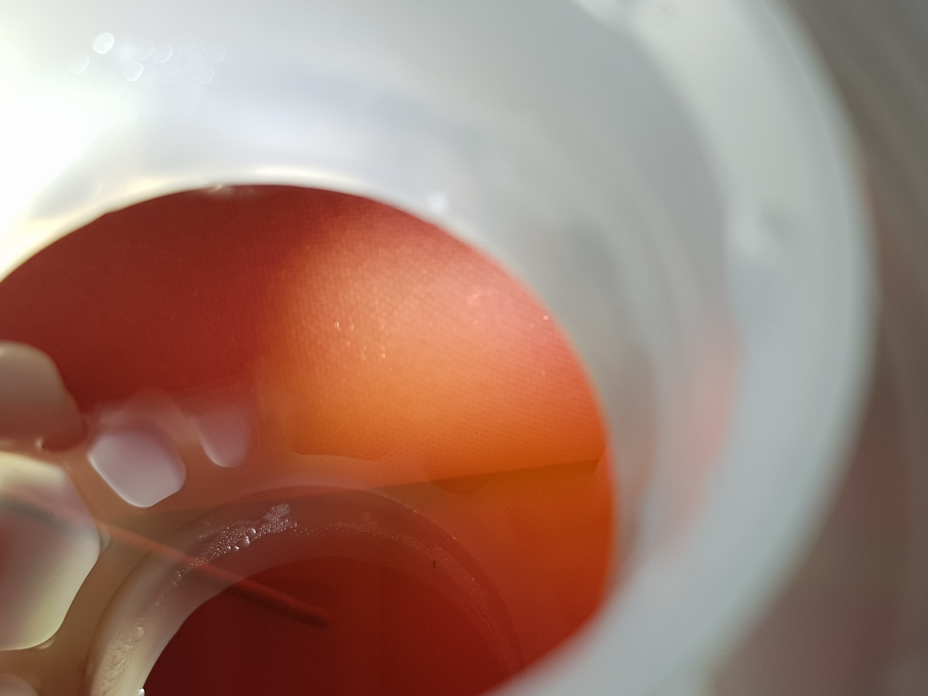

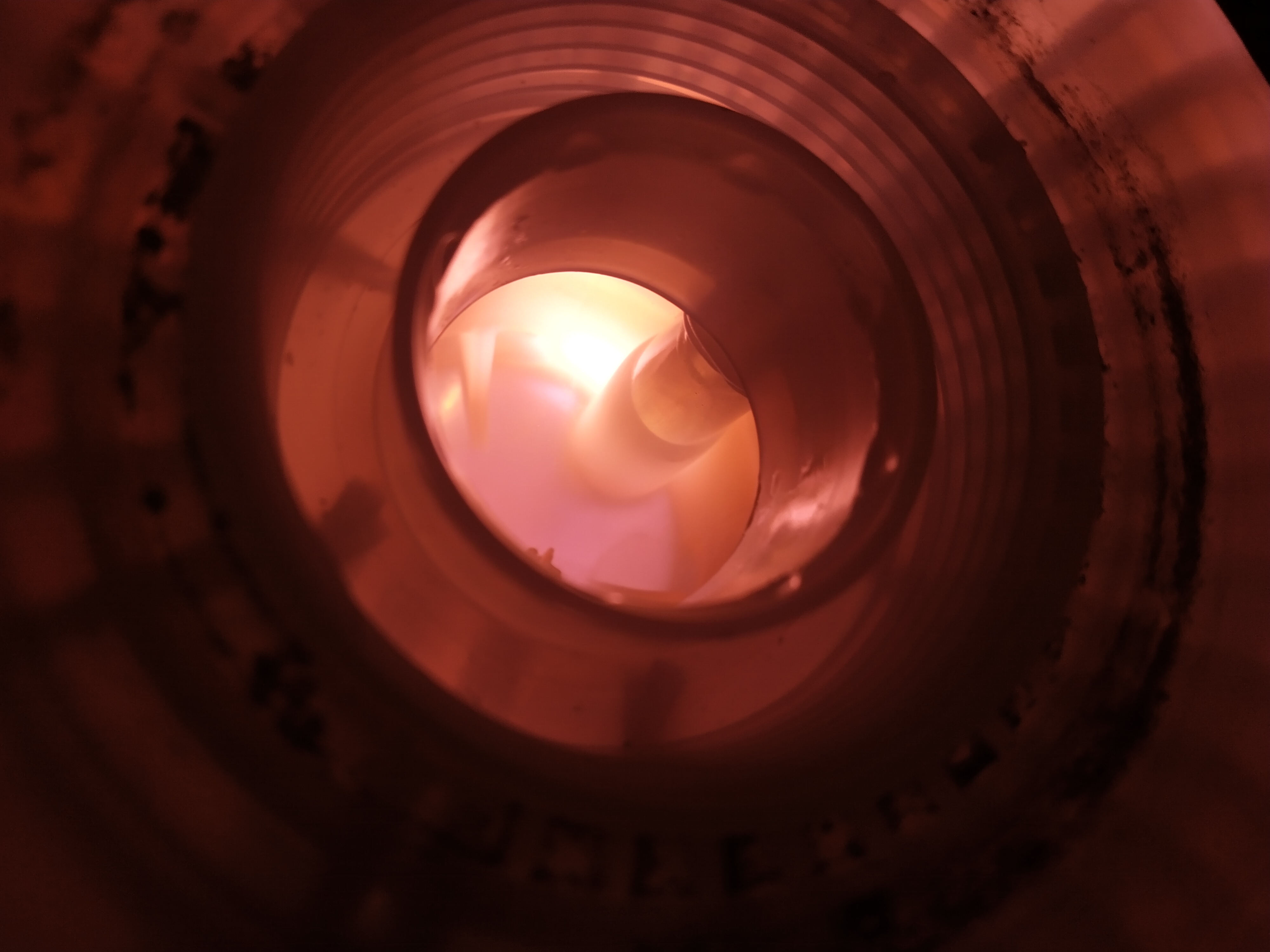

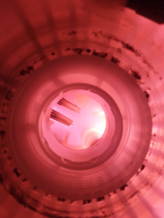

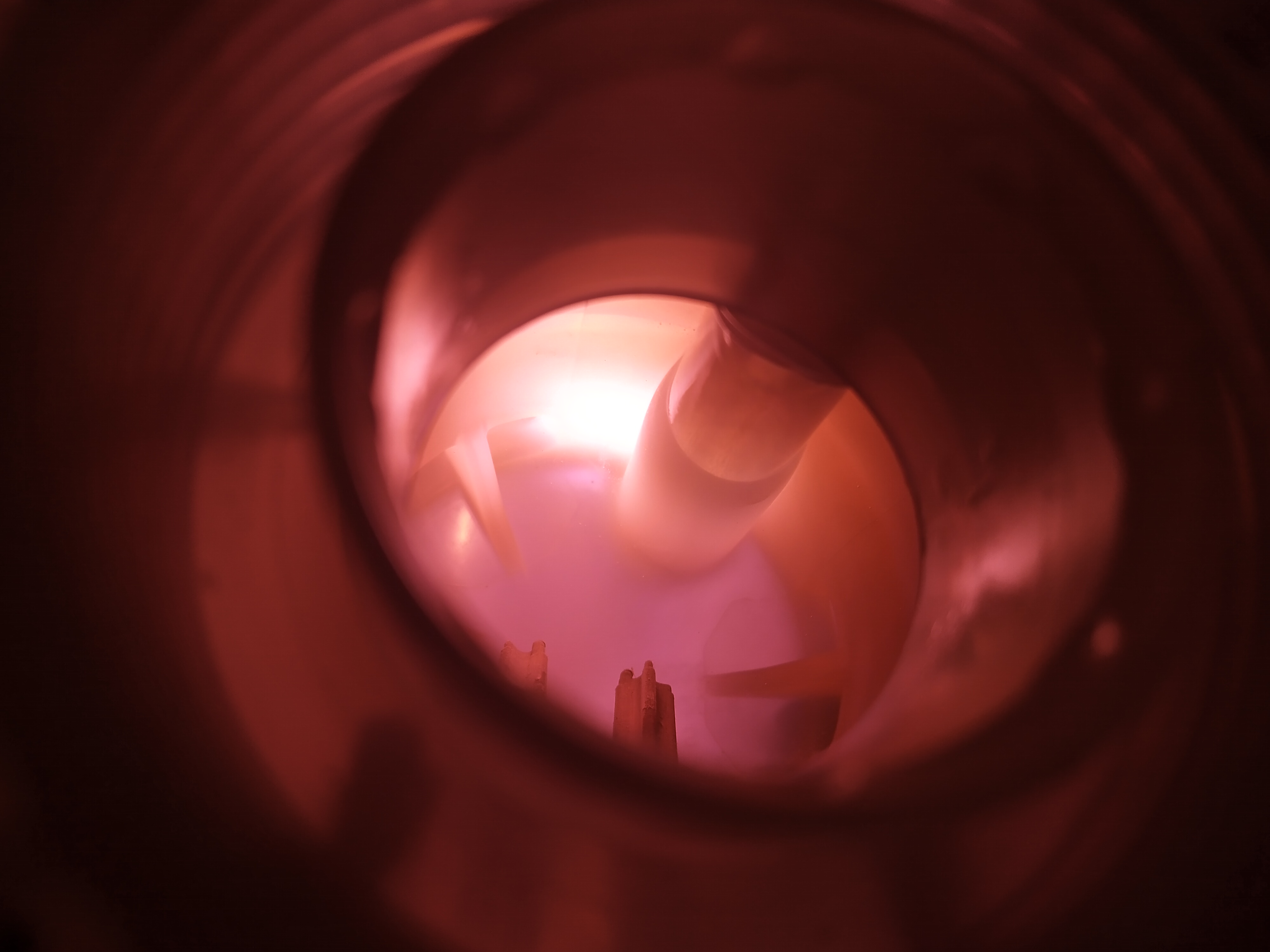

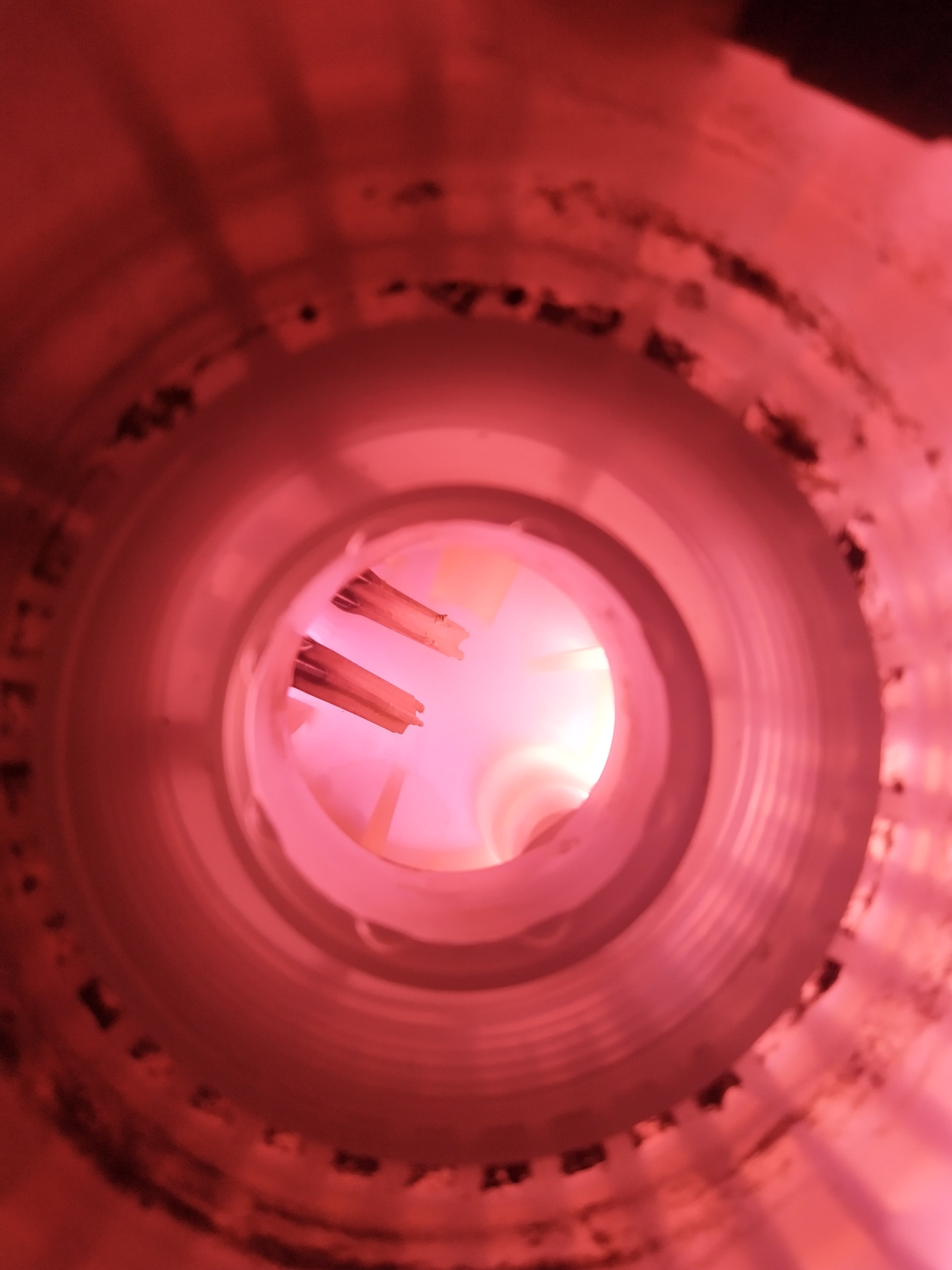

Checked bottle again definitely no bag, although says G13 mit silikat.
Think mine is a revised bottle, small tube running vertical could be the silikat reservoir.IMG_20230412_192124_1.thumb.jpg.b98f1cf3b9f52a02fd3b54cb74bf772a.jpg
Although the car has done 28k miles it is coming up to 5 years old and Skoda dealer recommended cambelt and water pump change. Be interesting to see if they put what kind of coolant they use
Maybe it's this type of expansion tank?
Hells bells, so the bag is not accessible from the filler cap. Will see about getting a replacement I think.

There really are a variety of expansion tanks and silica bags, and it might be that @benterrier's bag isn't the same as the one in the video.
I mean, they all look pretty much the same.

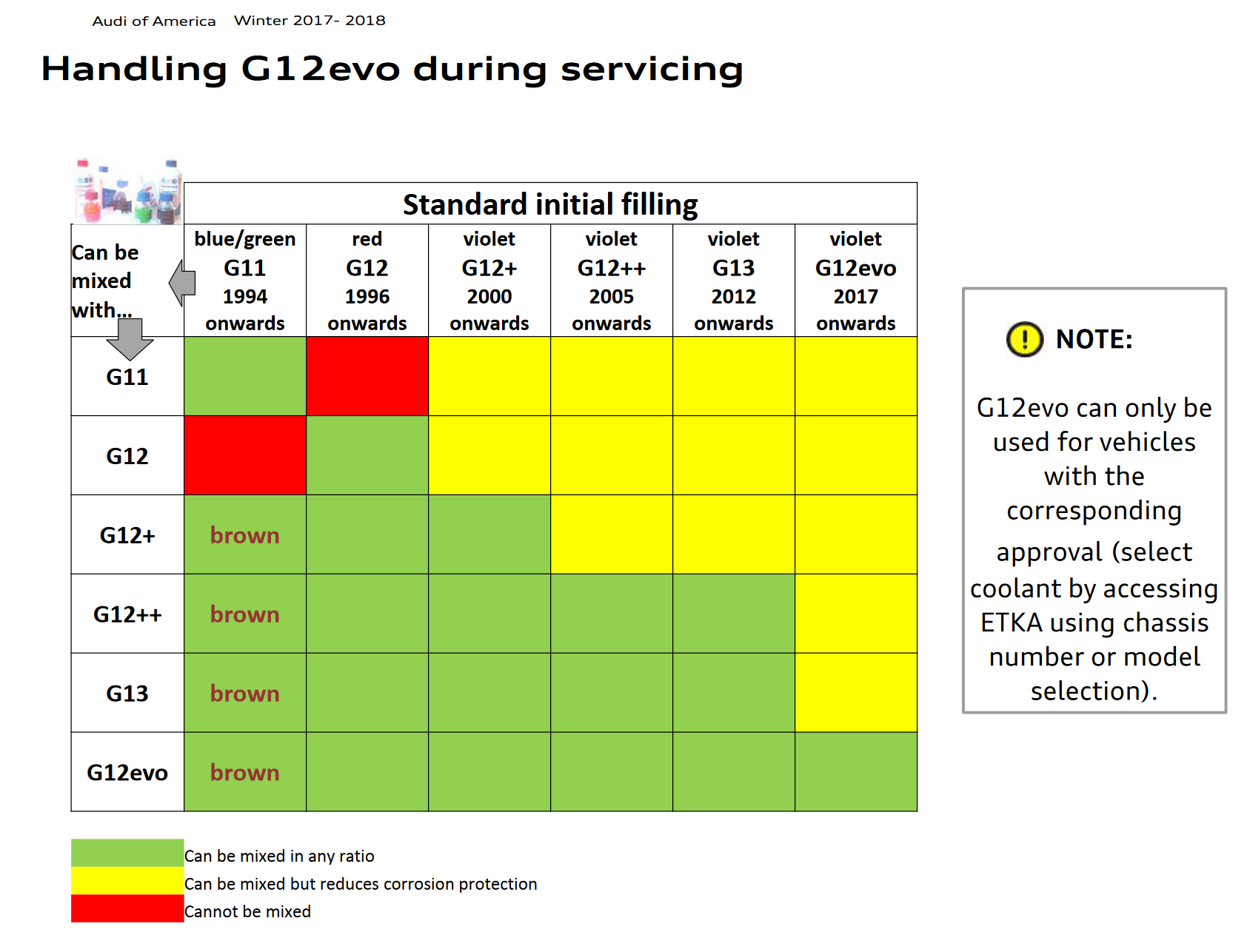

Also, while I'm here I'll post this, because it's such a handy graphic.
@EnterName, where did you get the sticky label denoting that G12evo 50/50 was in that cooling system?
Ah, I think that you just cut a bit of the sticky labelling on the bottles, why didn't I think about doing that! (still I do have 4 bottles still in the garage, so I'll consider doing that)
That's exactly what I did. :)

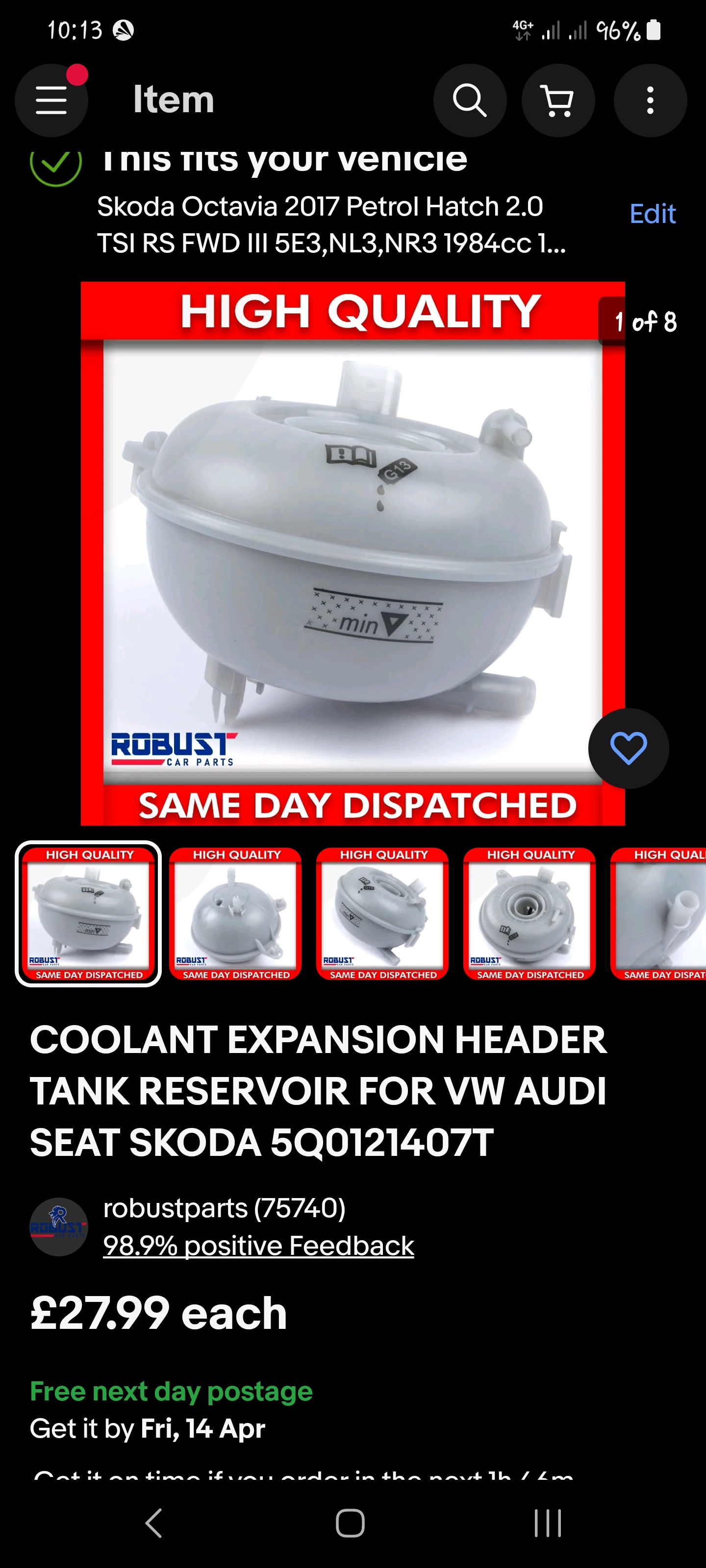

OE only or something like this ok?
I'd love to say "Yeah, that looks fine!" but I really don't know enough about any possible subtle differences between the expansion tanks, particularly as there's some sort of a sensor within the tank.
Someone on here is likely to know for sure, but your preferred Skoda dealer should be able to tell you which part you need for your specific vehicle, if you give them a call.
It might well be they're all the same and it's not an issue. But I can't confirm that is the case, and telling you otherwise would expose you to the risk of a wasted purchase.
