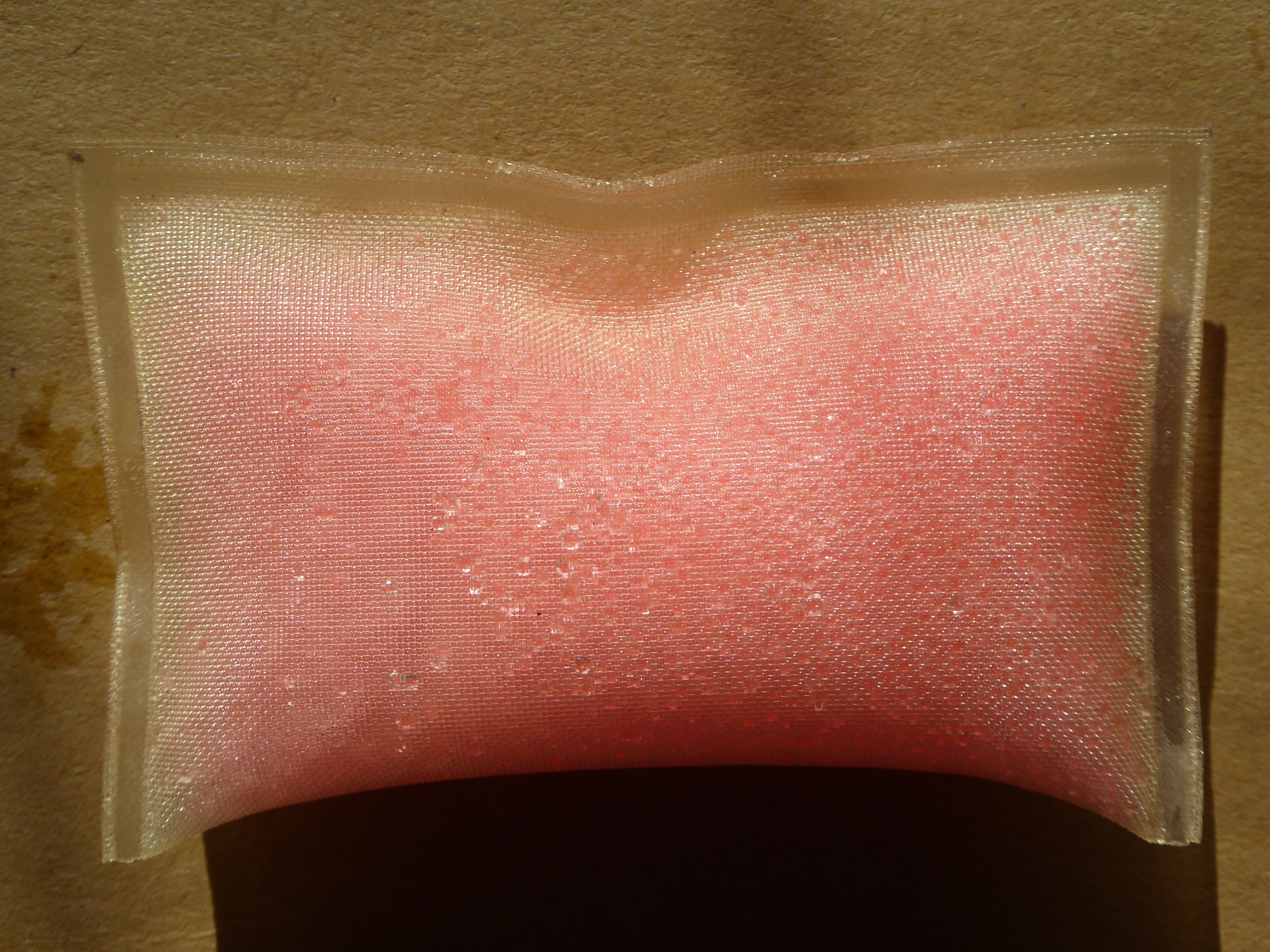

  • Replacement bottle arrived today. 10 minutes to change. Can just make out the shape of the silikat bag and pink colour. It's not loose and doesn't slosh about, if you weren't looking for it you'd neve

I've just pulled my bag out of the expansion tank, took 2 minutes with a pair of long nose tweezers. I was worried I might damage the bag and spill the contents but it seems to be a well made bag with no signs of deterioration.

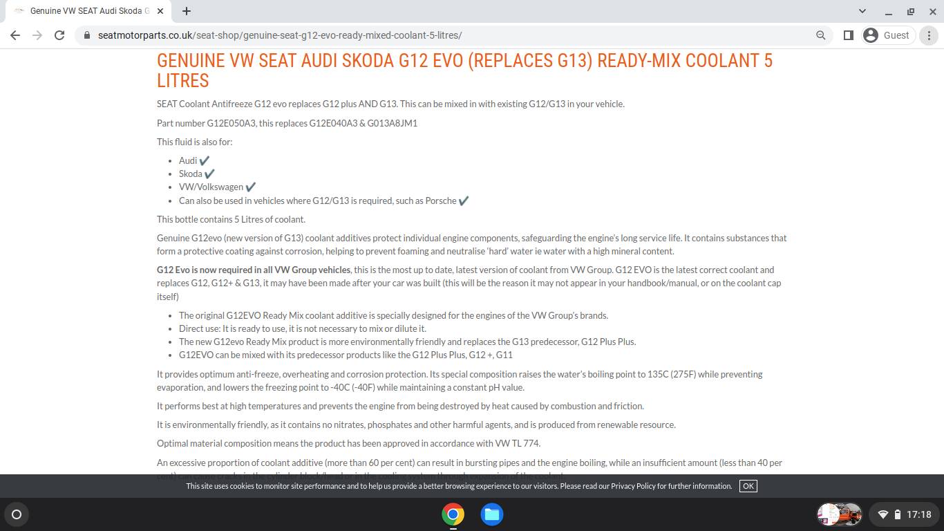

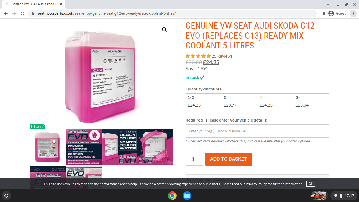

Question about the correct coolant/antifreeze: I know I should use the G12evo, but all the brands I've seen so far don't reference any spec. Is it just a case of finding the right colour, Pink?
Currently have Pink Prestone in the system. Is this OK?
It is a case of getting the correct coolant, not the correct colour.
Whenever I've looked at the coolant bottles, I can't see any spec listed.
That's what I've just bought.

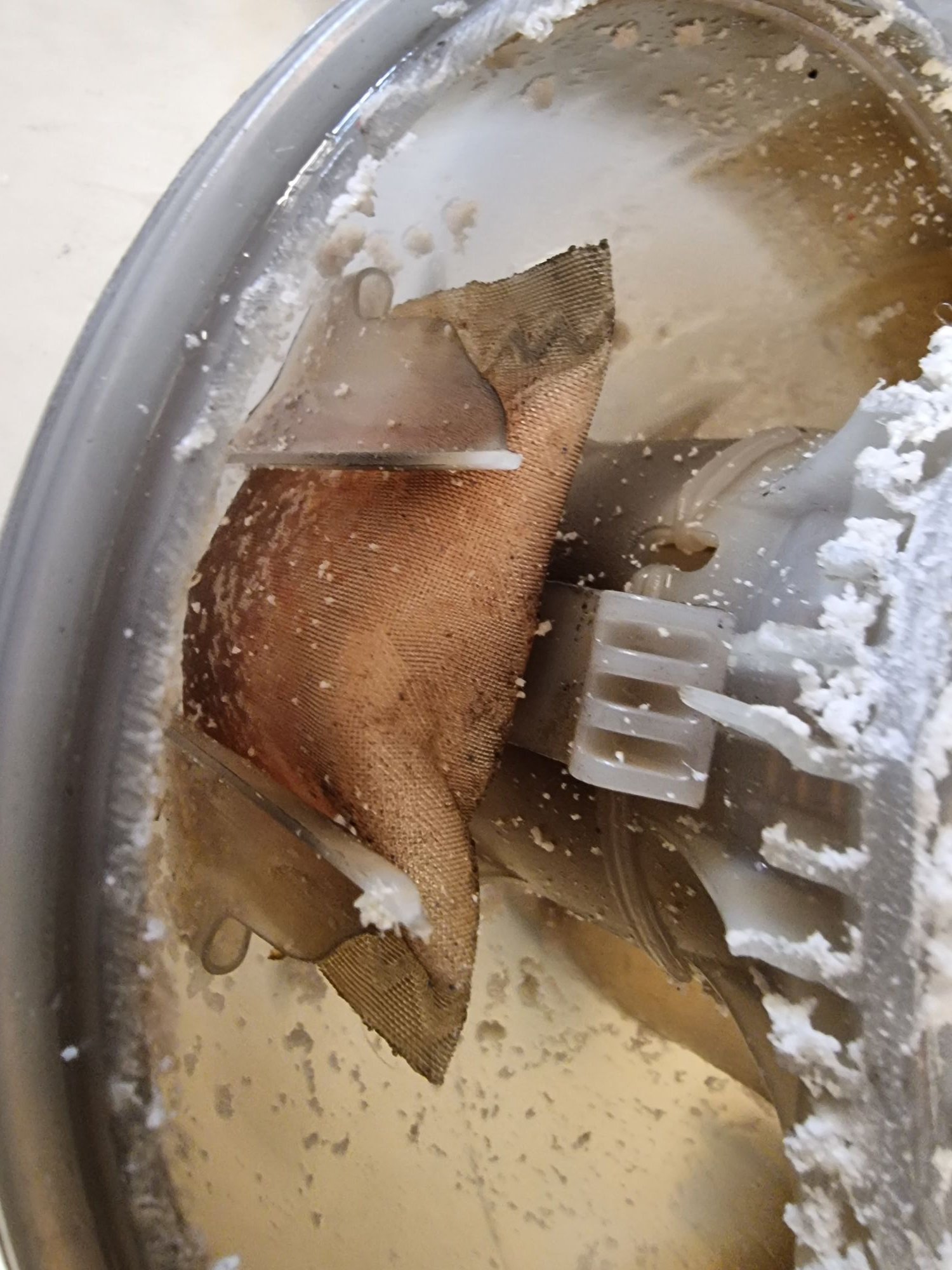

Had another look in the tank, with a bright torch, can't see a bag still.
Ha, was reasonably sure I didn't have a bag.......
No signs of damage on the bag, but absolutely no way I could ever get it out, not sure how people do that can?
It was in the outer chamber with no hole big enough for it to fit through.
Exactly the same as mine. Skoda know about this problem and from the bag initially being dropped in the bottle this was there next attempt. One good thing the bags I've seen do look relatively strong

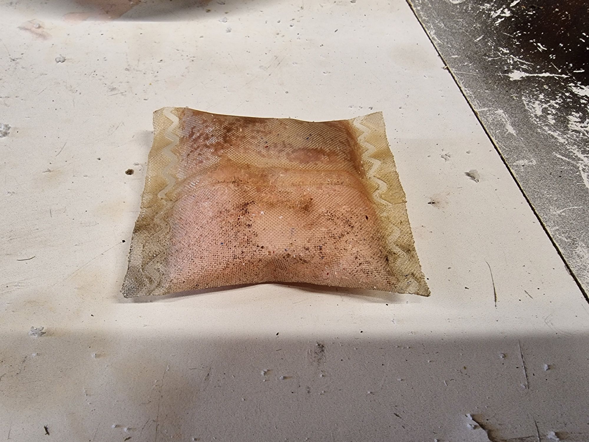

Yeah, it seems quite a tough bag, I even stabbed it a bit with a screwdriver ripping the top of the bottle off.
Still, much happier now its out.
Looks the same as mine. The bag looks and feels robust enough that I might even consider putting it back.

Mine was in pristine condition when I removed it and it still is, but now it's safely in a plastic bag in the boot, where it can't do any harm.
