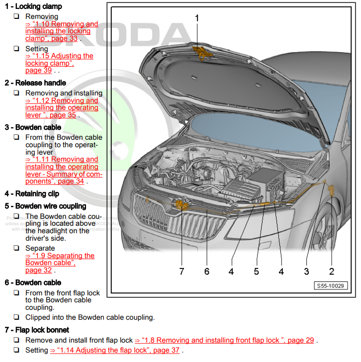

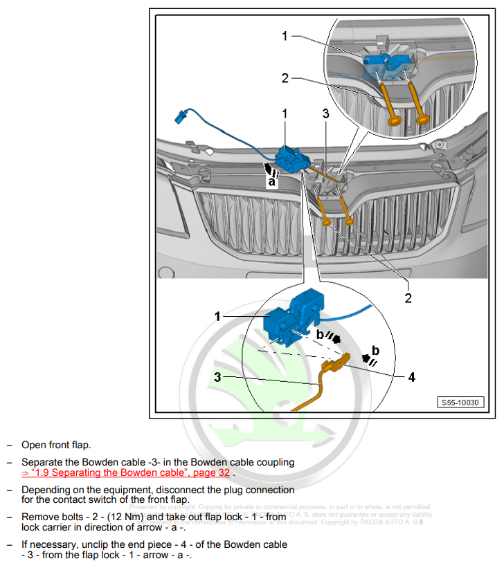

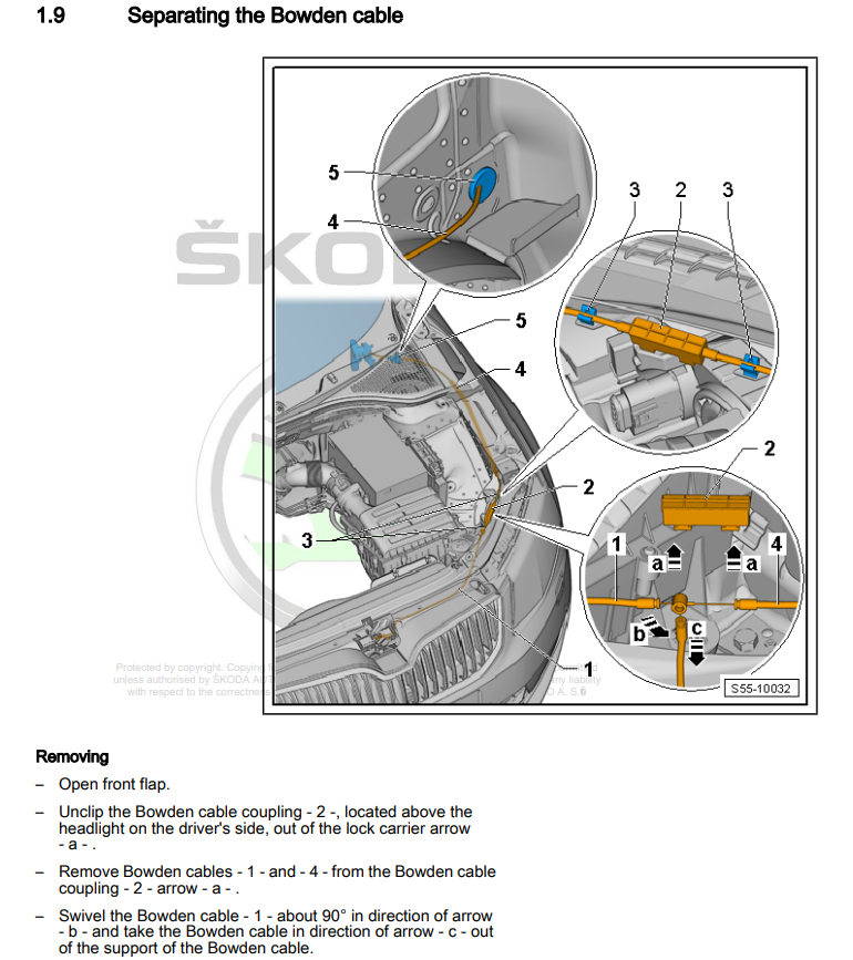

Bowden cable routing:
Lock removal:
Full system:
Lock removal:
Full system:

Removed lhs front wheel and internal lining.
There is a bonnet cable here, inside up above headlight that can be reached, however the join of two cables is different to everything I could find on the net.
Had a look at wife’s 2015 Tiguan.. Lo and behold it has same bonnet release..
Pull case apart easily, with small screwdriver (small lid comes off), and grab join of cables and pull.. bingo bonnet open.
No need to pull join apart.
