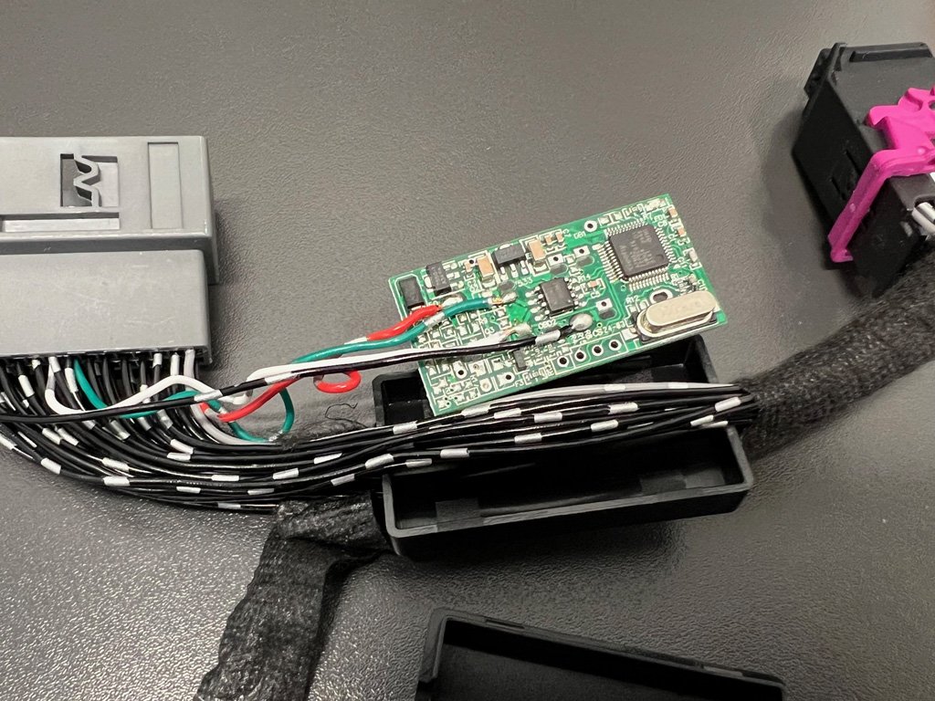

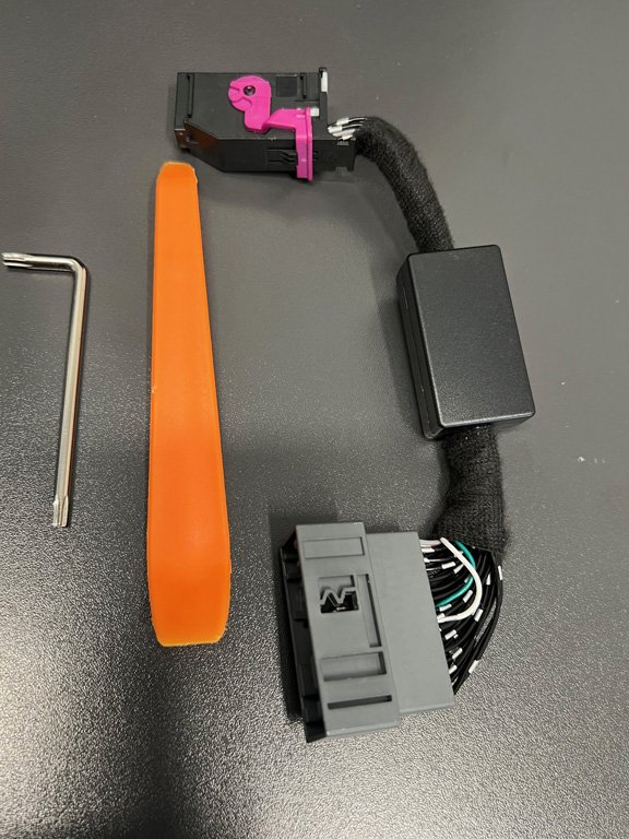

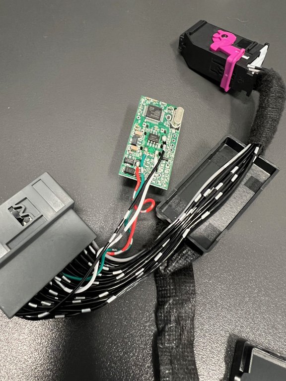

Hi,
Thinking of ordering one just to open black case on cable to see what did they implemented inside and to what pins on both ends of cable.

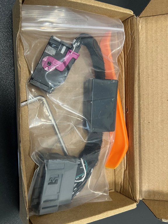

You connect the cable between original cable and the socket as in the picture above. You remove cable with pink connector release, plug in cable there and plug original cable into new cable.

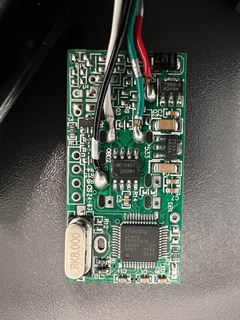

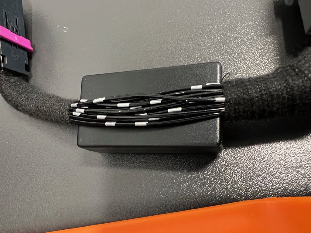

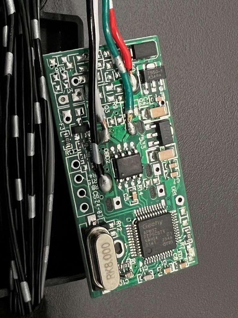

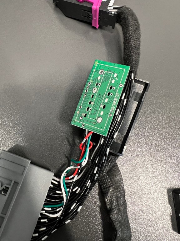

Some reverse engineering view inside, there is four wires connected to signals on pins 1,8,9,16, in main gray connector. This four wires are going to pcb with arm32 mcu and one gatemode CAN controller. I guess that mcu is loaded with program that continuously cycling off state SS, or it saves last state of SS.
Rest of the signals from black to gray connector are strait thru.

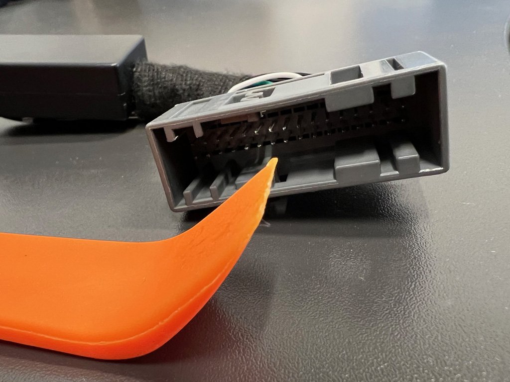

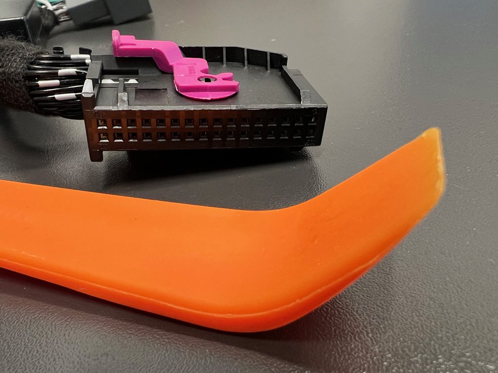

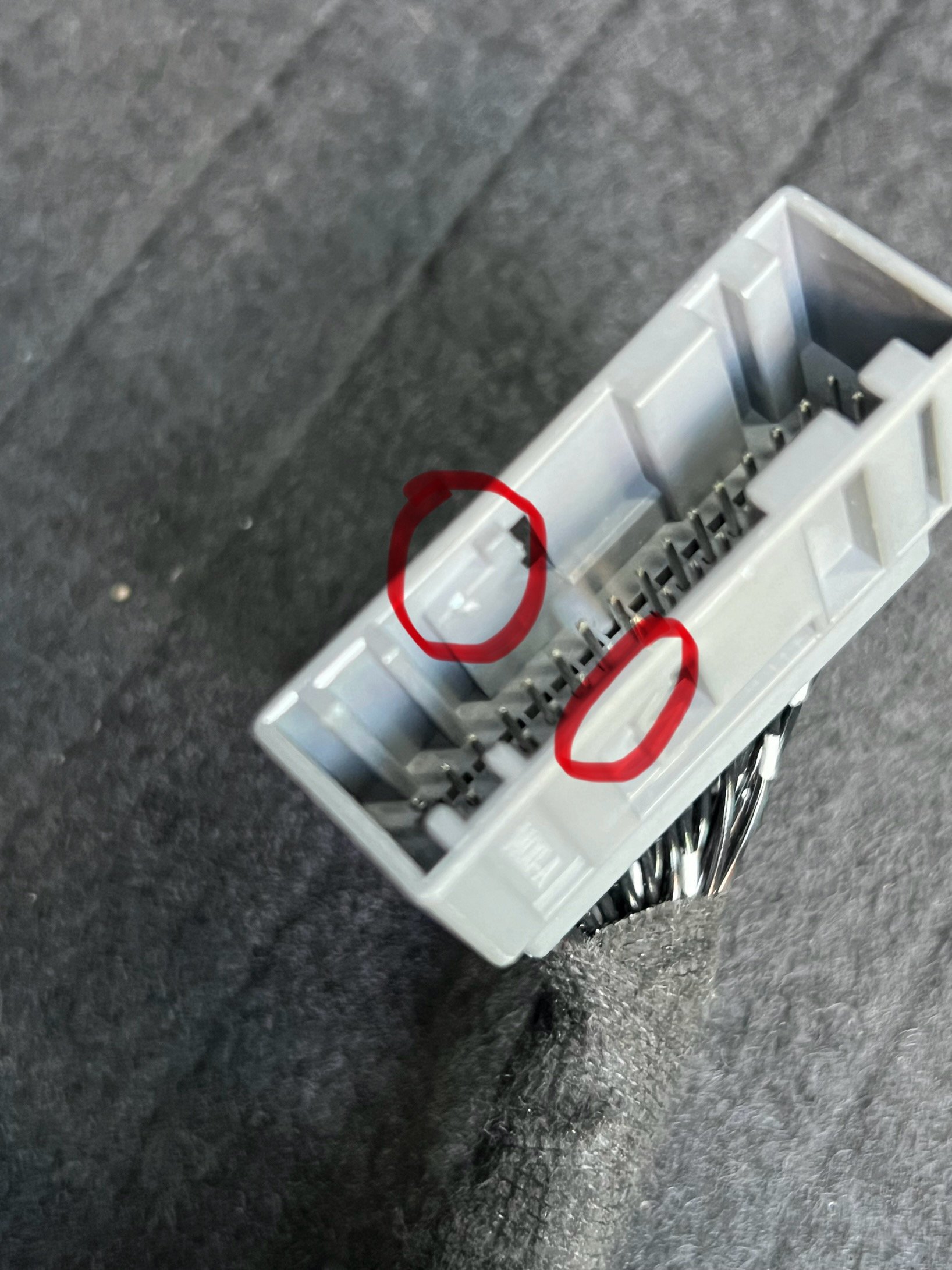

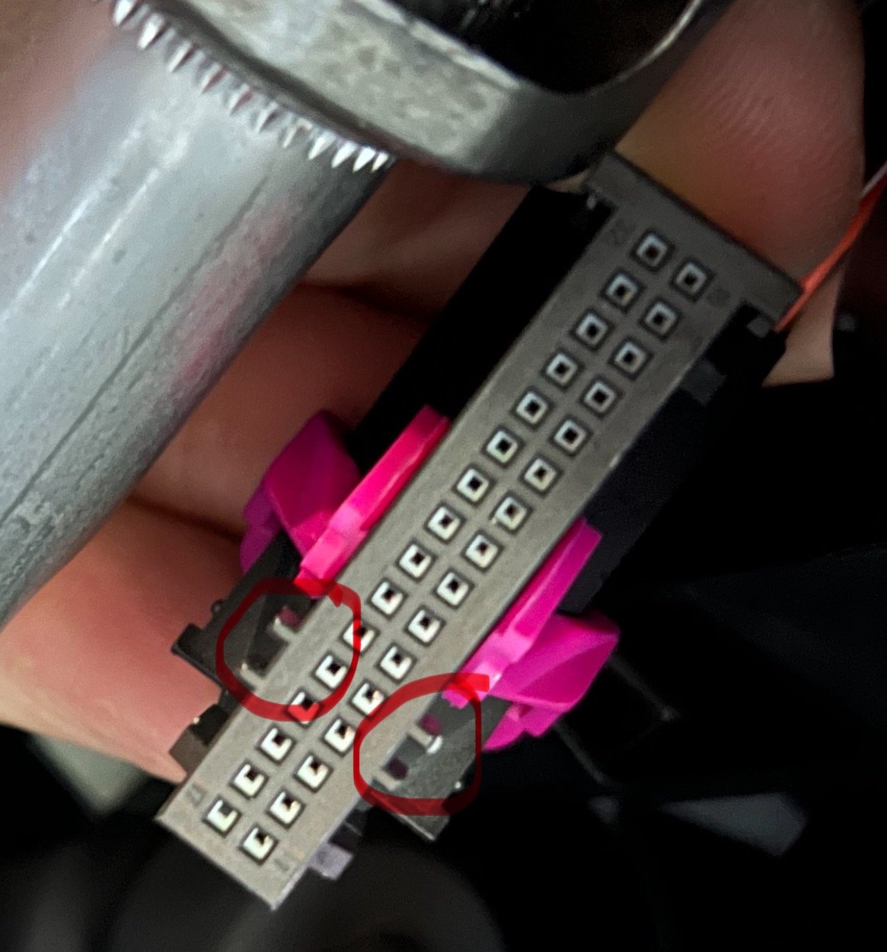

Okay the cable gray side does not fit connector in the car, so i can not plug this cable. There is little difference in connectors, one from car side has two little teeths slots (first picture)
while gray connector on cable side has closed position on that place where two slots
would slide in, and i cant plug it.
(second picture)
