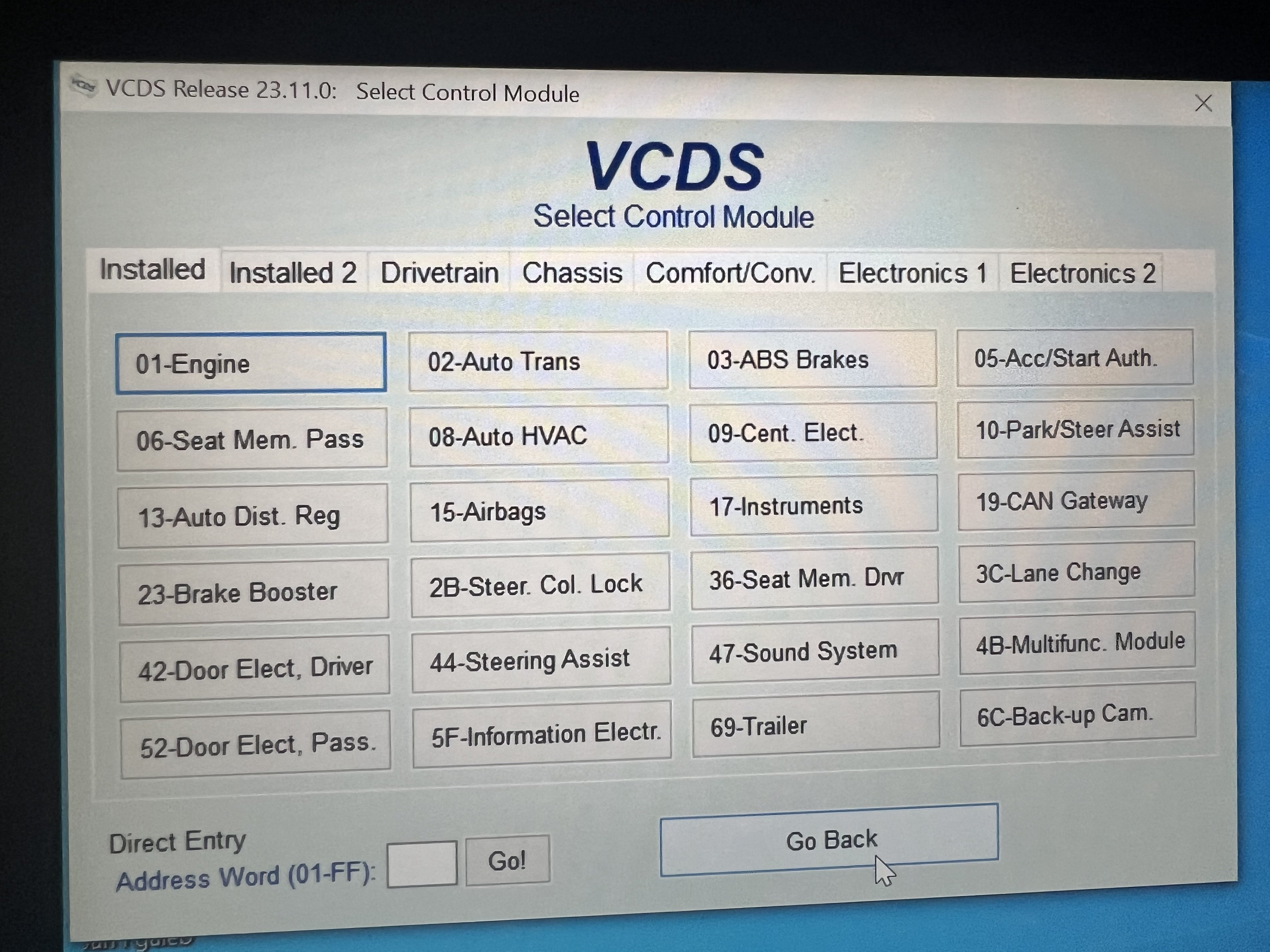

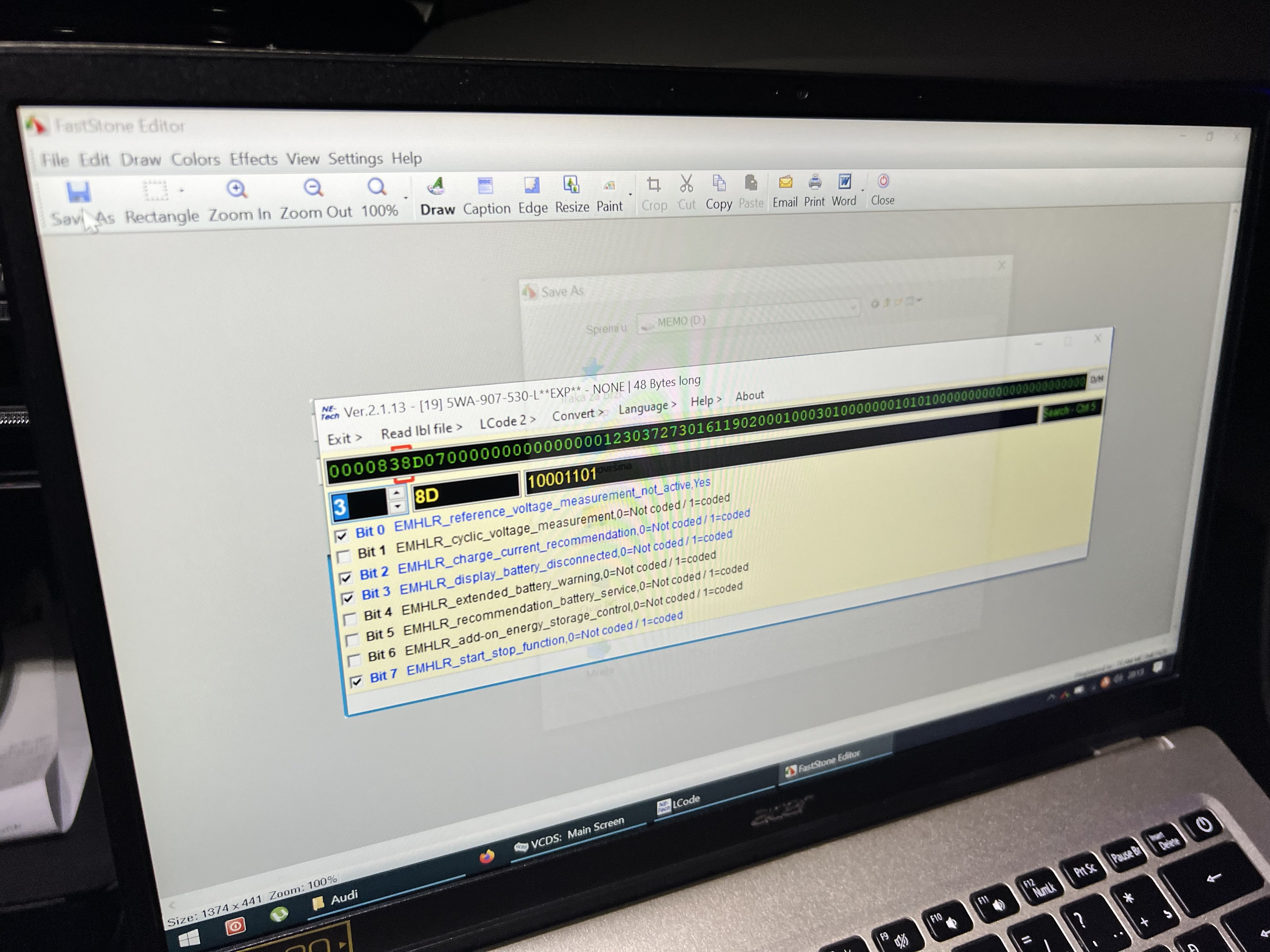

I managed to disable the start/stop function on a Skoda Octavia MK4. The start/stop function can be permanently disabled or re-enabled via the central unit (radio).
I did not need to unlock the SFD for the procedure.
I am not sure which bit I enabled, but you can check and answer on this forum.
01 - Engine
19 - CAN Gateway

what did you use ? VCDS ?
@zorglub
Yes this is done by vcds, but its poor explained and I ask myself why.
Whole world uses hardware to disable it, or sw possibility is only to rewrite ecu to disable SS.
Not obd11 or vcds….or someone prove me wrong on MQB 2024.
I have found modules but didnt disable it..just due not to trigger CP or some unknown state of car.
BR
Djadjo
