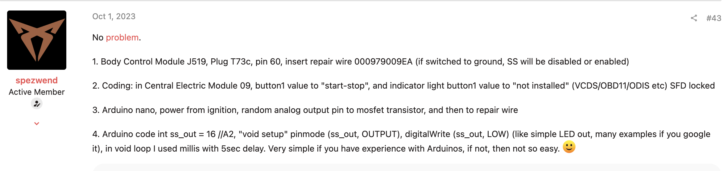

Hello. After installing the heated steering https://www.briskoda.net/forums/topic/518453-retrofit-of-the-steering-wheel/#comment-5815149, I decided to work on disabling the start/stop system. What I found:
1) China adapter which is not clear how to connect https://pl.aliexpress.com/item/1005005381695131.html?gatewayAdapt=glo2pol
2) China adapter which is easy to connect https://pl.aliexpress.com/item/1005006284446645.html?gatewayAdapt=glo2pol
3) Coding + Arduino
What do you think?
