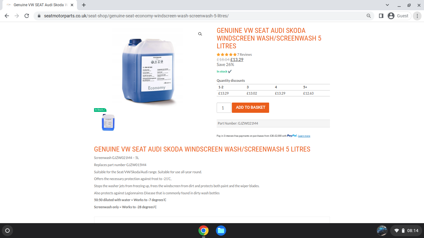

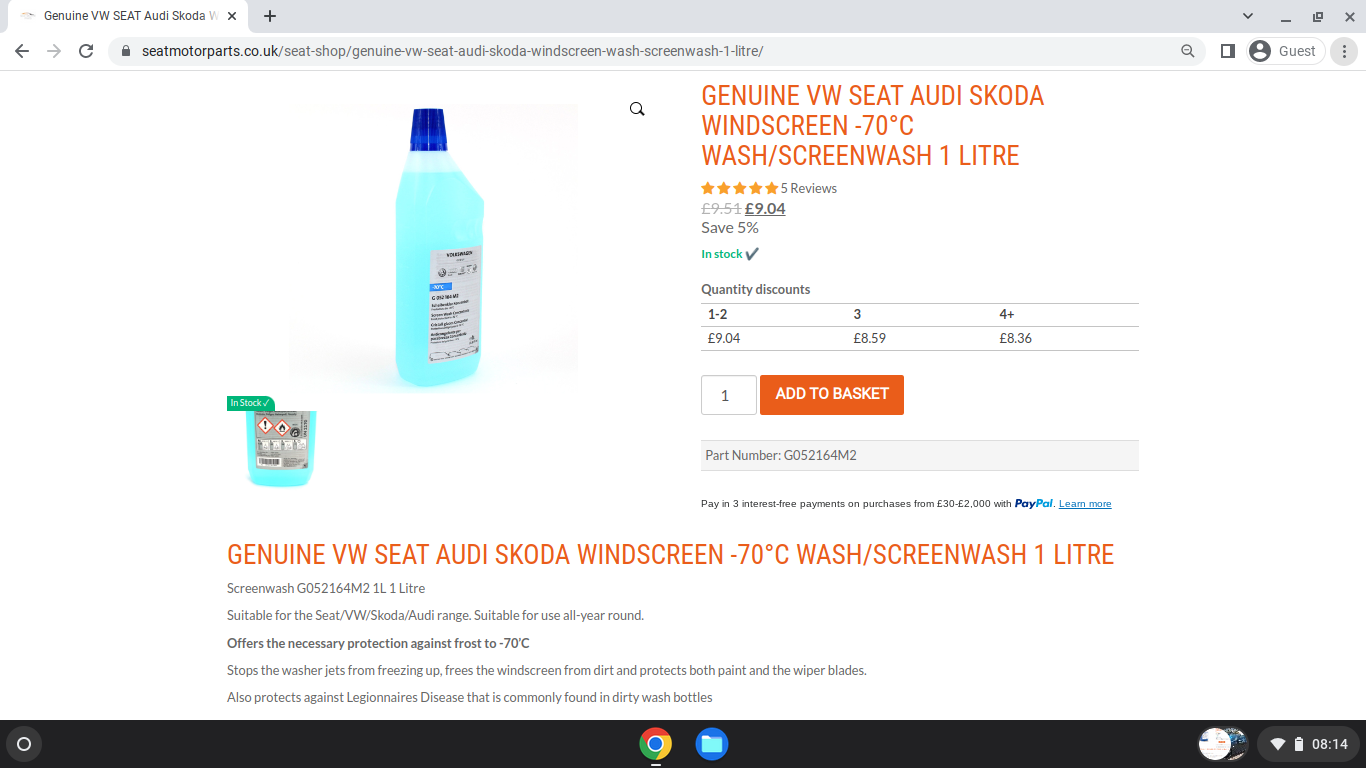

What is the ingredient that the supplier / producer of the Windscreen wash they put in containers with the VW Group brand that means the car knows that the liquid is running low other than the tears of angels?

my educated guess would be it’s to do with the dilution of the liquid rather than any ingredient.
Some screen-wash can use deionised water which isn’t conductive
Exactly this.
