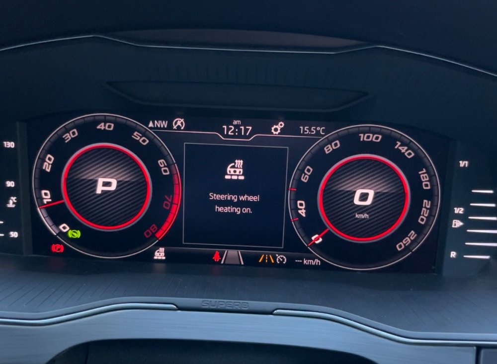

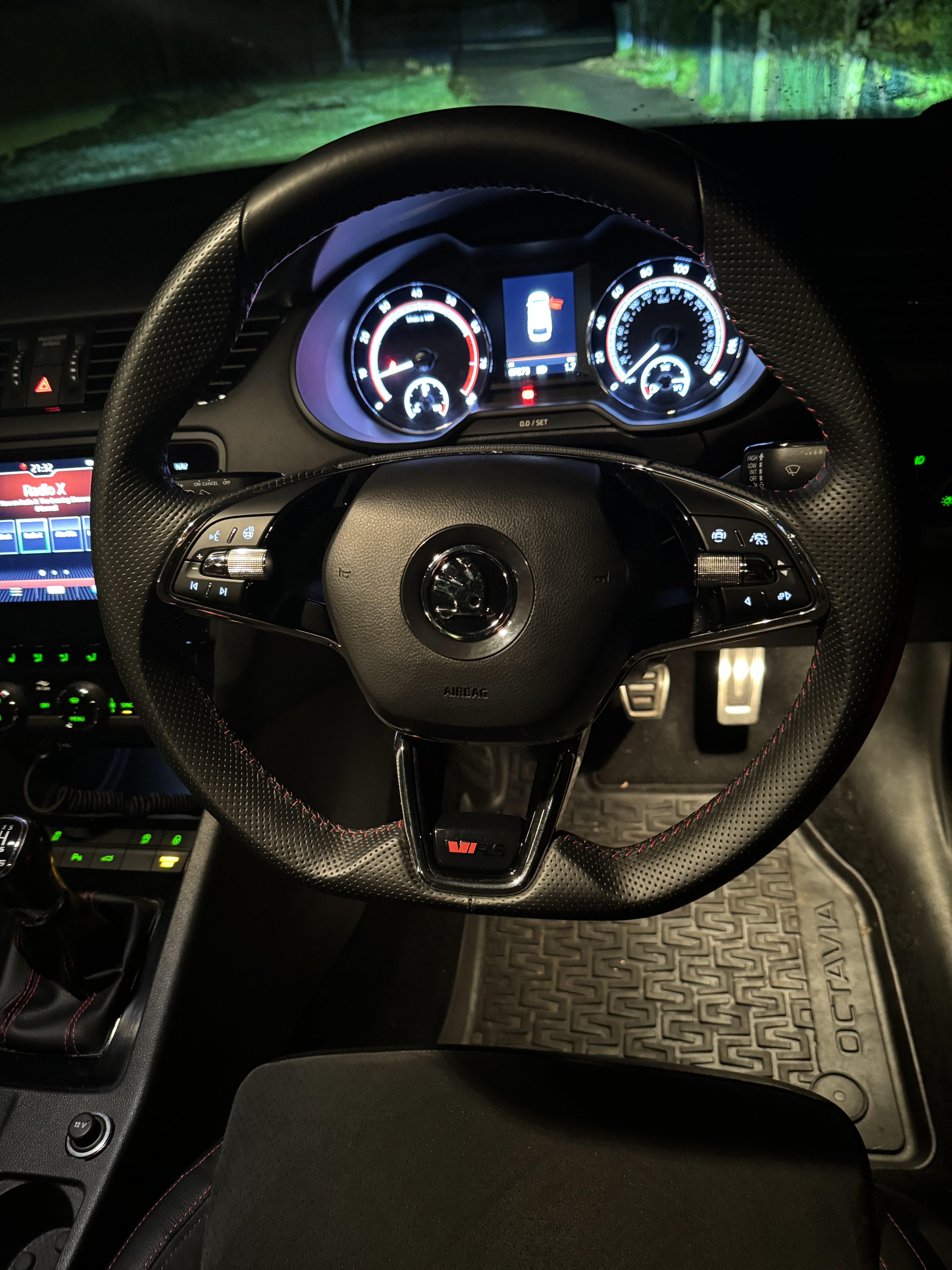

I’ve now fitted a mk4 vRS wheel to mine. There is no extra coding required but you will need a LIN convertor to make the buttons work properly - about £200.
Personally I think it’s a really nice wheel and a nice change from the mk3 wheel BUT it isn’t much cheaper once you factor in the airbag and LIN convertor.

Here it is fitted:

Yes, forgot that. The heating button on the wheel does not work but I just link mine to the seat heating and also have it switching on automatically  when the outside temp is 4 degrees or below.
