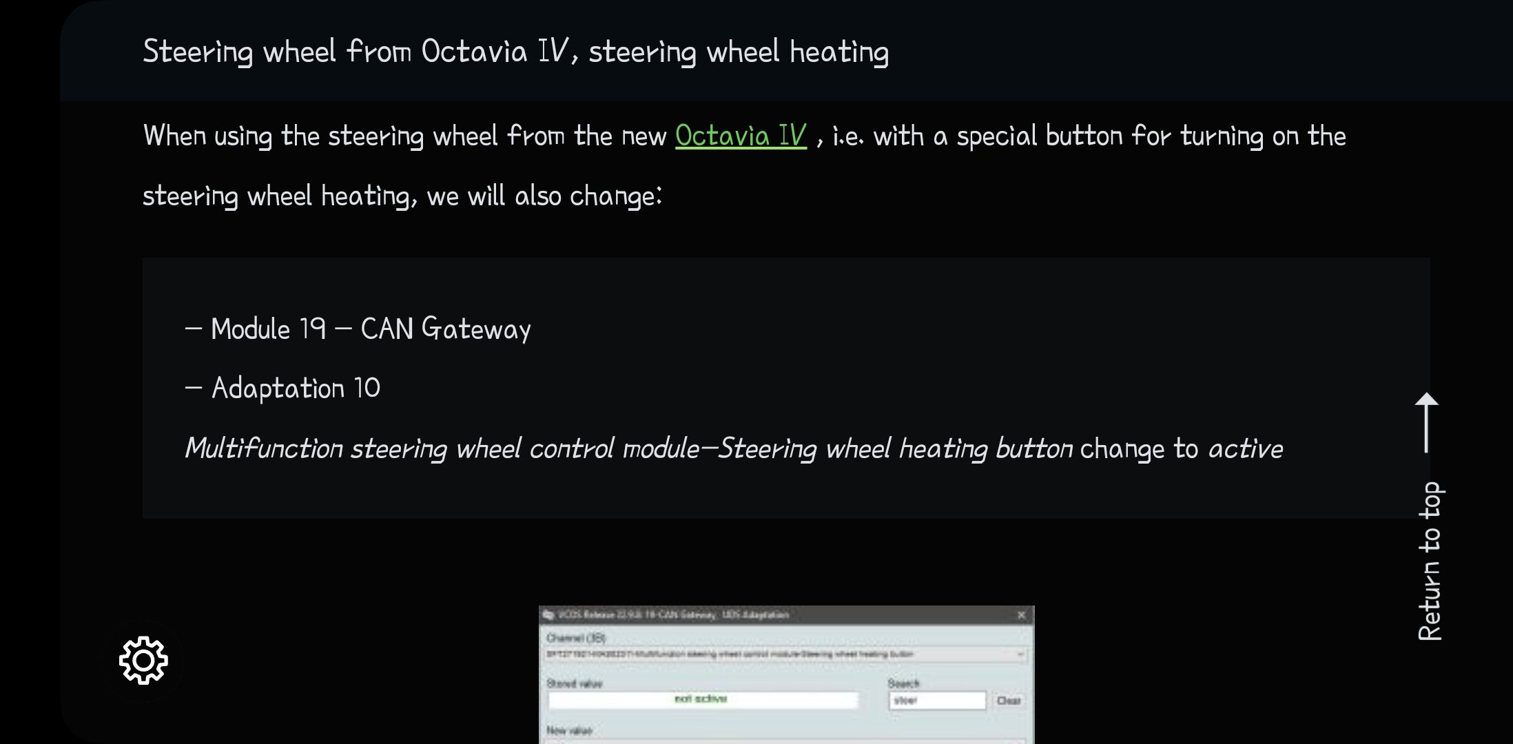

Have you enabled the button in the coding
Screenshot_20240319_170903_SamsungInternet.thumb.jpg.8fb9c679afecf342bebfecdc1b87c17b.jpg

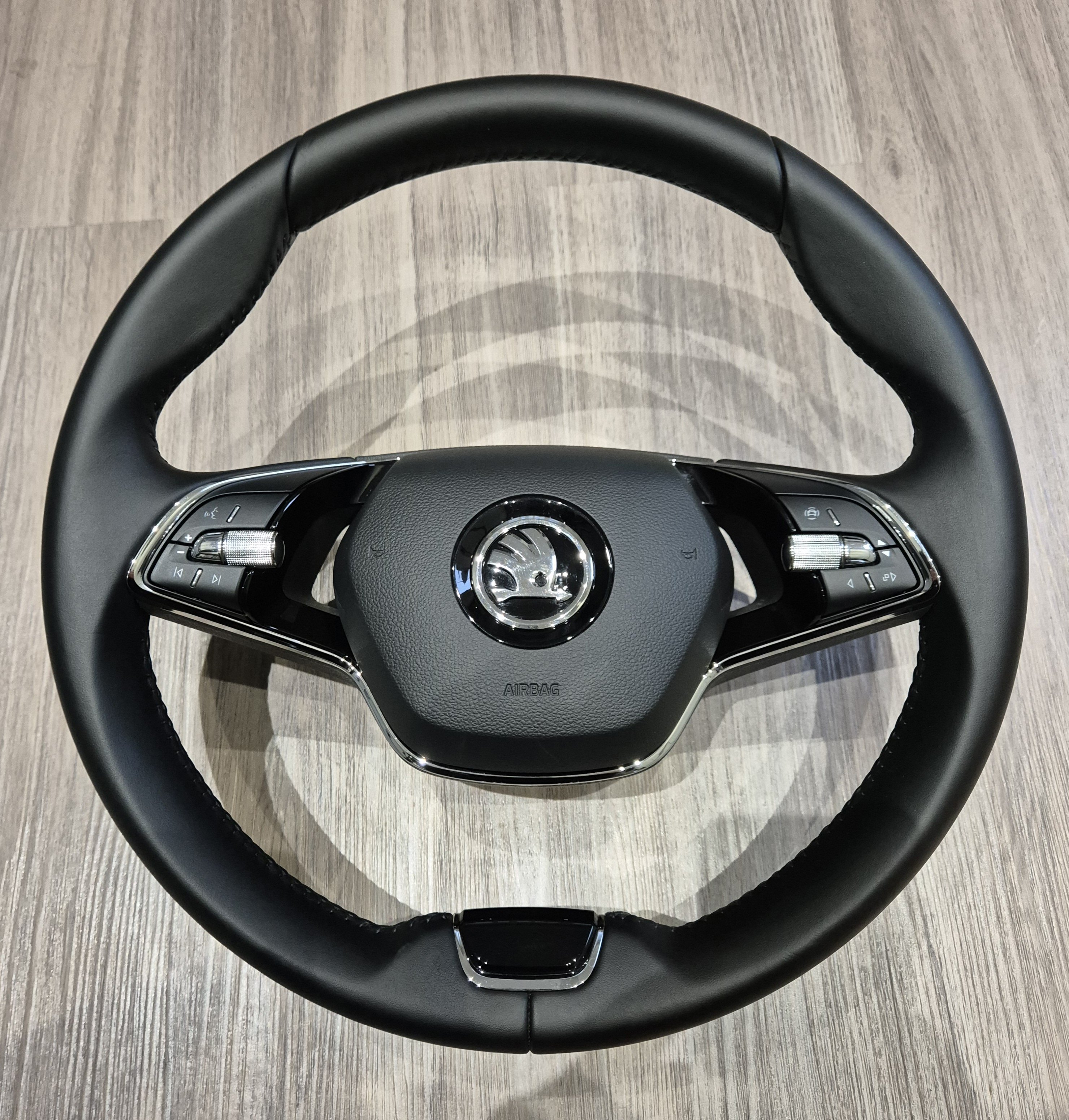

Anyone got any tips on sourcing a Mk4 flat bottom heated wheel? All between 200-400 without airbag

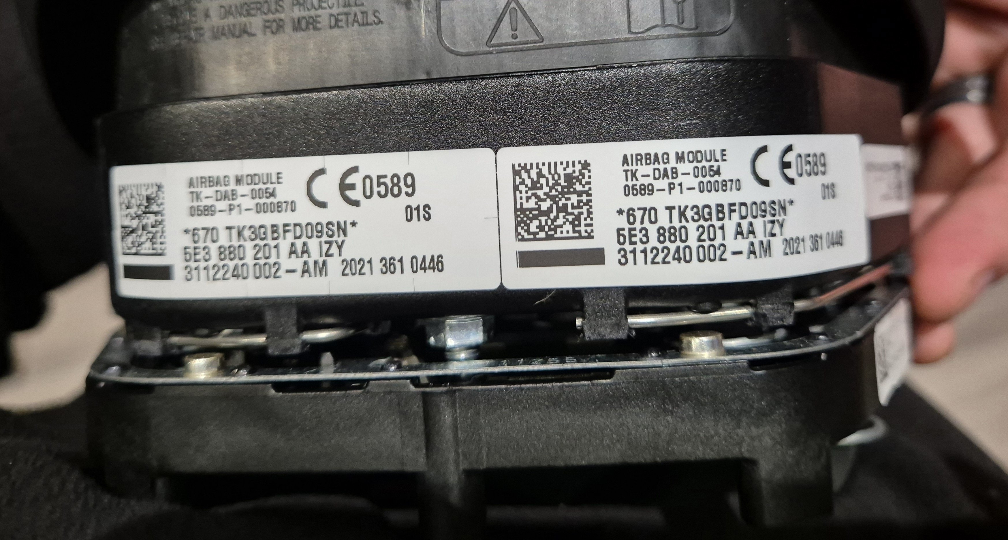

What is the difference between airbags. There seems to be so many different characters at the end.  I.e 5e3 880 201 S
I have acquired 5e3 880 201 AA.
I have no idea what the difference is and just need to know it will fit the Vrs flat bottom wheel when i finally get hold of one.20240326_181940.thumb.jpg.08abb332310f39dc9223a5a65628a454.jpg
Was removed from this wheel
Edited by STU3Y
I’ve no idea what all the differences are, but it looks externally the same as the one that I’ve got. Should be fine 👍🏻

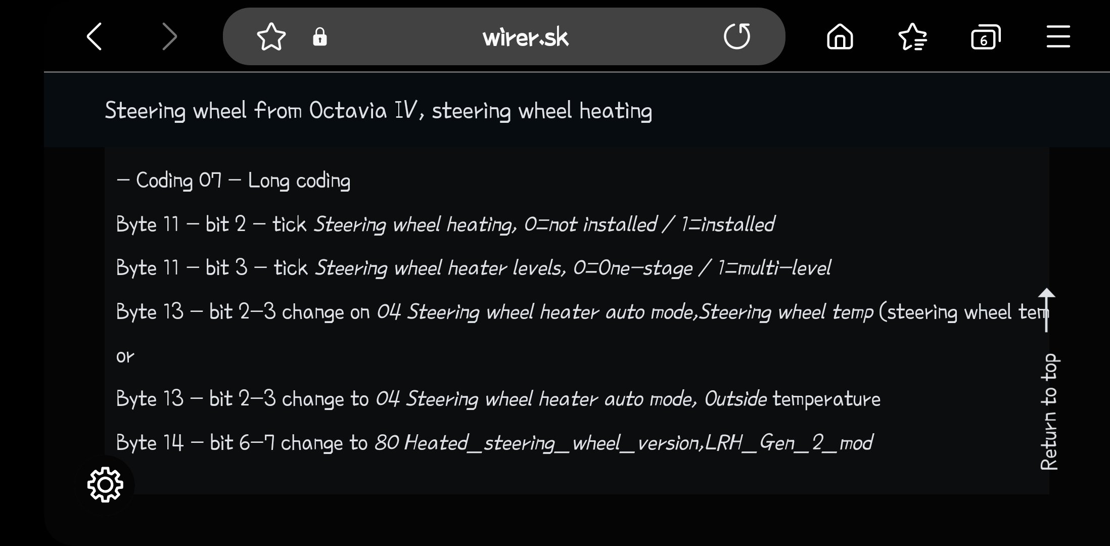

@Purpletom Did you try the coding I added for the heated wheel button.
Screenshot_20240319_170903_SamsungInternet.thumb.jpg.51830d3ca8eb0b7b54d5daf6482ebbc8.jpg
Screenshot_20240319_170746_SamsungInternet.thumb.jpg.af34dc73f661d8507ff3bd6eff056cf9.jpg
This has to be dine prior to installing the adapter.
I have been talking to a Russian guy that makes these and he says it doesn't matter which version of the adapter you have i.e basic or full, as the button is operated by the coding only.
To get it to work for you now, you need to remove the lin adapter, plug everything in without it. Then do the coding, once coded plug the lin adapter back in again and it should all work.

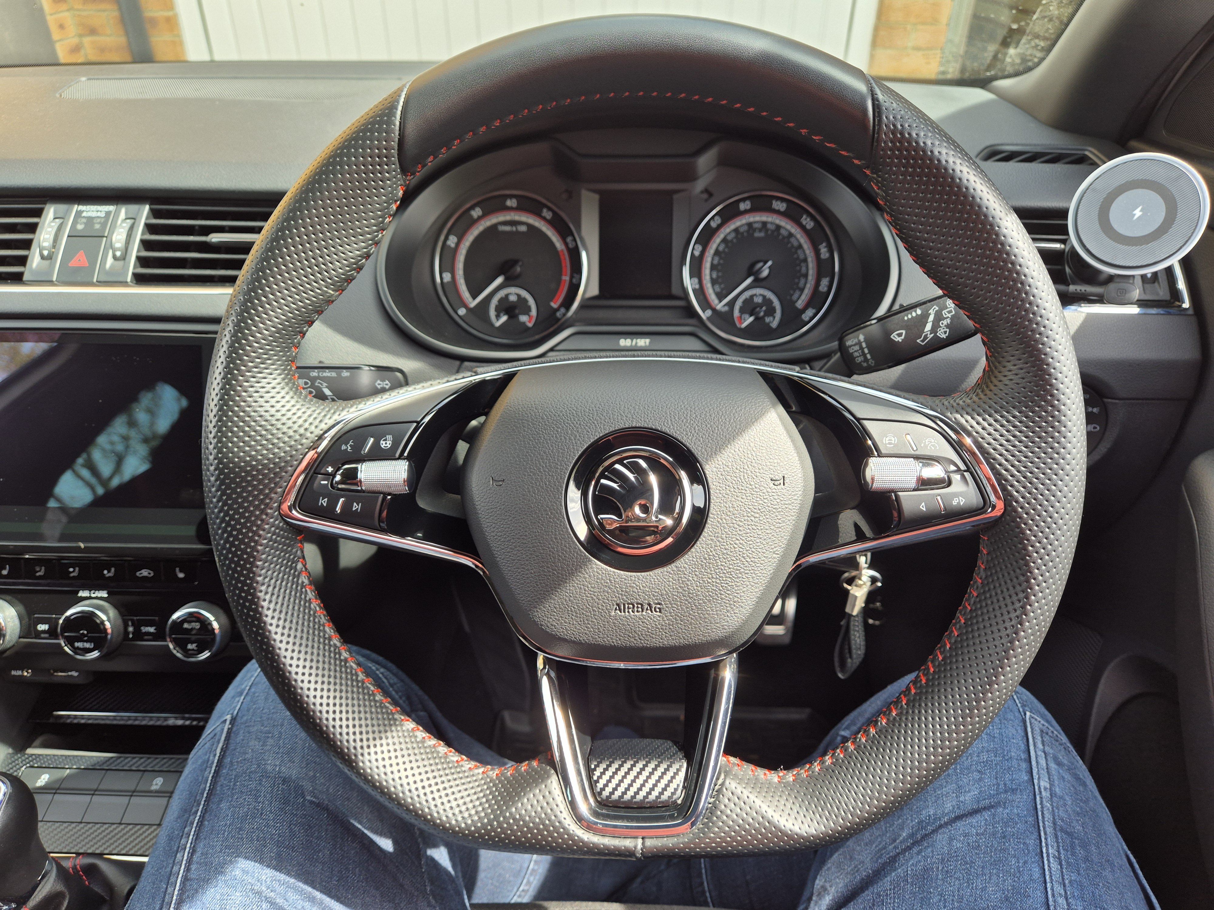

I have finally completed this modification and all buttons work perfectly, including the button to turn on the heat on the wheel itself. This was just a matter of coding as I posted above.

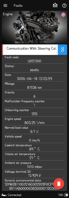

I have a fault code though Screenshot_20240418_132440_OBDeleven.thumb.jpg.86ccd62834e0f323e5ebd0a9d2c4483e.jpg
I have spkken to the Russian guy who supplied the lin adapter, and he states that it is just caused by the lin bridge but doesn't affect the operation or safety of the vehicle.
Do any of you guys have this fault code.
Edited by STU3Y
Realised then cruise control wasn't working. Spent ages trying to sort it as i thought I had a dodgy clock spring.
Put the old wheel on and off several times. Then realised the clock spring itself needed to be coded under steering column.
After this everything worked. And randomly the fault code above has disappeared for now
