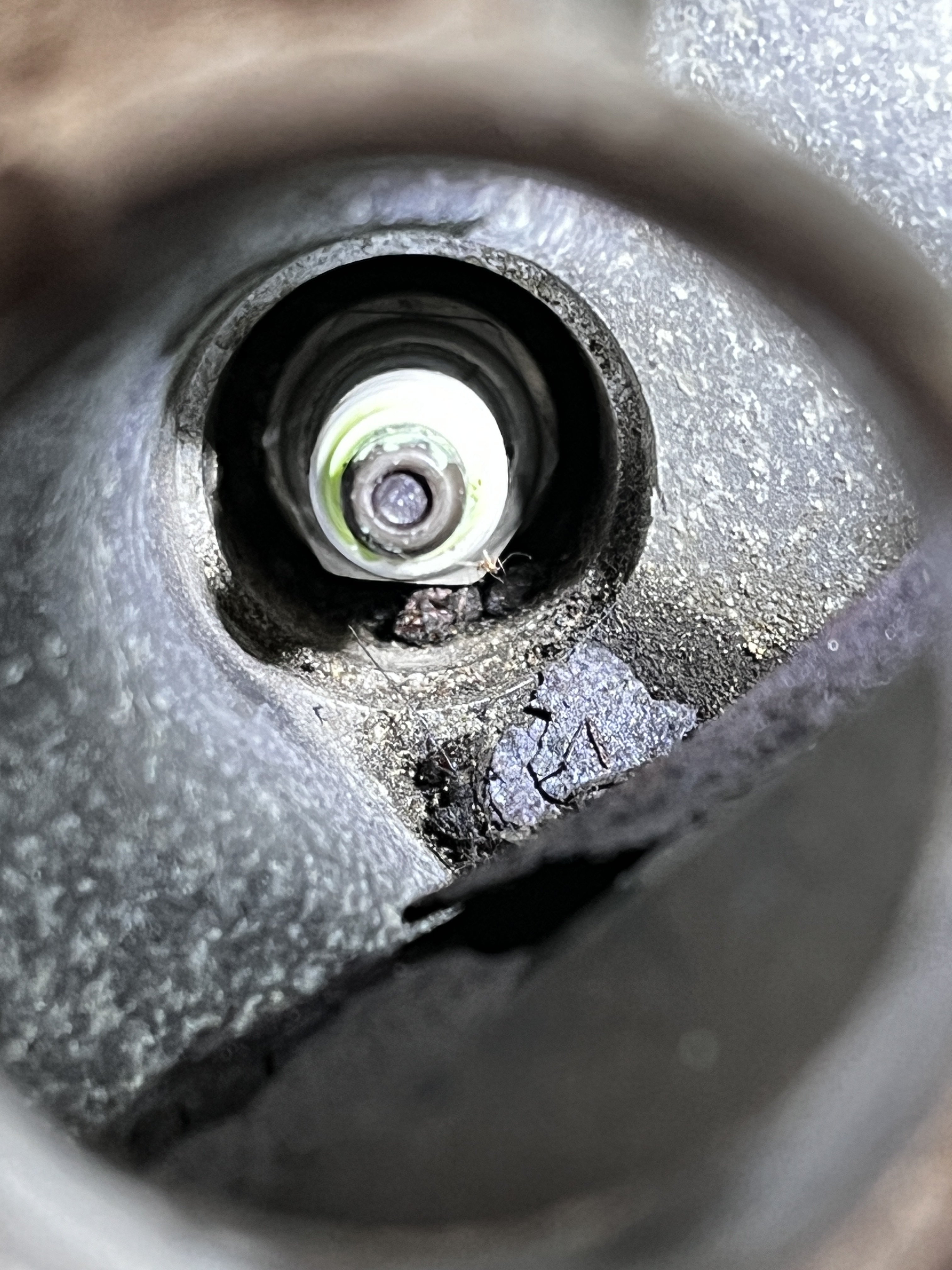

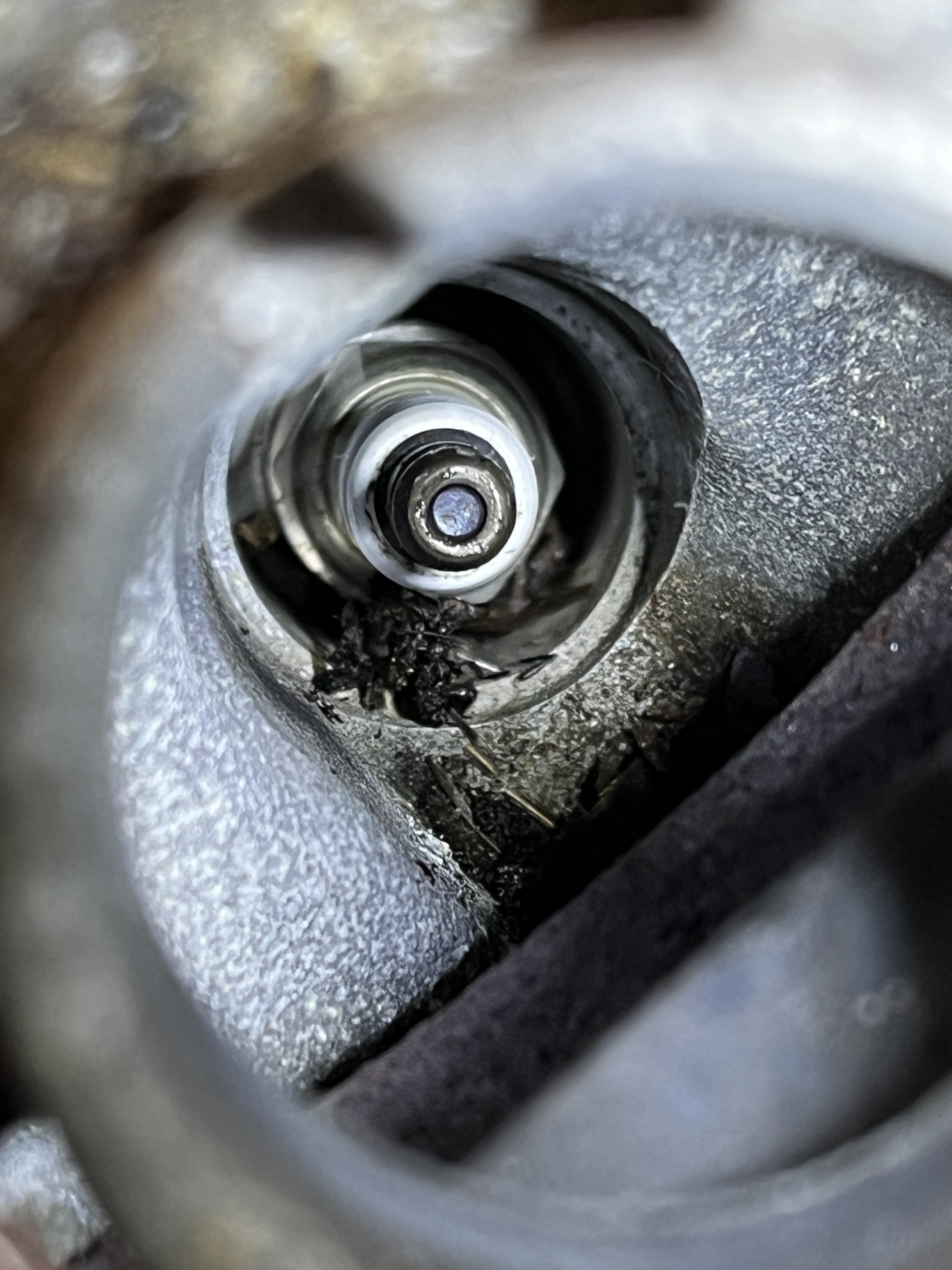

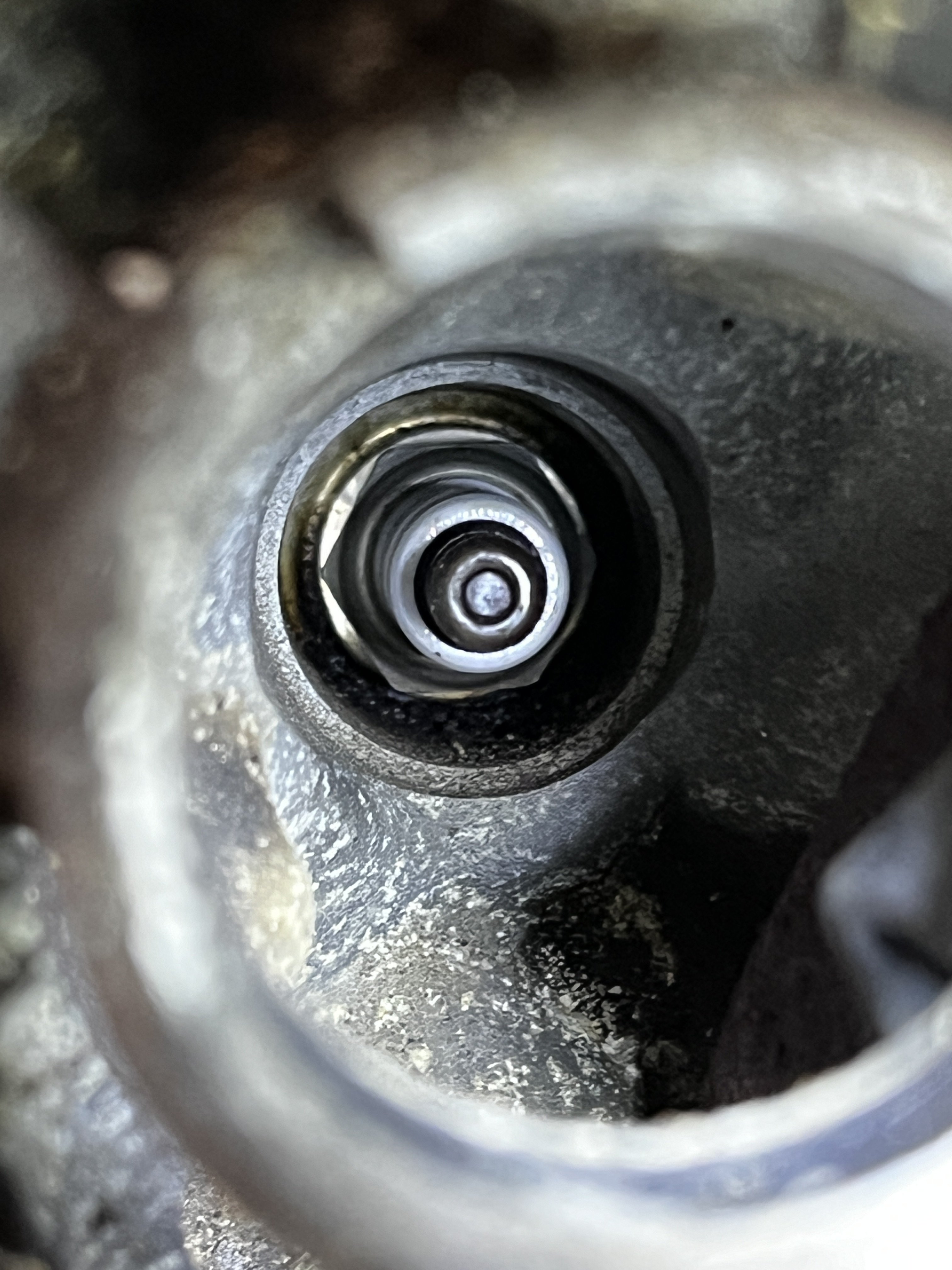

I intended to remove and examine the spark plugs today since I have new ones on the way (Bosch Super Plus FR7HC+ Spark Plugs). However, once I pulled the injectors out (which were a bit old I should probably get another 2 new ones) the spark plugs had loads of dust, little bits and even a small fly in the housing, I can imagine that once I pull out the plug there’s a small chance some of that will get in, or is it safe to pull out the spark plug and it would drag everything out with it.
Ultimately, it’s better safe than sorry and if anyone has any advice on cleaning up the spark plug passages let me know! I should probably get new coils too right?
Photos attached.

Spend a fiver on an air duster aerosol with a thin straw that you can direct down there to blow out the crap.
It's not really very important since 50,000 volts has no problems jumping through fresh air, a few bits of dirt aren't going to affect it either. Just blow the holes out if you're worried about it.

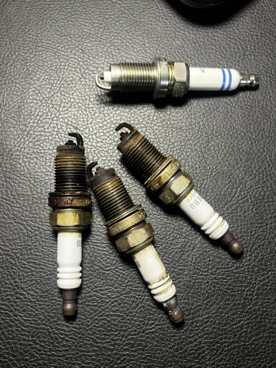

Old plugs + New one for reference (spare).
Photo Attached.
The quality isn’t as good as when i took it on my phone because the max file size to upload is 5mb.

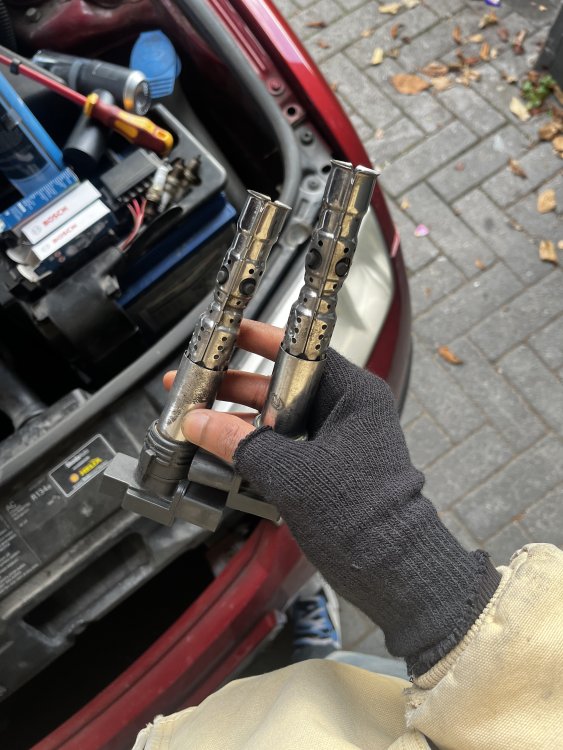

Here are my other two ignition coils.

Can't see any sign of a VW group part number on the old plugs, so won't be factory original. Also they don't look too bad other than a fair amount of gap increase. Clean them up, adjust the gaps to be like the new ones and keep as emergency spares.
Any date codes printed on the top face of those coils?
09/14 on the ring under the hexagon.
any advice on cleaning?
  • Sponsor
Wire brush? But wait, I seem to remember you bought a pack of four plugs, so you already have a new spare?
I meant dates on the coilpacks actually, they almost look too clean to be original.
Wire brush sounds good. And yeah I have 1 spare new plug right now.
For the coil packs, I will have to look when I get back downstairs to the car.
I will edit below with the dates I find. And yeh I realised after I read your post you meant the coil packs.

Throw them in the bin, they're completely worn out, they've lasted pretty well for a platinum plug but they've been in there about five years by the look of it!
