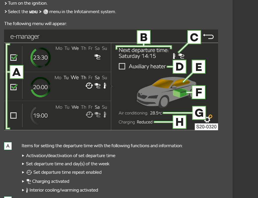

You can set heating/cooling departure time in the car.
Go to e-manager. Click settings cog. Set the temperature you want by clicking on air conditioning.
Go back one screen, touch a plan on the left.
Now you set the time you want it be ready, and you will also see an option for air conditioning as well as charging and another to tell it when your off peak tariff is.
So just click on air conditioning there if you want it pre warmed or cooled at your departure time, as well as being charged to whatever percentage charge you have chosen.
Hope that makes sense!

Hi do you know if you can set two departure times one in the morning and one in the afternoon for the same day so it comes on without having to go in to the settings and change it every time.
Never done that, but the app lets you set up three plans,  so I would think you can do what you want, yes.
That's what I thought and I am sure it did but will only let me set one a day so not sure if a setting has changed I have done a factory reset on the infotainment system but still no joy and wanted to know if anyone else had the same problem and fixed it
