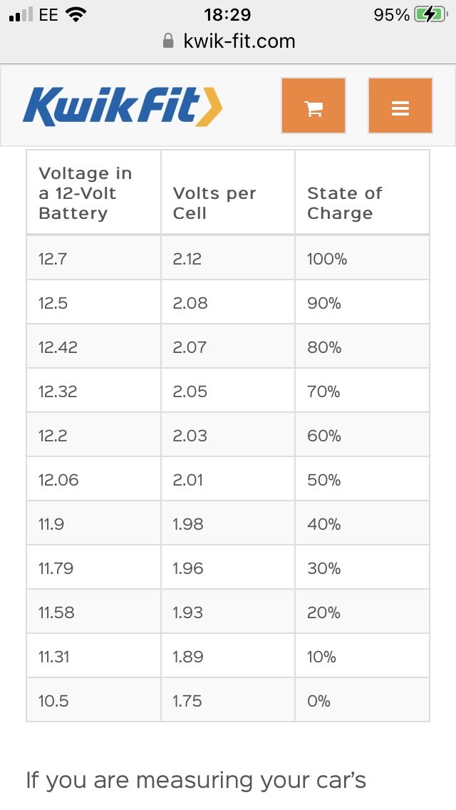

That voltage is still on the low side at the battery ( see pic) - on its way out.   Should ideally be looking for >=12.5 at the battery half an hour to an hour after taking the charger off.
Far better replace before too long, suggest Tayna batteries either EFB or AGM- personally I would buy Yuasa.

As put already you battery readings aren't great but it depends on where and when they were taken and what with.
Just driving the car doesn't always resolve the issue particularly if the battery has been taken too low or too low too often and if during the driving you have high electrical consumption.
