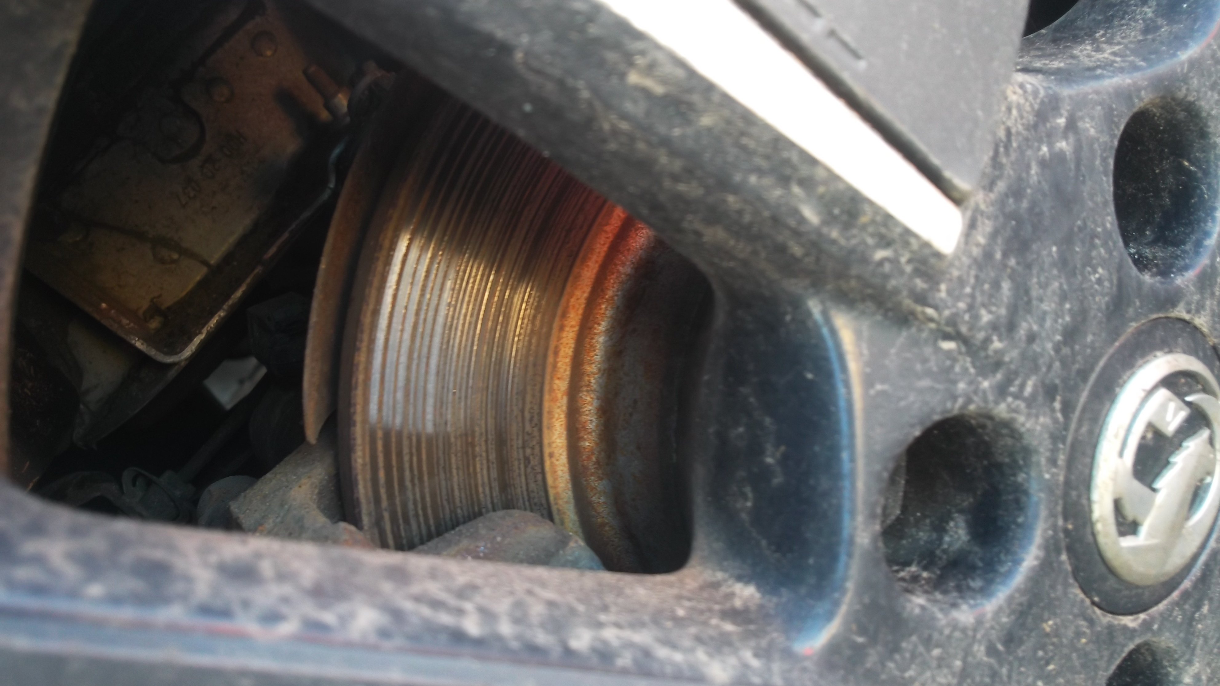

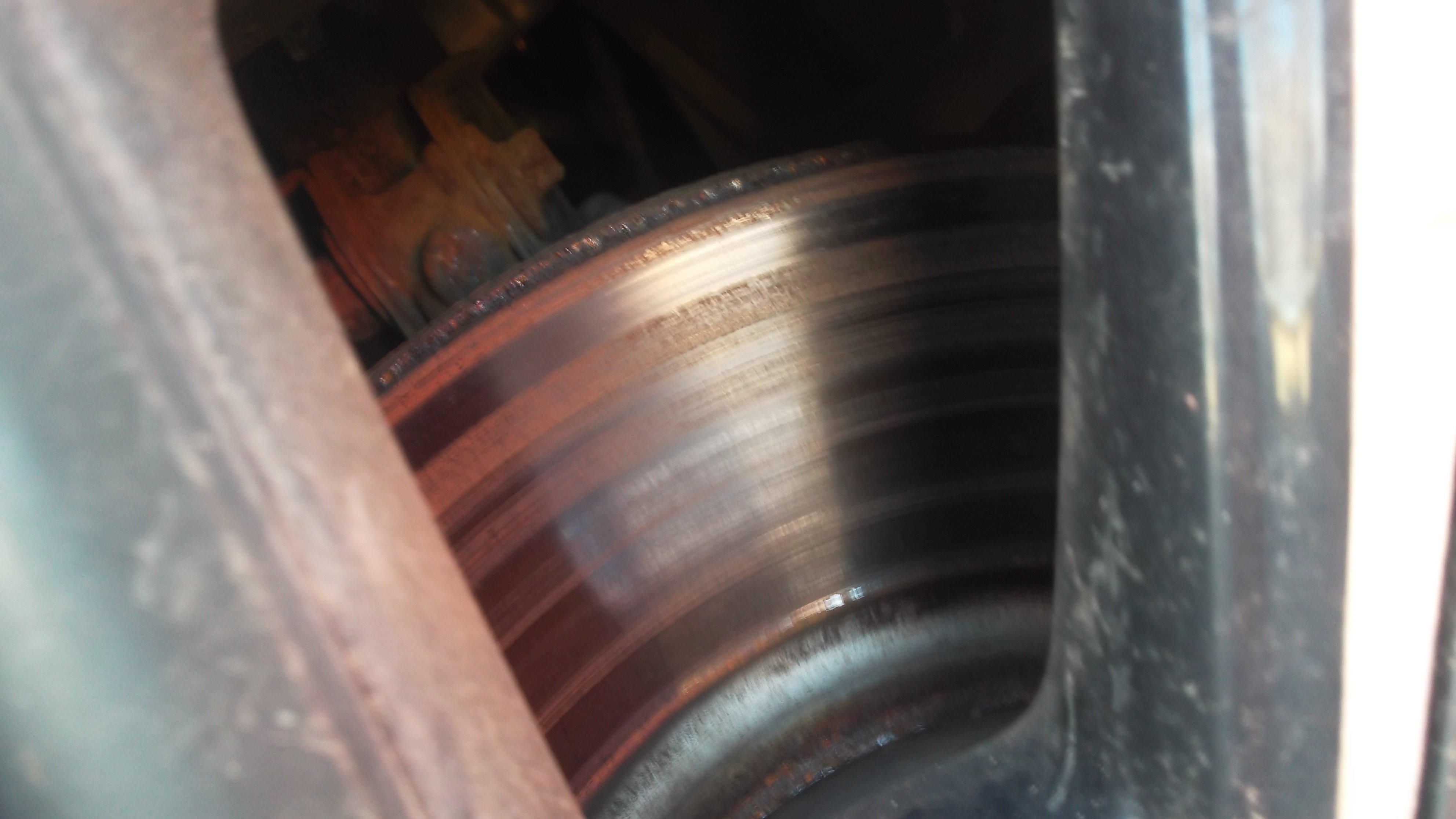

The brake disc in question :

Those discs are badly scored, I wonder if you do have issues with the brakes, I've never seen discs wear like that unless there are stones or something under the pads and are scoring the discs. Do you get any weird noises, squeaks etc coming from the wheels at all?
6 hours ago, Breezy_Pete said:
Leave them a year.
Ditto...   I wouldn't be too worried about those...   They look about par for the course for rear Kodiaq brake discs.
@Graham Butcher  Scoring like that is not uncommon oop north.
Gritting done with more grit than salt can be the cause.
Look perfectly reasonable to me too
Maybe cheap discs were fitted (no offence intended) ............ maybe not???
At least it scratches up the discs to a shine and gets rid of the surface rusting we get down here in the relatively balmy, if damp and wet, winters here in the East Midlands / (West) East Anglia region of England (north to Lunduners).  😊

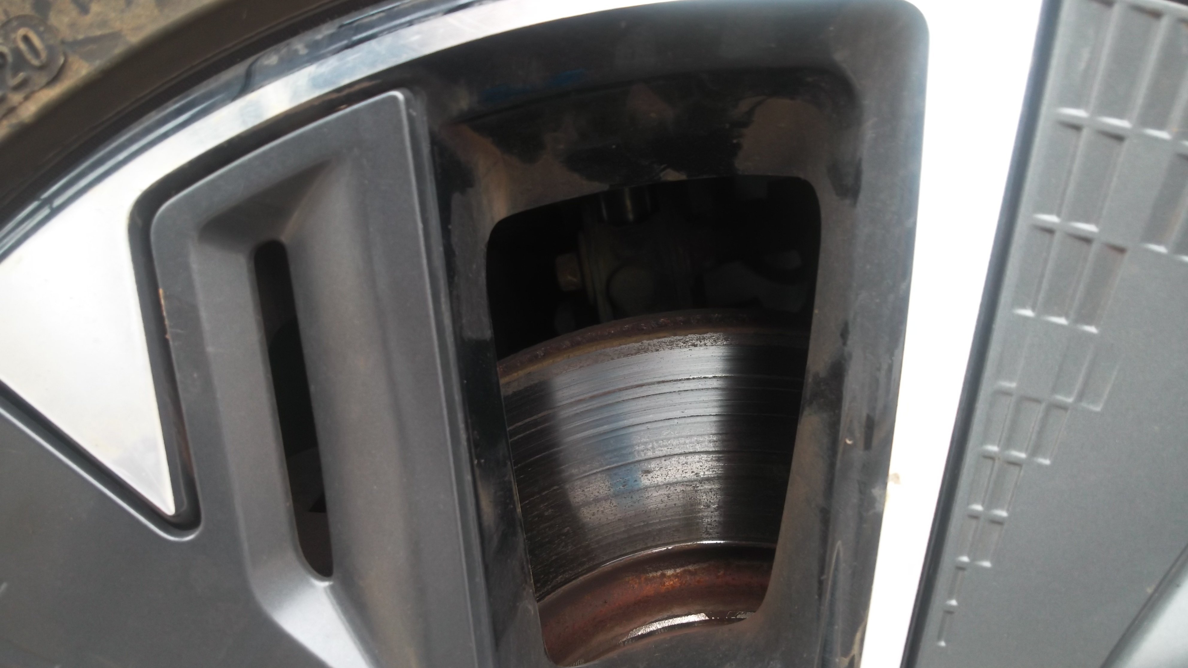

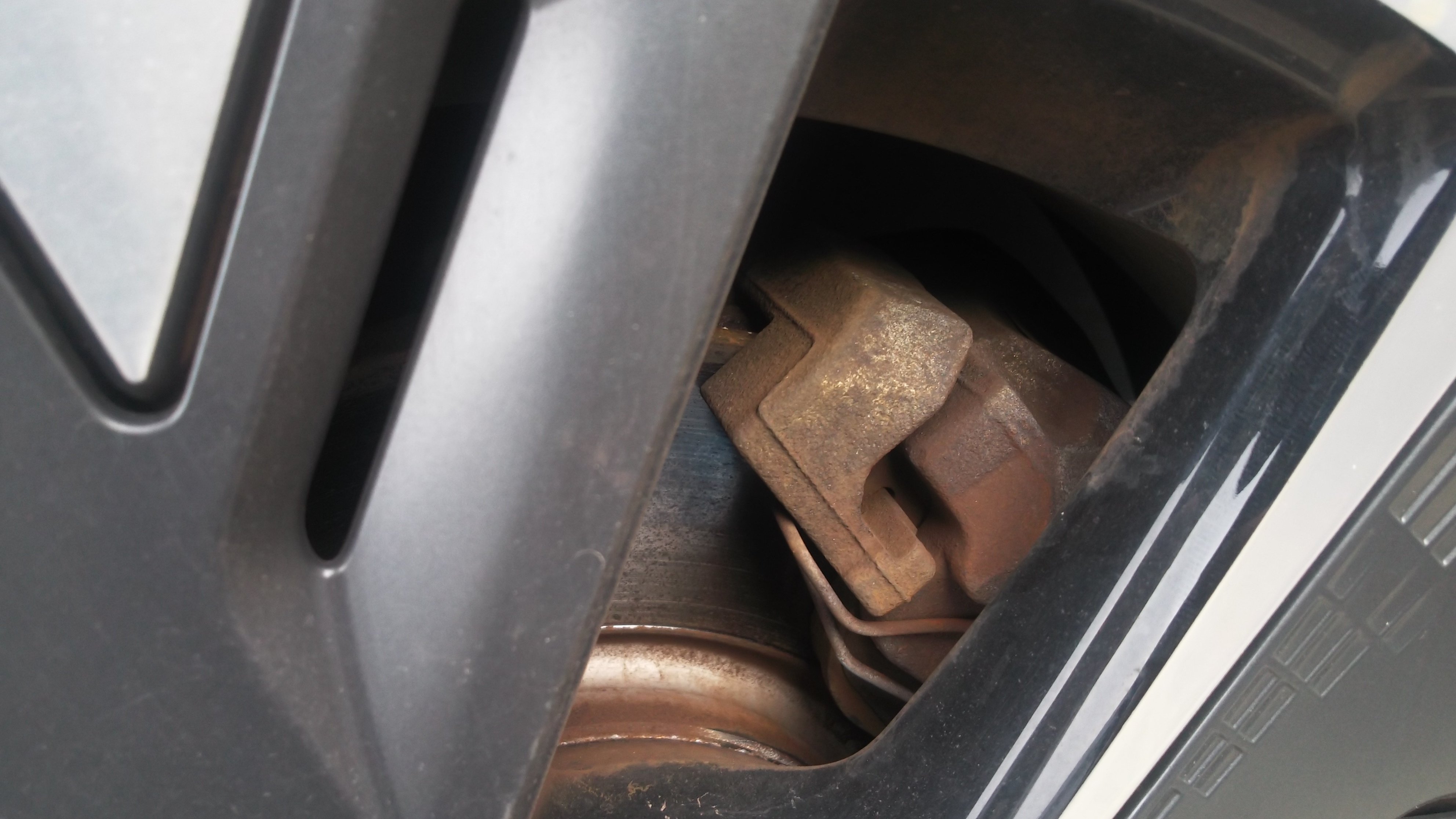

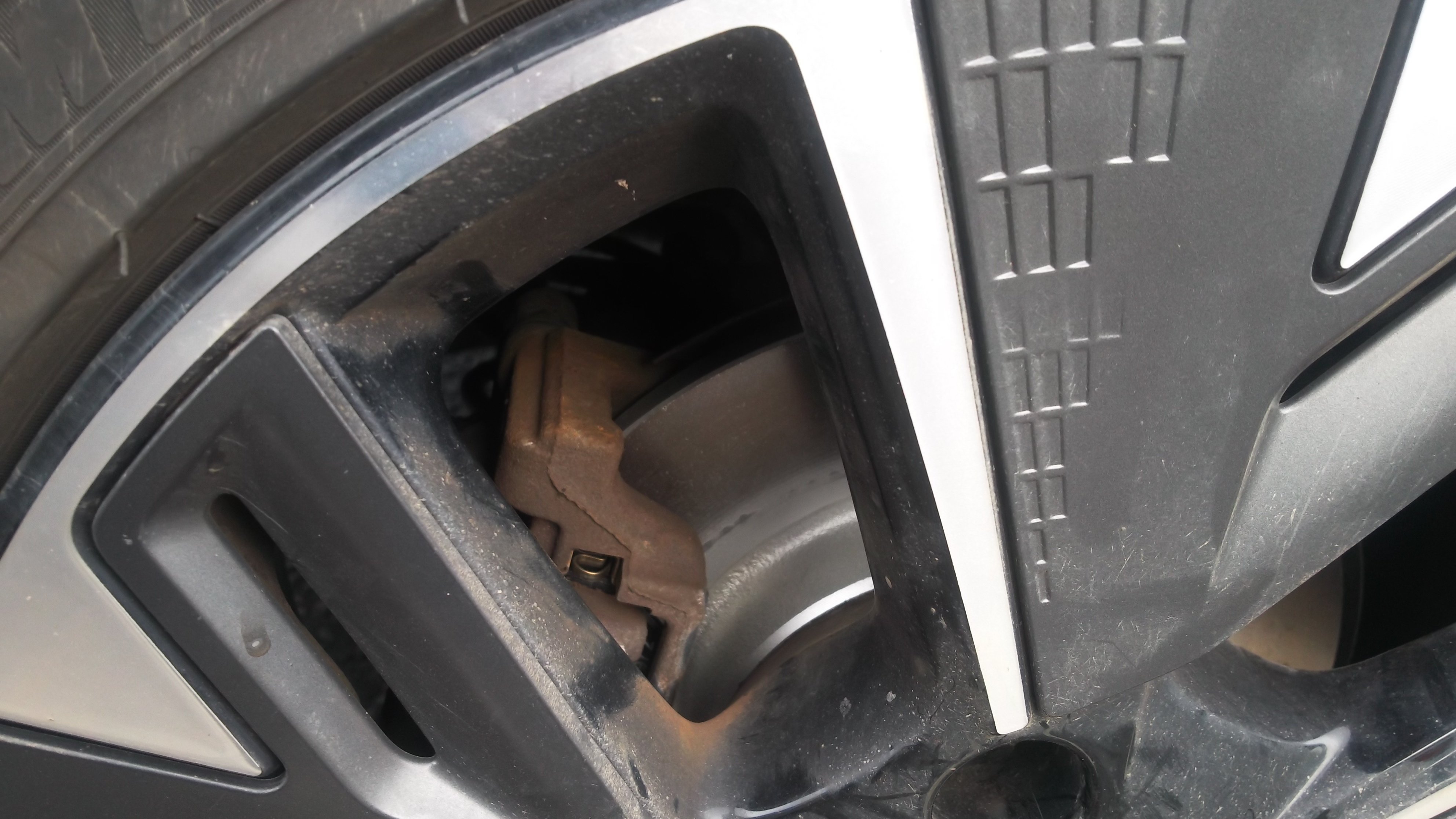

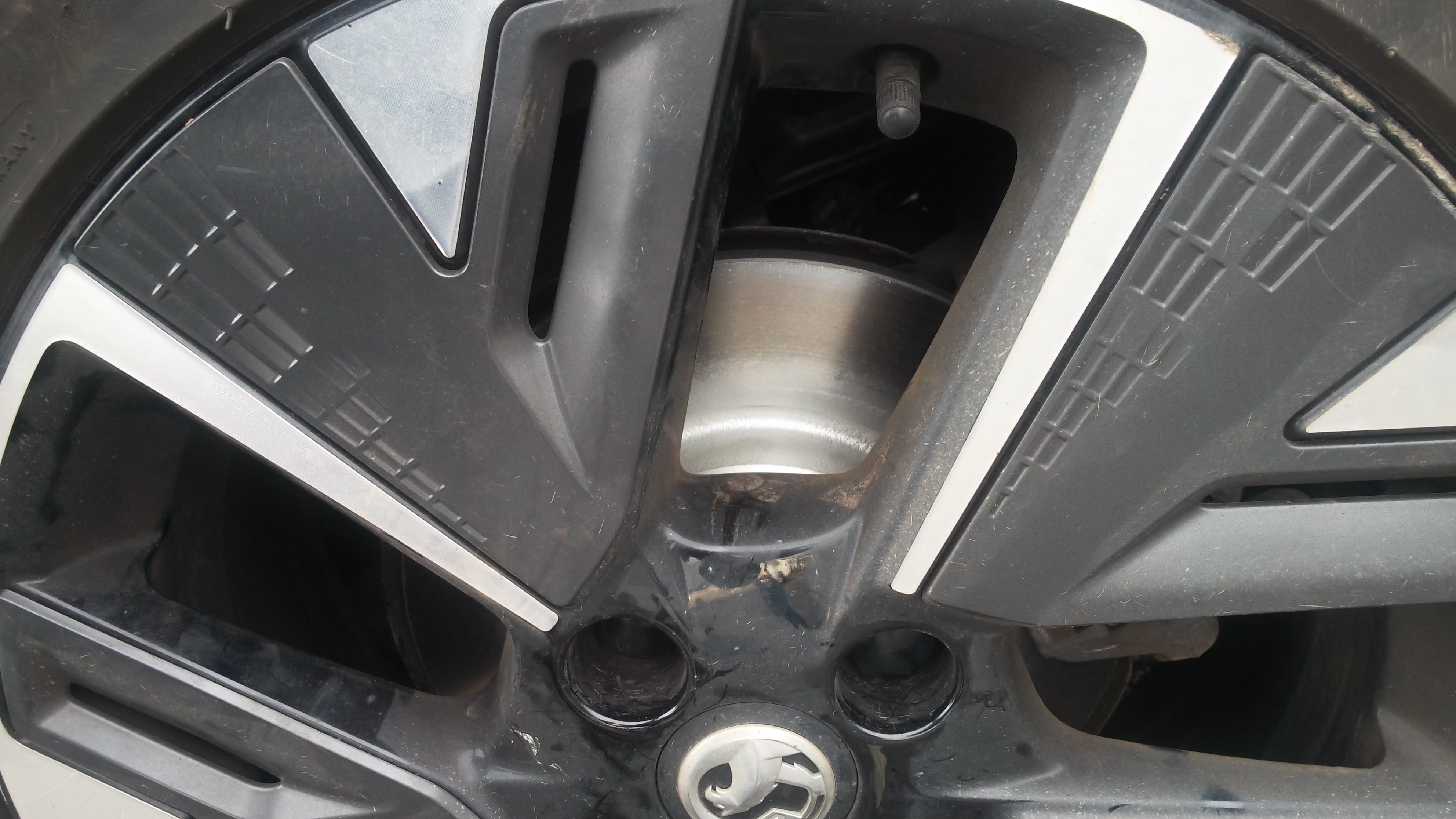

@nta16  The Electric Corsa i had for 3 years had the Discs replaced twice.
That was really from lack of use as no need to use the brakes other than each time to try and take the surface rust off them.
*Not lack of miles covered because that was high.*.
Not easy to clean off braking with a e-brake for the rears, and not easy with the fronts because as soon as you touched them even a little the car came to a stop if you tried rolling down a hill.
DSCN2308.JPG.3d6ae03f49dec96fc6058071512c9564.jpeg.2636e43a7a4e839db3a70886d80502ba.jpeg
DSCN2310.JPG.3363acf230f2b94fa16ea0ea6731b37a.jpeg.dc4656d5ac97e83995f6be0161bd3bf5.jpeg
Edited by Rooted
@ianjohnston - I forgot to put, take any % worn or left figures with a large dose of salt, I can only guess they are done by (biased) eye estimations, one time my wife had to remind a chap I had  only recently replaced the front discs and pads.  Tyres tread depth is another area of wide interpretation for them, the old service tick sheets could be amusing and more so when compared against previous sheets, one time the tread on some tyres increased between two tick sheets despite the additional mileage the car had travelled and the recorded tread variance on the non-existing spare wheel was interesting, to be fair a couple of times it was noted that there wasn't a spare wheel.

@nta16 The fronts are, but then they were only on a matter of weeks.
As to the rears, you should not go to Spec Savers, get a proper optician.     3 sets in 3 years,  and the car will have got a 4th set before the new owner got the car.
They were the worst i have had in decades, the only ones near as bad have been on Fabias.

Discs and pads must be about the most common subject on all VW group platforms. 'Made of cheese' is a popular description.
The ACC itheory is rubbish. The only common denominator is vehicles with electronic handbrakes. I'd suggest that's the culprit.

Good points about the (to me PITA) electronic handbrakes which I had forgot about (or blank from my mind) and about judging things by photos and over the internet, better made than my clumsy attempt at the same.
Up to Ian to decide if and what work, if any, he needs/wants done, could be either end of what's been suggested or something in the middle.  On our own cars we might do as we've suggested or we might do differently, perhaps as others have suggested, none of us are the other person, what might be right for one person may be less suitable for another person.  If my wife has any concerns about something on her car that she drives it's of no matter if that something doesn't cause me concern.
