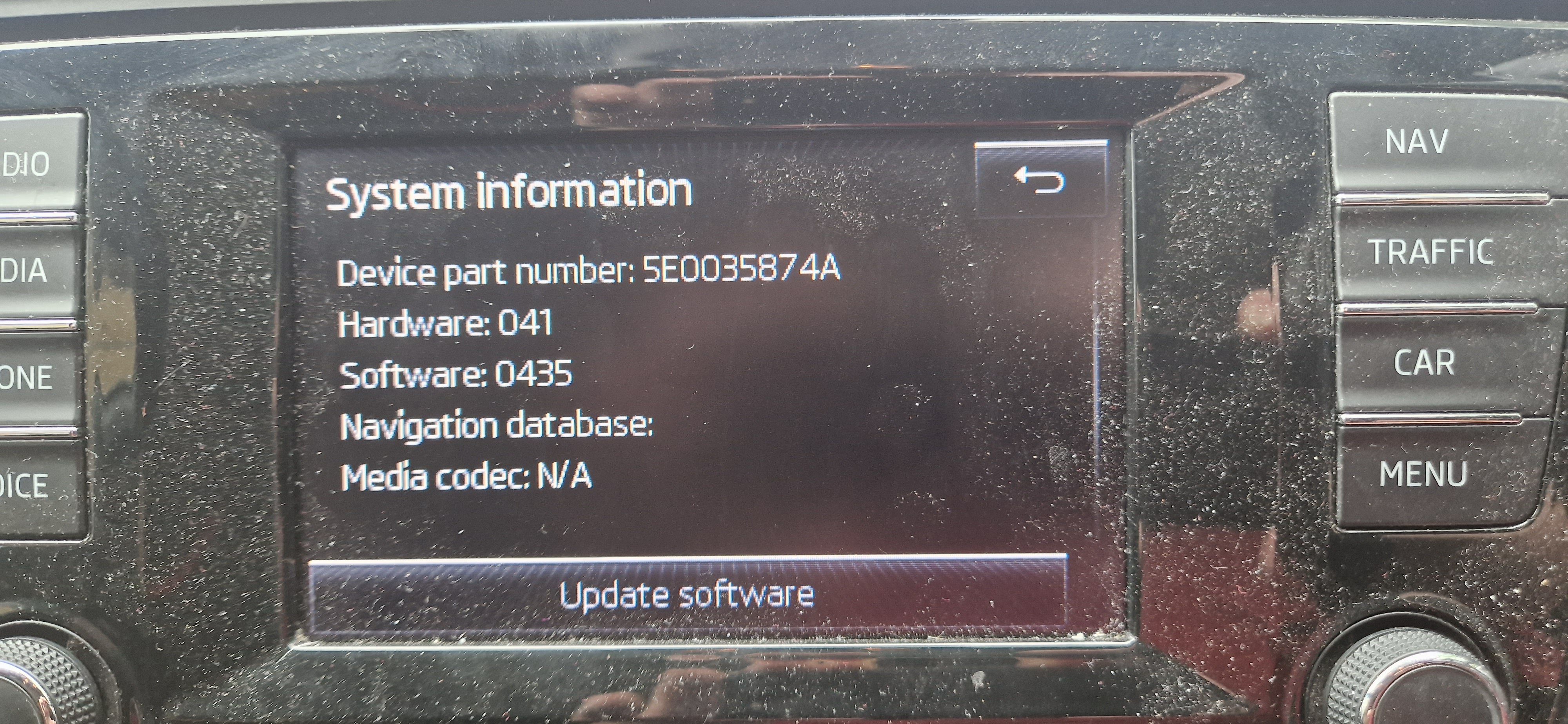

I have a 2015 Octavia 2.0TSi VRs Estate (pre facelift, with the single strip DRL, not the split "eyelash" style lights). It has the lane assist camera, Maxidot display and what i *think* is the MIB2 Amundsen unit. If I type my VIN into the Skoda Update portal (for the nav) it says Amundsen.

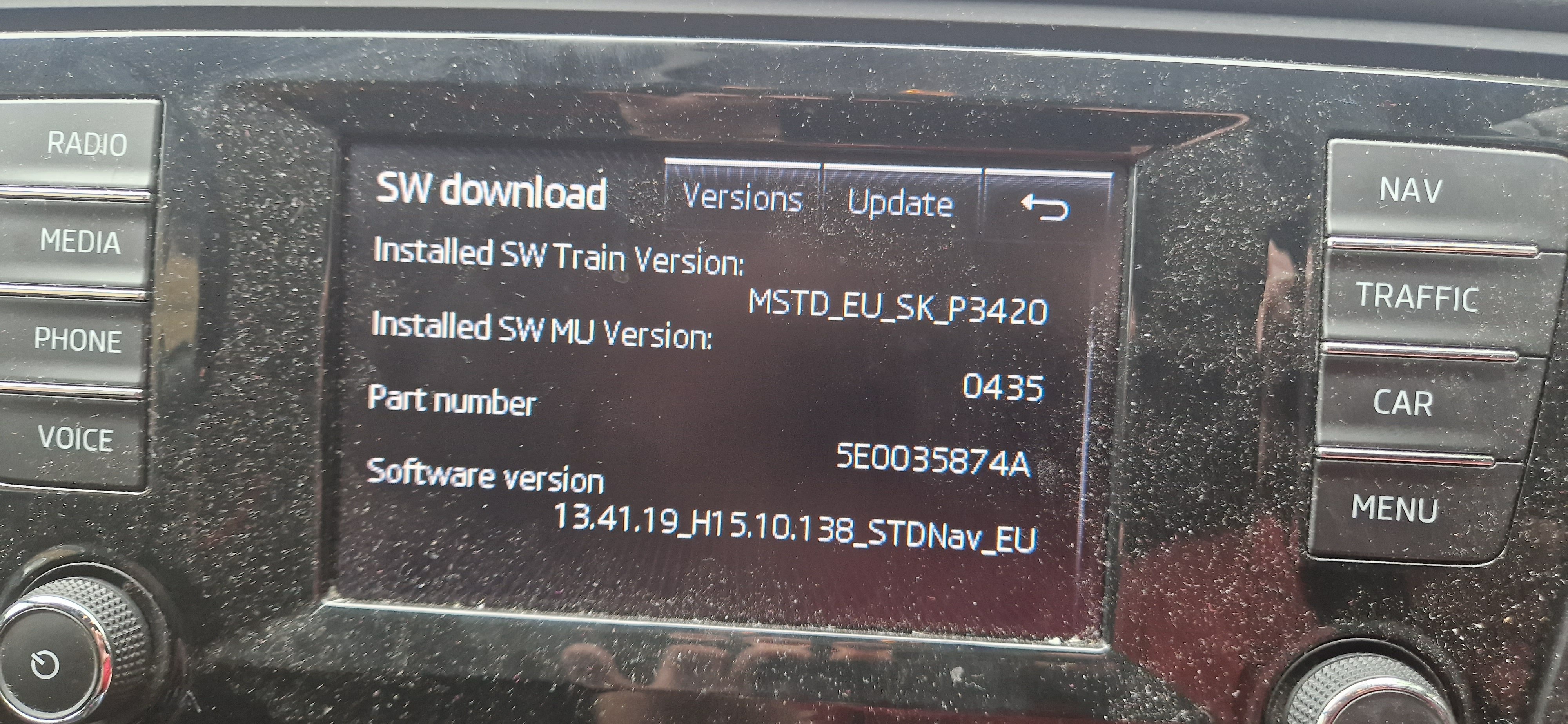

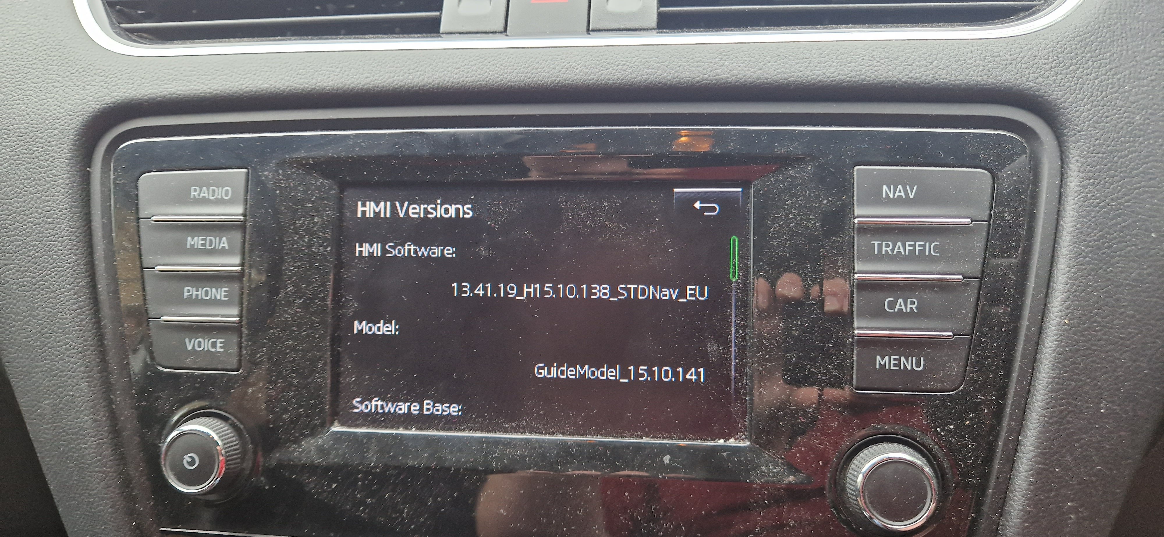

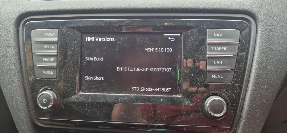

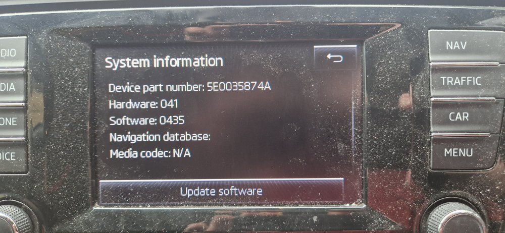

Photos attached from the service menu (please excuse the dust!)
I am reasonably experienced with VCDS adaptations/long coding, so was just more looking to see if enabling SmartLink for Android Auto was even possible on my unit. I have the USB port and AUX jack underneath the climate controls. I don't see the SmartLink option in the menu currently at all.
2015 builds can have MIB1 or MIB2 depending on build date, and looking at your part number I'm pretty sure you have a MIB1 Amundsen - like my previous 2015 Elegance.
Which means you cannot enable SmartLink as you need MIB2 hardware for SmartLink.
Ah yeah, I think you're right about the MIB version. A quick google images search shows the MIB2 has the larger screen. I should've checked that before!
Damn, was hoping this could be an easy upgrade. Thank you!
