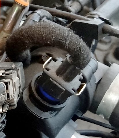

From no where, it started overheating (cooling pump changed last year).
And the fan is not starting. The thermostat also broke. So i changed both the thermostat and the heatingsensor just to be sure.
and its better now but it still overheats. The fan is not starting either. I have ordered a new fan relay and thermostatsensor or whatever you call it.
I dont think the actual fan is broken since i have tested if electricity passes through it and it does.
The question: If i am going lets say a 100km/h why is the car still overheating. I mean it cant matter if the fan is on or not in that speed? (or does it?)
I live in Sweden, we have like 18-25C. Also, if i cranck the AC on max speed and heating the car stays a pretty solid 90.
I should also mention that there is a tiny leak, (drops) from where the heatingsensor sits. But if i still have a lot of coolant does a leak matter?
Is the pressure not building up right maybe?

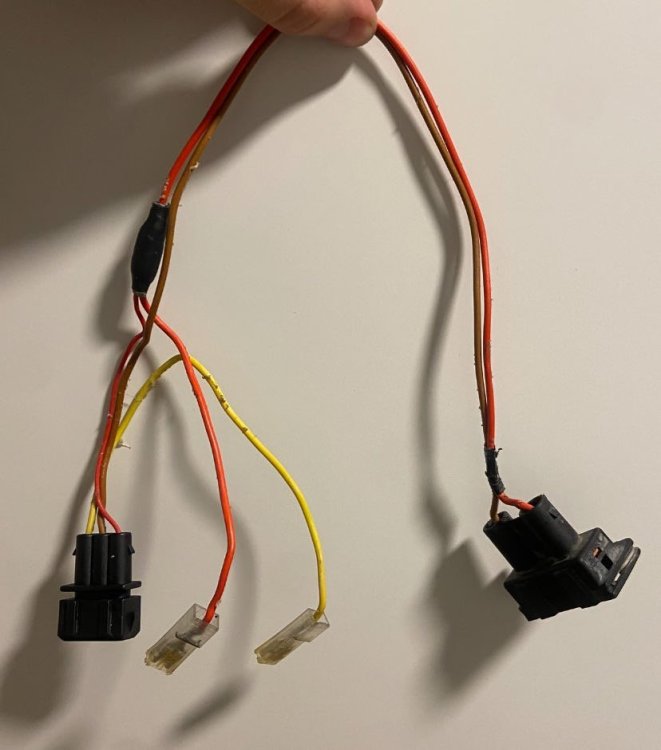

Problem 5: The radio, i would like it to turn on/off when i turn on/off the car. Does someone have the wiring schematic so i can change that?

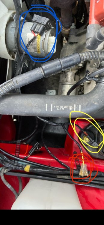

  • Looks like a bodge to me, I wonder if someone had previously wired-in an override switch to that loom.
  • My concern is over the very existence of those joints, not the quality of the work under the tape.

P5 You describe "normal behaviour" with standard and most correctly installed aftermarket stereos. As you say, you need the wiring schematic, but some Skodas reversed the permanent and ignition live connections so you may need a wiring adaptor with an aftermarket stereo.
Problem 1 - The fan switch sits in the radiator, if there's no flow to the radiator, it won't turn on. Check if the tube going to the radiator warms up when it sits on idle. But ito Sunds like the thermostat is not working properly (it can happen even with new thermostat). To rule this out, you can remove the thermostat valve.
There's a circuit that simulates function of a newer car - the radio stays on as long as the key is in the ignition.
https://www.sp-el.cz/Felicia-S-kontakt-d1149.htm#detail-anchor-description

The electrician can do it opening when the key is On 1 scale or turn on-off any time you want, in GR i older years the electrician was ask you first of all ''with the key on or not"? Some guys want to have music in their car even when it's off, it's risky because if you forget it can ruin your battery.

Check the thermostat opens check power going to thermoswitch and fan if it is a single speed will be driven directly by the thermoswitch's output.
Don't bother usually a new crush washer will rectify that but I prefer one it 2 drops instead of stripping the threads
Ill check thanks,
Yea it is an aftermarket stereo actually, really wanted BT so had to change.

P1: Both tubes are warm while driving, one more than the other, so i can try to drive without a thermostat? To see if that helps?

- Yea exactly thats the problem, i always forget to turn it off when im in a rush... But ill look into it, want it with the keys.
- Yea exactly, okey ill check the switch. I am thinking that the relay must work considering that it works one-way?
If both tubes are warm while driving, it would mean that coolant goes through the radiator, but radiator doesn't cool it. Could you check whether the entire area is warm on idle?
Is it car with AC? There's no relay, if it's not. If it has AC, the fan should turn on immediately once you turn on cooling.
Just to check, what temps are we talking about?
Edited by Papez
If you connect the 2 cables that are attached to the radiator switch (it's like to take a command from the system) the fan must start spinning.
Ill check the radiot, pretty sure i did it before and it got "medium" warm all over.
The car has AC, The fan does not turn on. I have bought a new relay but i cant find where it is hahaha...
I have also bought a new thermometer fpr the radiator, that one looks like **** so i think it needs to be changed,
I will also try to burp the system again by overflowing.
ill try

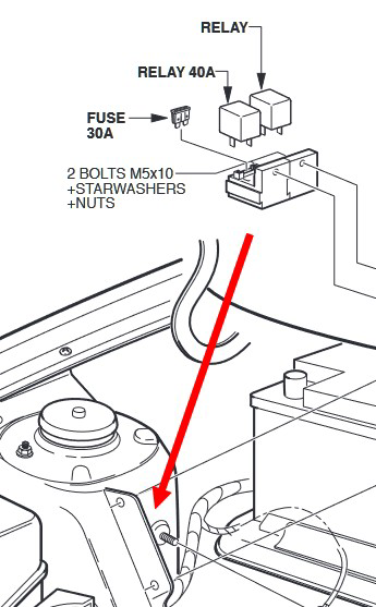

in front of the battery left of the dryer
Behind a triangle plastic cover with 2 screws.
Photo would help, there are more types of AC. Factory type has relays and fuses near activated charcoal canister, on the opposite side from the battery.
In GR with Alex a/c there is only this:
No relays.
