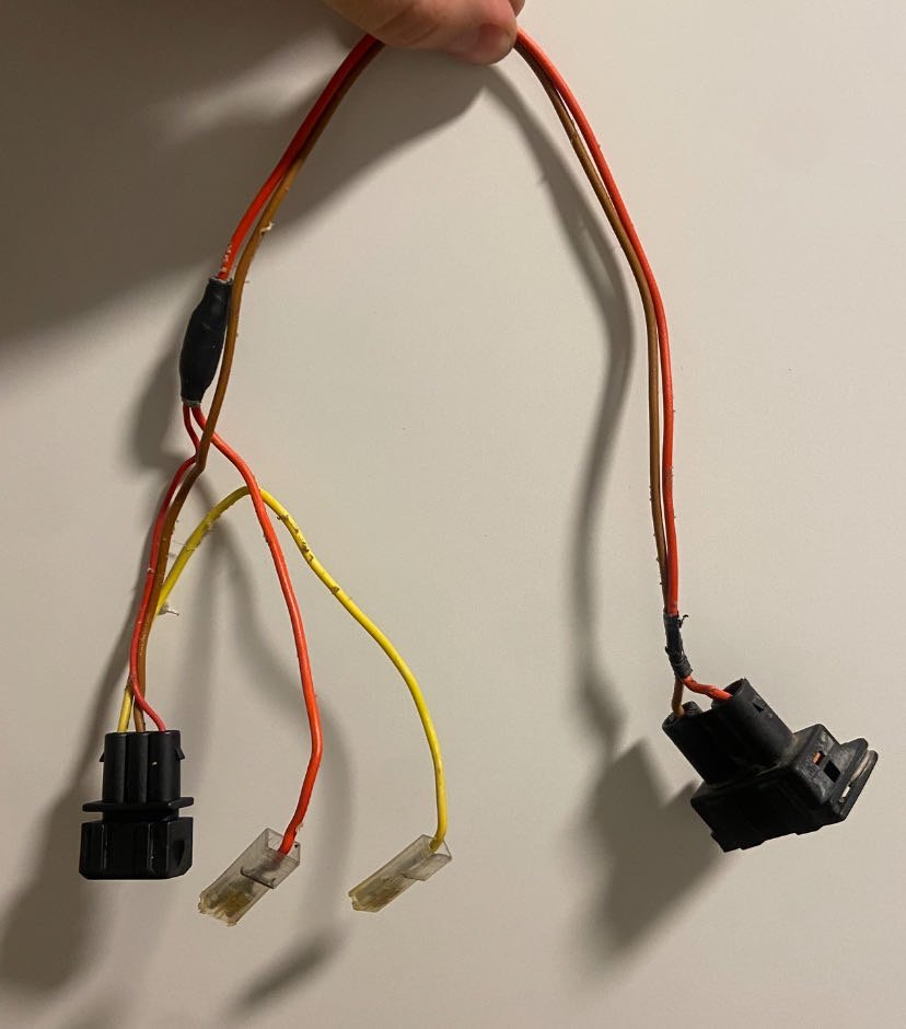

  • Looks like a bodge to me, I wonder if someone had previously wired-in an override switch to that loom.
  • My concern is over the very existence of those joints, not the quality of the work under the tape.

I do not like the look of the two wires to one (perhaps I am wrong as I do not know the wiring on these cars) but even if I am old and forgetful I have seen enough suspect looking wiring to be suspicious, you can now perhaps see why I put about checking the wiring and the quality of some peoples work.

The yellow and the orange (which are alone in the middle) are for the radiator switch.

I could not get enough zoom on the image to see well enough but am I the only one to think the connecting set up below does not look factory standard.  The red(?) (thinner?) wire, from the two-way joint off the orange wire and whole wire set up and presentation looks DIY to me, am I wrong?
Then you would wonder why you would want or need an override switch if the car is running fine and cooling fine, I know some like to have a dog and bark themselves but for an owner that has had the car from new and barely drives it perhaps before selling, perhaps it was just belt and braces but seems a bit odd to me other than bodge.
Or could it be extra wire for extra pin if the three-pin switch was previously fitted instead of two pin switch, how is the two speed wired.
ETA: some people have their own logic to their wiring which can be "unconventional".
